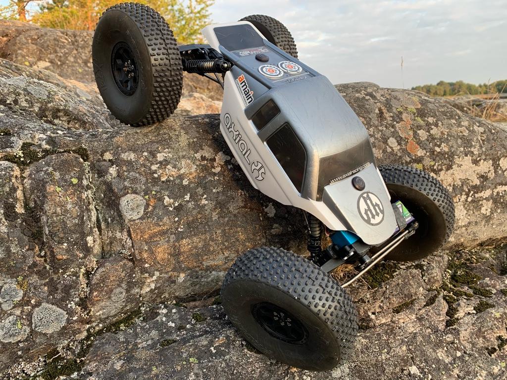

Got a question about the amount of torque twist on the rig.
I am very happy with the way it climbs,-even with rather light knuckle weights,-about 100 grams per side. So the Pneuma chassis do work well "thumbsup"
I did a few one-handed driving video clips today,-climbing some quite steep lines.

Have you tried the upper links on the outside of the chassis?
When you say torque twist are you meaning you lift the right front tire or the chassis is rolling back on the left rear shock?
I know its the same thing basically but for me I look at it two ways. If Im not lifting the tire then I may add a little preload to the left rear shock.
If Im lifting the tire then I try spacing my uppers out a little more at the chassis.
Mine does roll the chassis but i havent seen it lift any tires or loose any front traction when it does. Hope that makes sense.

What I mean is that I got a PM about how I find the amount of torque twist on the rig.
There is almost zero torque twist,-the rig drives very well"thumbsup"
And the videos were an attempt to show how nice it does climbing :)
Yes,-there is a tiny bit of body roll,-but I do not think it is harming the performance "thumbsup"

Ah gotcha.
The climbs look really impressive "thumbsup"

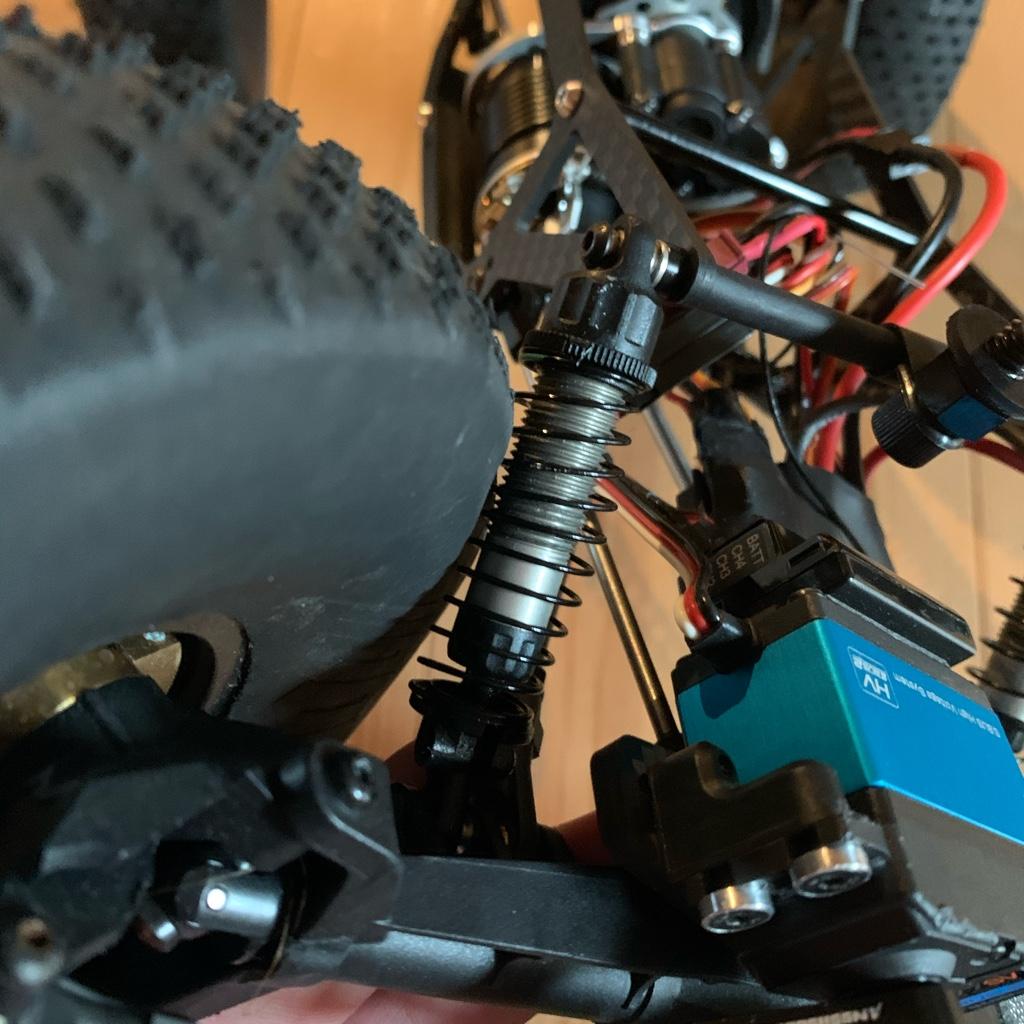

Hello! I have just started buildind a pneuma too. Do you get any tyre rub on your front shocks when you turn at full compression? I have been trying to fix it with wider hubs but cant get it to clear. Im using voodoo pins at stock width, but starting to think narrowing the tyres might be my only option.
Hello. My tires are just touching the springs on the shocks at full compression. But it is not a problem I think. I am running Shift hubs with CI Bolt wheels.
