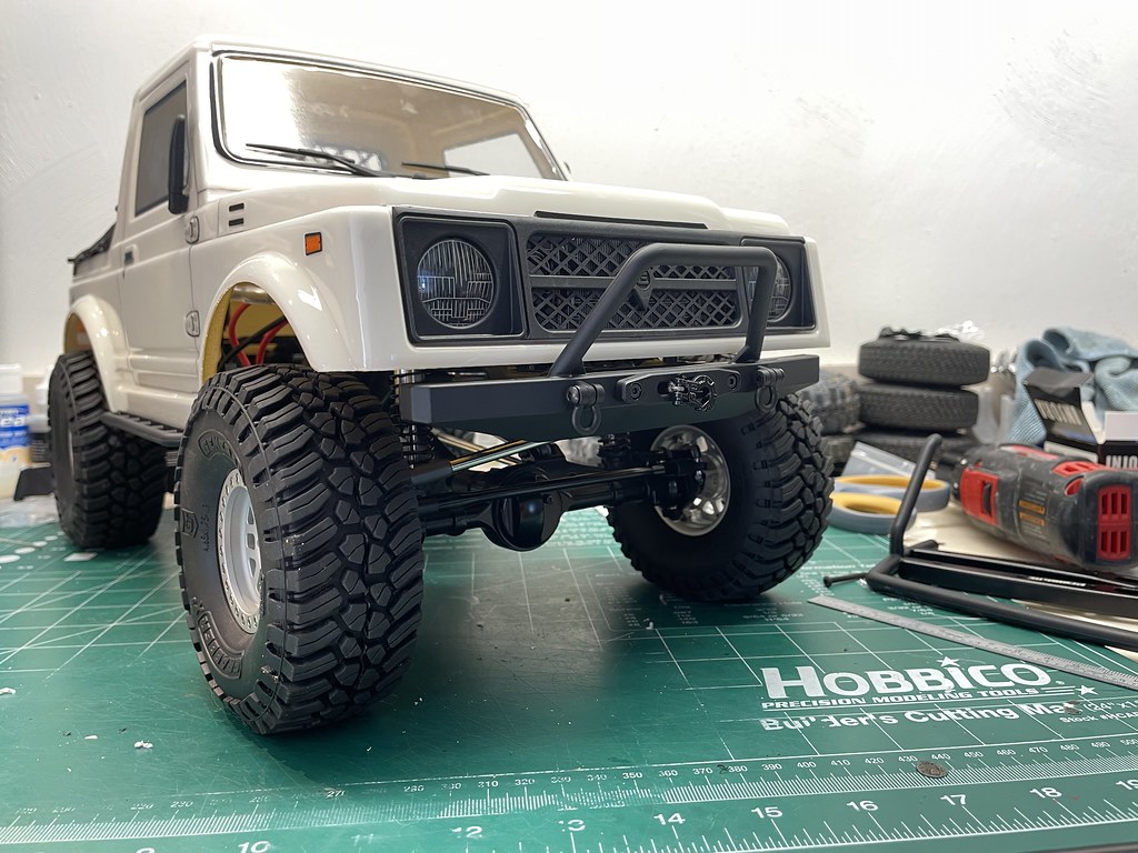

Picked this up the other day and going to do a little build thread here, nothing crazy. I took it out for it's maiden run and it did pretty good. Super smooth and the short wheelbase made a noticeable difference in breakover in my backyard rock garden. Got some wheels on order and some other stuff in the works but that will be revealed soon enough. Here's a boring bench shot.

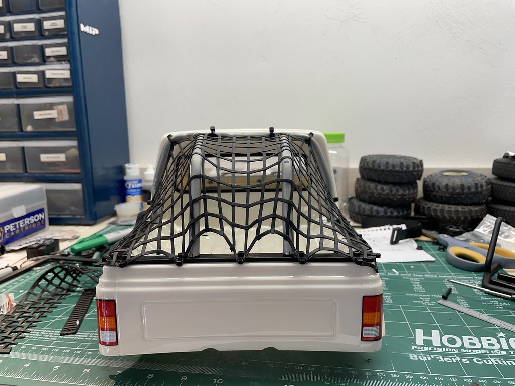

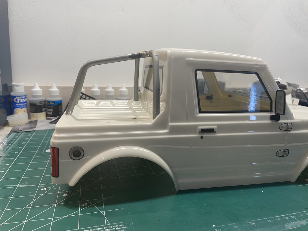

So I wasn't happy with the 3/16" brake line roll bar. It seemed too thin for the body. So, I ordered some 5/16" hard fuel line and created version 2.0. In addition to looking better, the larger diameter allows me to use 3 mm flanged nylon nuts (via JB Weld) in the base of the bar. That cuts down on fabrication and makes it a cleaner install. Here is a pic of it mocked up:
Untitled by JASON MCKIMMEY, on Flickr
