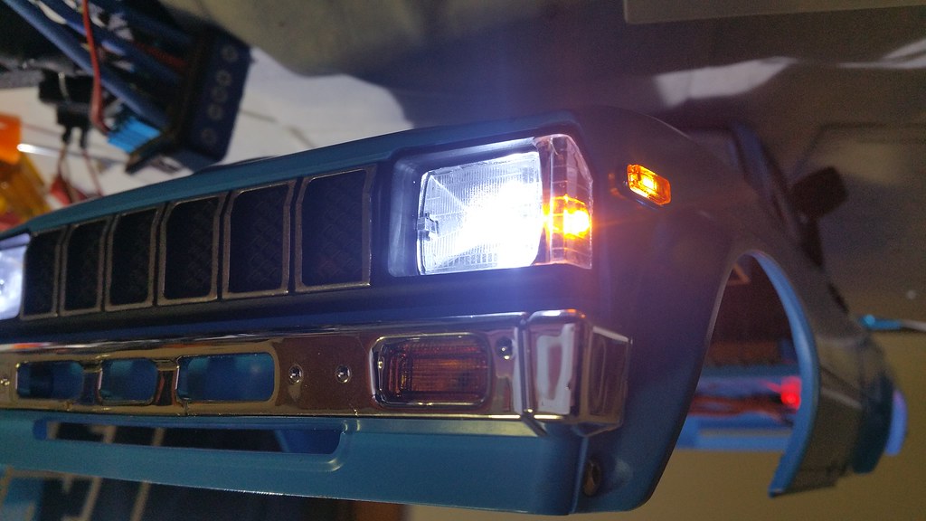

I've had the RC4WD Mojave LED light kit lying around for a while. Last night I decided to install it.
When I opened up the package I saw that RC4WD didn't bother with labeling the lights. Even the cheapest of cheap Chinese kits label their LED colors.
Fail #1. So I attached the LEDs to a receiver, ESC, and LiPo to power them up.
While installing the kit I realized that the front of the truck has 8 light buckets - 2 headlights, 2 side marker lights, 2 marker lights in the bumper and 2 turn signals. The LED light kit only includes 6 "bulbs" for the front? Whiskey Tango Foxtrot?! Fail #2. RC4WD strikes again. You can't make this stuff up. :lmao:
So I had to decide between one:
and two:
Two looks better to me because in the first setup the turn signals look like an orange bulb behind a white lens. There's no diffusion going on.
So one it is...
And then onto the rear. There are something like 10 light buckets in the rear - 2 marker lights and each taillight has 4. Guess what. RC4WD gives you 4 LEDs for the rear and they're all red. Womp, womp! Fail #3 :lmao:
So the marker lights each get a red LED and each taillight gets 2 LEDs.
The back is now lit, yo!
Am I nitpicking? Yes, but these are the easy, little things that just shouldn't be missed.
Don't waste your money on this kit. :flipoff: RC4WD. It's really no wonder that their half assed products have given the name RC3WD over the years.
I think it looks cool. Now it's time to light up the Blazer body for which, unfortunately, I also bought the RC4WD LED kit. I can't wait to see how many LEDs are missing on that kit. :lmao:
