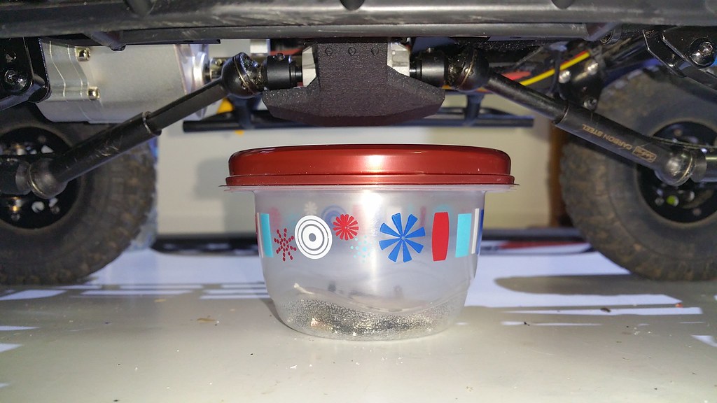

Here's the starting ground clearance. The shovel, err I mean skid plate, is just barely riding on the red lid of this container. This skid plate gets hung up a lot in the rear world, even on mild trails, in my limited experience with the truck.

And, finally, we are all back together. You can see I gained a significant amount of ground clearance without raising ride height or center of gravity. Always a good thing!
