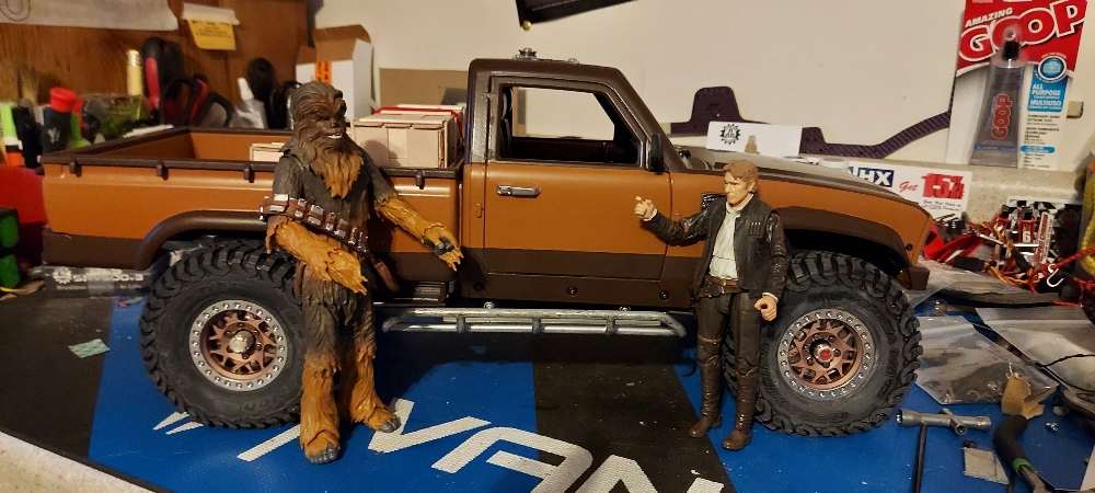

Looks good Adam. One thing I like about that body, is it looks like the wheel wells have plenty of clearance for the 4.19’s. It’s just got good proportions in general [emoji1303]
Thanks tom! Its such a good lookin body. The front axles is a bit forward but not to noticable. For the ride height, it has good bit of flex, right at 3 1/2 inches.
Boy she’s coming together now! The cargo lipo stash is a cool idea. I think the front axle position is just about right. The opening is centered. Leave it. Rock on
Thanks travis! With the bumper mounted, the tires look more forward bias. But they dont rub much, so im goina leave it be.
The batt box i really wanted to hinge the top, but just wasnt goina be enuf meat on both sides of the hinge. But thats ok, the bungee makes it look like its strapped down. Goina get on the electronics he in a bit n try to knock them out today

Ive been workin on the juice tupes this mornin. Got the powerhouse mounted in there, its rather tight but it fits. Used a piece of thick lexan from the PL PW body i had to make a base plate for it. Cut it a bit long to mount the rx right out front of the esc. Worked out better than i expected, less wires to have to tuck in here n there. Debatin whether to cut the power switch off n wire it straight, or leave it n find a spot to tuck it away where i can reach it. Guess i could turn it on n then tuck it in somewhere.
All the rx wiring tucks nicely behind the grille, including the locked up light controller. I made a short extension batt connector with 2 jst plugs, 1 for the HH shv500v3 n one for a servo winch at some point. It all hides under the interior pretty good. Gotta hand it to these 'scale' builders, theres not much room to tuck stuff away.
Once han n chewy show up to the party, ill get them strapped in for a joy ride. Cant wait to take this thing out for its first run. Lookin at it with most of the weight on it, im glad i stuck with the stock PL foams in the km3s. They have just enuf squat to look realistic.

Here u go travis, i snagged some pics before i left this mornin. Just got the chance to post them up. The panhard needs a lil adjusting, but i think im goina leave it be
