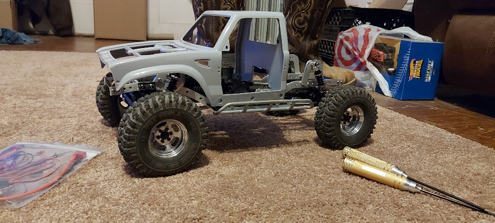

Evenin everybody, got a small update. Been workin on the body the past few days n have it pretty well lined out.
First off, i had to do some axle swappin. The f10s were to wide to get the tires tucked under the body enuf to pass c1 rules. So i swapped them with the VP pro rear and the ssd pro44 offset front from my c2 rig. Now the tires sit nicely under the fenders enuf to pass.
After i chopped the center out of the floor to clear the vfd trans, i got a trans tunnel made. Its a bit wonkey, but its there lol. Didnt have any styrene, so had to get creative with wat i have.
I got the bed cut for the shock towers, kickin my butt for the mess up smh. I shouldve done the towers first, then cut for the shocks. Instead, i marked n cut for the base of the towers n shocks, not thinkin the inner fenders would cover quite a bit ore than i needed to cut. But this was the first bed ive modded to fit like this. Live n learn i guess...

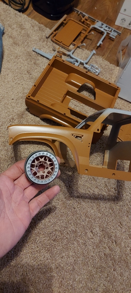

Ive got parts on order to hopefully get this rig goin. I got a nice set of bronze VP 1.9 bully wheels from our good buddy fricker, much appreciated brother! Have a copperhead10 in the crawler edition flavor ordered, white case. Snagged a set of PL bfg km3s to wrap those sweet lookin wheels. For foams, im goina try out the powerhobby dual stage for the 3.85-4.19 tires.

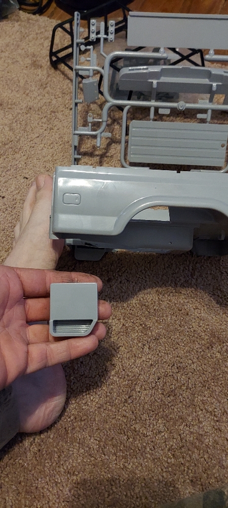

One more thing though... With or without mudflaps? I cant decide...
