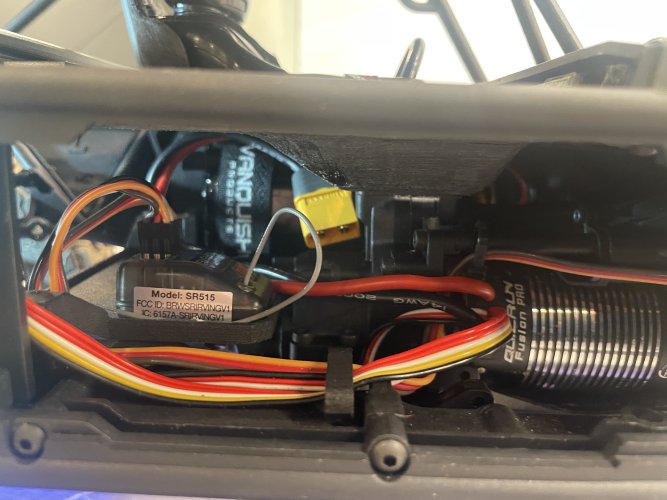

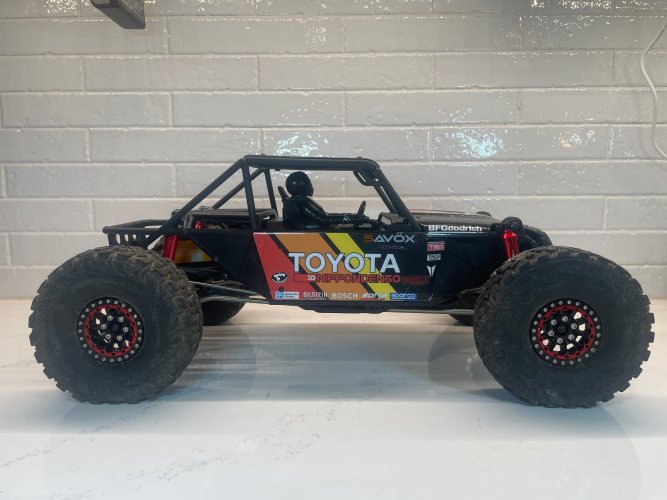

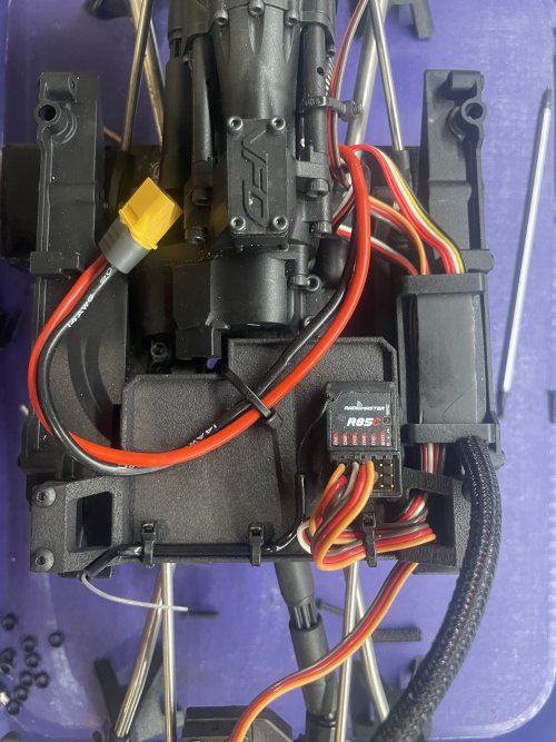

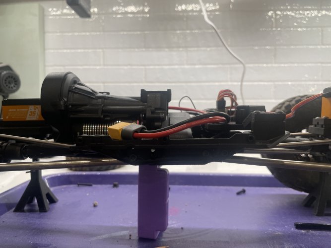

A little update. I went to work reducing weight up high to help lower the COG. Went with a printed electronics tray that lowers the height of the receiver. Added a mount for the power button that keeps things neat and tidy. Removed the 2nd seat and ground down the remaining seat, backside of interior plate, and driver to whittle away grams. Got rid or the radiator and replaced it with a threaded spacer bar. All in all I removed over 70g from above the skid plate. Not bad. With a few light weight adds and the weight saved I am probably about 50g lighter up top.
20250129_133846829_iOS.jpg20250202_043415952_iOS.jpg20250129_133900865_iOS.jpg20250202_043719580_iOS.jpg

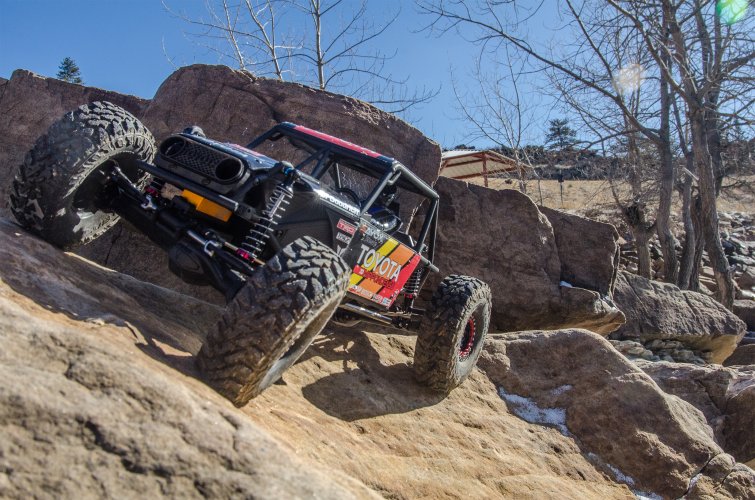

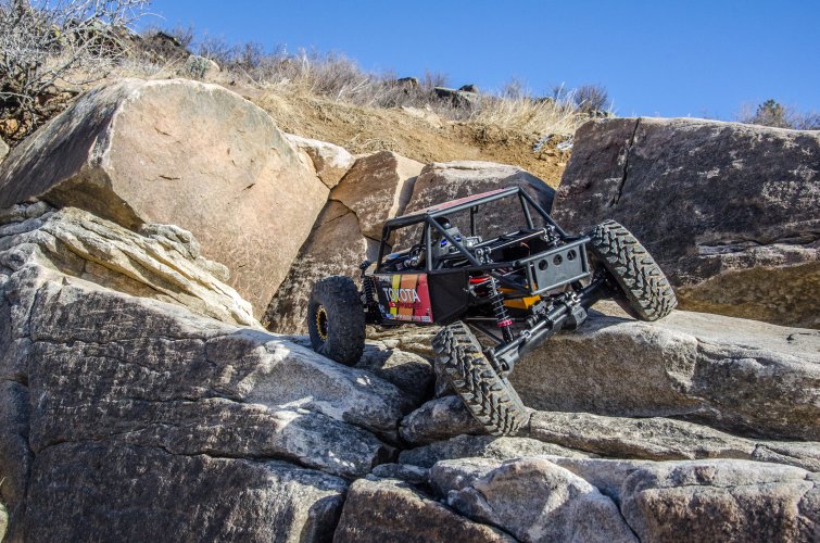

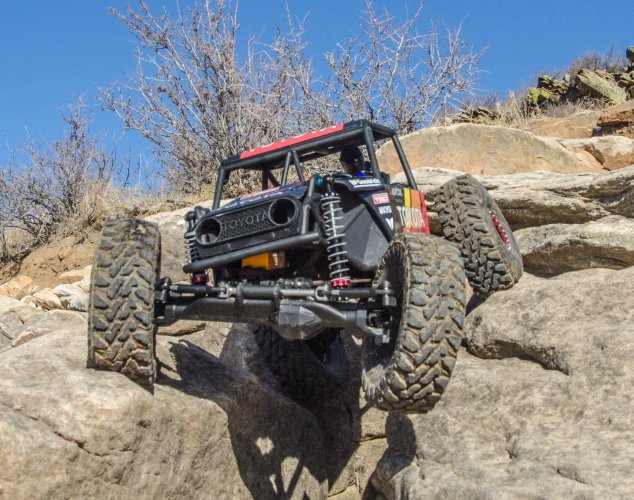

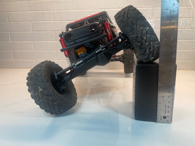

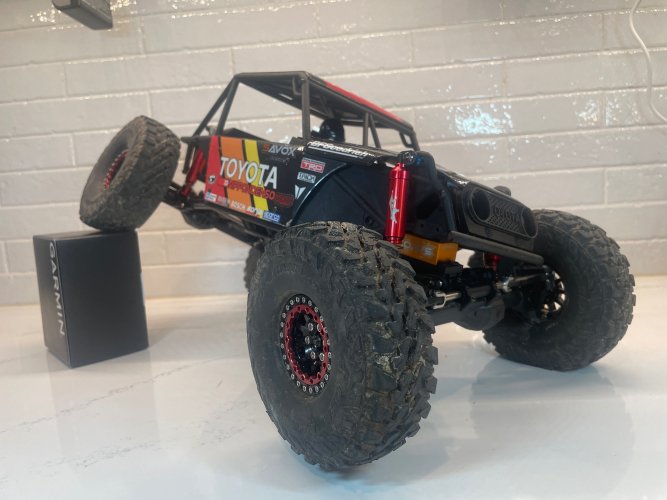

Finally got out on the rocks after the last round of work. The reduction in up-high weight was noticeable. The rig felt more stable and planted. After weighing all the parts I removed, it ended up being just under 70g in weight savings. This weight was from above the skid line so the impact was really felt. Still working on lowering the CG. Working on shock setup to lower ride height a little. Probably gonna add a bit of wheel weight in the front. Planning on bent rear links to help belly clearance. And a few shots from the rocks._DSC2373acrop.jpeg_DSC2405asm.jpeg_DSC2420asm.jpeg

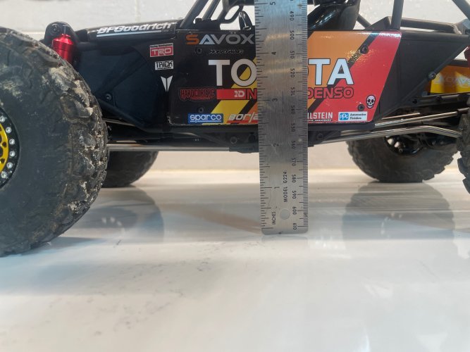

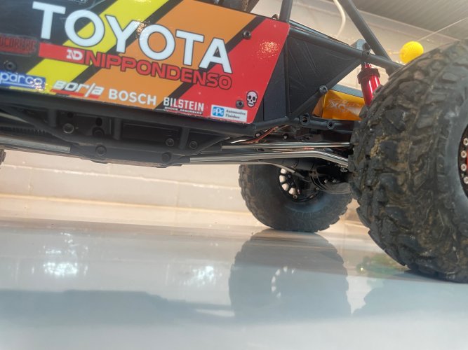

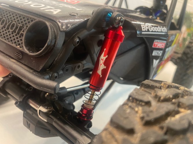

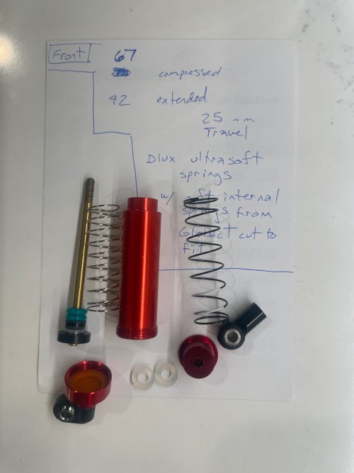

Build update. Went to a full-droop setup. Built Dlux medium shocks up and they feel smooth and solid. Added high-clearance rear links. Belly scraper yes, but I have done full-droop in the past and think it will fit my terrain and driving style. Replaced the radio/receiver - Radiomaster mt-12, for the rear steer dial. Installed a Harley Design printed lever. Still dialing in the servo settings but having independent rear steer like this is amazing. Looking forward to getting her out and testing this setup.
I have stiffer springs if I need to raise the ride height. Driveline is a bit more exposed to rocks with the bent links but it doesn’t look too bad. Low low. Only real plans revolve around upgrading the transmission and drive line.
Gonna start collecting parts and probably drive it as is until she breaks something. Then do everything else at one time.
EDIT: I got her out on some rock lines around my house and I think this will be a great setup. Very stable with the lower COG and the DLux droop setup. Very smooth and controlled suspension movement. The rear steer lever is awesome! The steep curve dictated by the lever throw in the gate makes the rear steer quick, so I am getting used to that. Very precised with a solid centering click to keep things clear.
