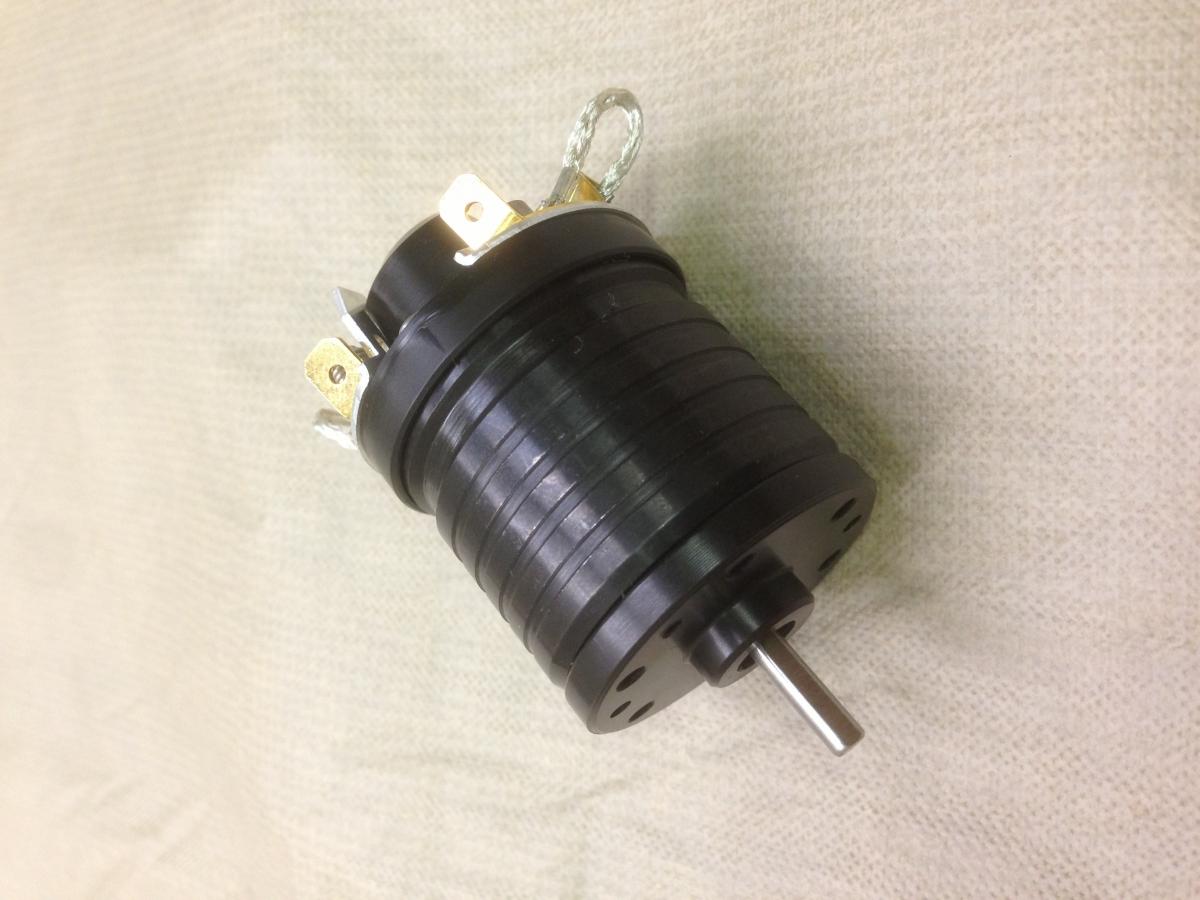

The next improvement is just in the looks department, but looks matter! As shown here, we have begun working with a company to bring anodizing and better can finishes to the mix. Costs more for us, but not for you! You will find the deep black luster on all Pullers cans from now on, and we will be offering anodized parts very soon. What colors do you want on the faceplate?
