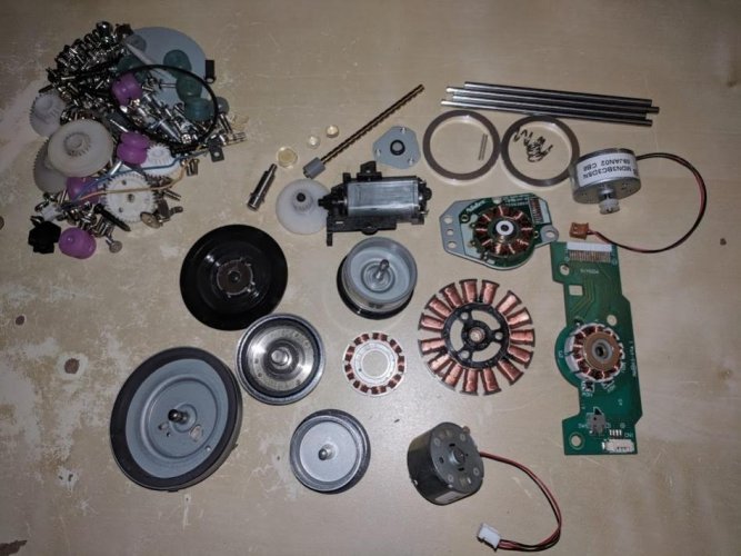

BTW - wanna see some weirdness?
All the below parts are from a hard-drive and a couple different CDROM / DVDROM drives I disassembled today:
Interesting bits of electric motors used to spin platters, move read/write heads, retract CD disc.. and the actual hard drive platters, and attached to the zinc-plated pieces in the platter pic are 2 SERIOUSLY strong magnets...
Still have another hard drive, and another entire PC to disassemble - I also have some other metal bits soaking in solvent.
These 2 PCs were extremely old, to slow for anyone to want - or even to pay a decent price for the bits and pieces.
I'm definitely keeping some parts for use in projects, and the magnets work great for magnetizing driver bits / nuts & bolts...
I work at an electronics recycling company, have a bunch of those magnets, as well as some similar strength but much smaller rare earth magnets salvaged from iMac bezels.... really handy to have around
