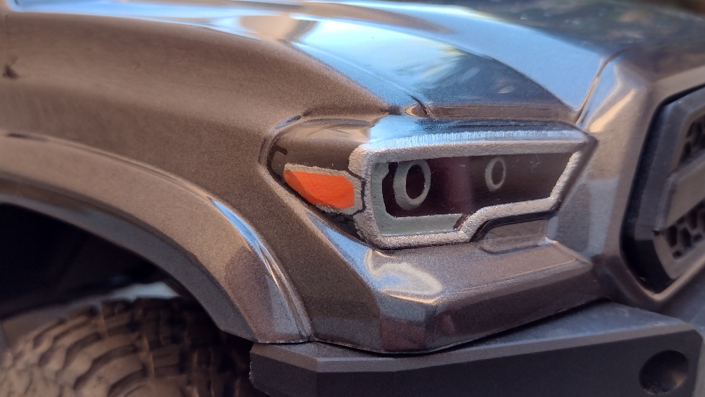

Knight Customs headlights painted. I wanted to fully chrome/silver the inside of the housings but wasn't doable for me so I just chromed the border only. Light shrouds and stock DRL are a light blue, and the turn signal is an orange paint marker.

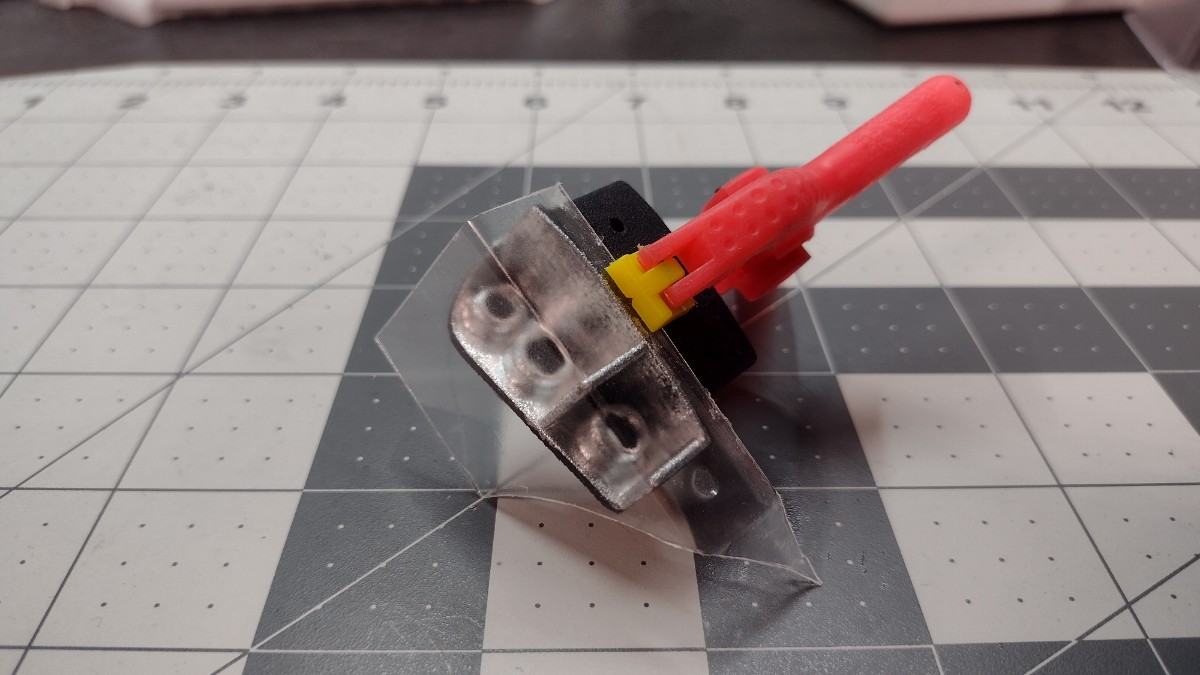

And the taillight buckets. I want to avoid seeing the LED holes and I'm always shooting for that OEM look, so here's a take on an idea I had with scrap lexan. Idk whether to buff the lexan for the reverse lights so it gives it that lens reflector look on an actual taillight, or diffuse some silver paint and brush it on, or both methods? I plan to make another lexan piece for the brake lamps anyway and both pieces will then get E6000'd.
But as for the brake lamp lenses, I will paint those a transparent red and probably do multiple coats until it's barely transparent so you can't see the bulb holes/LED.
Wow, those headlights are stunning! So is the hood scoop as well! Good job dude!

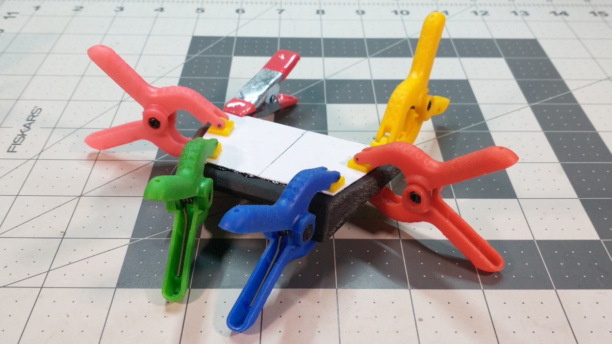

Few tips I learned from this. The clamp method I used without some type of flat brace to equalize the force holding the styrene down caused waviness where the clamps were. Also, I should've used a non flexible glue that is more friendly to sanding. So every time I sanded and met E6000 at the surface, it would disrupt the putty around the area. Newb life.

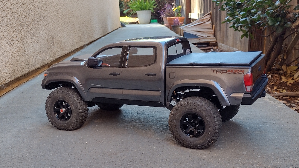

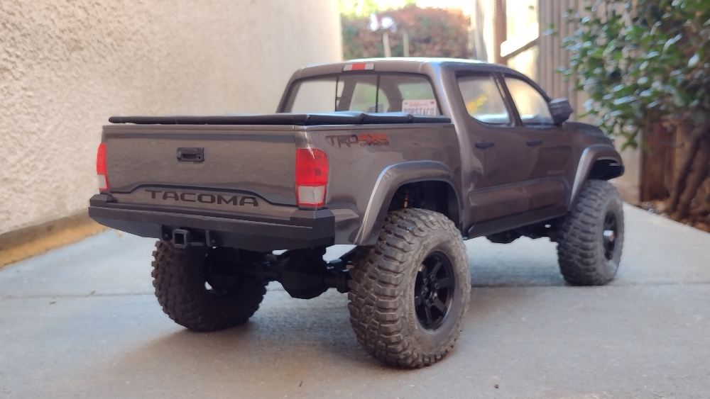

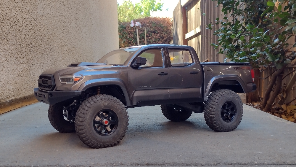

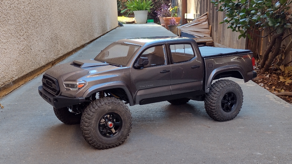

Full body shots:
I'll get to work on redoing the scoop this weekend.
Love how the hood scoop came out! Looks so much better than it did when it was stock.
Them taillights look great! I've been debating on painting mine instead of using a decal. The E6000 on the headlight is barely noticeable. I had the same problem on my grille tabs, so I just used E6000 on the center of the grille instead of near the headlights.
Great full body shots! The stance looks spot on! Great job on the build so far!"thumbsup"

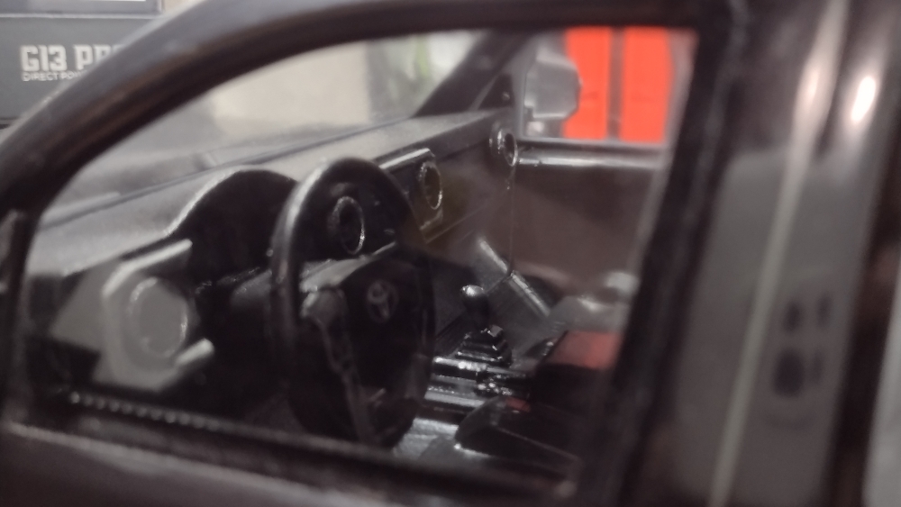

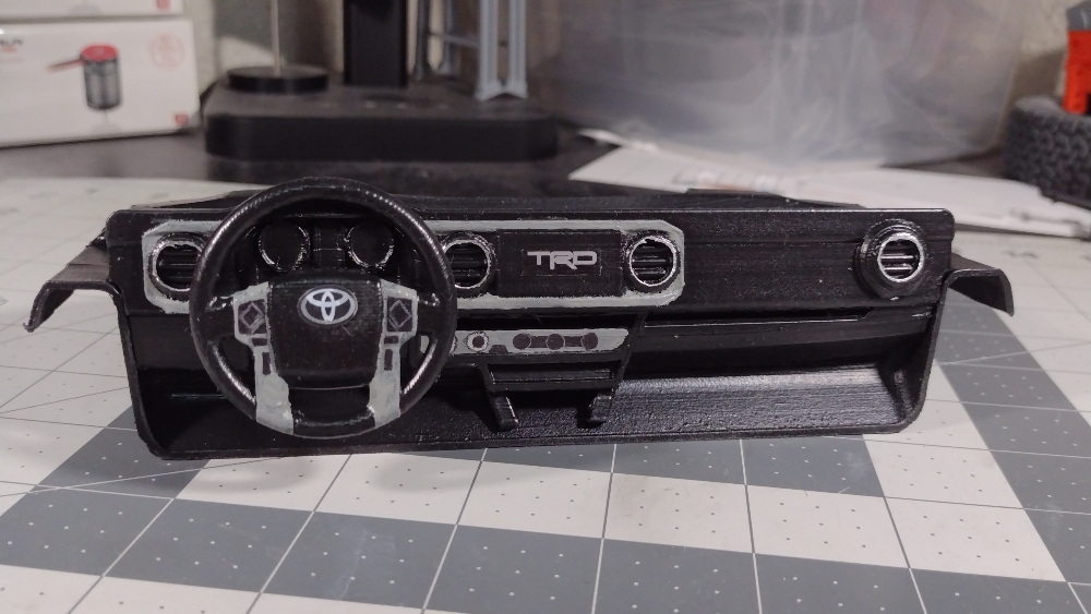

Shout out to @tigris99 for printing me the KC interior!
I wanted to find a fabric design similar to the seats my dad has in his Tacoma but I didn't search very long. I just Plastidipped all the interior pieces to try to keep the print lines to a minimum and detailed the dash, called it good.

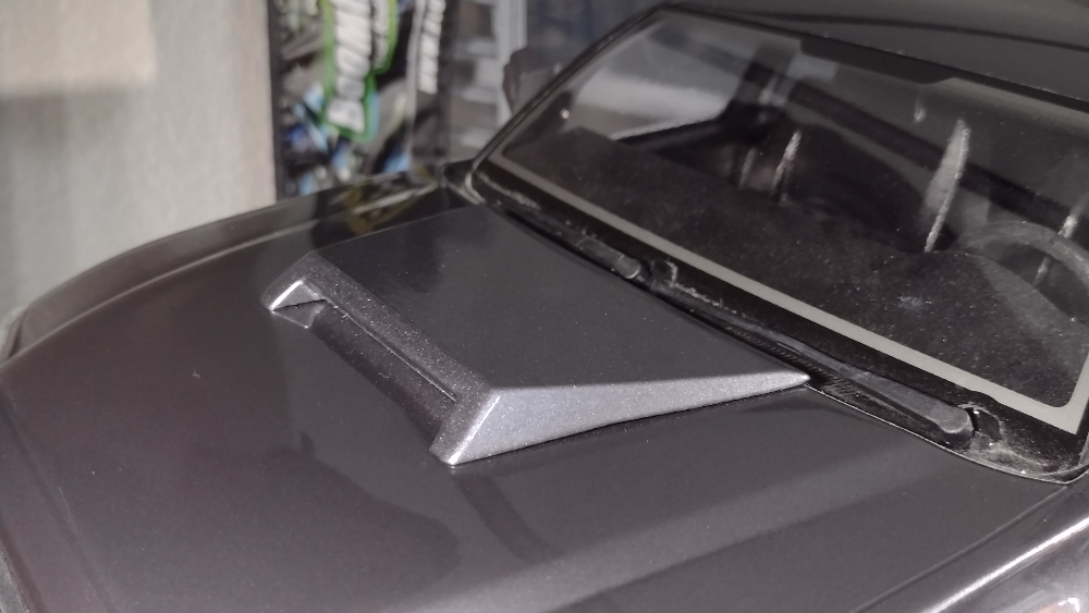

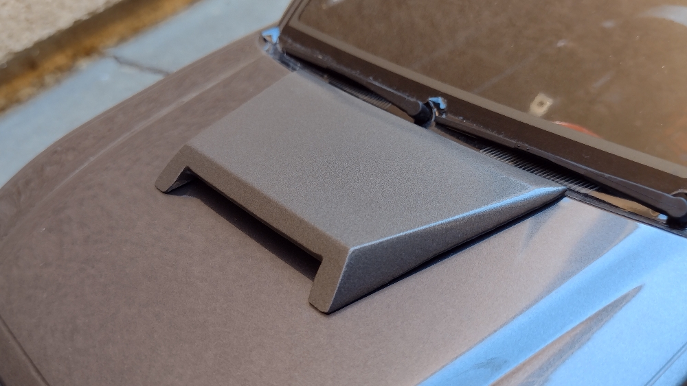

Hood scoop is in it's final form! I tried Tamiya metallic gray first, way too much flake. Threw on Tamiya gunmetal next and it's as close as I think I'll get it. Still not perfect but it's at least half better than my first gunmetal spray.

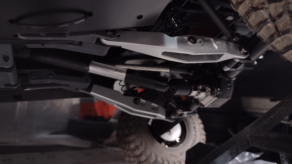

Stumbled upon SOR's aluminum trailing arms so why not throw them on.

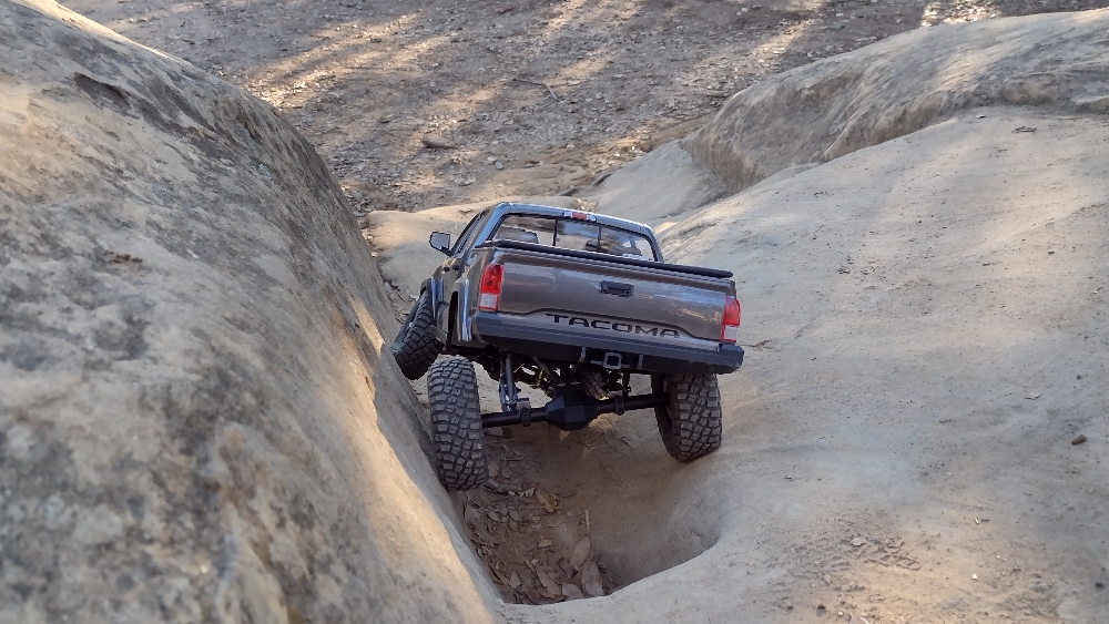

I took this and 3 other rigs with me to a meet at Mt Diablo in Walnut Creek this past Saturday. I am complete ass at getting footage so I didn't even bother. I did snag this picture though.

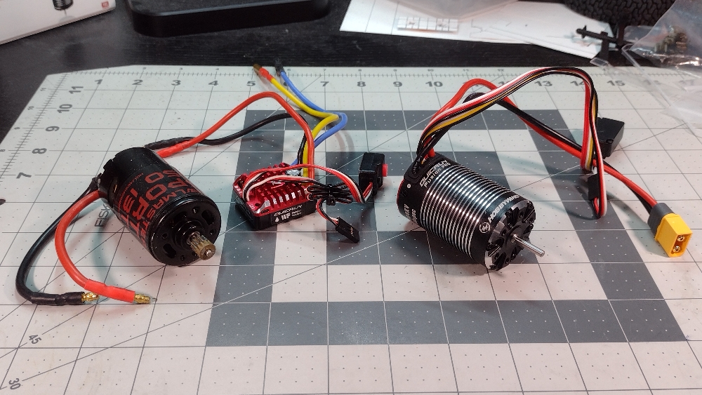

And last but not least, even though the ol' 1080 and HH brushed combo did it's job, it didn't have that FOC technology that the Fusion Pro has. So my spare went in. Such a night n day difference.
