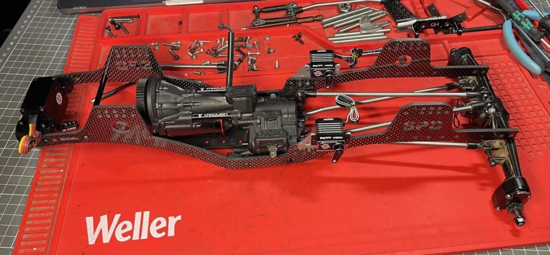

Nice build. Do you think the vfd twin transmission and skid would work/fit in the gspeed v3 chassis?
Easly, check out my thread here in the 1.9 section named the bama phoenix. I used the vader skid, but ive got the vfd twin mounted in the blue cf v3 chassis
It fits the same as the standard vfd. Just gotta find a place to mount a couple servos...
