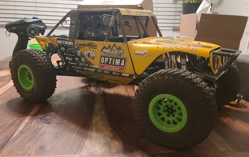

I got the front axle back together, flipped the differential and filled it with Silly Putty. I tried to Silly Putty the rear, but stripped hardware prevented me. I just locked it permanently with a zip-tie.
I got the truck all put back together with the new skid plate in PETG. I had to shave less than 5mm from the driver's side rear to make clearance for the rear driveshaft. My half-round file made short work of that.
No more shift servos, no more huge transmission, no more engine housing & no more interior. We'll see in the next few weeks how this set-up holds up. From the outside of the truck I don't really notice the missing interior.

Looking good. I can't quite tell from your picture, but does this look like about where the notch you filed needs to be?

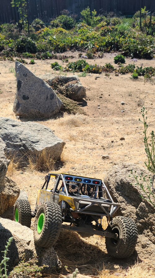

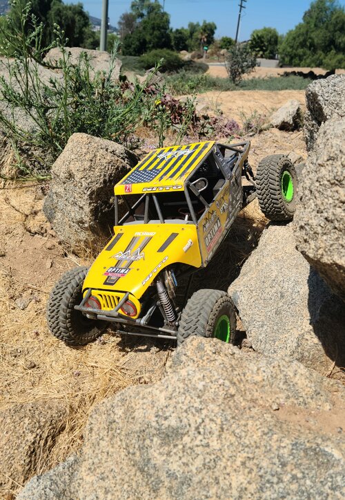

Performance? I drove the "new & improved" Miller truck today for one battery. In the upcoming election, I'll be voting for BGRedjeep as his skidplate has made my Miller Motorsports great again! It's once again a lot of fun to drive.
Less overall weight, and the biggest weight is all focused on the skid plate. Even with the rear locker only partially functioning, the truck handles chunky rock sections surprisingly well as long as you approach with and maintain momentum.
Given the larger size, scale looks and fun performance I suspect I'd prefer this set-up over an H10. That being said, there's no way I would buy the Miller Motorsports over an H10. They're the same price, but the H10 is rad looking and performing out of the box.
