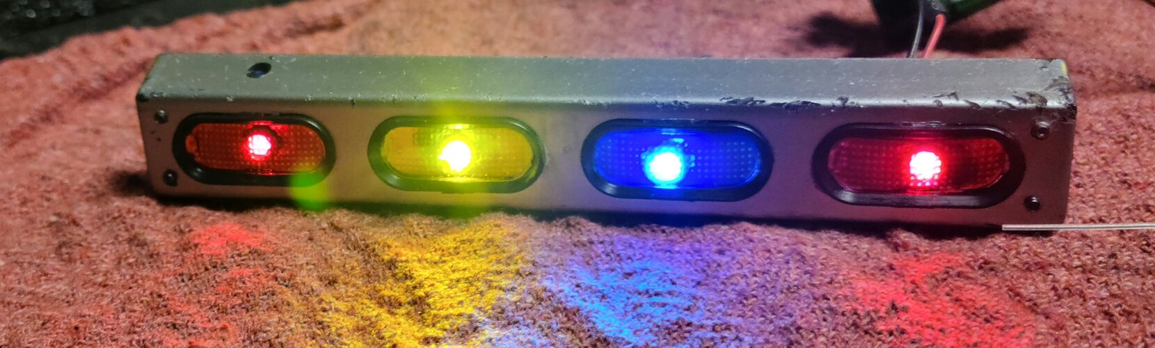

I painted my rear lightbar lenses. The stock lens color was too dim. The white LEDs blew through the color & looked pale.
I used Tamiya clear red, yellow & blue. This lightbar is a reference to when Ultra 4 trucks were required to run one rear facing amber and rear facing blue light. That was the era during which I got into watching Ultra 4, so this lightbar is painted to remind me of that.
