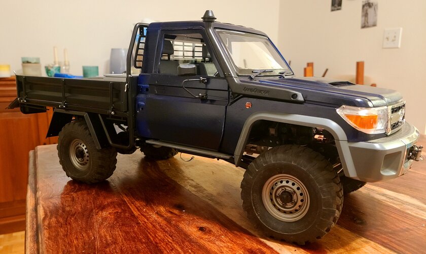

Two firsts for me; my 1st 1.55 wheel build and my first hardbody. This will be my most scale, and most challenging build yet. This is as close to scratch building as I've ever gotten, and it's still not scratch building!

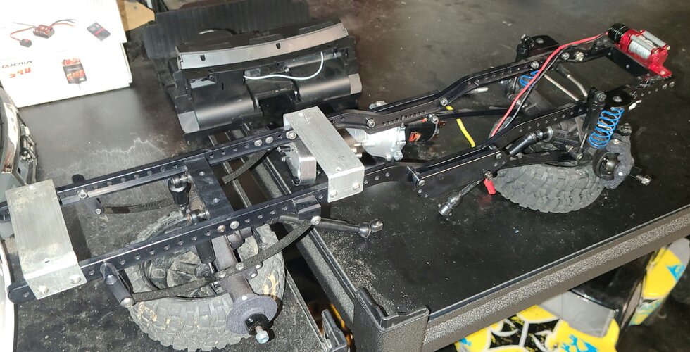

I scored this GCM LC70 chassis & body from Mudbeast in a trade for my old LMT.
I'm currently planning for a different bed, different color, different tires... and I think that's it.

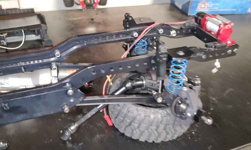

This truck will be driven and expected to perform like a full-size LC70 that showroom stock, with nicer tires. In case you didn't notice, scope the machined radius arms at the front suspension. I think the chassis is my most exciting part of this build.

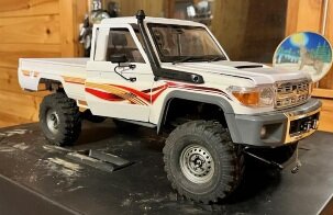

For reference, here's a photo of how it looked when I got it:
Electronics not installed yet, body assembled in white, and a few unfinished odds & ends.

I assume those radius arms and axles are from GCM?
Looking forward to what you come up with.
Thanks. The arms are sold by GCM and come with their CMax LC70 kit.
The axles are the NCYota 157mm housings from Bowhouse's Shapeways store. Bowhouse designed them to be used with the LC70 chassis, so GCM recommends them.
Fortunately for me, the chassis came as an unfinished roller that just needed some finishing.

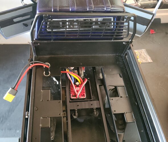

I made a satisfying amount of progress on the LC70 tonight. After two trips to the hobby store, I scored several bits and bobs. Most notably, 3 cans of Tamiya TS-53 and some Tamiya Fine Primer.

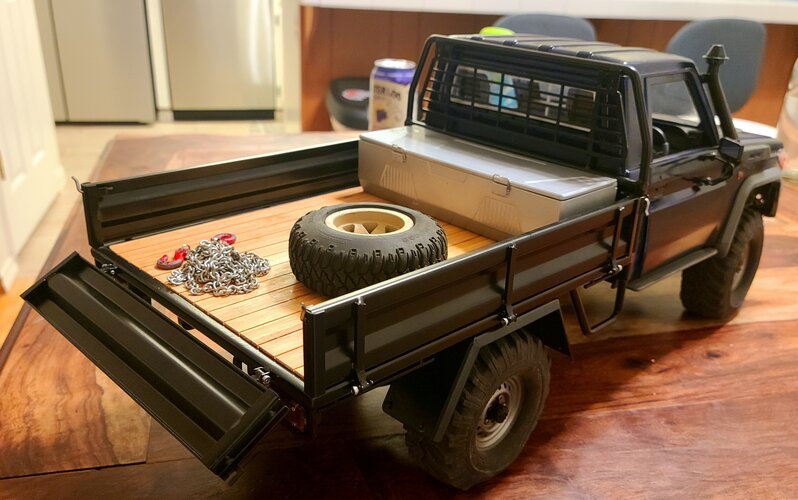

My new bed also showed up 1 day early; the CC Hand Kober bed for the LC70 body. It's designed to fit the TF2 chassis and I figured that would give me problems. This bed is nice! It's all steel and wood.
I thought mounting the bed to the chassis would be hard, and mounting the bed to the cab would be easy. The inverse has proven true.

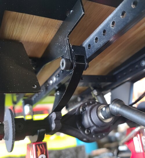

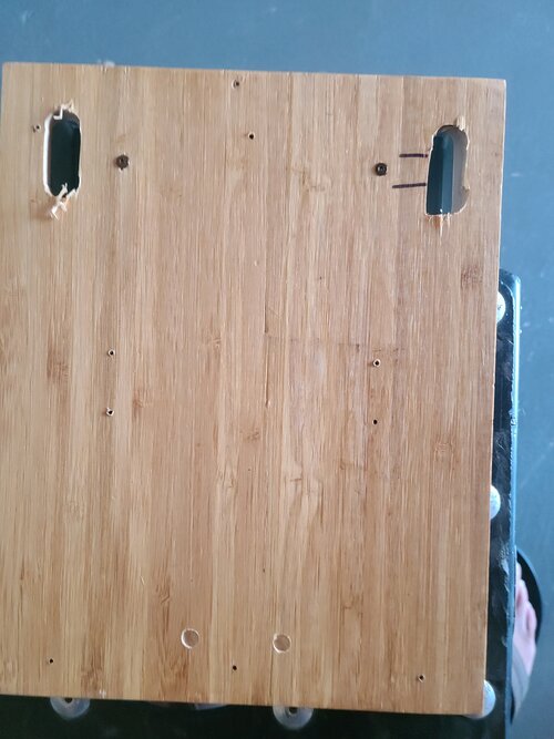

The front mounting tabs which secure the bed to the chassis align perfectly with the front leaf hangers for the rear suspension. I had to open the bolt holes up from 2MM to 4MM.

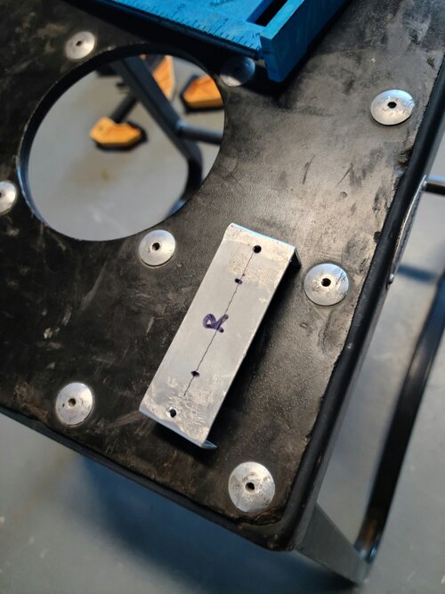

That left me with only needing to figure out the rear mounting. Fortunately, Mudbeast included an aluminum brace he made to mount the stock bed. I just needed to add new holes to that brace, new holes in the bed matching those and voila! She's on! A couple of spacers under the rear of the bed get my bed nice and level.
Now I have to figure out how to mount the cab to the bed. I figured that would be easy, but that's going to be difficult. What I may do is just mount the cab to the chassis instead. I know these GCM chassis are designed to run SCX10 sliders. I may try to get creative and mount the body to some of those.
Paint and finishing is a ways off. I have a decent amount of structural work here first.
And boy is this type of building neat! I'm still far off from scratch building but this is way more fun than opening a box and installing a battery.

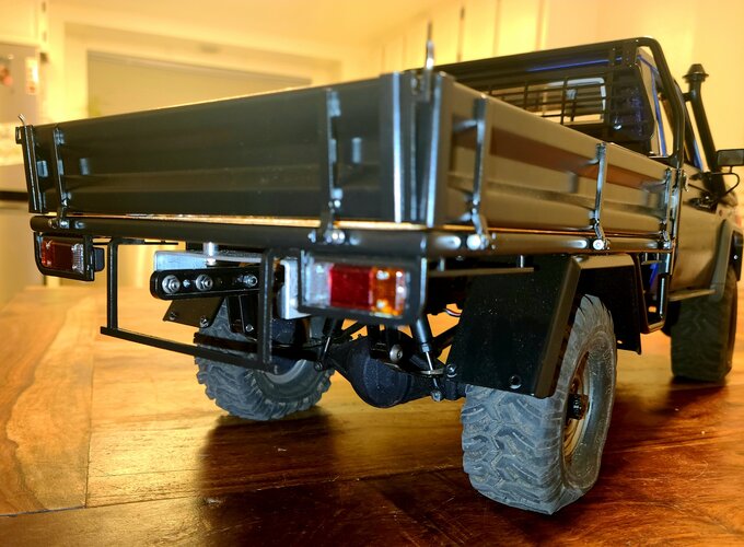

Just the radius arms give an unmatched look. I did them for my LC70. Flex better than I've expected. Downside is that they only accept just one shock length

By the way, when I said mine "flex better than I've expected" , I didn't say it flexes much :) . But it is enough for the build
