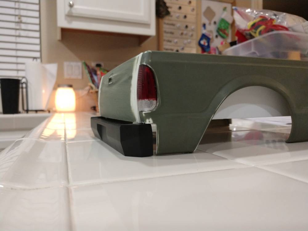

Gonna get back on finishing the replacement bed ..got fine tune the tail light openings.. don't know if I should just mount the rear bumper to the bed or chassis. I also want to make a functional rear hitch. I already have the ball receiver from gearhead rc

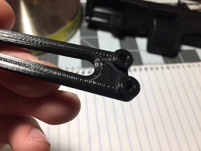

Okay, so I have redesigned the arm to include a ball end. The ball I have measured 6mm in diameter and it is 6mm wide with a 3mm hole. The thickness of the arm is 4mm and has a 50% honeycomb fill. It is super strong.
Wow that looks ****ing awesome..
Sent from my Moto Z (2) using Tapatalk
I had to reduce the width of the arm to get more articulation out of the ball end but I assure you she is strong. Do you have a side pic of how it will mount to frame and axle? I want to make sure it will bolt up. It is 6mm on ball end (may need to shim and 6.25-.30 on the axle end.
Just noticed only problem is the front mount.. it has to be open. See the picture. Unless u are able to make a axle mount for ar44 style axle
Does the front mount to the axle from the outside? My arm has clearance hole for M3 screws.
