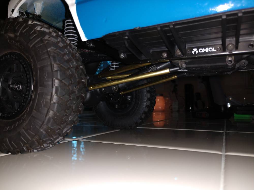

Thinking changing the front 4 link out for leaf springs. I have another pair of leafs the RC4WD hangers. Just need another pair of gcm perches

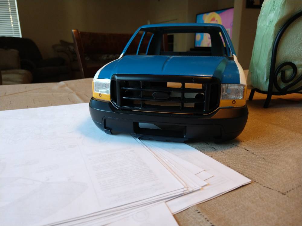

Got the lenses installed and painted. Also grille is cut out to
