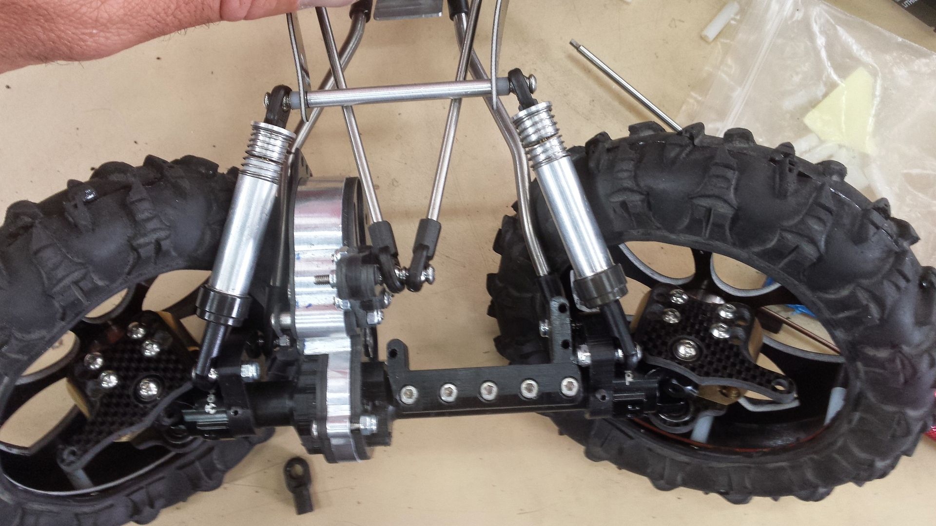

This build is very familiar in the way that its a cross between my 2.2 and my super. I feel like I am using the same ideas and parts, just slightly different sizes of the ideas. The tires and wheels will be no different.

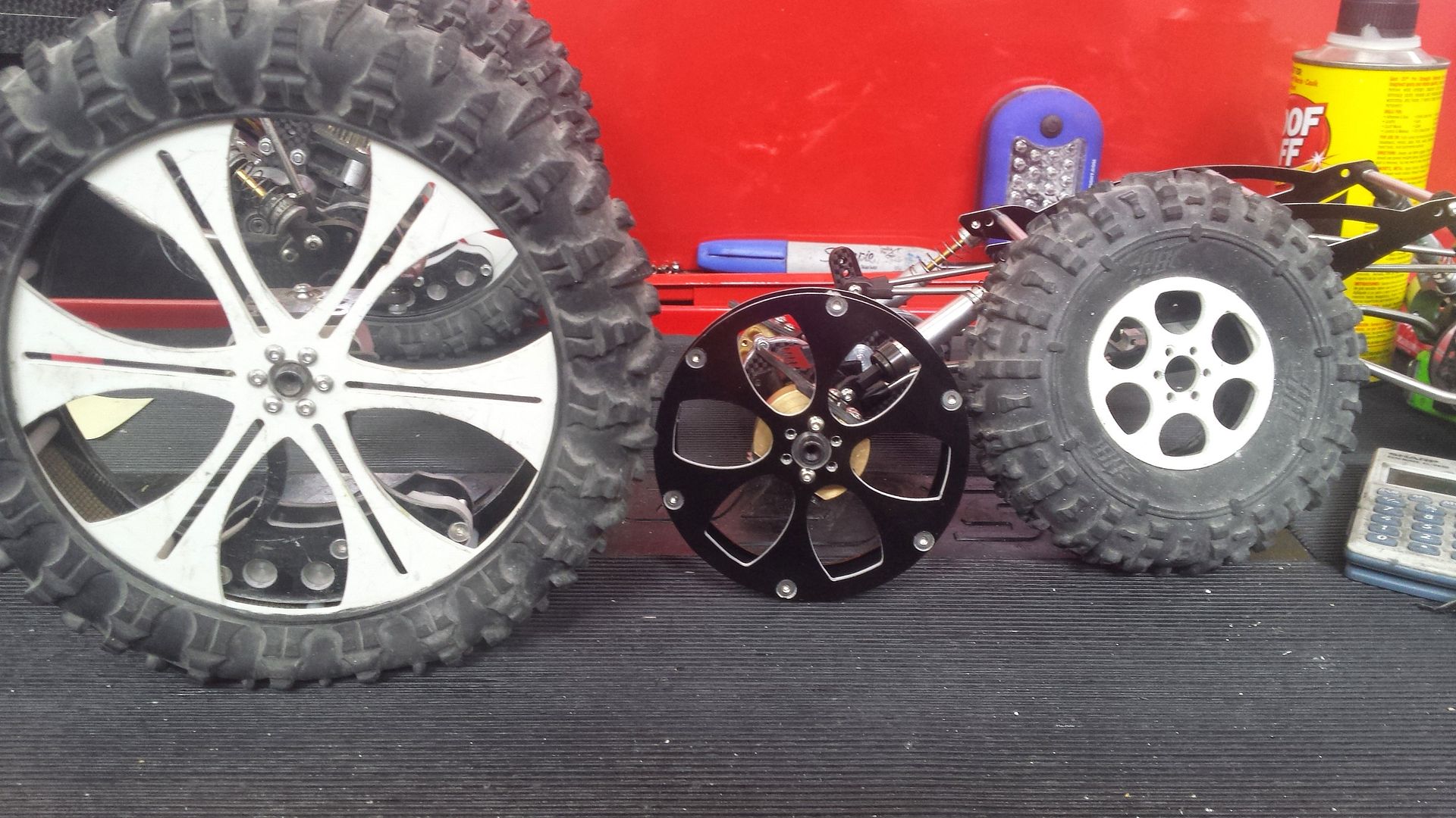

As said above, wheels will follow suit of my new style super wheels that I made not too long ago. These wheels for this car measure 4". Thats the same size as the full size supers use if using a Trencher side wall. That should give some perspective as how large these things really are.
You will also notice that the wheels are black vs. my white that I love. My supplier is not around at the moment so I will have to make due. Pretty bummed about this.
Mega super, mini super, 2.2. As said above, the mini super size is the exact same as the "standard" super wheels I have made for a couple years now.

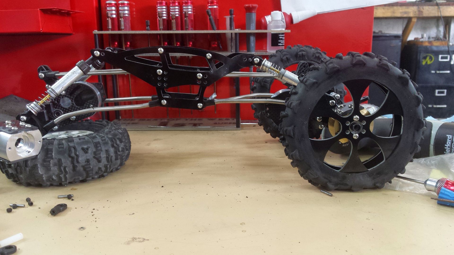

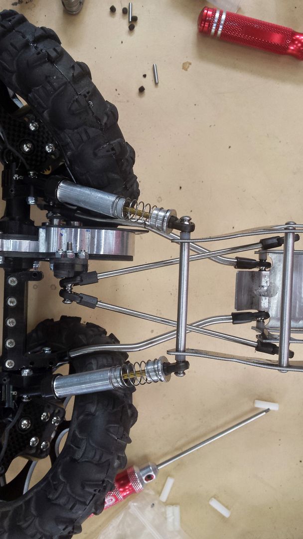

I spot glued the tires on the wheels and got it all mocked up.

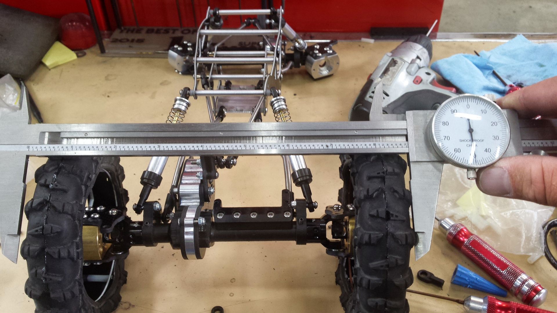

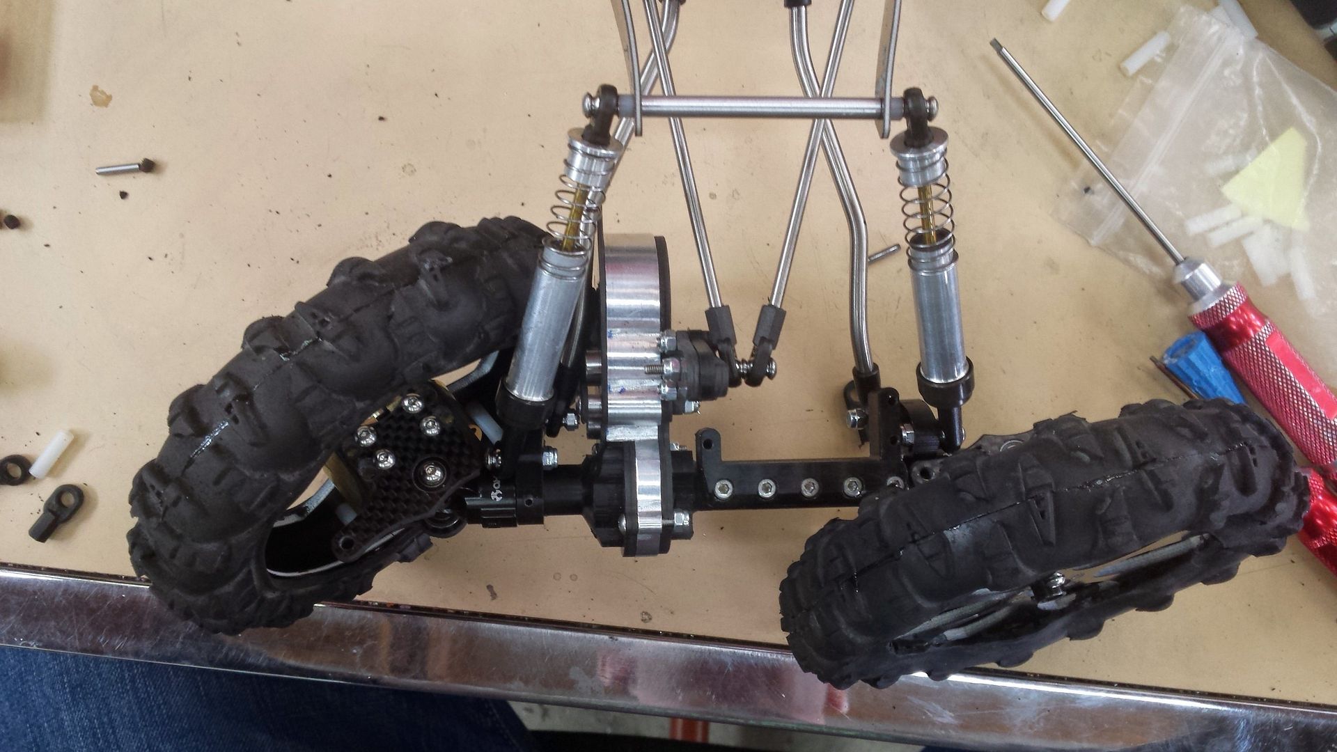

With the current config, I can get to approx 8.5" on my narrowest hub setting. Right where I was hoping.
Num, num, num....

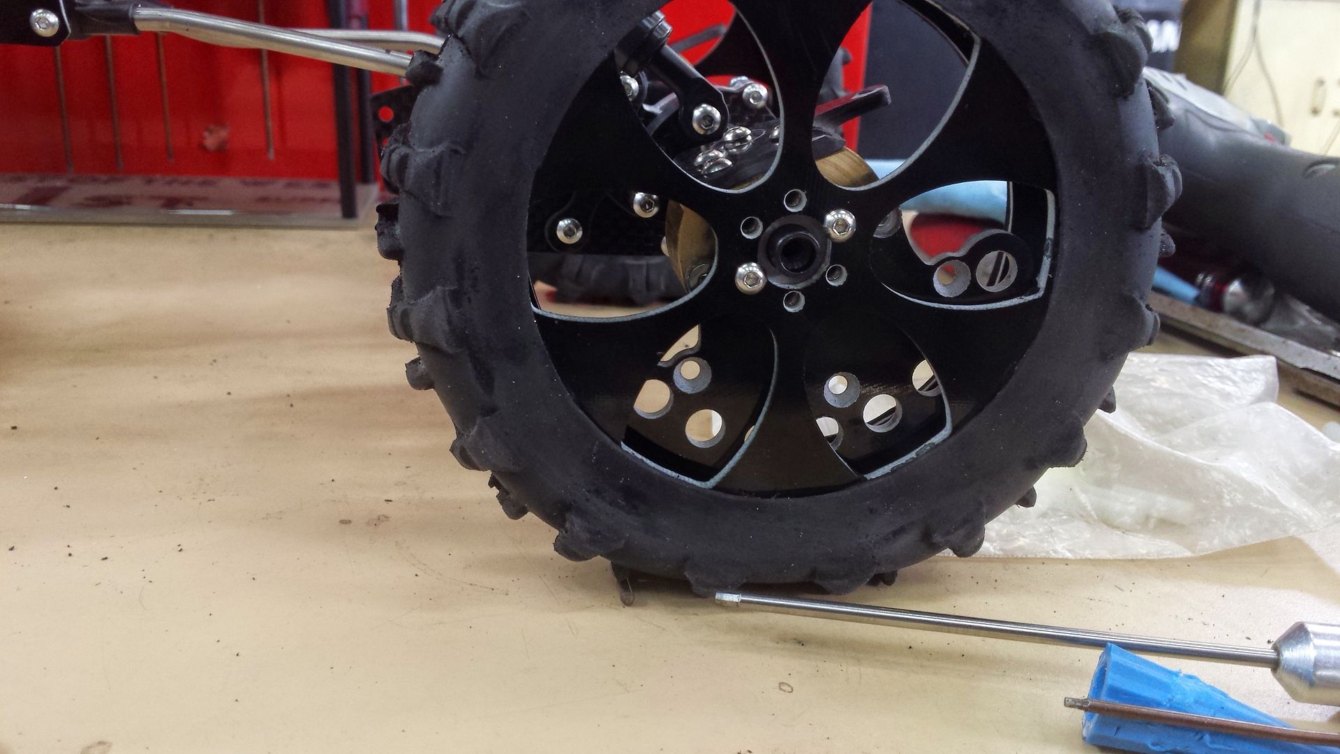

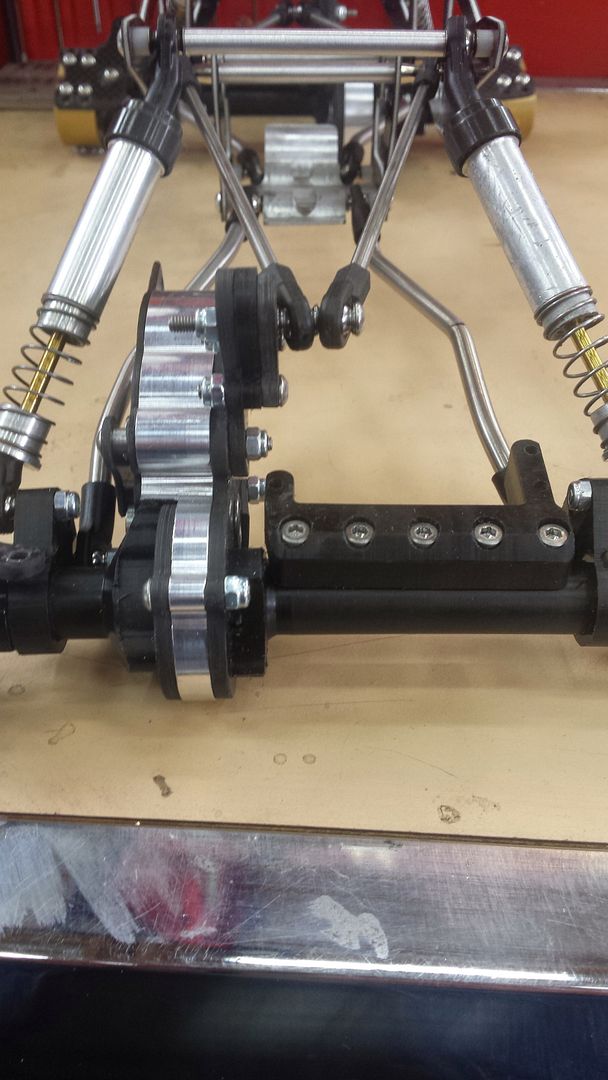

Might be a bit tight and too much tire rub. I was hoping to leave the inner lugs but looks like there will be too much contact if I leave them.
I am using my stainless 0 offset hubs. They are pretty sweet because you can basically get 2 hubs for the price of 1. All you have to do is flip it around and it makes you wider.
Here is a bit wider with the hub flipped. Just about 8.75" but dont take that to heart. I dont think I got an actual good measurement out of it since I dont have inner shafts in yet and the stub can flop around a bit. It will be under 9" though, probably what I will try and run with so I can get some good steering and stay under 9". I at least feel its good enough to finish the shafts, steering links etc,. and not worry too much about major changes.

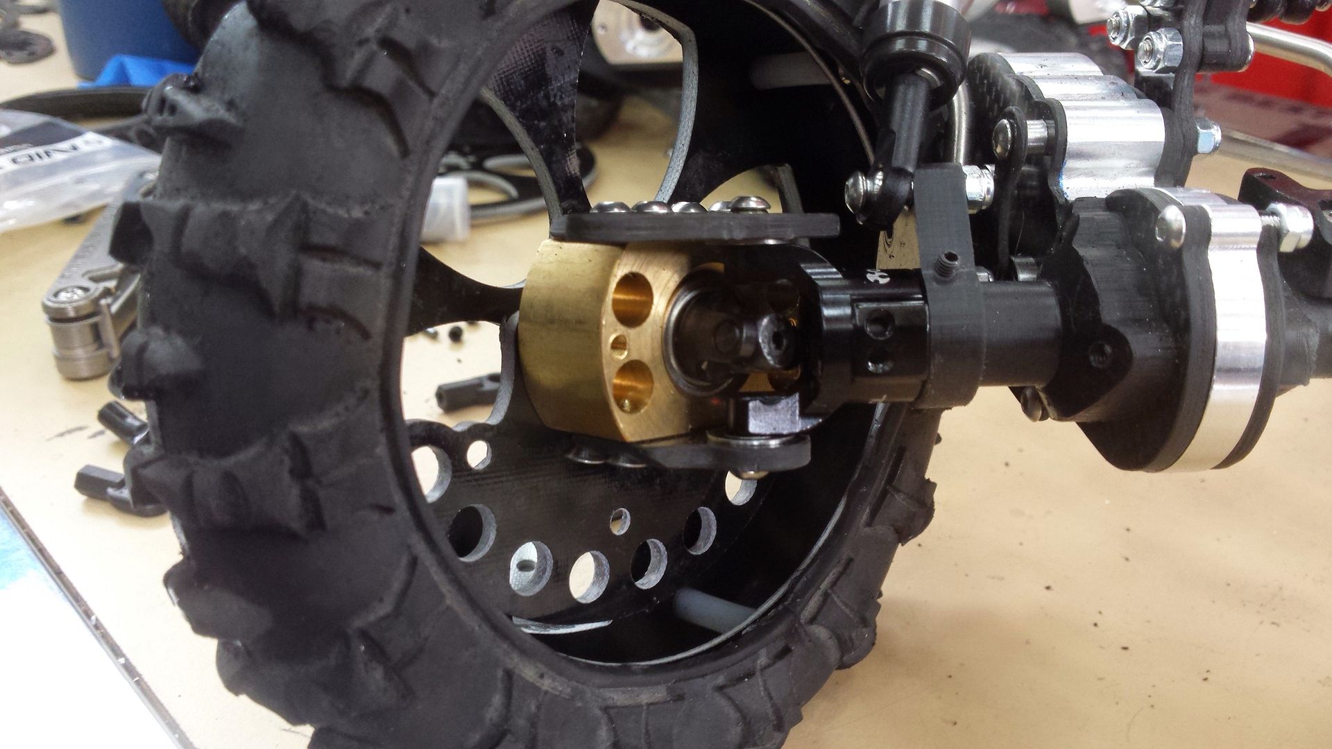

I got a good start on the knuckle weights. I will probably run some rear weights too, just need to make those up. Maybe they will just be the same design? Not sure yet.
