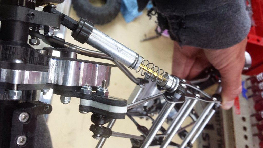

Could it be worth trying to make the link mounts go over the chub a bit to be able to narrowing the axles a little bit extra? Or make some new chubs with built in link mounts? You should be able to save 3 mm or so per side I think.
There are ways to get narrower. My fear is that it wont matter though because the limitations should be the gearbox and motor. If they are not limiting like I think they will be, I will go after more savings on the tubes.
Just incase anybody else is building and wants ideas, there is quite a bit that you can probably see on the short side that can simply be cut down. On the long side, I considered inserting a brass insert into the link/shock mount so I could eliminate the nut and move that over or, thread into the servo mount. Also, on the long side you could trim the tube flange down, move the servo mount over and attach the servo mount straight to the gear box.

Its not really the 1mm that I would be after, its the 3mm on the wider part thats more appealing. The 1mm is just bonus.

No idea. Just as tight as possible. If my math serves me, I am down about 3/4" now and I can get about .350" per side off with hubs for about another 3/4" so, if I can fit all of those savings, thats 1.5" total off and if I use my current 2.2p tires, that would put me around 8.5", which is where I want to be. I am not counting on it. Just counting on "as good as possible".

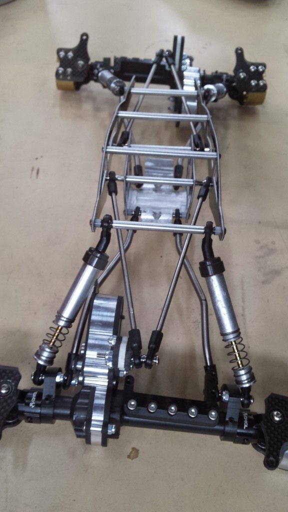

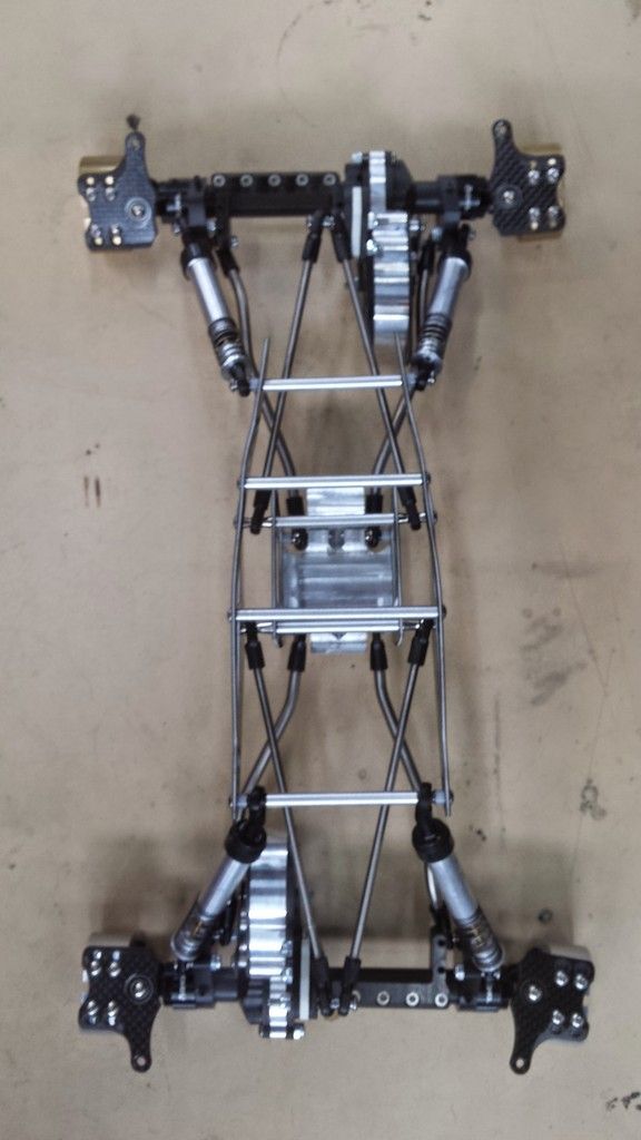

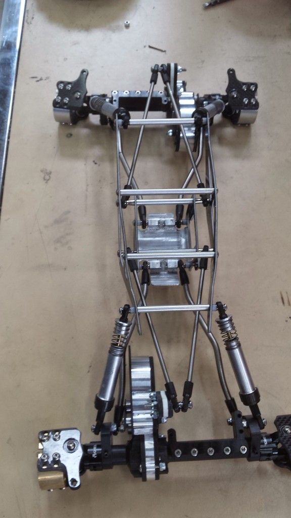

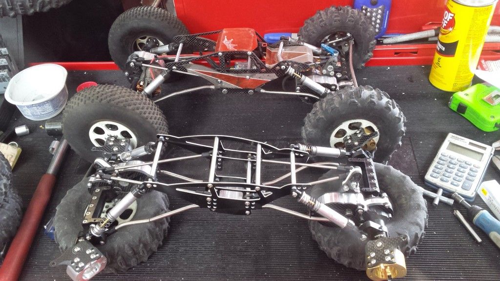

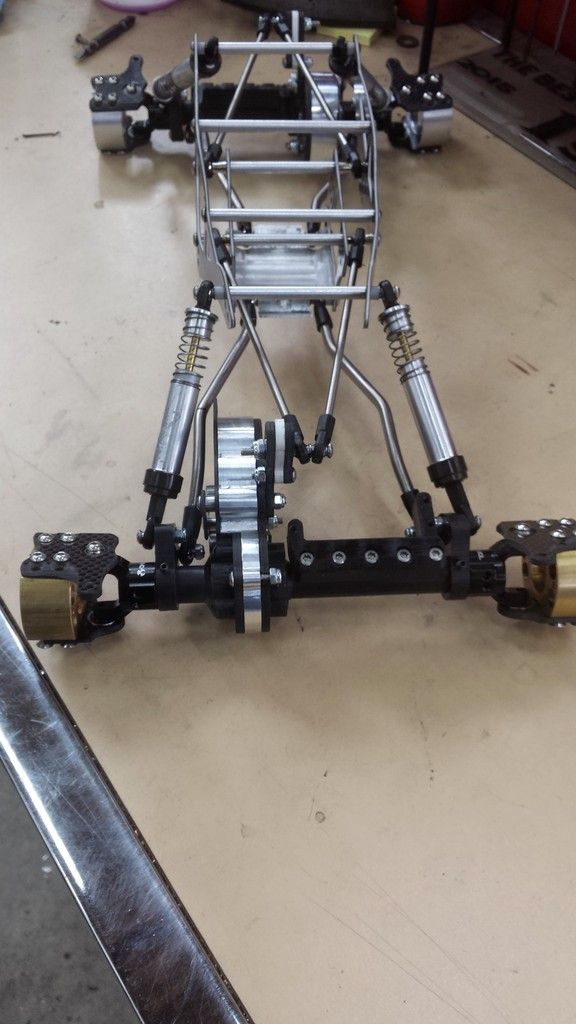

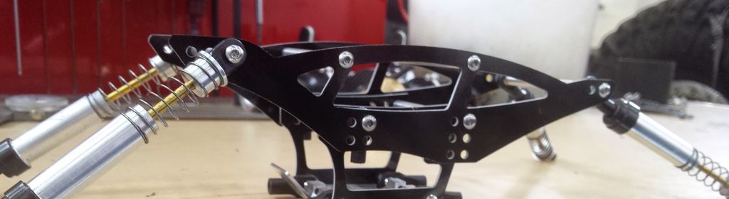

Chassis is done. Should be moving right along now as links are easy and then its just a bolt together affair.
I just made the chassis as simple as possible. Its 1/2" shorter than the 2.2p version so it should drive upside down nicely.
This build is going to lighten my bank account! :flipoff:

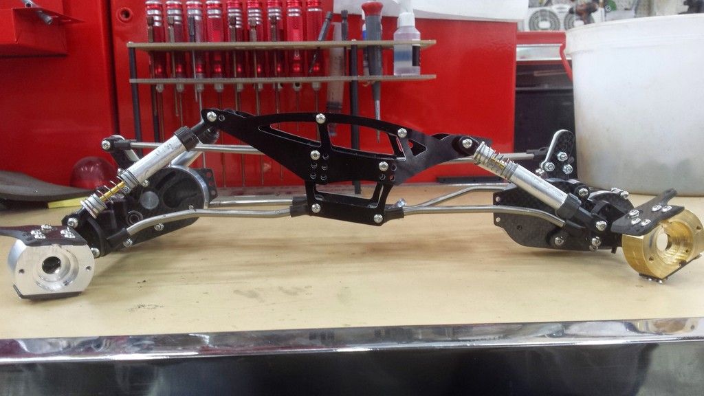

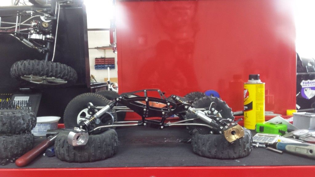

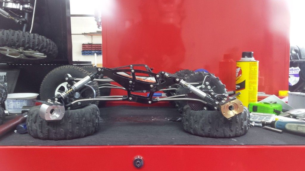

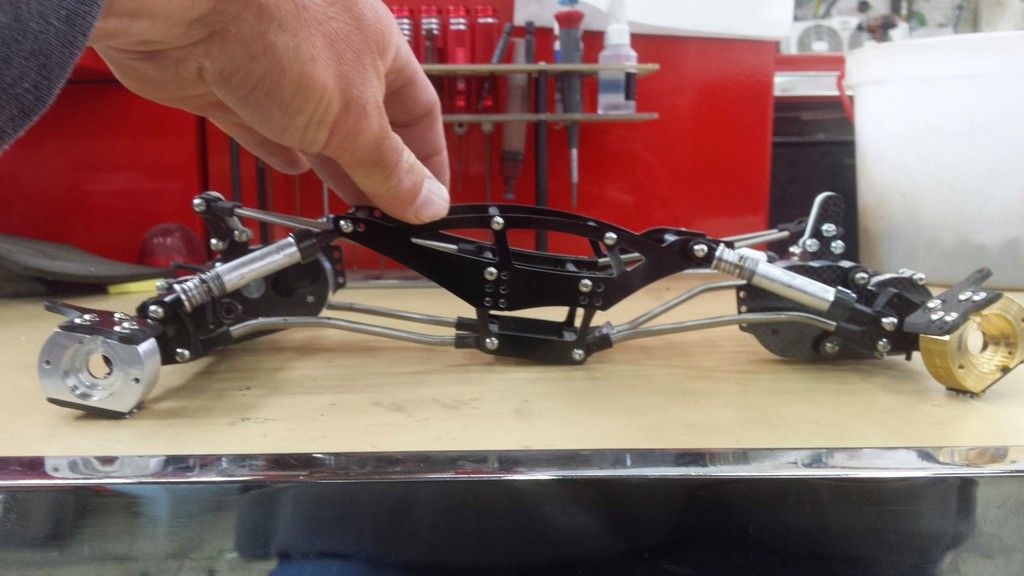

Not quite full stuff, belly hits the table before shocks can fully compress but, its close
Full extension

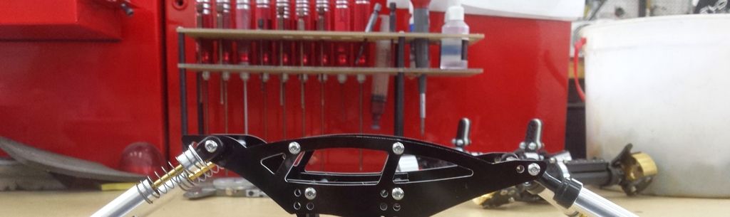

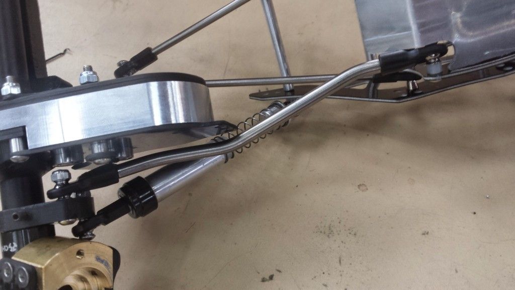

And I guess this is somewhat ride height. Springs are feeling stiff so I may need to work on them a bit.
Clearances are somewhat tight. I think I could milk another .5mm if I need.

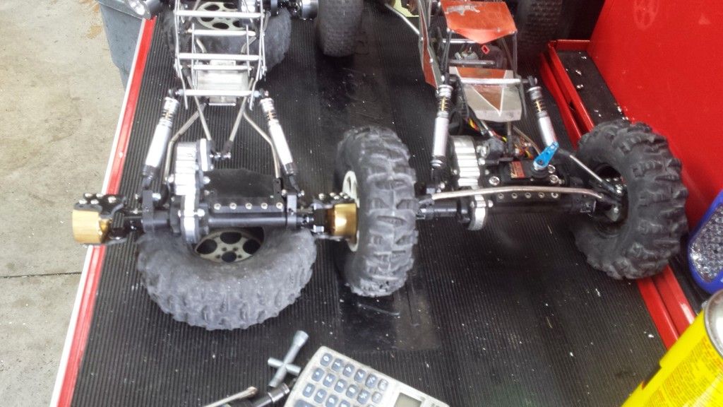

Yeah, I will get one ASAP. Other than the chassis, its not that different. Pretty much my 2.2P car with a different chassis and rear steer.
