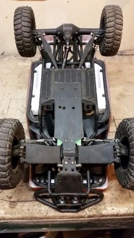

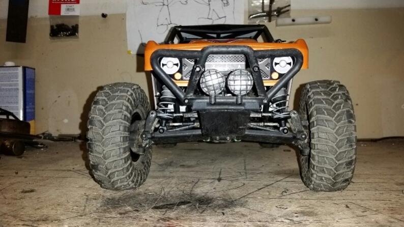

An hour with the portaband, drill, and some beers....voila! Pretty solid. Now it runs full twin hammers running gear. Gotta try to find a way to utilize the trailing arms still.

Just move the fronts of the trailing arms to the outside of the chassis so they are parallel. They'll work better and you'll still have triangulation from the rear uppers. Just a thought.

Thank you very much!
Good idea!! I'll give that a try. **Edit** Won't work with the hammers rear end. The link mounts are too angled. Maybe once it gets the currie rear axle I will give it a try.
ScaleReady, When you do this, you need to make some sort of a double sheer mount for the trailing arm to mount too. Otherwise you got a hang up point and the bolt is venerable to get bent.

I may attempt something similar to that. Maybe make a boatside to help the transition"thumbsup"
if you need help mounting shocks to the chassis to use the trailing arms pm me for pics of how i did it. im working on a trailing and leading arm rig using wraith chassis and twin hammers trailing arms. dont wana thread jack haha
