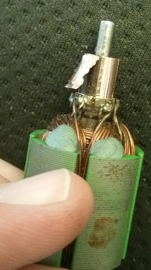

So i get to the front motor and find this.... a big awe crap. The other two segment gaps are a little damaged but not this bad. Im surprised it even worked still. Anyways. I had a set of 5 slot 16t that i threw in for Worlds...... not the best scenario but the motors are similar only thing I've noticed so far is the light drag break and holding power as i dig on a steep incline. Gotta keep that rear pressure on with my right stick.

Thats nasty and the timing is disappointing. I'm running 16t in a couple of scalers and the start up is smooth and they have lots of power on the top end that should work for you. I've thought about 16t motors for my pro more than once I'm running 13t HH Pullers currently. Good luck at the Worlds. "thumbsup"

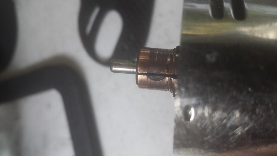

Ive been having a bit of motor stall latley so i figured it was time these 16ts got a freshen up before BOTW..... this always seems to be my down fall. The motor needed new brushes for sure. One was broken and im sure the spring had a tough time applying pressure. The timing ring was bent....... no problem i got a spare in another motor... cut the comm.... looking beautiful mirror finishon my very last pass.... something to write home about... BAM! The edge of one segment bit the tool and........ugh
