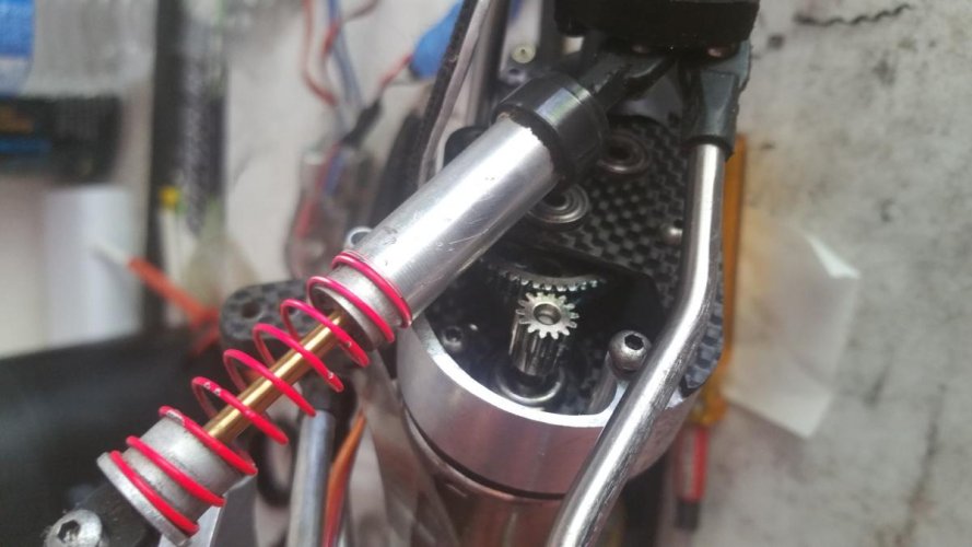

Its been a lot of prep and updates headed into the RC Rock Crawling Championship, nothing major but updates and maintenance. I got some new lower rear links that should give me a touch more breakover. Did some shock and upper link adjustments and found a broken pin in my HH hv500. (That was quickly replaced by some fantastic customer service at Holmes Hobbies). The motors are back to 16t with new armatures front and rear, plus a new set of BRminis. Car feels smooth as silk. The gear boxes are a bit quieter too with a brand new set of SAF gears from Dlux using the standard 48p pinion soooooo nice and then brand new bearing throughout both cases! This rig is ready to rock down south and couldnt be happier. Here's a tiny tease of the new gears inside the cases.
