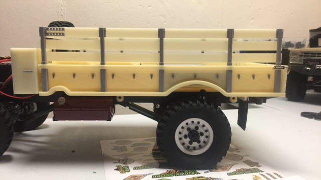

The leafs seem nice, but I won't be able to give an accurate assessment until its first run. They are a bit stiff, but it's a truck.......
As far as design flaws, I haven't really hit any snags yet except for some machining issues on the bed that were rectified with sand paper.
Overall, I'm very happy with it so far. The bed is getting a few coats of paint now, so it won't be long before my first trial run.

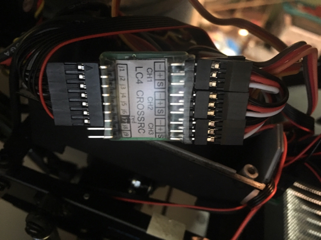

I take it that you have the exact same light controller as i do with PG4.
I had also problems with the head lights, but i tried to connect the headlights in to different, empty socket in the light controller and they began to work. Markers i didnt use so i wouldnt know about those.
I think the problem is, that there must be wrong socket in the instructions i recon.
What comes to Cross-RC's customer service, i woulnt keep my hopes up, but as i bought my PG4 from Greens Models, i had excellent customer service from there.

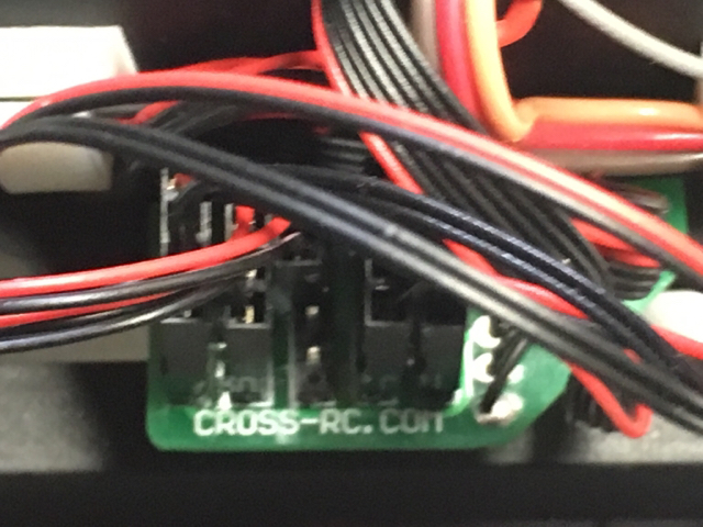

Here's the board the lights connect to. No empty slots. The 2 on the left are for the headlight/marker lights, the one in the center is the roof lights, and the 2 on the right are the tail lights.
Is this the same board you have?
Upon further testing, the lights are good. I plugged both headlights individually into the roof light plug (center) and the headlights came on. So, it is either the controller or this jumper board......
That what the main control board looks like inside the box. The one I pictured is just the jumper board. The main control unit connects to the esc and servos and then feeds this jumper board. I'll take a picture of it later when I get home.
I think the problem is here.....

Oh, thats interesting. PG4 doesnt have that jumper board, only the main light controller where everything is connected.
