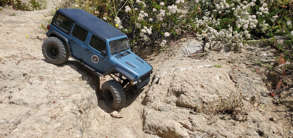

Finally took the SCX10III out for a run! The SCX10III Jeep JLU has such a nice body that I didn't want to trash it right away. So I drove it a lot more deliberately and carefully on the way up El Modena's technical side. Given the stock tires and foams with the heavy body, it actually did better than I expected. Next will be to try changing up the tires and foams.
