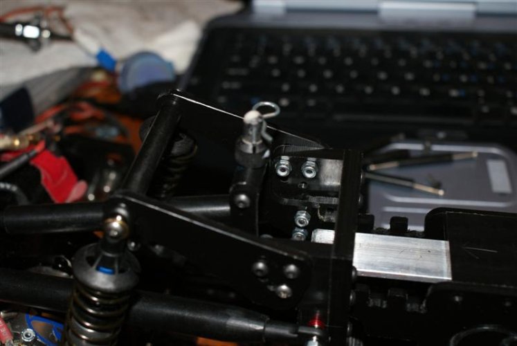

Finally got the most important part finished.

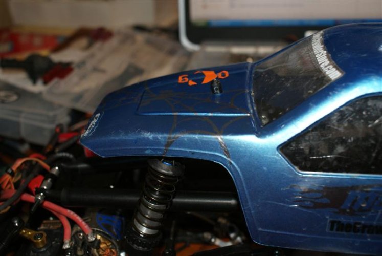

The body mounts...
I tried the easy way out with side posts, but upon test running I remember why I hate side posts. So, top mounts it is.

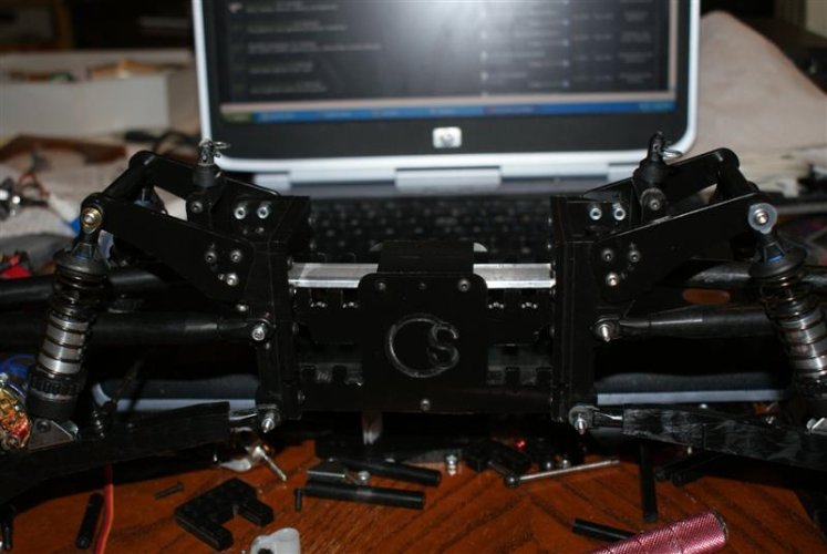

The body mounts are attached to the stationary 'keyed' chassis, so no matter what length is selected, the body stays in the same place.

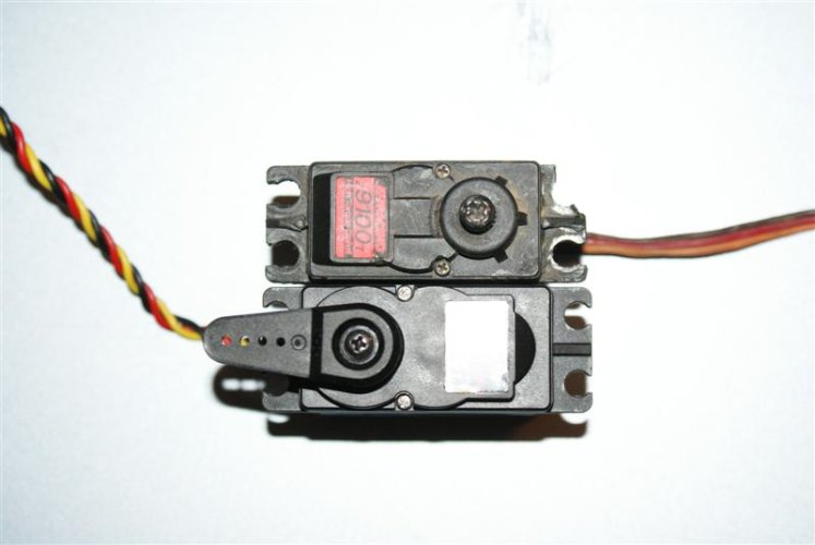

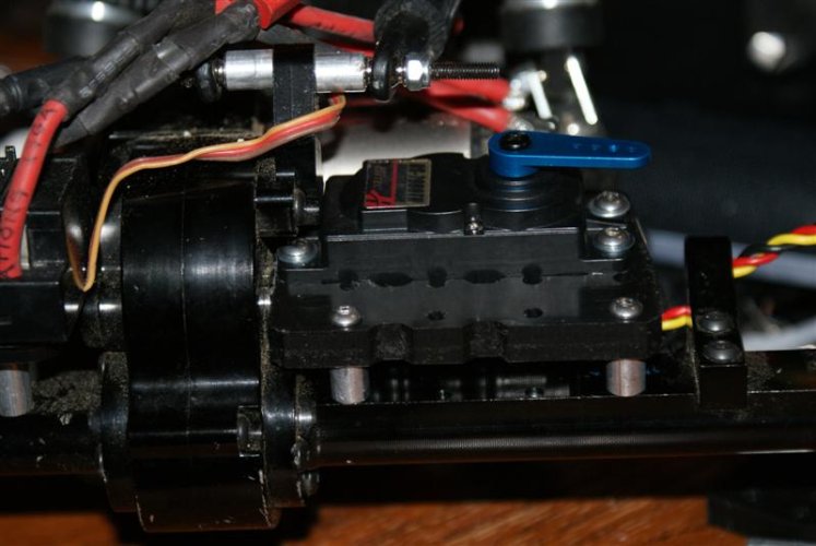

Drawing up some new mounts for the HS-7980 going on the front. Would be nice to put one out back as well, but that will have to wait for my wallet to recover from this one.

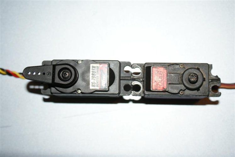

Very tight fit. I can't even fit a piece of paper between the servo and the motor. I'm using the pinions that came with the axles. If I had any smaller pinion, the servo would not fit. I can only use the front row of mounting holes on the axles, due to the servo being flush with the axle tube. But even with 2 screws holding the mount, the assembly won't budge.

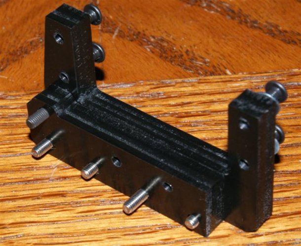

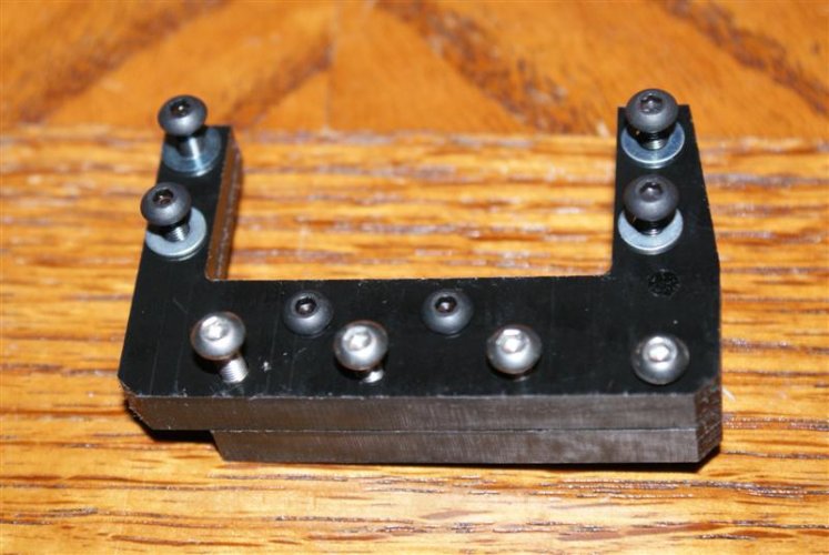

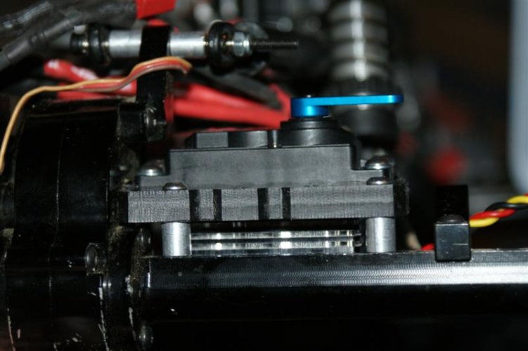

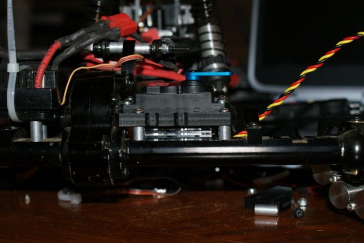

Redesigned the 7980 mount. The original felt very solid, but I wanted more security than two screws could provide.
OOOOOHHHH Nice!!!!!"thumbsup"
Looks ALOT stronger. Nice and simple design.
Did you have to grind into the axle tube any with that?
Edit, I see you said it was flush with tube.
I still need to see what pinions i have in theses axles!!:oops:
Been busy making dremel dust with these huge links!!
Cant wait to put it on the rig next week."thumbsup"

Thanks!
Hopefully you have the stock pinions, because I don't know if it will work with any pinion smaller than stock.
The mount pictured is actually yours. One thing I forgot to take a picture of is the 1/16" spacers, in case you want the servo to be a little higher above the bottom of the axle.
No grinding necessary.
I do suggest assembling the mount and servo (as shown in the 2nd and 3rd pics above) before screwing it to the axle; leaving the two black screws on the back row a little loose until the others are tight. It will make the process much easier. Also when screwing the mount to the axle, screw the counter sunk screw down most of the way before trying to do any of the front row screws.
Let me know if that is clear as mud.
