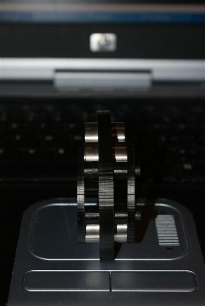

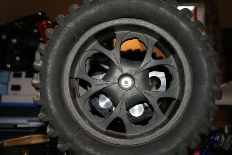

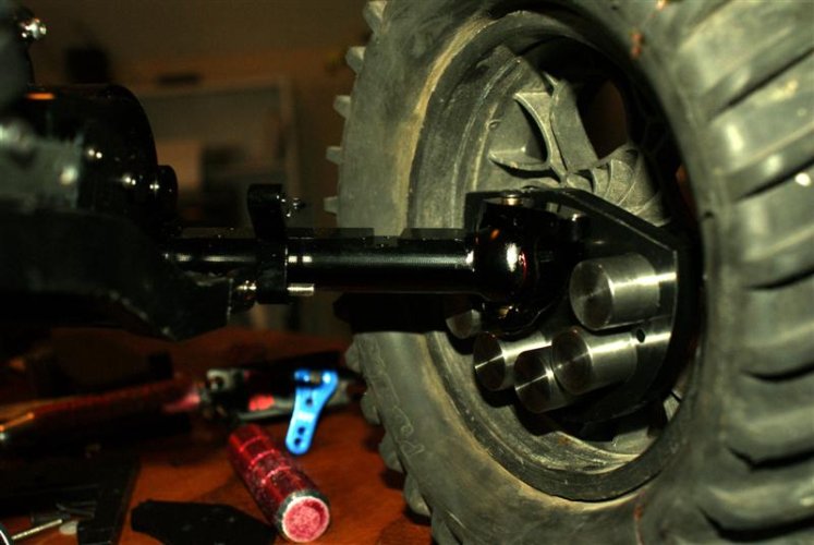

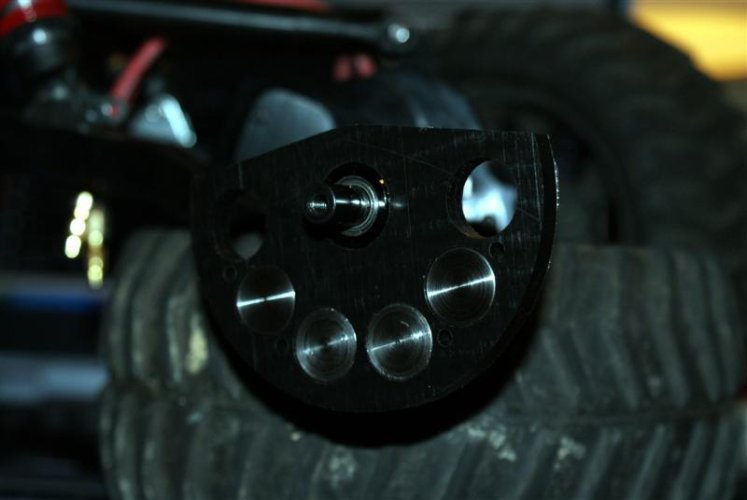

Wheel weights, using the VP slugs..

The retrac is awesome in person. I just hope next time i get to see it on the rocks.
Thanks Thomas! I will definitely have it running the next time we go.
I need to get some longer screws, but here's the idea anyways...

Sven, everything looks great! Cool idea on the wheel weights! I've got a few sitting around and might give that a shot.
Thanks Jeremy!"thumbsup"

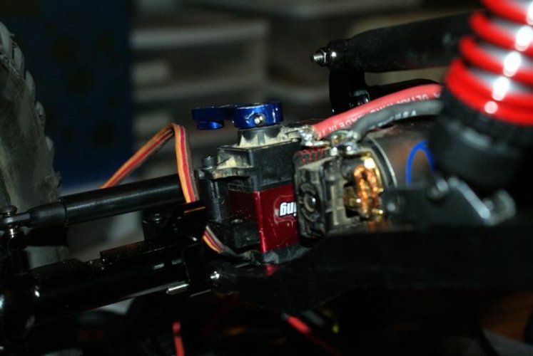

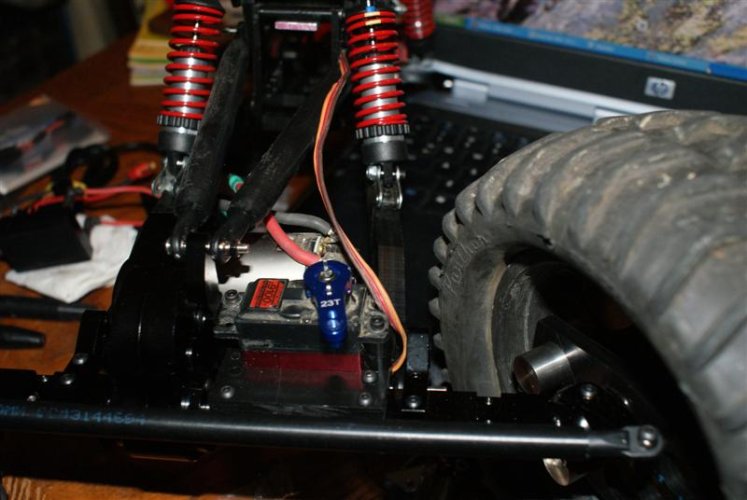

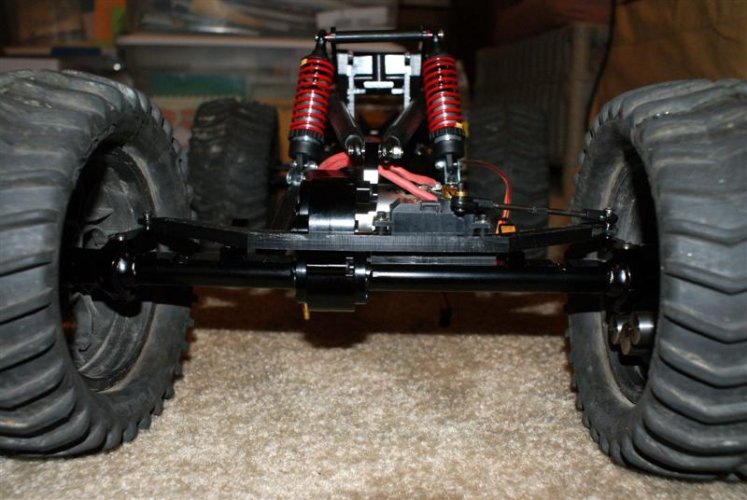

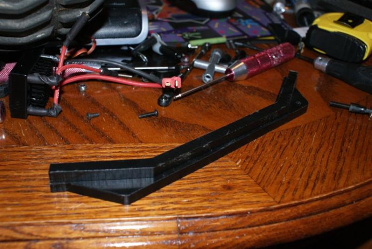

Got a start on the steering mounts. The front axle will be getting an over the axle/bta link. The link shown is for the rear.

Looking good Sven"thumbsup"
Thanks Joe! "thumbsup"

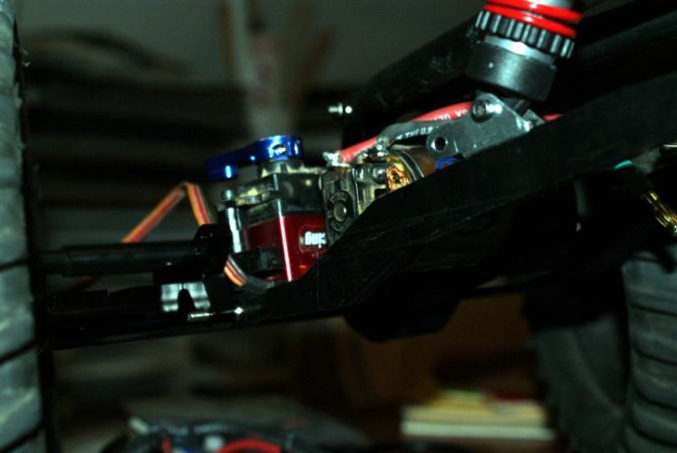

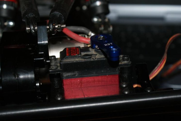

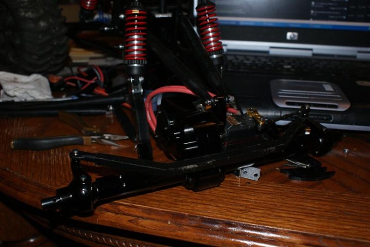

First front steering proto is done. There are some things I need to change to stiffen it up a bit.

Nice work on that steering setup! This thing is really starting to come together. "thumbsup"
Hey Sven is that 9100T servo strong enough if you get in a bind ?
I got one on my 2.2 and I wish I had more torque at times.
Probably not, but it is just for mock up. I have another JR 8711 around here somewhere that will go in there. I have been using the 8711's since my Hitec 5995's gave up the ghost and are now discontinued (I beat on the 5995's hard for about 3 years). Once the Hitec 7980 comes out, I plan to put those in there.
Hitec 7980: http://www.hitecrcd.com/products/servos/digital/hv-ultra-premium-digital/hs-7980th.html
Looks great I like the weight system... I think you might need to use aluminum or steel for the steering link... I suspect the Delrin will get bendy in a bind especially when you get a 7980 in there...
I think you are right. What I think I am going to do is cut out a 1/8" thick aluminum plate to mount on top of the delrin. I don't have any way of cutting the 1/4 aluminum that I would like to use (within a reasonable time frame). But I think an aluminum reinforcement across the top will help stiffen it up a lot.
