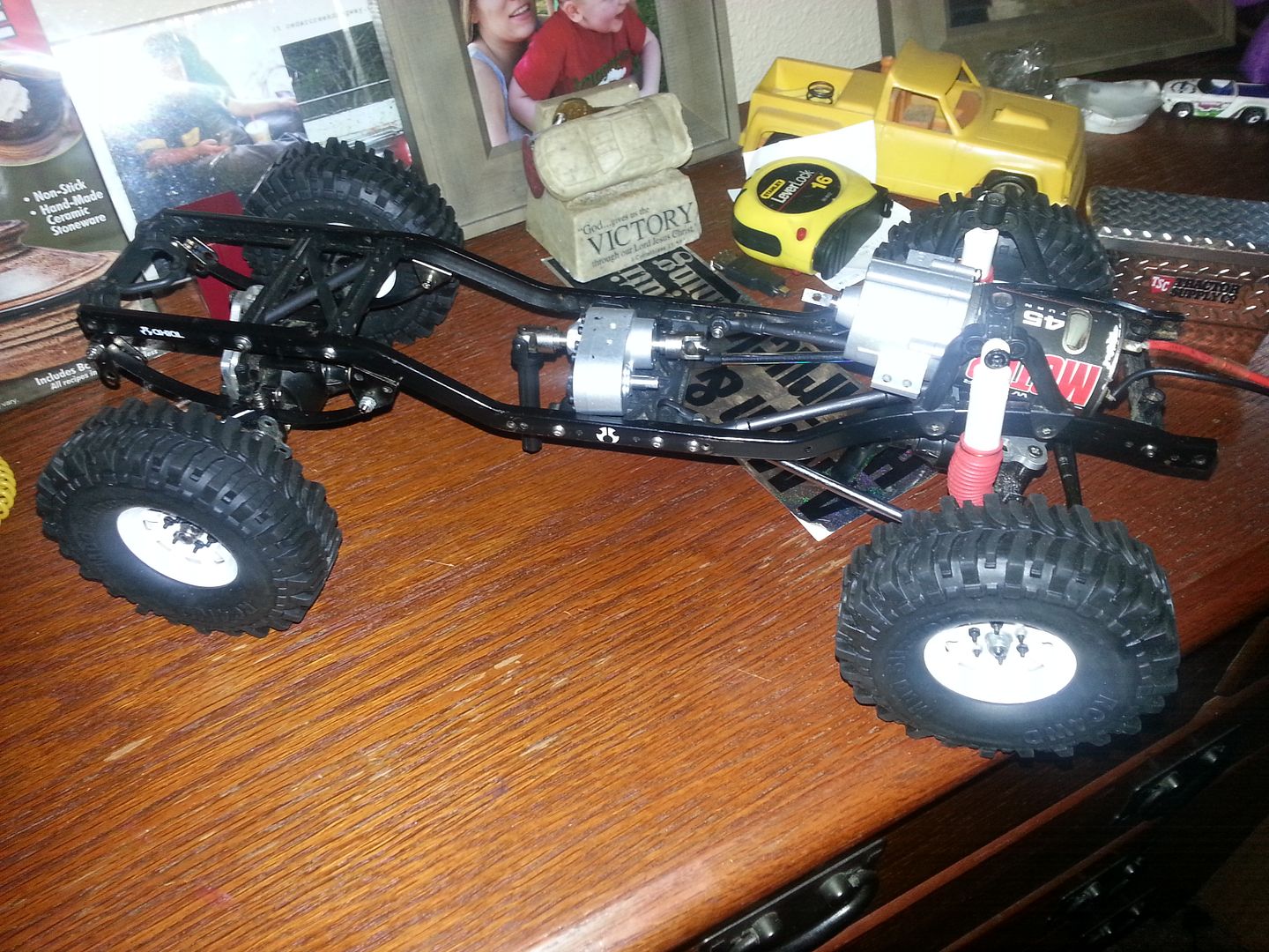

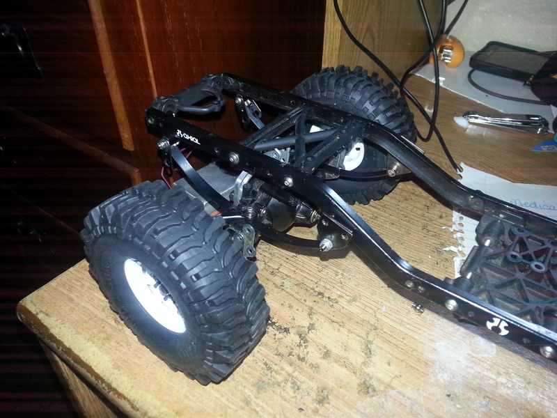

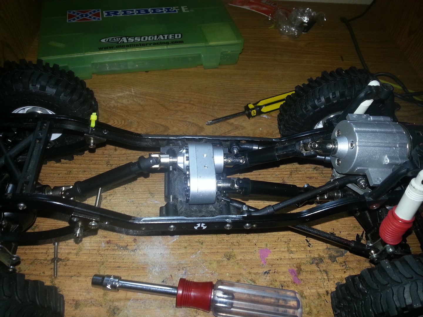

Well after waiting what seemed like an eternity for the postal service to get my truck to Dallas from NY, I had the truck in my possession. Even though it wasn't no where near what I wanted, I was still happy to finally have the truck. So happy I forgot to tell the wife. Well once again, I changed my mind and decided to make the rear end leaf sprung. I saded and grinded on the trans mount for the SCX10 and made it smooth, then i drilled the holes and mounted the TF2 Transfer case. I then sat and thought about a trans mount, I found some scrap metal and took and put the Drimmel I got for Christmas to good use and drilled, grinded, cut and sanded it into a decent mount for my disruptor tranny. After getting that bolted in and getting all my shafts in I come to find the front one is too long so out comes the dremmel. Finally its all in and bolted up.

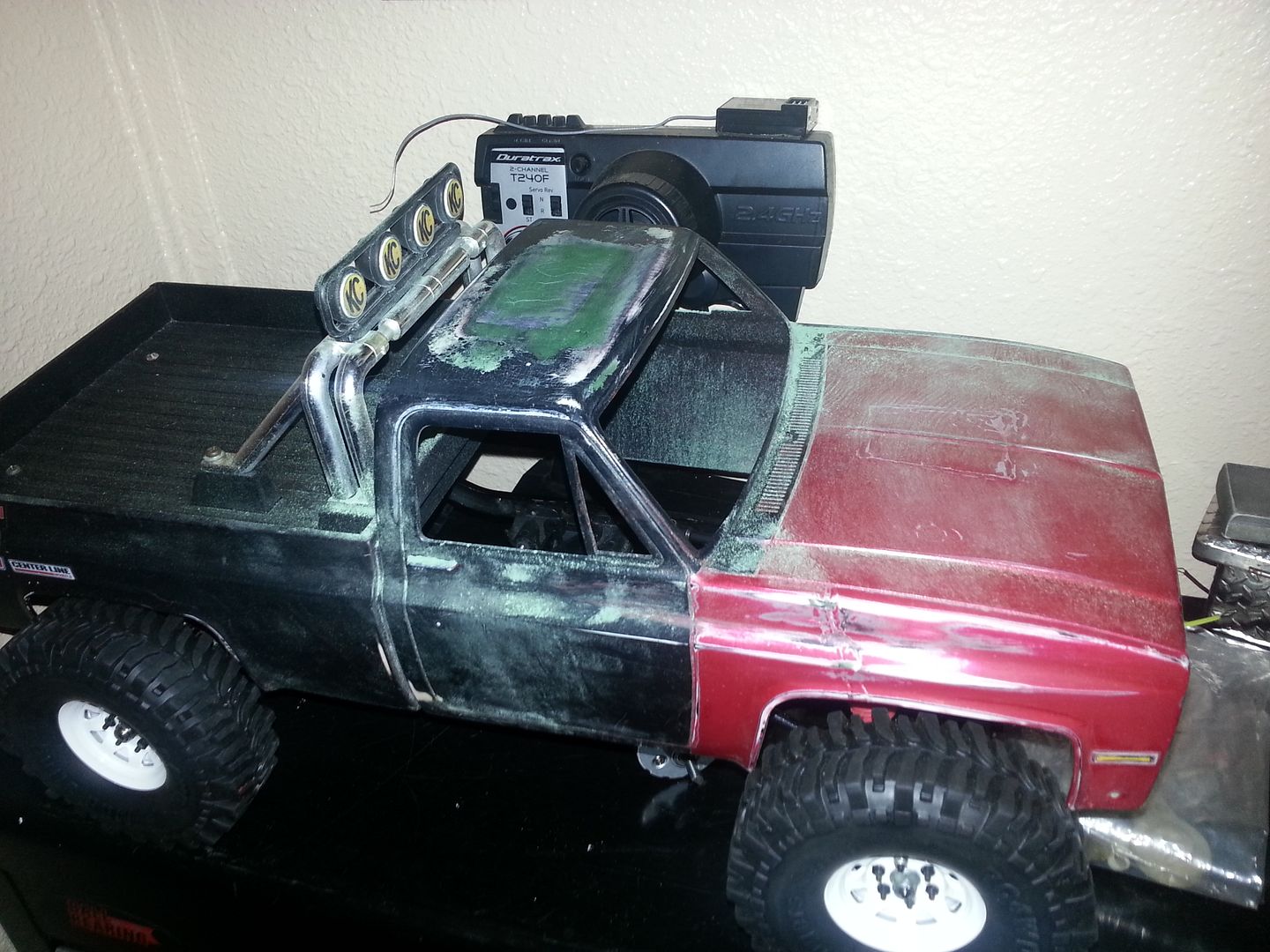

An so began the daunting task of sanding and smoothing. sanding and smoothing, sanding and smoothing, ugh well I laid the first coat and realized the hood was cracked where the PO had filled in the hood. SO I sanded and painted and filled and sanded and finally got to prime it out.
Originally I wanted blue but then the wife pissed me off and i know how much she hates a red truck so, it turned red. But not befor a shot of primer.
Well it stalled out again, my life got busy, wife, work, had to move because the land lord wanted to sell our house. Not to mention the wreck and alot of bullship. Well things have started to turn around again and I have jump started this build again. I have sold off all my R/C stuff except one or two cars and a fist full of parts. I installed the cage from a axial jeep kit. Installed a old bumper I had off of a Axial, Made a chain and actually found a pinion for the tranny. I got all of the kinks in the rx/tx/esc worked out and actually ran it for 100 ft then realized I need new shafts. The shaft going from tranny to the transfer case. I fat I fabed up a mesh screen for the grille that I cut out to make room for the fan that I made.
