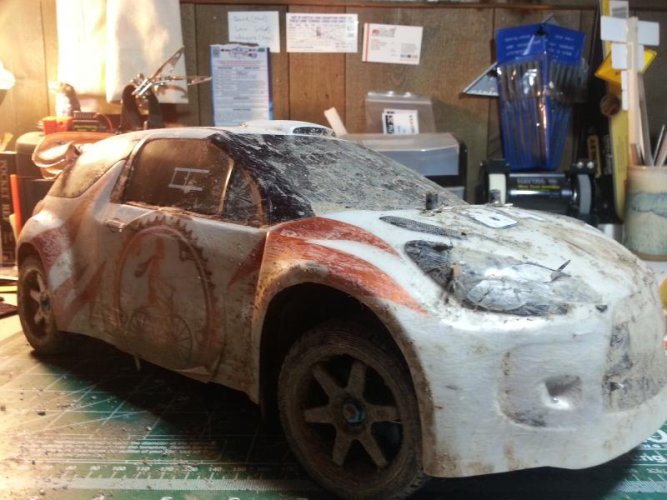

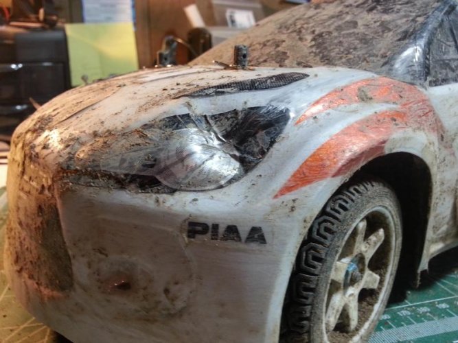

Today was the CRC race #3. Full stage rally. We went out and back on a 4 season rally stage course. There was snow, ice, dirt, and tarmac. It was super fun.
After pics.

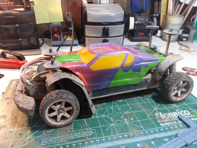

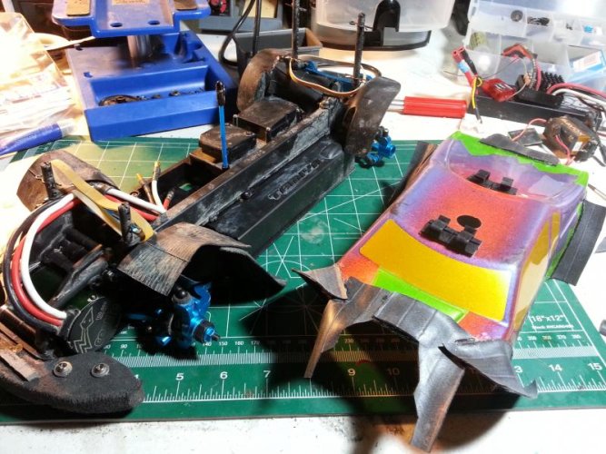

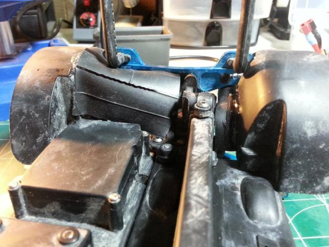

I've been needed to make a decent chassis cover for a while. Starting now with a spare 1/16 truck body. I ordered some gmade 62mm shocks:mrgreen:, undercover/chassis protector thing, and some other spare things. I'm hoping I can find the time to give this car a full tear down and clean. It is really dirty.:roll:

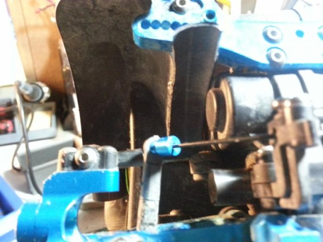

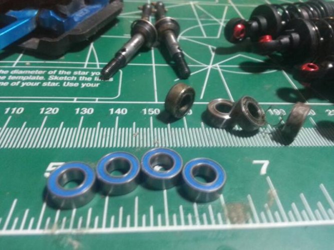

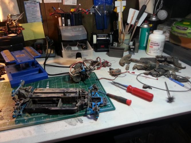

I found a few bad bearings today, So I ordered a full sealed kit from ebay.
Tear down pic:

Added some rear tube.

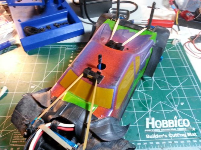

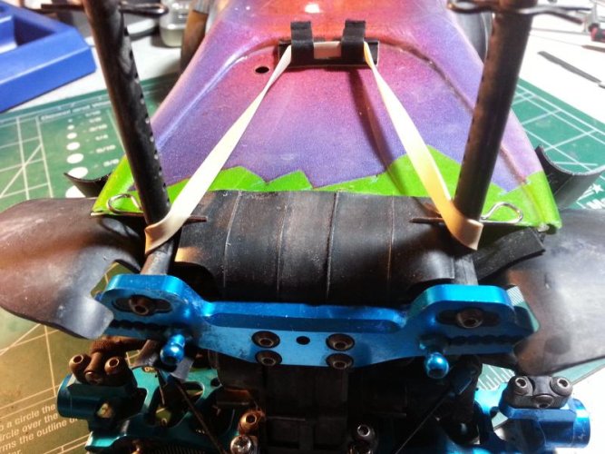

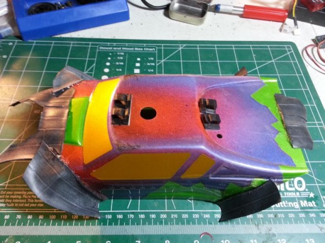

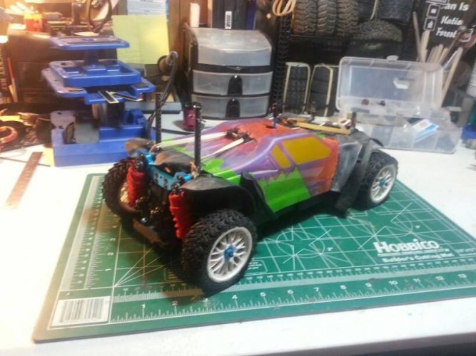

This is what I came up with today in terms of an under body cover. It looks dumb but I think it'll work pretty well. It's held on with two rubber bands looped around the base of the body mounts. It's pretty easy to get on and off. And the rubber bike tubes kind of give it a glove fit on the chassis.

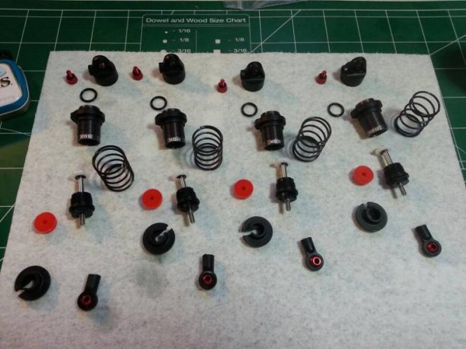

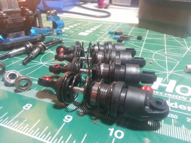

The CRC season has been rough on the stock bearings. I got a new set in the mail the other day and I'm replacing all the wheel hub bearings. New shocks built up. I've always liked to use those axial rubber shock mounts (part # AXA1356)

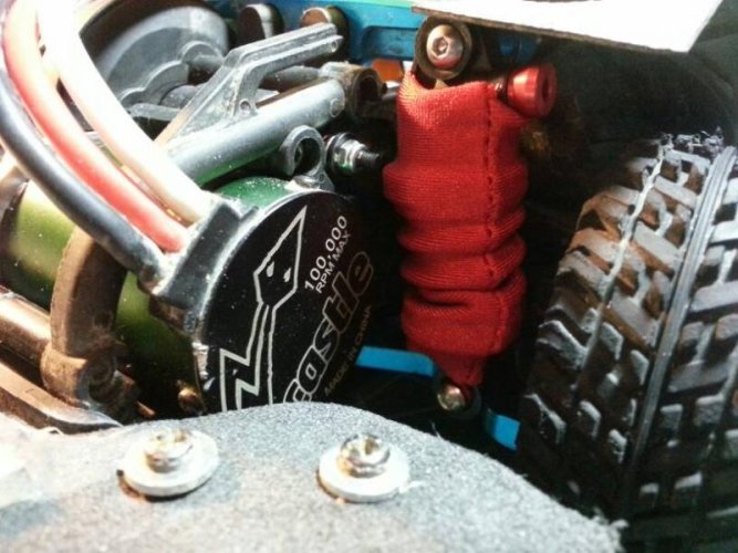

New shocks mounted up. I need to work on them a bit. I think it's riding a little high to be within CRC specs... I'll try to update that so I'm within the rules.
I used the bad horsie shock covers (generic size small). Gotta love those things...
These G made shocks are a tight fit in the front. On one side they almost hit the spur cover, and on the other they're pretty close to the slipper nut/bolt. They feel nice though. Each corner has a smooth feel.

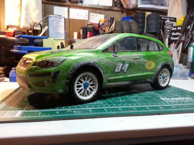

BACK TO THE GREEN MACHINE:mrgreen::mrgreen:

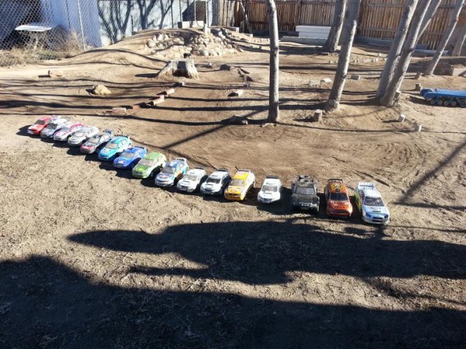

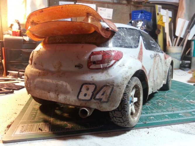

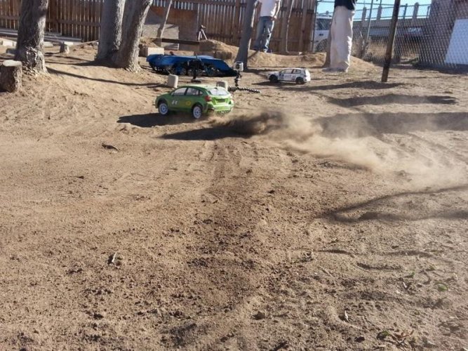

Some pictures from last sunday's CRC race #4.

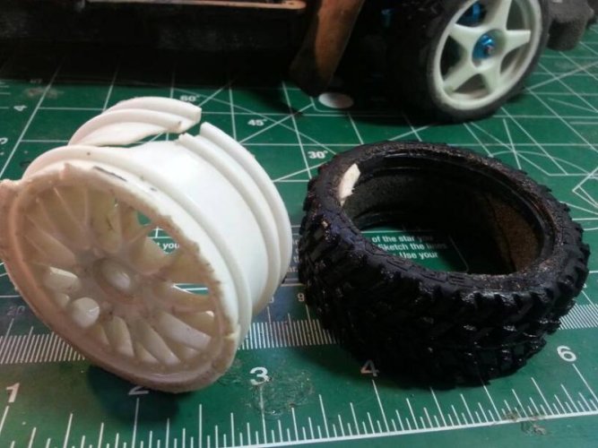

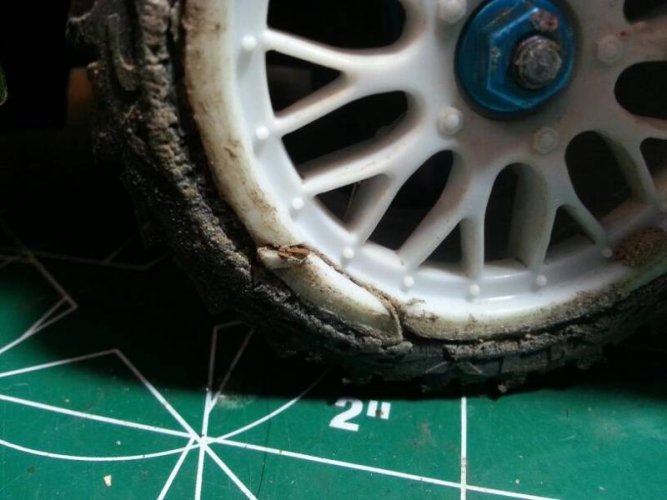

Wounded wheel.
It's actually pretty broken...
HPI wheels right?
Looks like it's time for some proper rally wheels from Tamiya.
Actually, these wheels came from toughracing. They came in a 4 pack, with the academy racing tires. I think they're just a generic wheel. I really have no idea, but looks like I have an excuse to order parts now...

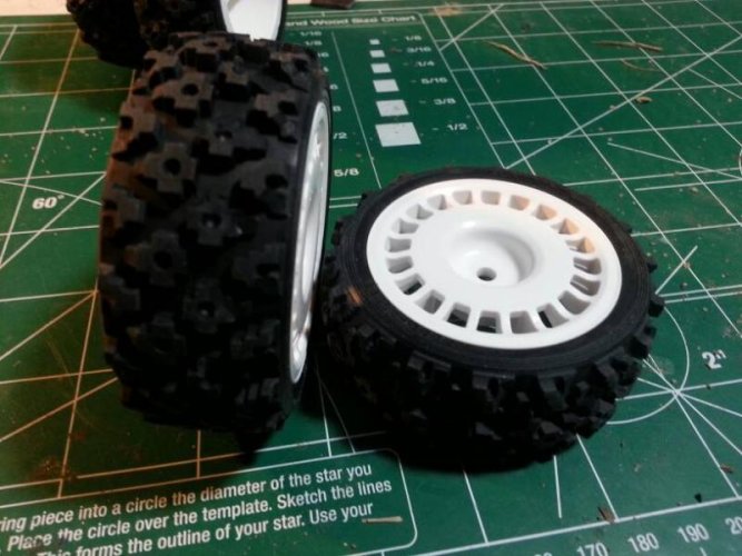

Picked up some wheels and fresh rally blocks.
