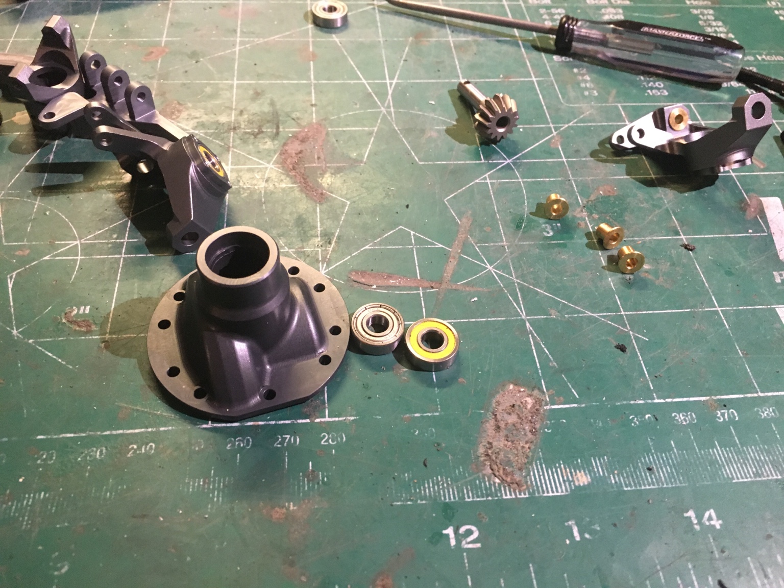

Ssd axles, wheels and shocks.

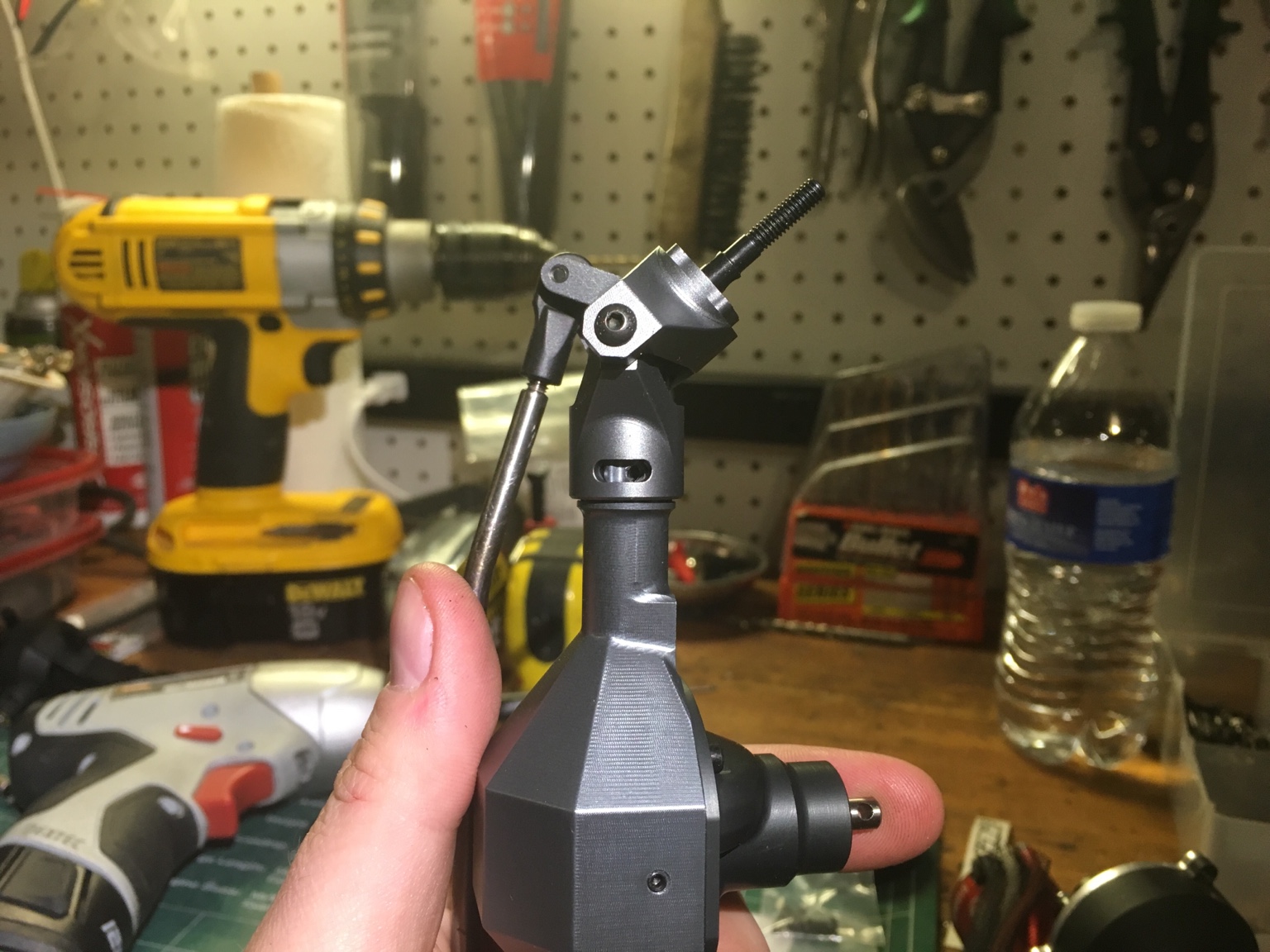

Really like the Ssd axle housing. As many I'm sure have said. It's well made and looks really strong. I love the fact that the threaded holes for the chubs are pretty thick so hopefully will hold the chubs well.
Going with FI spool and 38/13 up front. Also using the vanquish knuckle bushings.
The 5x13 pinion bearings in and out are sweet. The ones that come with the axle are metal shielded. I had one revolution bearing from avid that I put in to have a rubber seal on the outside.
Another really nice feature is the link mount truss has two threaded holes as you thread the bolt thru.
The Ssd pro knuckles give some really good steering angle too.

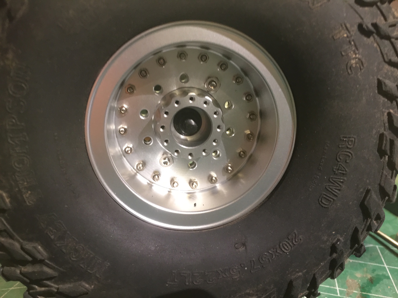

Mounted up one of the militant wheels. Dang a lot of hardware but love how they look!!!
Used an old Mickey ttc I have with the old compound. Won't use them in the end but I'll work for now.

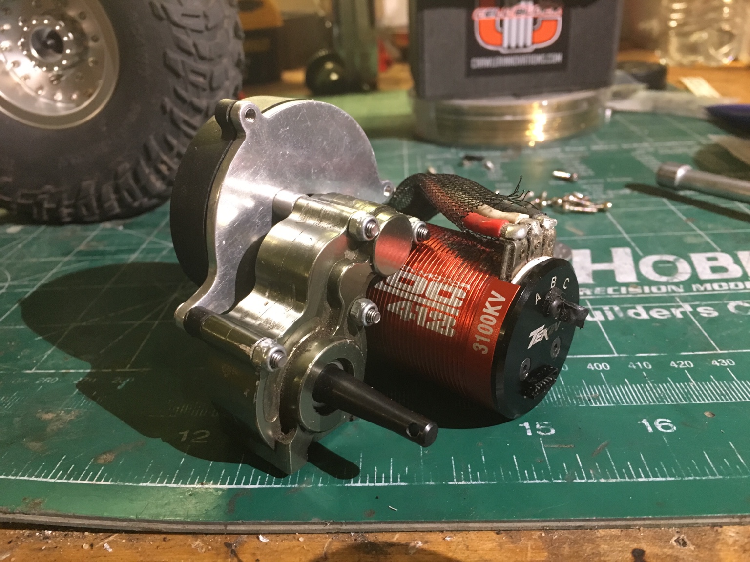

In the meantime I got the bombproof trans put together with some new bearings in my roc412 3100kv

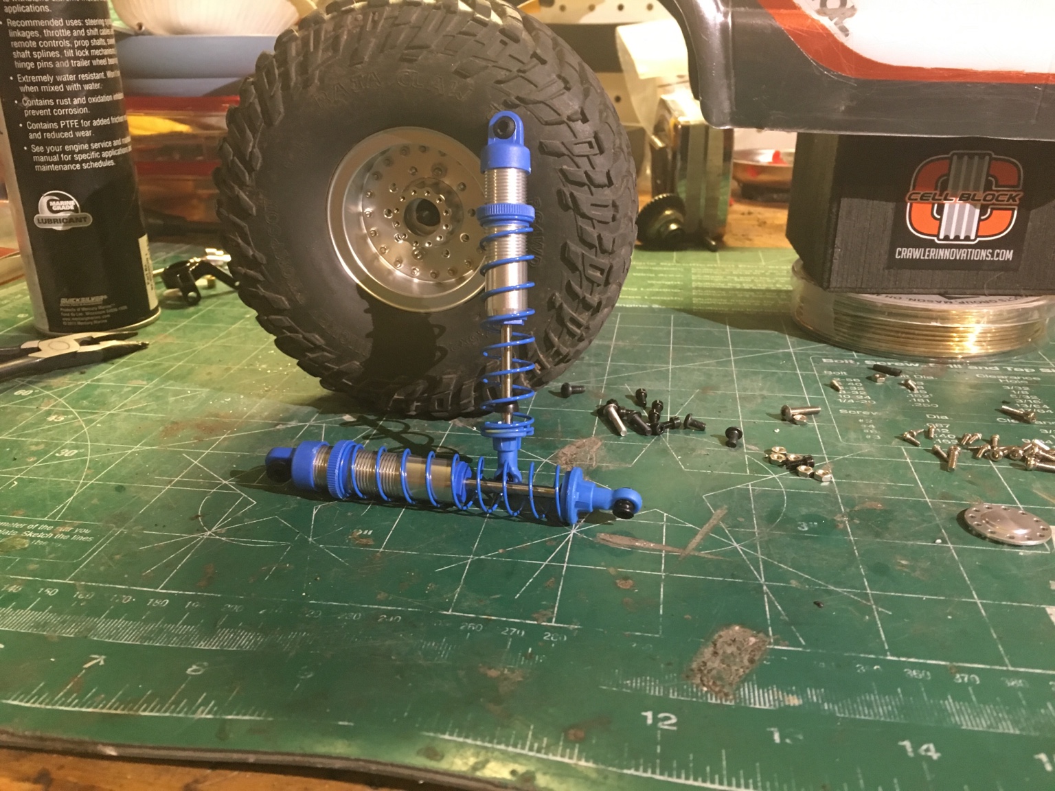

Axial 4" king shocks arrived too. I know they aren't the best shocks bit they fit the bill and I think they'll perform pretty good for my needs. 4 aluminum shocks with King colors for $40...that works for me.

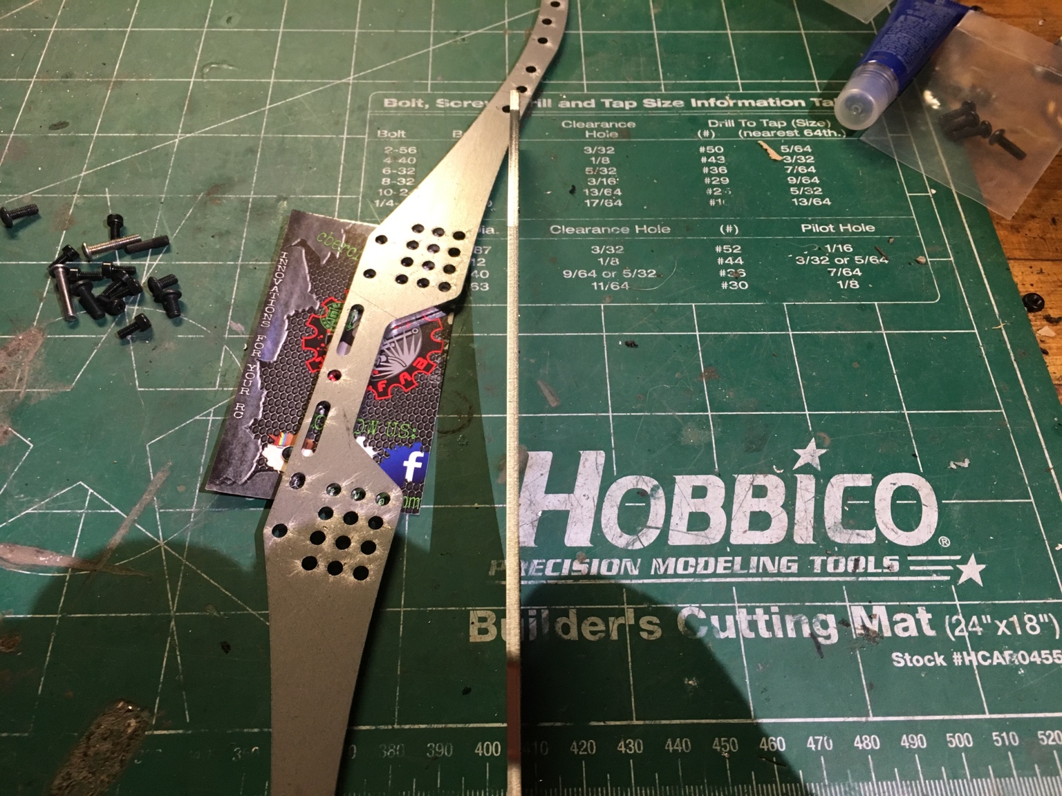

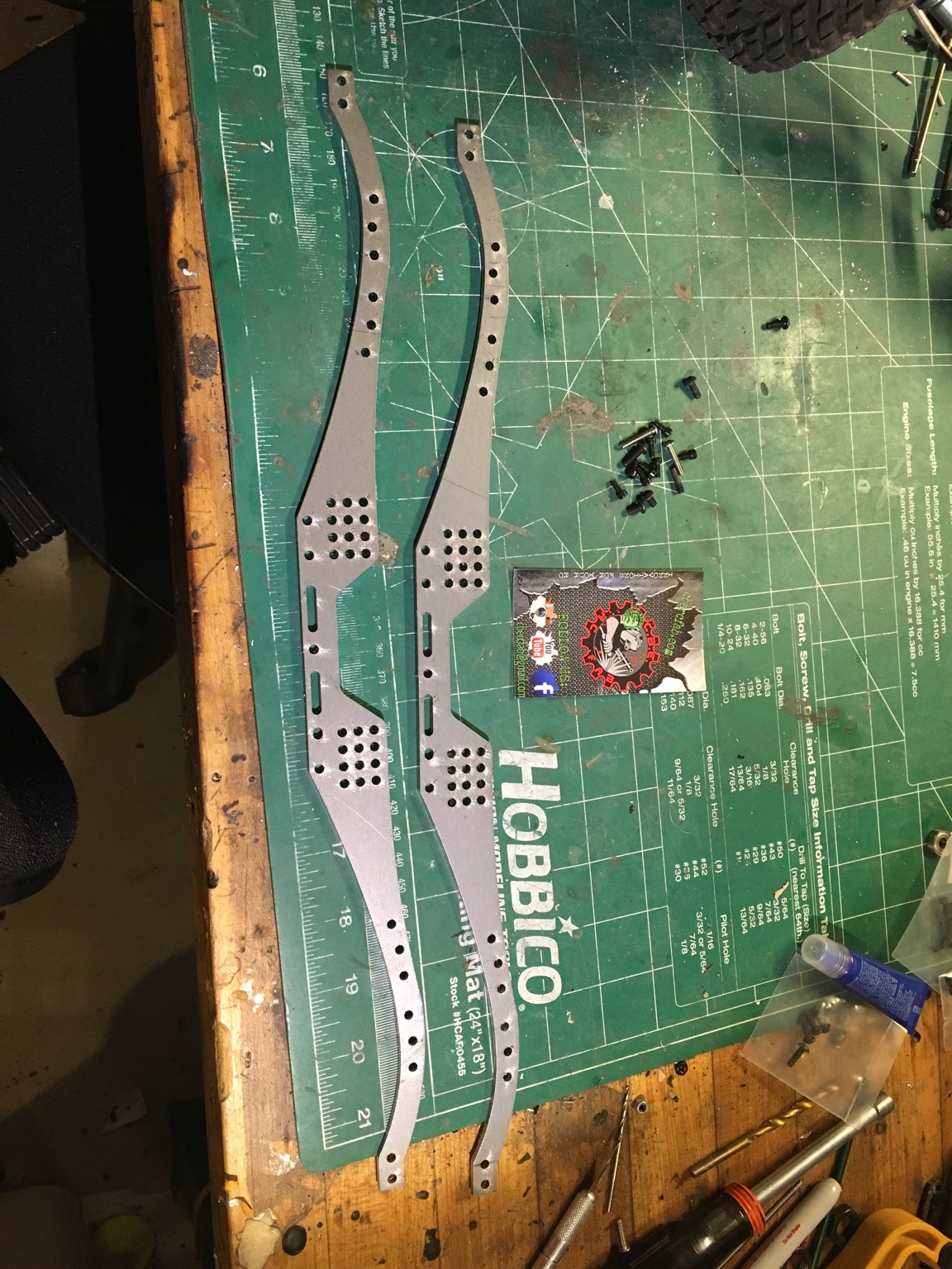

CBE rc frame rails showed up. Exactly what I need to start fab. No shock hoops to cut off and a reasonable price. Plus they're 100 thousandths thick. Just need to cut the back part off and get going ;)
The new f250 body showed up so I will start cutting into everything very shortly!!

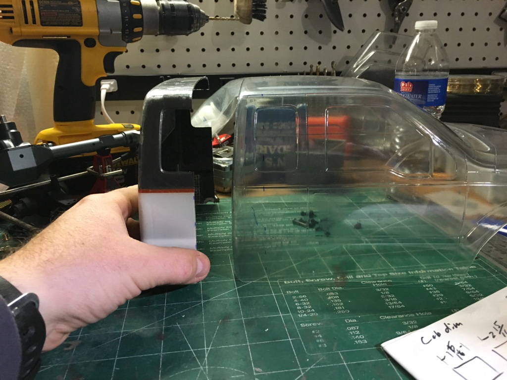

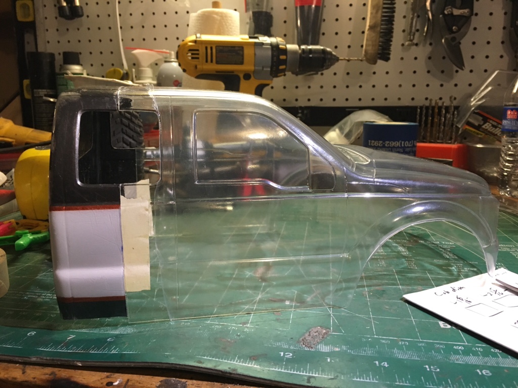

Decided to get some work done on the body so I can lay out the chassis.
I used a 2008 f250 proline crewcab body to scale the amount to add to the new body.
Cutting has begun.
Now time to cut the new one.....

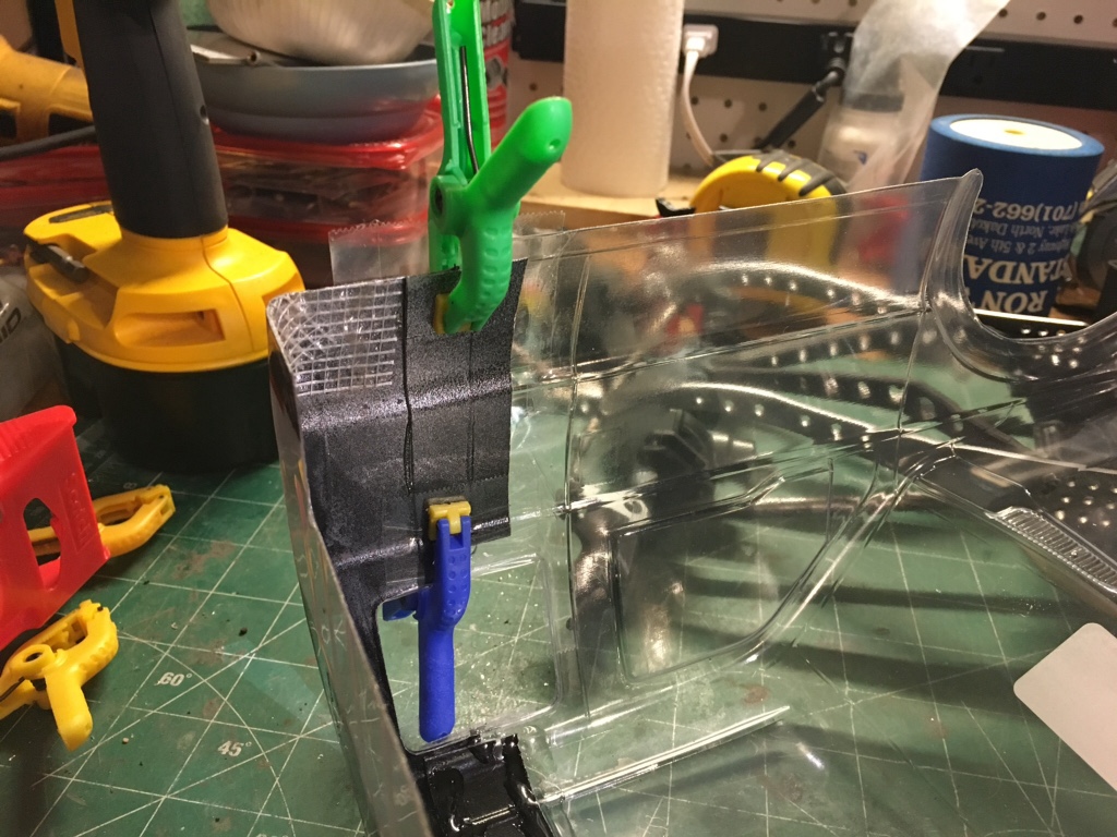

Fit up test
I cut out the rear door window for each part so it won't have a seam. Plan to glue in a new piece of lexan for a window. I cut up the rest of the cab to make backing support plates. These work great as the follow the contours of the body.
Just a matter of letting the E6000 dry now....

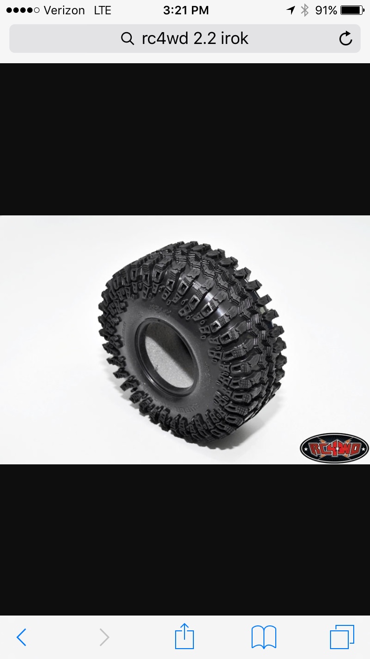

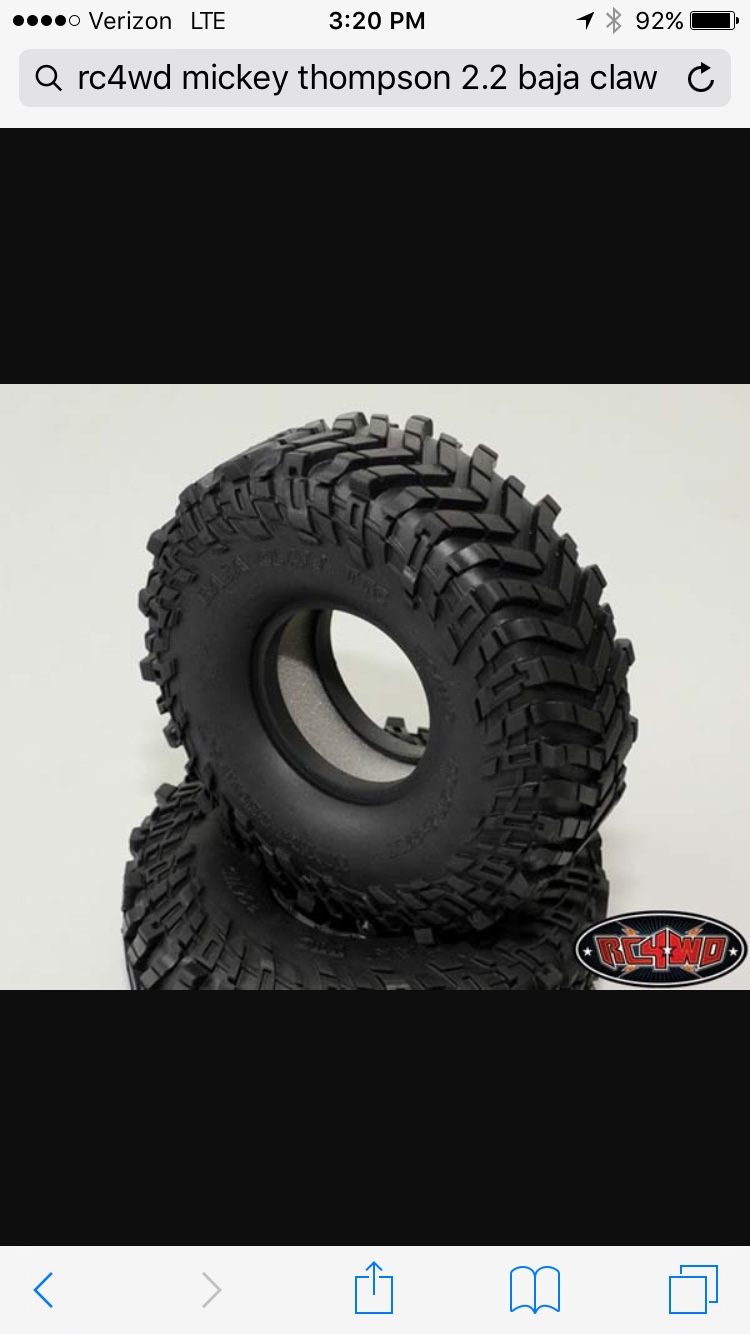

Ok guys, I need some help on tire selection.

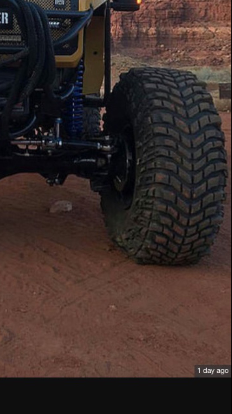

The 1:1 uses Mickey Thompson ttc baja claws.
Although they are one of my favorite looking tires ever, I am not huge on there performance.
At our local club test and tune yesterday. A buddy said "why not use pitbull growlers?" They're chevron design, great compound and they do work really well here in Mn (especially if you trim some lugs)
So I'm looking for feedback on where I should go....
Option 1 - RC4wd Mickey Thompson 2.2 ttc in x2ss
Option 2 - Pitbull Growler 2.2
Option 3 - RC4wd Mickey Thompson 2.2 ttc Radial
Option 4 - RC4wd Irok swamper 2.2 (Totally goes away from the scale look but I already have a set in x2ss and they are a great all around tire)
I'm kinda leaning pitbull or ttc radial.... I just don't know.....
I love love love growlers!!!!!! But I do think they would look great on your build. In my uneducated opinion
