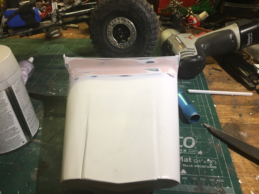

Do yourself a favor though, throw that green stuff away. Even the Bondo brand two part you can get in the tube at Autozone is easier to work with and holds up eleventy-billion times better than that stuff. your styrene work loos awesome, you owe yourself the pleasure of using some decent filler on there.

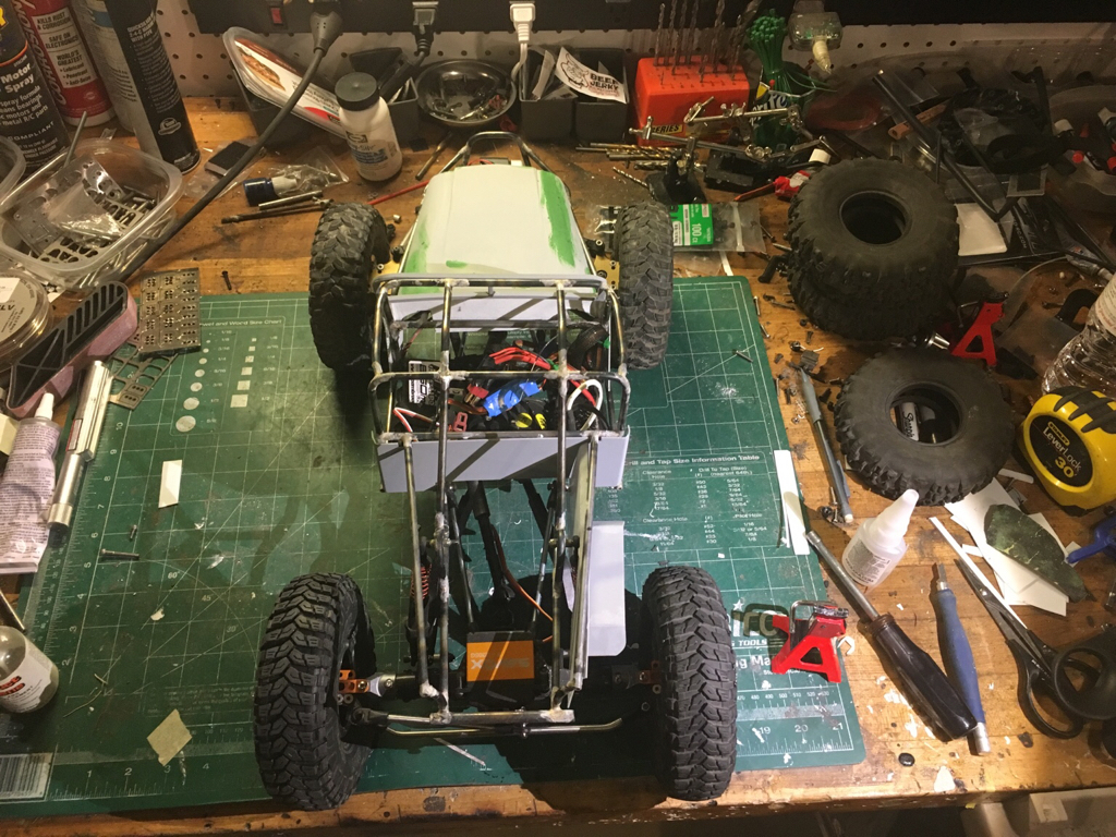

The fabrication side is old hat to me now. It's only my second attempt at a custom styrene body and my first scratch built.
I can agree that the modeling fillers haven't been the best. I've had decent luck with the green so far. I started with tamiya white putty and have had some of it crack off. I'll probably drive the rig in primer for a little while and see how it holds up before final paint.

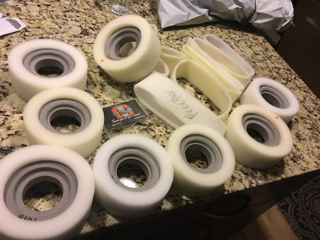

Thanks to Eddie getting stuff shipped out so fast my foams arrived.
I got the rear tires mounted up on the trail ready wheels. Running 5.5 narrow comp cut with soft up front and med in rear. I can't wait for spring and testing these on the rocks we Comp on. If not, the pitbull growlers are sitting in a bag waiting.

I had some issues with the tamiya white putty cracking (just like I was warned of). Bought some bondo filler and that's worked much better.

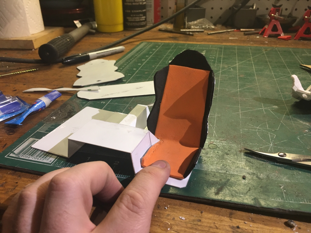

Next thing I started was the interior. I decided to do more of a 3/4 as I really want the battery low on the drivers side. It takes up a decent amount of space so I made a "floor" pan. I'll tuck the battery under it.

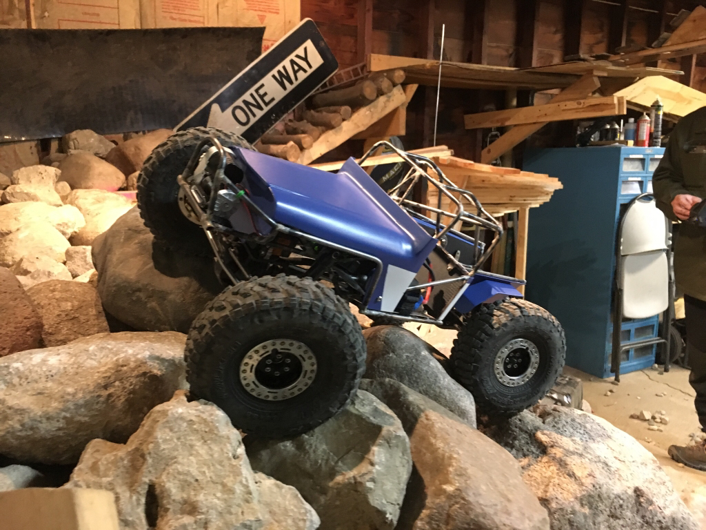

We had a small indoor comp last weekend. Since she's mechanically sound I took her out for a run with the body installed. She smoked the competition and didn't even come home with a scratch.
