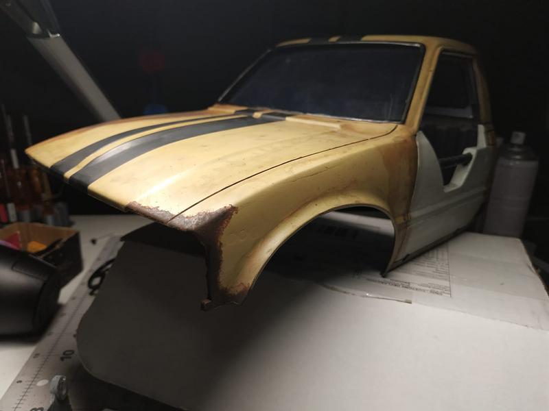

after several crashes, fallings, and rollovers the current body is pretty beaten up, so its time to build a replacement
parts list:
Tamiya Toyota Hilux Front Truck Body TAM9335487
RC4WD Mojave II Cab Back Panels & Grill Parts Tree RC4ZB0074
Clear Plastic Window Windshield for Tamiya Hilux
Loops RC Interior Set for Toyota Hilux
First step, design half doof for driver´s side
The second step, correct the previous half doof design and glue the back panel and rear window
Third steep, build the door interiors and dashboard, also cut the back panel to fit over the transmission
The fourth step, paint the body
Weathering and final assembly is pending, some Vallejo paints are on the way
photos of the final work, soon...
I finished the weathering ising the wash technique
I followed the tips from this thread: 3 Stages of Hardbody Paint Weathering
of course, it is not the best work but not so bad for my first try using this washing technique
some pics
colors used
vallejo model color
70865 oil y steel
70946 dark red
70855 black glaze
70887 olive green
game effects 72136 dry rust
