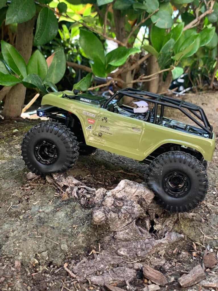

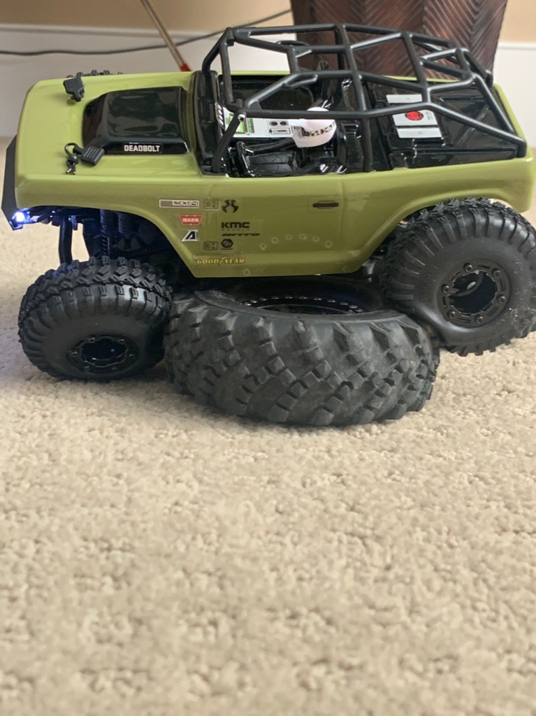

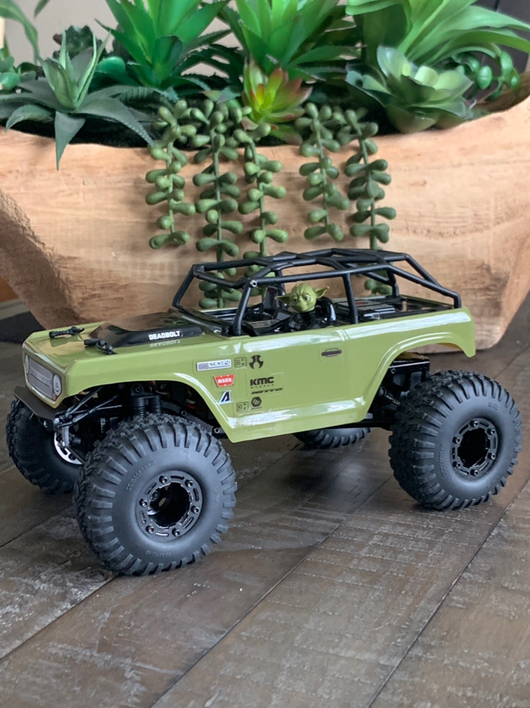

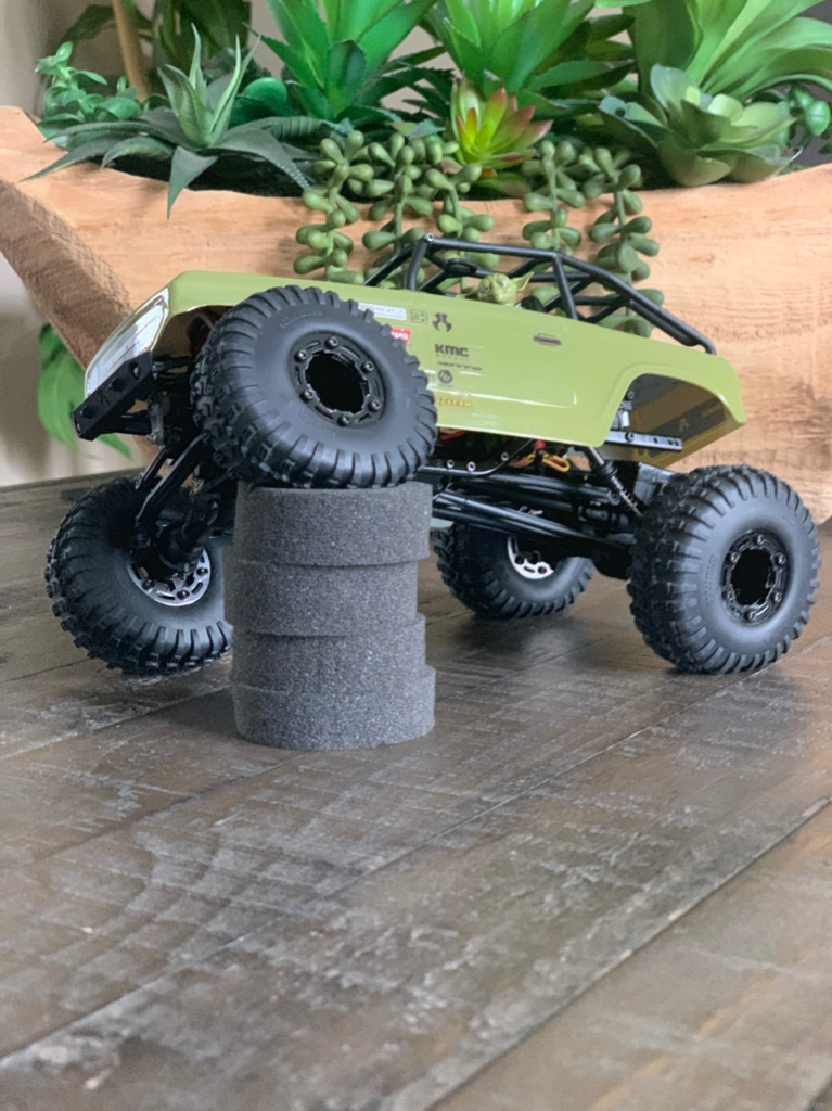

Yep[emoji41]The Furitek TEGU with BT dongle and real time app is the shit! Check this out!

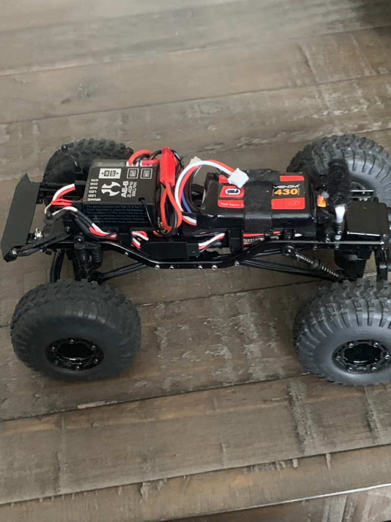

To me this is the best esc for micros period! It’s worth the cost. I think I paid 75ish for the top of the line waterproof version with Bluetooth dongle.
75 + 16 for the reverse surpass mount on eBay + 20 bucks for the surpass motor make this thing a super beast! It literally moves so slow you have to look twice to make sure it’s moving.
My mamba micro X with the surpass was so loud. The furitek is silent. I hear NO WHINE at all.

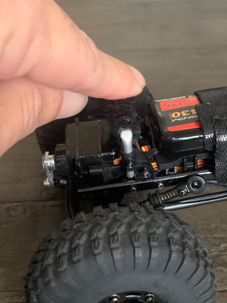

Plus, the tegu version is same size as stock esc. So it goes right in place of the stock one on the tray. The reverse surpass motor mount on eBay doesn’t require you cutting the tray up and you just flip the battery tray and your done!
I highly recommend this setup!
