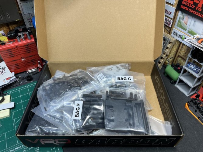

So as I expected, I couldn't hold back and I broke the seal on the box. It is a very nice looking box. It is smaller than I expected, but full of really cool stuff!
Here are a few more pics of what can be expected to see once the lid is opened.

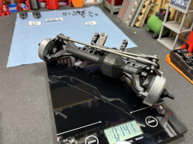

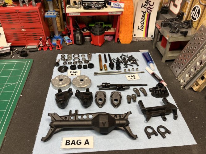

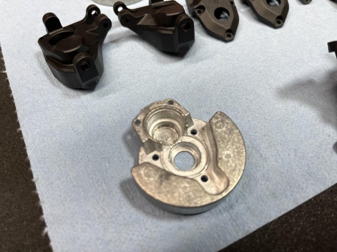

I couldn't wait.:roll: I had to open Bag A to see the front portal weights up close. Then decided it was time to build!:ror:
The heavy alloy portal weights or as Josh said, like melted down Hot Wheels or something like that, feel and look good. They sorta remind me of a lead fishing weight. The bearings fit tight into the housings and I feel no slop in them. I did have to use my tiny hammer and tap in the bearings so that they seated all the way in. The weight of these are about 4.5oz or 128 grams. Should add some good weight up front.

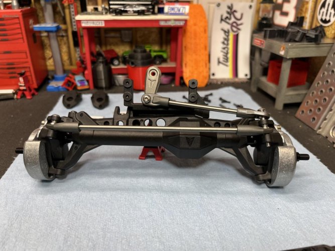

As always with any Vanquish kit, building the axle was a dream. Fit and finish is perfect and every part just fell together. If you've ever built one, you know!:)
As with all of my kits, I opted to use Team KNK stainless steel hardware to assemble. I normally use marine grease on the axle gears, but this time I decided to try out the supplied grease in the tube that came with the kit. After applying it to the gears, it looks damn near identical to the Walmart marine grease that I have been using in all of my rigs for years.
For now I'll be using the non-clamping servo horn that came with the kit. If I have problems with it, I'll swap it out for a clamping VP horn in the future.
Edit: I forgot to mention that this kit comes with the harder rod ends. The look great and the links threaded into them really good. I thought that I might have to tap threads into them first, but I didn't have to. Also, I like the new thinner links that are used up front. Instead of a bent link to clear the front diff, the straight link used bent rod ends and the link clears the diff nicely at full lock.
Another Edit: Total weight assembled: 14.1 oz. or 399.7 grams

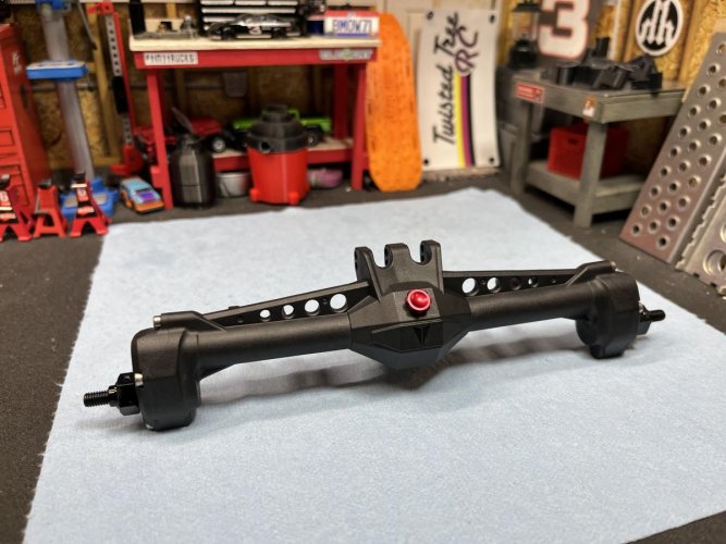

Now that Bag A is complete, I hauled in Bag B to the garage. Bag B is the complete rear F10 portal axle. This is nothing spectacular and many have built these, so it's OK to skip this post. It's OK, I understand!:ror: It's just all part of the process!
Same build experience as the front axle. All molded and machined pieces are top notch and go together with ease.
Total weight assembled: 7 oz. or 198.4 grams

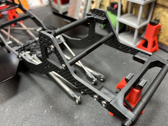

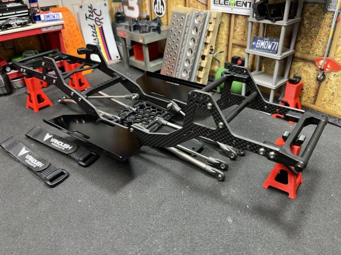

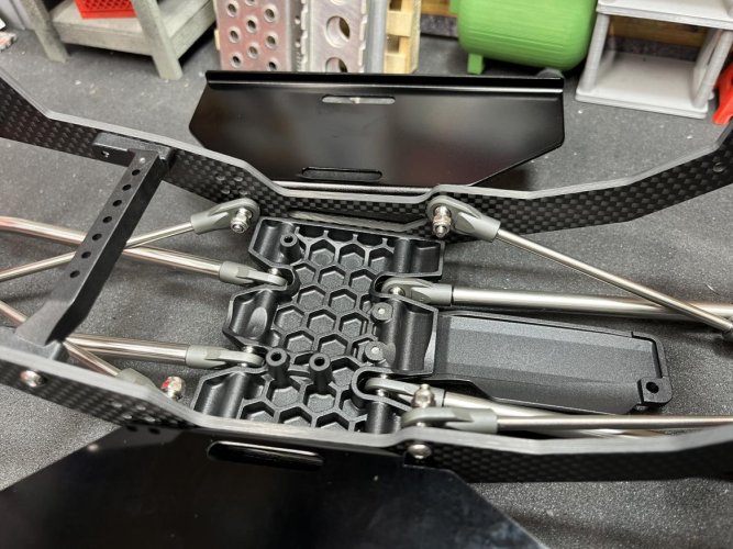

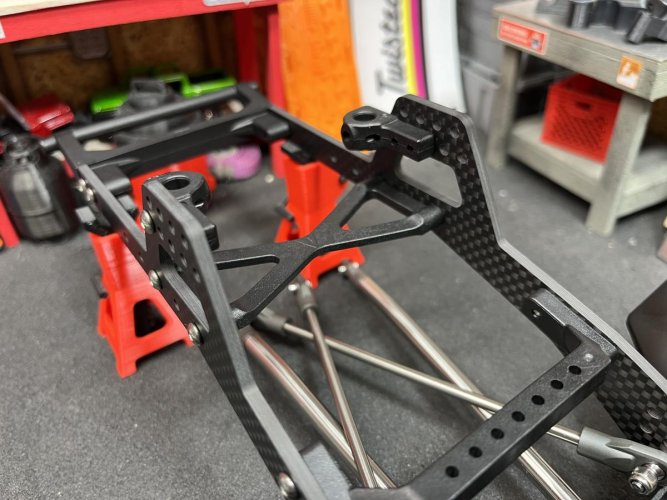

On to Bag C, the chassis bag. Once again the fit and finish on these items are great. The carbon fiber chassis rails look stunning and are cut and drilled to perfection. I like the dull gray look on these rails better than some others that are a glossy black carbon fiber. The skid is flat and slick and follows the curve of the chassis nicely. The sliders are a black powder coated aluminum and are very light. In fact the entire completed chassis is super light. I did not get weights on the chassis or individual pieces, so I'm going to go back and get the weights and post them in the next post.
Very easy assembly and is light as a feather. Just like the links on the front axle, I did not pre-thread these harder plastic rod ends. In fact I found threading the links into these rod ends much easier than the black plastic rod ends that come on the other VP kits. These links were very easy to assemble and install. The balls in the rod ends fit the skid great and I feel no side-to-side slop in these. Time will tell how these new rod ends hold up compared to the black plastic rod ends. I've seen pics that people have posted of rod ends that have stretched out due to the softness of the black rod ends. These harder gray rod ends feel much more durable.
