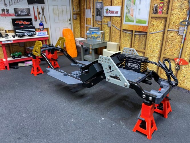

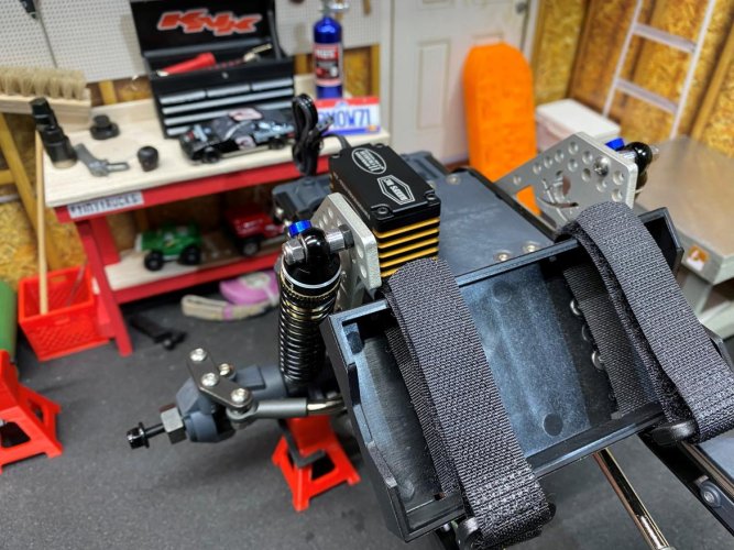

To start the build off, I went ahead and put the chassis together. Using Team KNK hardware, as always:), I assembled and attached 2 sets of rear Rock Pirates RC shock towers. The rear towers are a limited edition gold that were sold on Veterans Day 2021 and all proceeds went to Operation 11 Charlie to help out our Veterans.
The Reefs RAW 500 servo is a limited edition servo which a portion of the proceeds were donated to Operation 11 Charlie to help get our Veterans to USTE 2022 this past weekend. It is a beautiful servo and should steer this rig over any obstacle with ease!

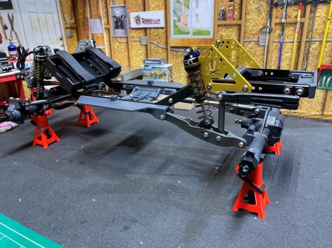

The front (rear) shock towers are also a set of Rock Pirates RC shock towers in the clear flavor. I decided to use these instead of the RPRC Element front towers because I had them and I didn't want to wait for another order to arrive. I also wanted to see if I could make the stock GK panhard mount work with these towers. I had to drill a hole in the shock tower for the rear panhard mounting bolt. For the front mounting bolt, I used a 3mm alum spacer to attach it to the rail. Looks like it should work and I'll have to add about 3mm extra length to the panhard link.

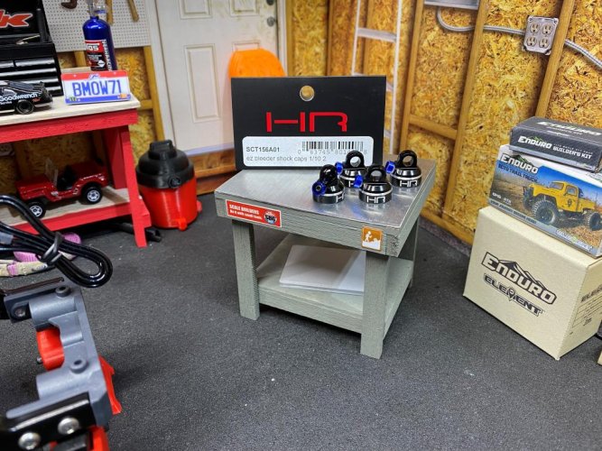

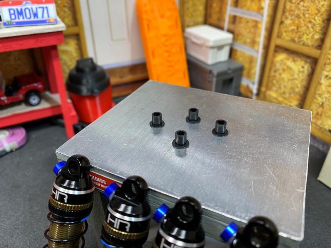

Spent a little time last night on the GK/Ecto. Assembled the shocks and added Hot Racing bleeder caps to them. On my Trailwaker, (http://www.rccrawler.com/forum/elem...ck-sendero/618127-b-mows-ifs-trailwalker.html) I installed a set of AE shock bleeder caps and really like how easy it made it to fill and bleed out the air in the shocks. So I figured I'd do the same and try out a set of these HR bleeder caps. These caps made it super simple to bleed and there is no sign of air in the shocks afterwards.
These caps are aluminum and fit the Element shock bodies perfectly. The only issue is you can not use the steel ball end that is used in the plastic shock cap. The mounting hole in the HR cap is smaller and requires a plastic spacer. Luckily, I had four plastic spacers in my shock spare parts bin that fit these shocks perfectly.

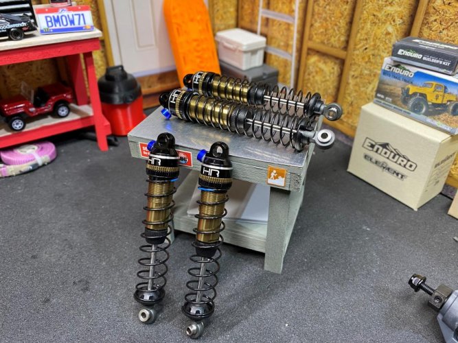

These Element shocks are so smooth and look great with the bronze anodizing! I decided to fill them with 40wt shock fluid for now and I'll see how it feels once I get it on the rocks. On the bench they feel really good. I cycled them and left them hanging overnight and I see zero leakage or seepage of fluid on the shock shaft or shock cap/bleeder screw.

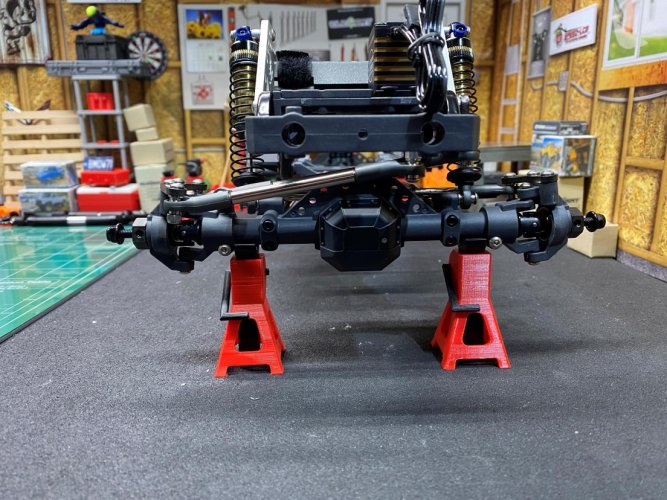

Assembled the axles as well. Easy to assemble and feel smooth when spun by hand. This is my first experience with the Element "hard" gray plastics in this kit. I found that tapping all of the 3mm threads first before trying to thread the screws in made it a lot easier to assemble and reduced the chance of breaking or stripping out the plastic. I did not tap any of the 2.5mm threads. These 2.5mm screws seemed to thread in pretty well without tapping.
There are a few of the 2.5mm screws that I still need to replace with stainless screws. Since I didn't by the Team KNK hardware kit for this rig and was using only my stock of SS screws, I didn't have enough to swap out all of them. I'll have to get an order in to KNK soon so that I can replace the black oxide screws.
I do have plans to swap out the stock c-hubs and knuckles with SSD, but I haven't placed that order yet. When I do, I'll get pics posted of them.
Almost forgot to mention, this kit does come with steel 6mm hexes. It's nice that I won't have to worry about replacing them any time soon. I believe the RTR GK only comes with the plastic hexes.

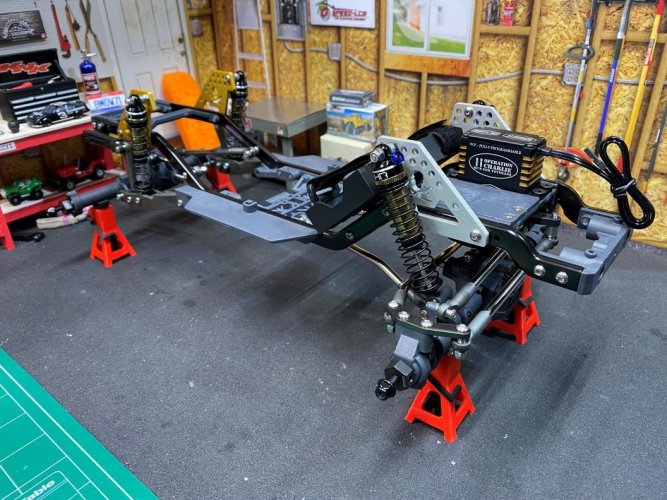

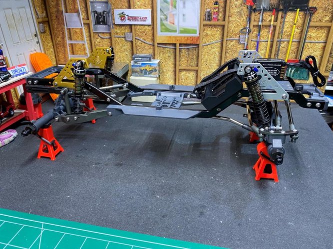

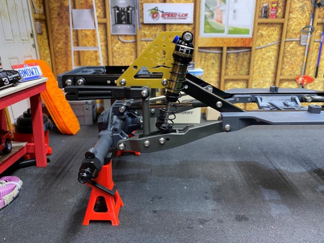

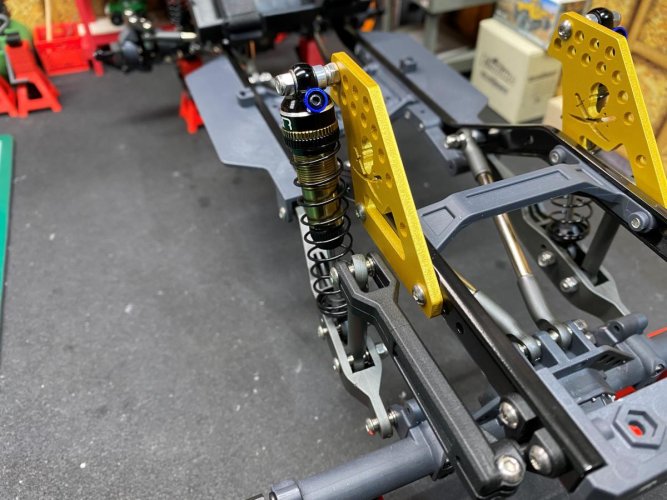

Made some more progress last night. Got the links all threaded together and measured. Installed them with the shocks and axles. I like how this GK Kit comes with the front high clearance links.
On the front shock towers, I want to mount the shocks further back in the last top hole, but before I can do that I need to modify the batter tray to give room for the shock cap and spring. I'm going to get an aftermarket battery tray on order that will not interfere with the shock.
Also need to work on the panhard link. I need to put a slight bend in it so that the link does not hit the diff cover. The suspension travel is limited on the driver side because of the link making contact with the diff.
Ok, photo dump of the completed chassis below.
