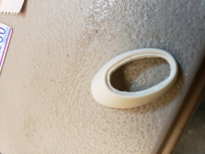

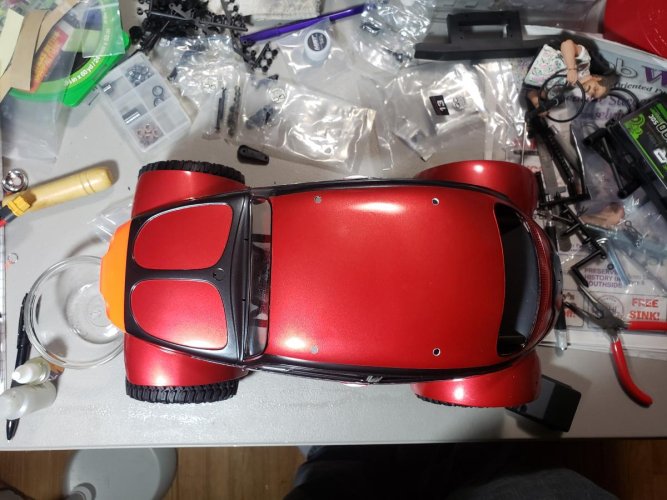

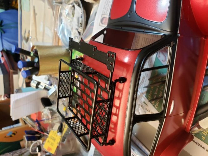

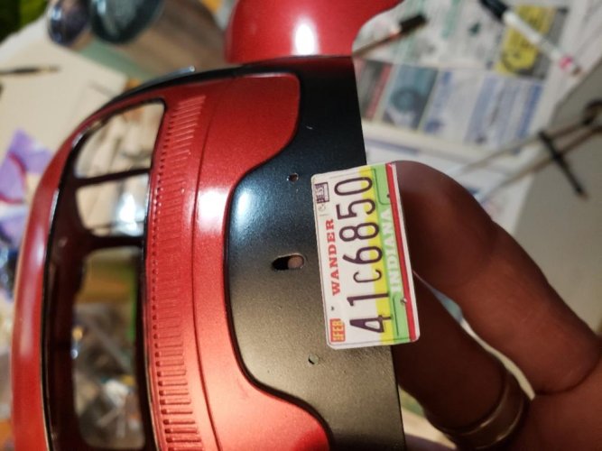

Turns out that the clear lenses included with the Scorcher body do not actually fit the taillight buckets. I planned on leds for the back anyway so I had to dig the plastic out and leave a small shelf for the lens to attach to as well as fabricate some aluminum plates for the leds to attach to. Finished the fuel filler exterior and backed it with some scale HR aluminum diamond plate. Also drilled for the roof rack that I painted to match body color. A shot of the license plate I made for the back, I printed a high quality inkjet photo and then trimmed the Tamiya plate holder down to the size of the printed plate. Coated the plate with a super thin layer of E6000 and I will use a photosafe waterproof sealer over the whole thing once the glue fully cures.

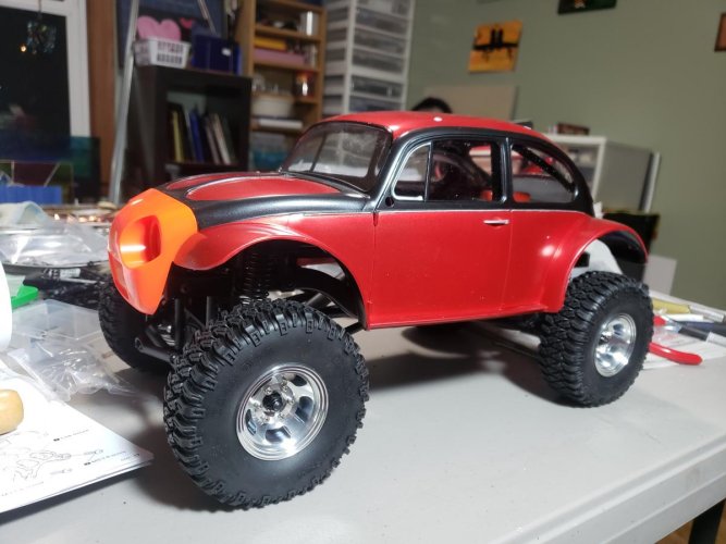

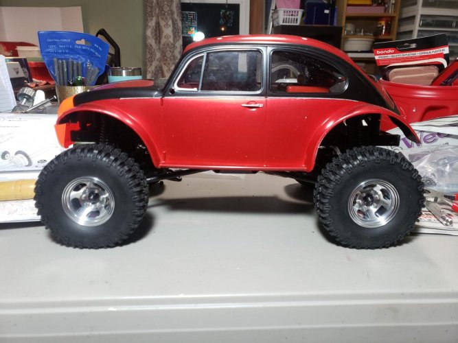

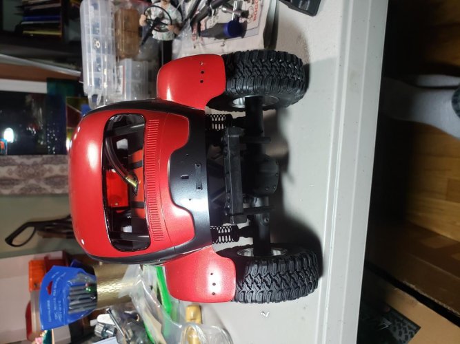

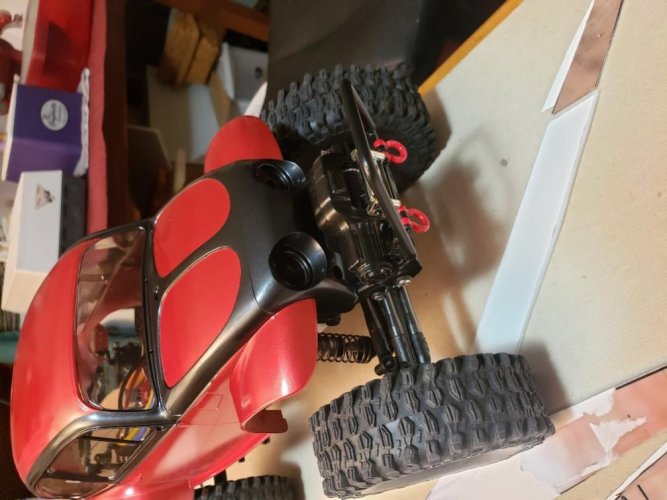

You can tell Im a newb by this mess of a build thread. Anyway, built the MST CMX and the wheelbase and track width were much better but I still had clearance issues with the chassis up front so I swapped the front and rear links and flipped the shock mounts. Im not sure if this is going to have a negative impact on performance but things finally look the way I want them to. Had to pick up a new nose since the modifications I made to the original wont work with the new chassis. Also picked up some 1.55 Gear Head slots and a set of Baja MTZ tires.

Yeah thats a nice improvement. Its hard to tell on the track width from those angles but it looks a fair bit narrower.
I used the MSA narrow axle set and I'm happy with the way they look. Here is the track width. Thanks for the feedback!

Yeah that does look good. Everything needs to basically be as narrow as possible with this body (well for the best results).

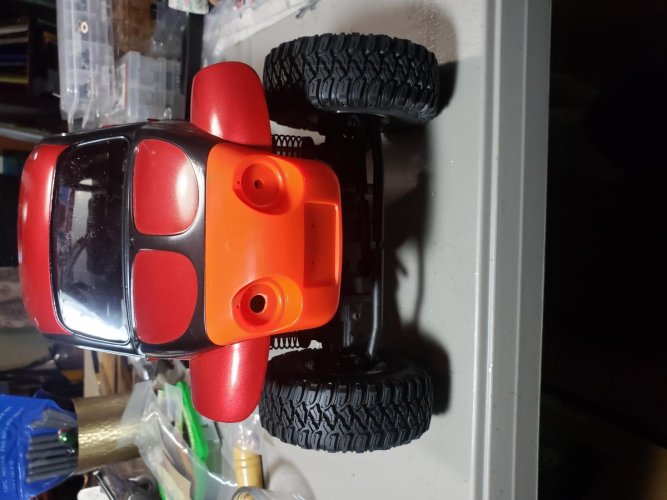

Its odd your replacement nose is orange, or was that painted first?
It is a Blitzer Beetle nose, it does not have the turn signal holes and has a slightly different side profile. The Blitzer nose is a little deeper so it allows a bit more room up front. I still need to paint it to match.

Really like it, but I just don't get the orange front...lol
As he stated - he's test-fitting an unpainted part... ;-)
