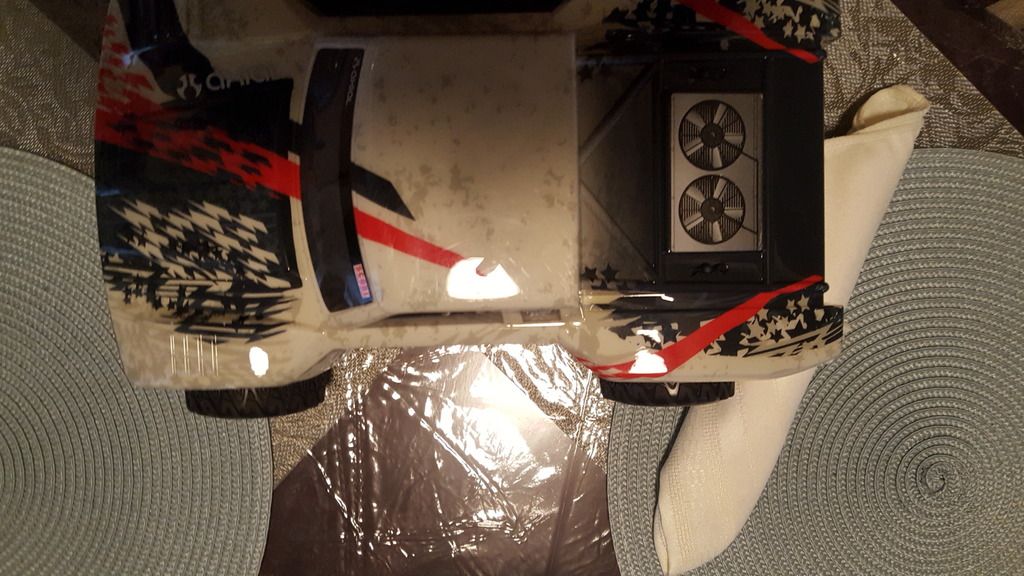

Here is a pic of mine with the Traxxas Latrax wheels,and mini rival tires,the added width,and traction helped tremendously, the hex hole on my wheels are tapped out to m4,so I can use my RC4WD wideners when my body shows up. It looks good with the TT body,but the tires look wide when looking underneath,but performance,over looks 1st!That's the servo saver I use for the mg90 servo,they have more than enough power,no need to spend alot on servos,and to ease up any binding in the steering rack,just back the screw out on the rack assembly,you'll feel it loosen up!

Here is how it looks with wideners,this isn't the body Im gonna be using,just to show the stance,it actuall handles really well now!
