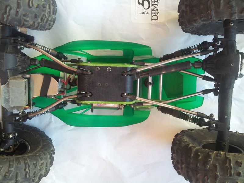

I swapped the bent links with the straight and it has made things not move side to side as much but the rod ends are still rubbing everywhere and limiting articulation quite a bit. On the advice of cboggs i tred putting the lower lins on the inside of the mounts and it just made the connection to the skid bind up more. Can anybody reccomend some bent rod ends that arent super bulky? Im putting more thought into just getting the vanquish links but im worried those ends will be bulky also.
fyi the links i have are the axial heavy duty aluminum links
If you look you'll notice 2 bends on front lower links mounted in stock ar60 location & Rears lower links have 1 bend closer to the axle links are mounted on the inside lower hole & shocks are in stock link location...
My upper links also have 1 bend in them. (I'll be swapping out upper links to 1/8" Titanium some time after Worlds)
Rig is free of any binding.

Then i put the ends on my vanquish links (was not fun with horribly arthritic hands) and bolted those all up to finally have an axle that has good range without feeling like it was fighting the chassis. Alot of people told me to get links from dlux and i have no doubt that they are great but i felt like i was loosing sight of the project i set out to do. Im not building this to compete with anybody, im building it to have fun with so haveing the best of everything isnt required. I do appreciate the advice and input of everybody but my purpose is not the same as most with this build. Anyway, pictures of links!
from the top
from the bottom

I have to admit that i was getting really bummed out with this build, people had sent me random links that didnt work out and then i got some stock wraith links that i thought for sure would work. After looking at tapped out's thread i got the idea in my head that the vanquish links would work out and im so glad it did. I still have some drive shafts and a servo coming from troy and those feel like huge bounds forward. I will try and take pictures of the back end coming together and of course i will take pictures when im done with it and have the front link/shock mounts on correctly.
Flip your upper links around with bend closer to chassis & bolt links to outside of chassis.
i dont know why but i always keep thinking the bends are for clearance so i have them up and down. I put the links on the inside since that was the only way they fit. I just did the rear the correct way and its working much better.
thanks for pointing it out"thumbsup"
i present to you RCC, a better functioning front end! Now with correct assembly!
