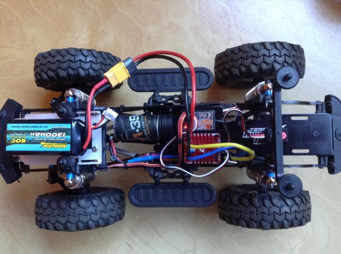

Installed one in my TT Kaiser XS project after PM discussions with Screamer. Had one run before I smoked the stock motor but could tell it was worth every penny. For the $$ it was excellent for this small a rig and I would have no problem putting it in a SCX. Very smooth, great brakes and stupid easy to program with the card. Until the motor let go I ran for just over 15min with outside temps at 71* and ESC at 83*. I'm running a small PHD 1050 at 6v and a sub 4lb RC but would not blink at running the BEC at 7.2v.
Is it a MMP, Holmes etc? No but damn close and for $40 it is a no brainer IMO.
You might want to blink... Lol
'cuz the 1080's internal BEC choices are for either 6.0v or 7.4v... not 7.2v
The internal BEC is only 3a tho'
so not sure if my amp hungry Savox servos won't be starved
or cause RX issues when plugged into that ?
Guess one should be sure their RX is up to handling 7.4v run thru.
I know mine will handle 8v... but not sure about my Savox servo's amp draw run thru the RX ?
Think I'd need stick with utilizing the HH's "Y" RX by-pass adapter.
