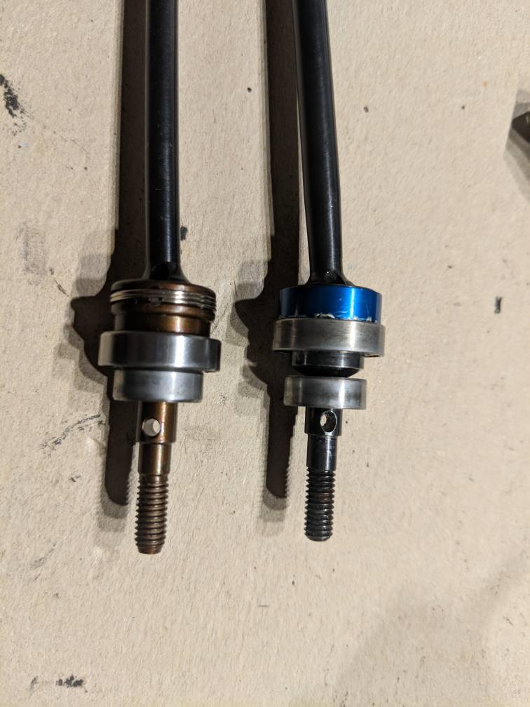

Did some little maintenance on the front. I did mention a longer time some slop in the axle stubs. Found the issue.
My incission vdi have a large gap between inner bearing and the outer bearing, approx 3 mm. But the knuckles fill only 1 mm of this gap so there is a 2 mm slop by design. Or did i Miss something?
See picture compared to the gpm cvd.
