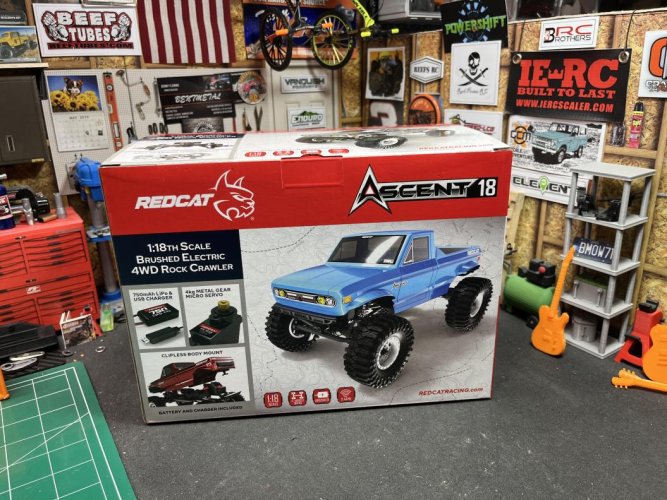

Mine arrived yesterday. Ship date was last Saturday, but USPS sometimes finds a way to make me upset.
Anyways, at first glance this lil' rig looks great! It seems to be built well. I really never thought I would say that about Redcat since I've never been a fan.
We'll see how it does when I get some wheel time.
