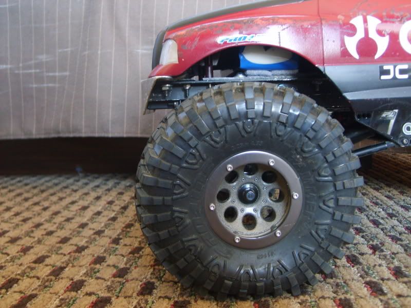

I made my Tall Irons, and from 6x flat irons, 4x hammers, and 1x rock lizard I got 4x 5.5" Tall Irons, and 1x 5.2" Spare Iron.
Then, I narrowed and painted some Axial 8-Hole beadlocks, painted them grey. Also cut some custom 5.5" x 1" foams and stuffed two per tire and mounted it all up. (No weight, for now, but I am thinking of putting 4 oz in each front and 2 oz in each rear...)

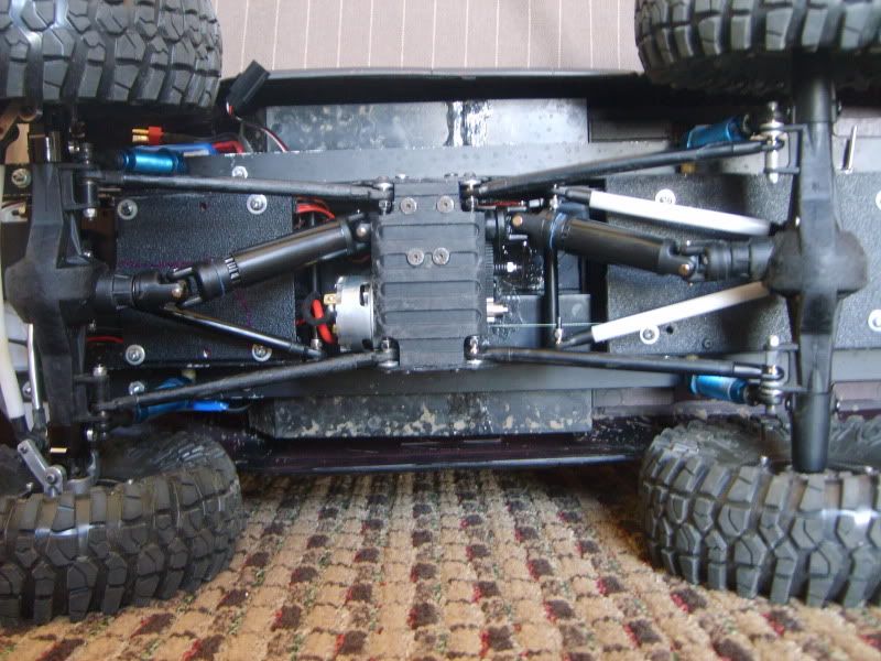

I drilled out the Axial outputs and installed a solid 6mm rod so that I could install some E-Revo driveshafts (damn those things are huge, won't have to worry about breaking anything there.) I also drilled a 2.5mm hole in the Axle Input shaft so that I could use the traxxas screw that came with the E-Revo shafts.

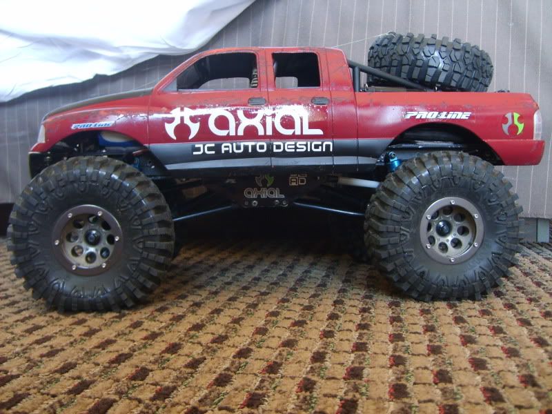

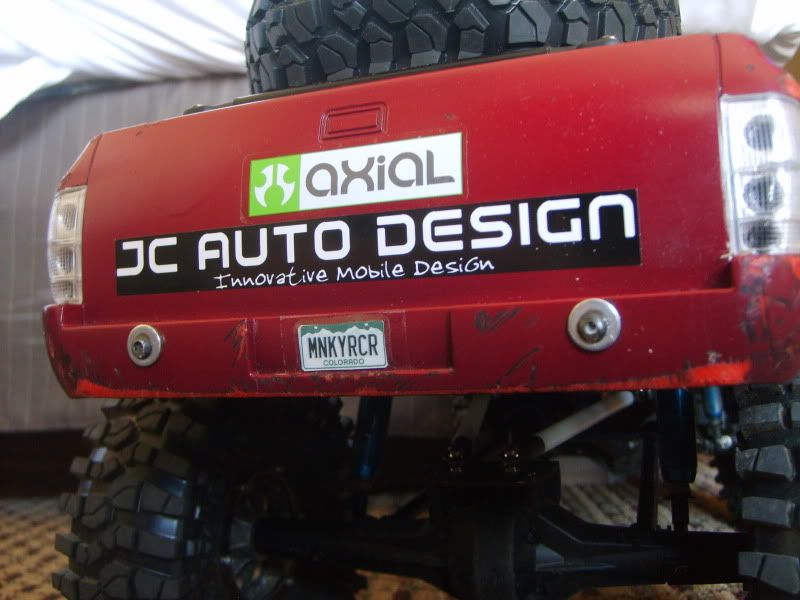

I added some graphics to the body; a few Axial, Proline and JC Auto Design stickers, as well as a custom license plate. I want to go get some Race Numbers (Number 34...), and a few Traxxas decals to complete the graphics though.

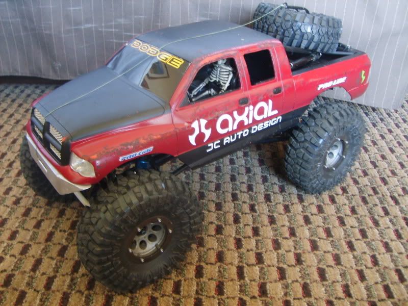

Ok, no Moab pics, didn't have time to bring the truck out, but we'll be back in moab this weekend on the way back to CO, and I plan on getting some good pics then... For now, here's some hotel pics:

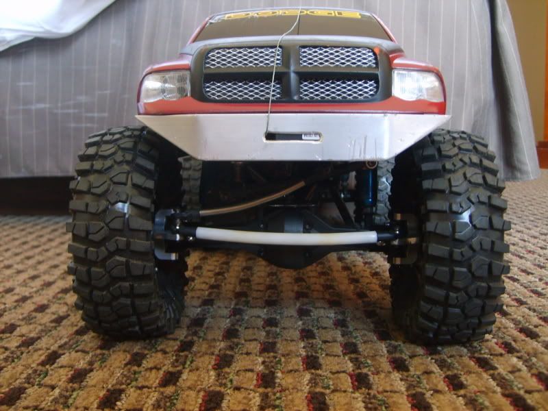

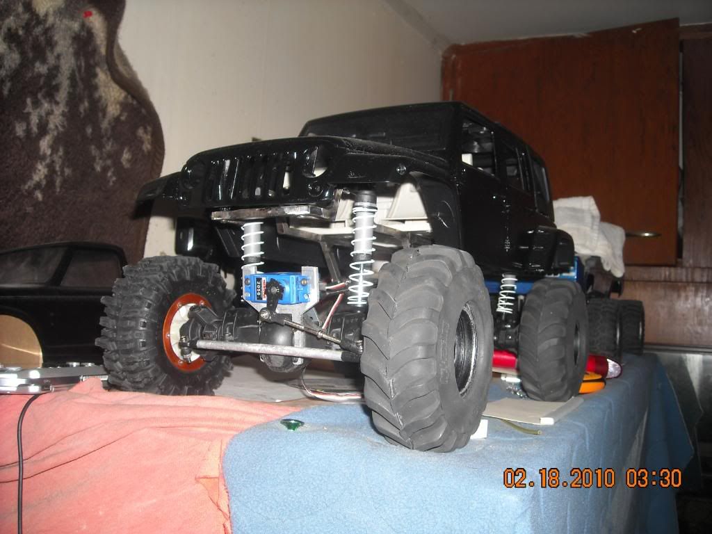

90 degree approach angle:
Revo Driveshafts:

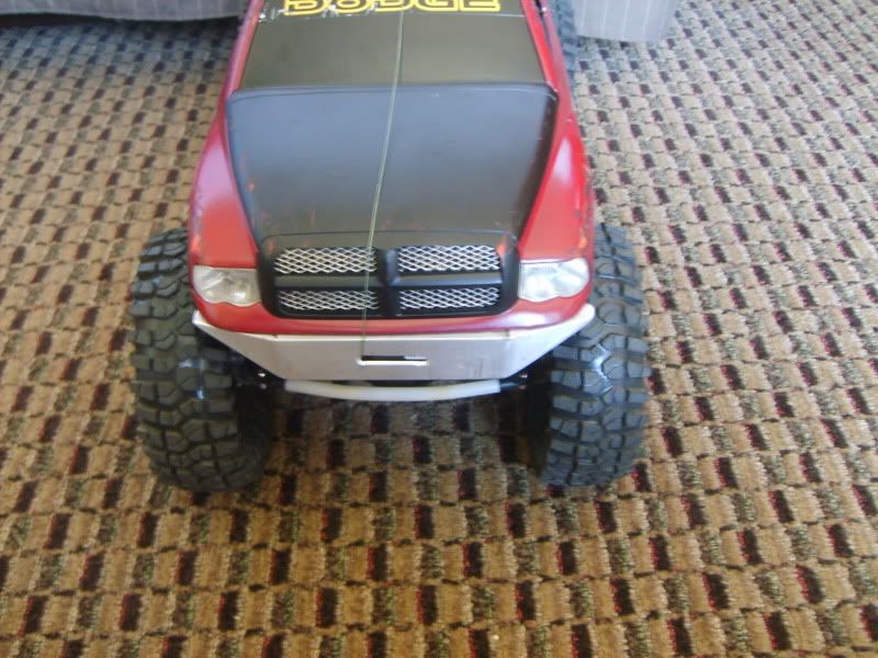

Tall Irons:
Width with Tall Irons:
Those tires turned out great "thumbsup".
I like how your graphics job turned out also.

The tires seem to work well, at least from the little bit of testing I've been able to do, and they were half the cost of Rok Lox...
There are still a few more decals I want to add like number plates and some traxxas and maybe a rockstar decal on the hood. (Rockstar may be cliché, but I drink a lot of it, and almost always will have one at a comp.)
I didn't want to just throw decals on, only companies I use in/on/for the truck. Too bad it's not real sponsorships, it would be nice to get free stuff for it.

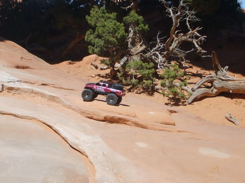

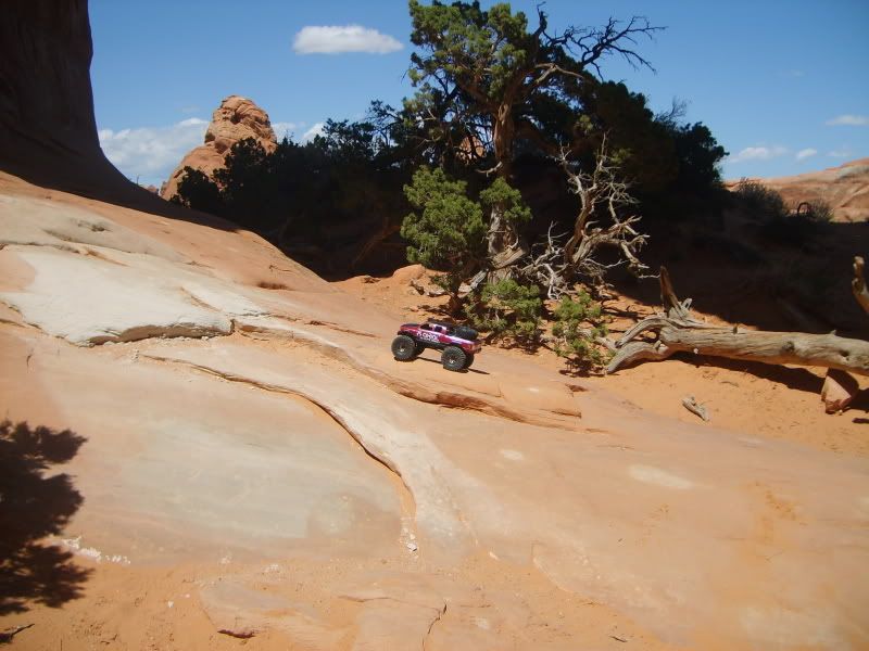

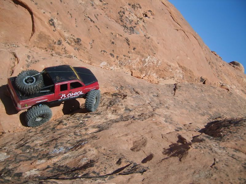

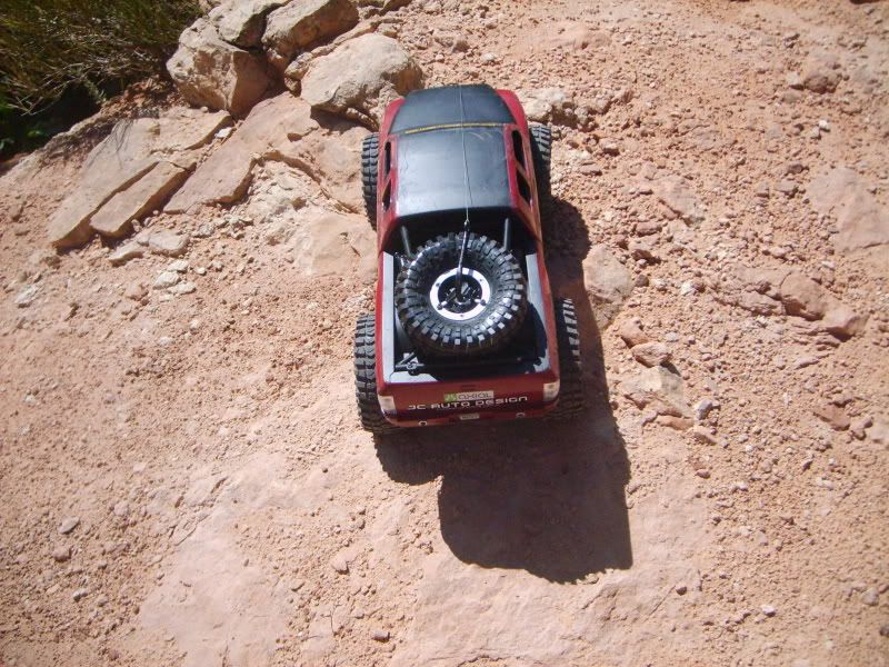

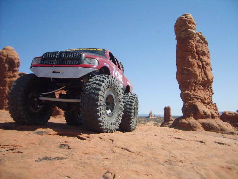

Finally some rock pictures!
And my Favorites:
I've got to get started on my to-do list (I posted a few posts back) when I get back home...
