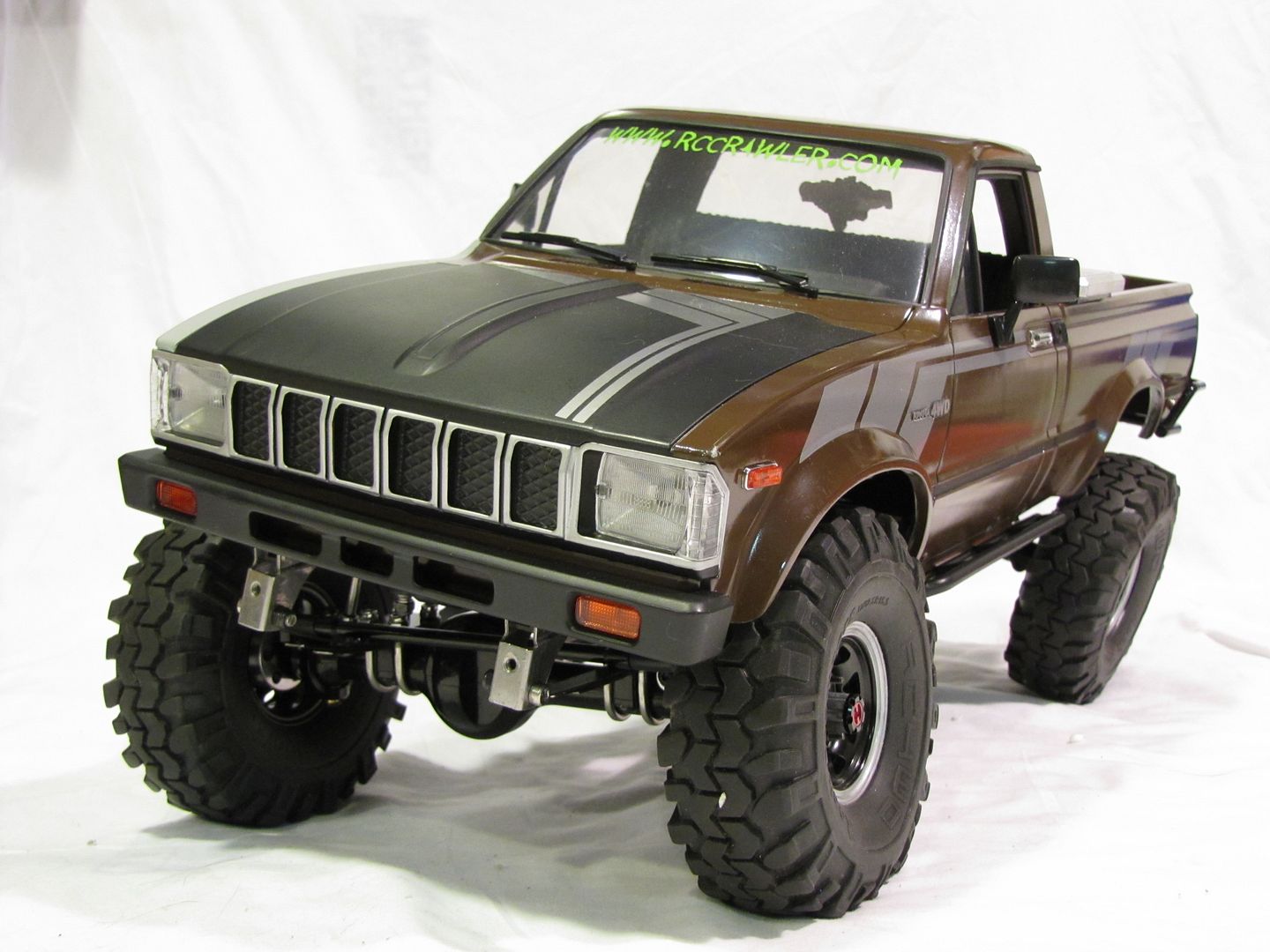

Update! Its a RUNNER!

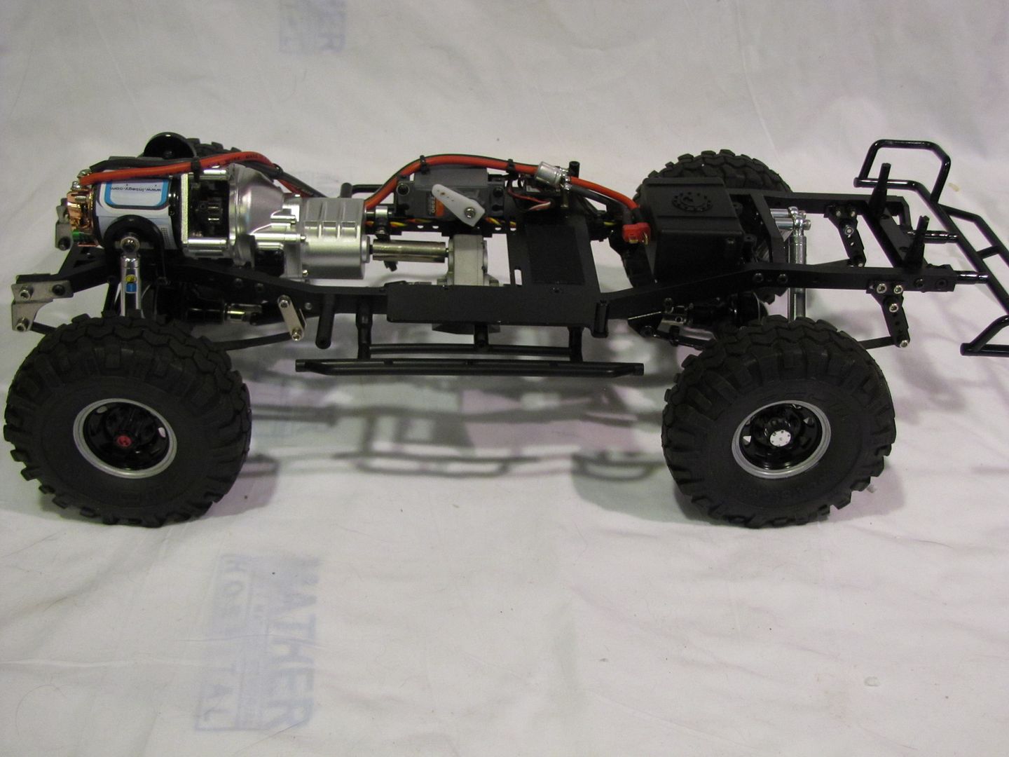

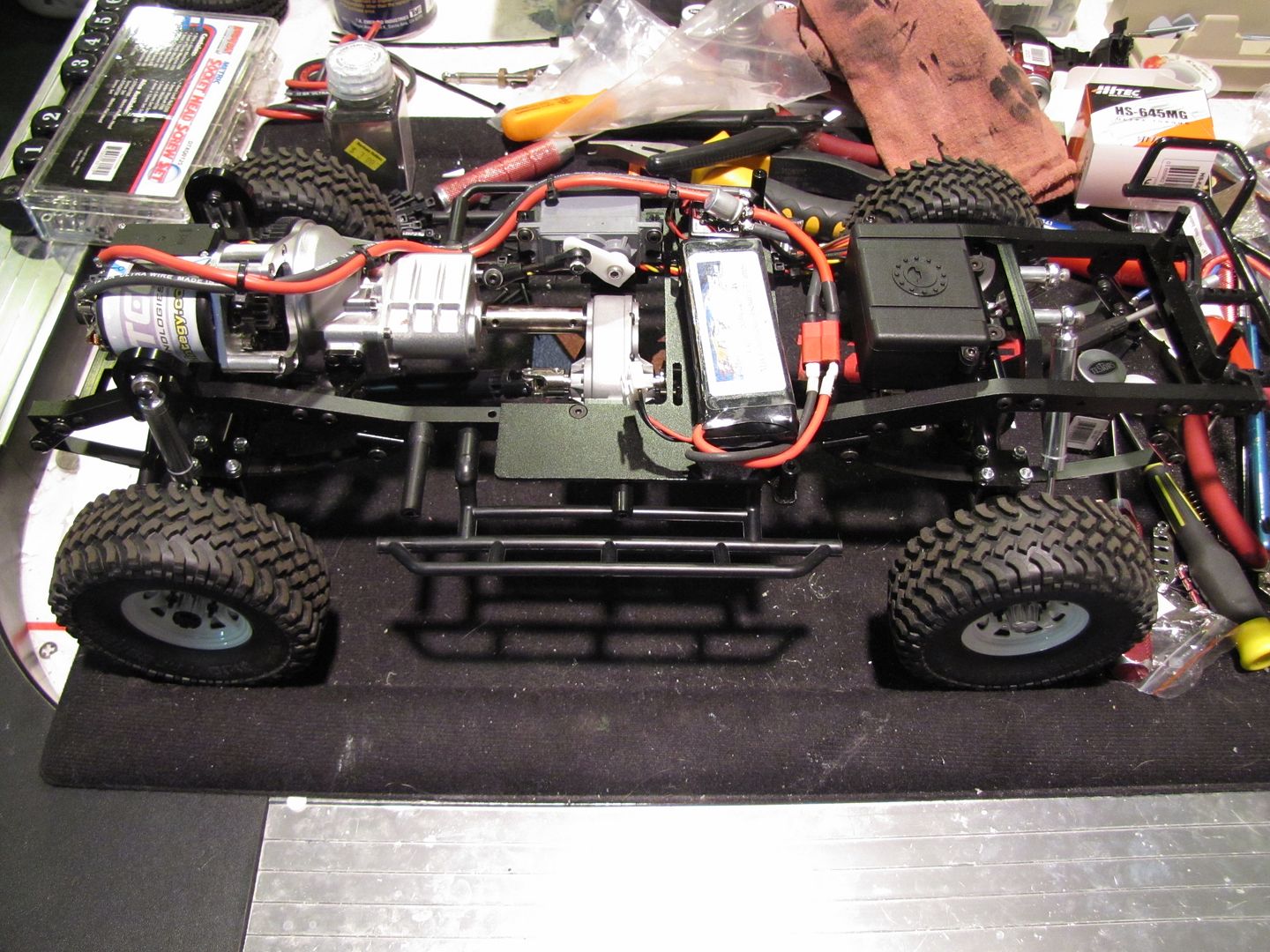

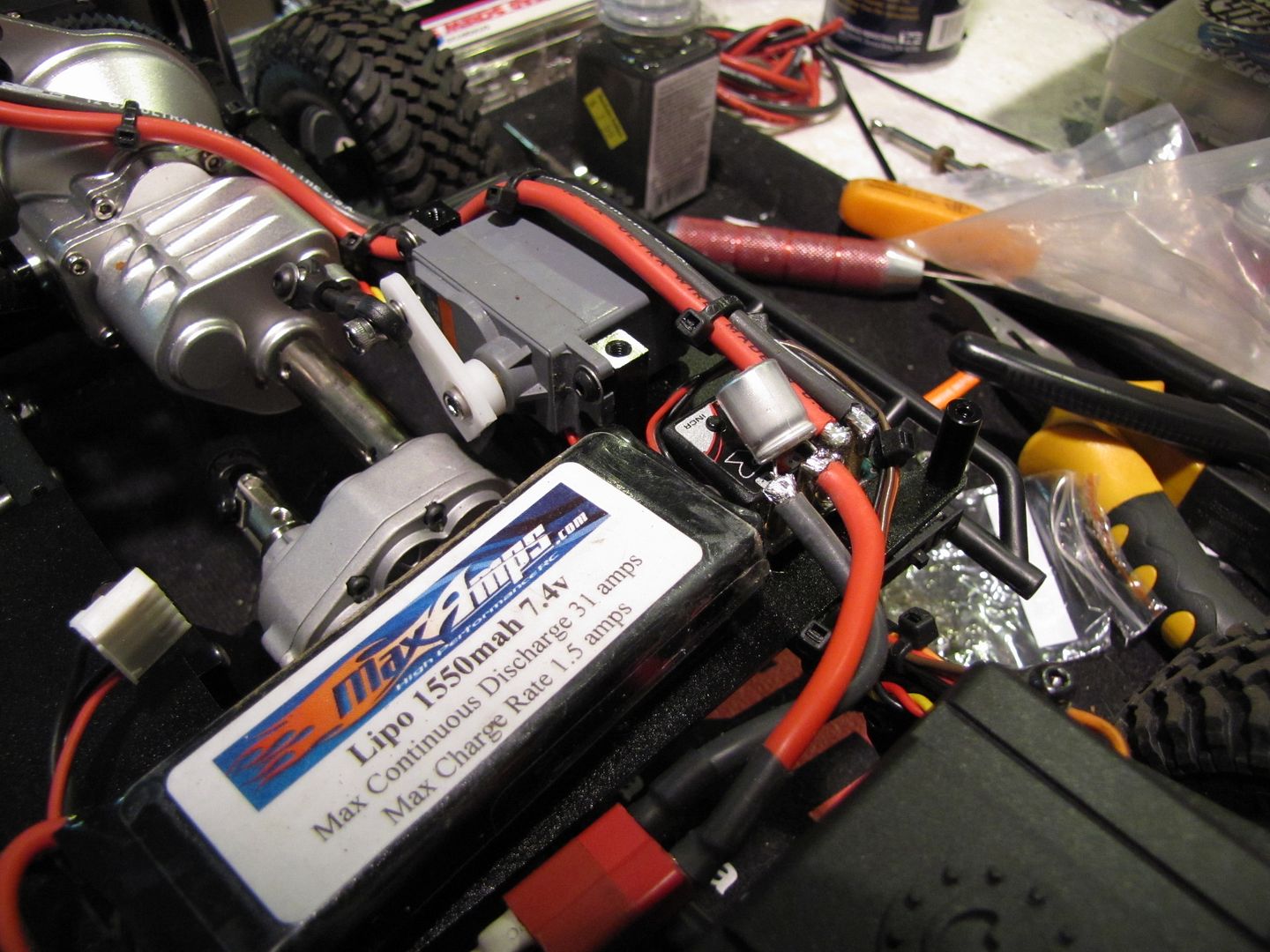

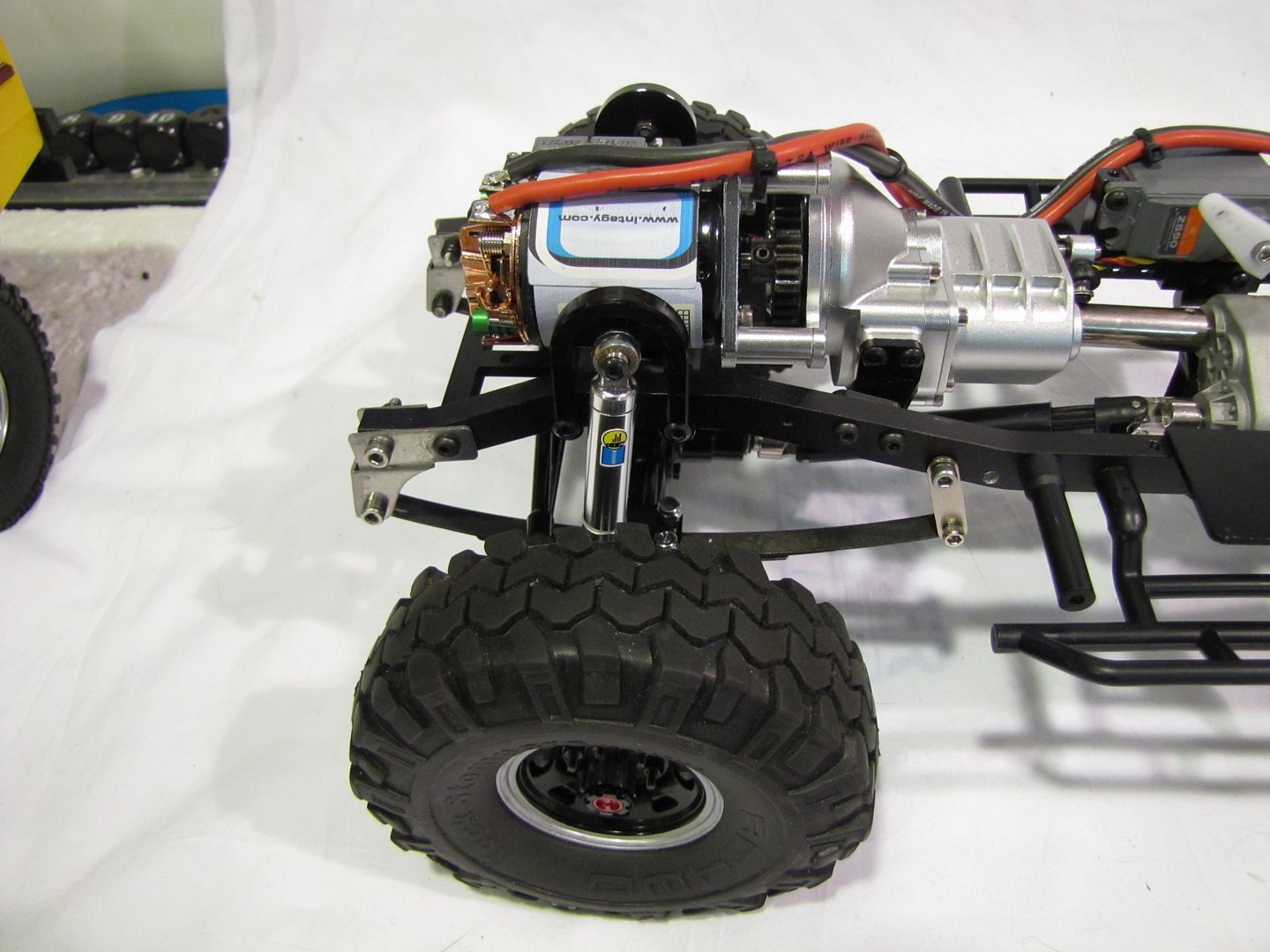

I robbed my SCX10 Comanchee of its 45 turn motor and Tekin FXR ESC. Found a JR590Z servo (overkill) for the shifting duties. A hitec 645 keeps the steering under control. You can see how I nearly routed everything.

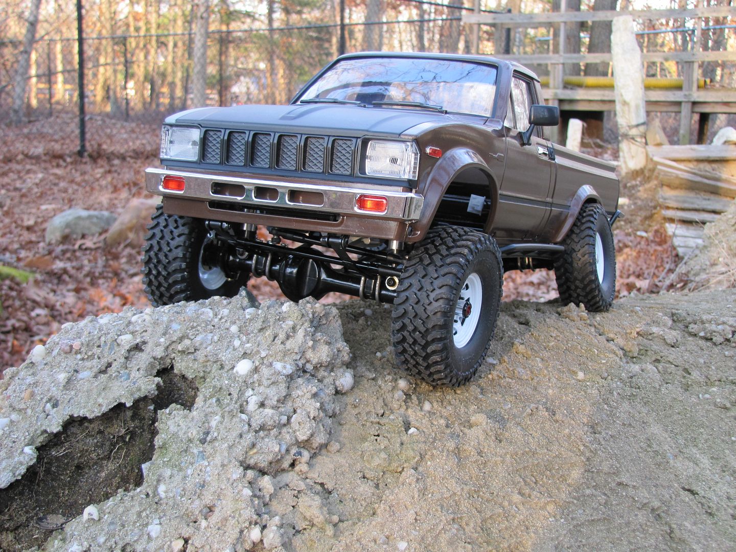

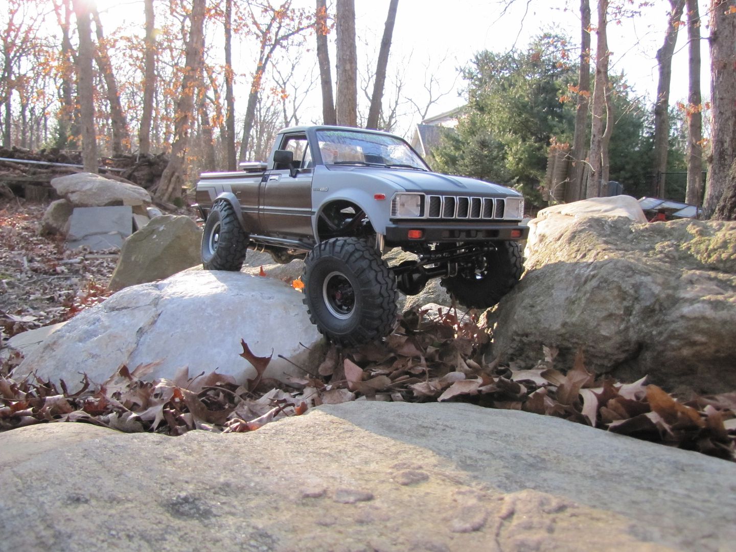

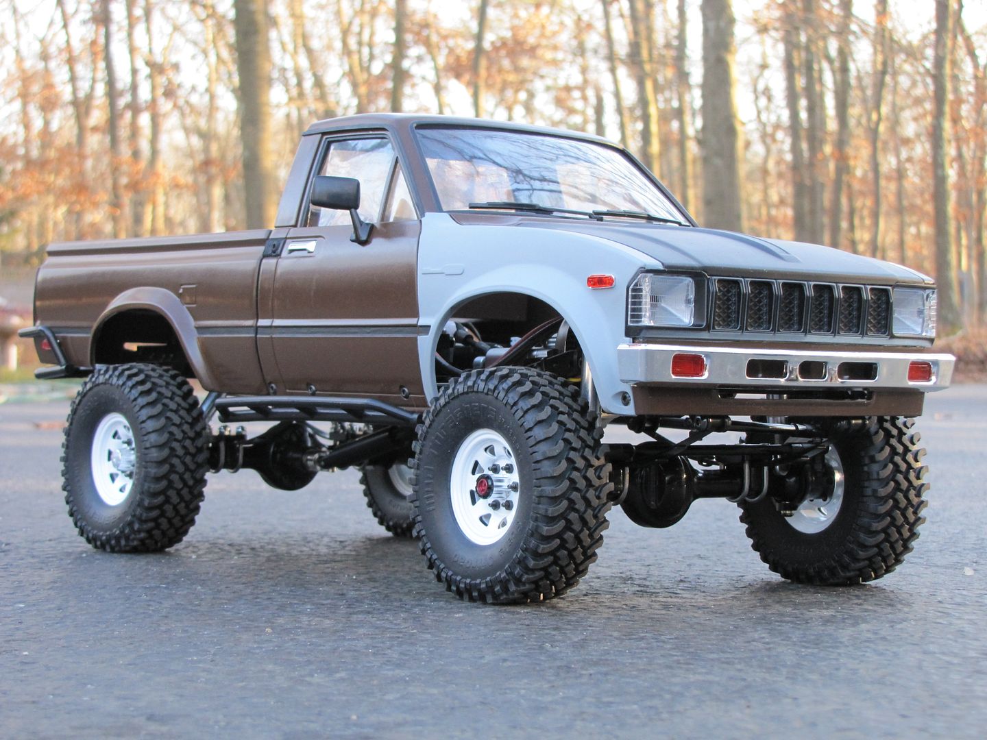

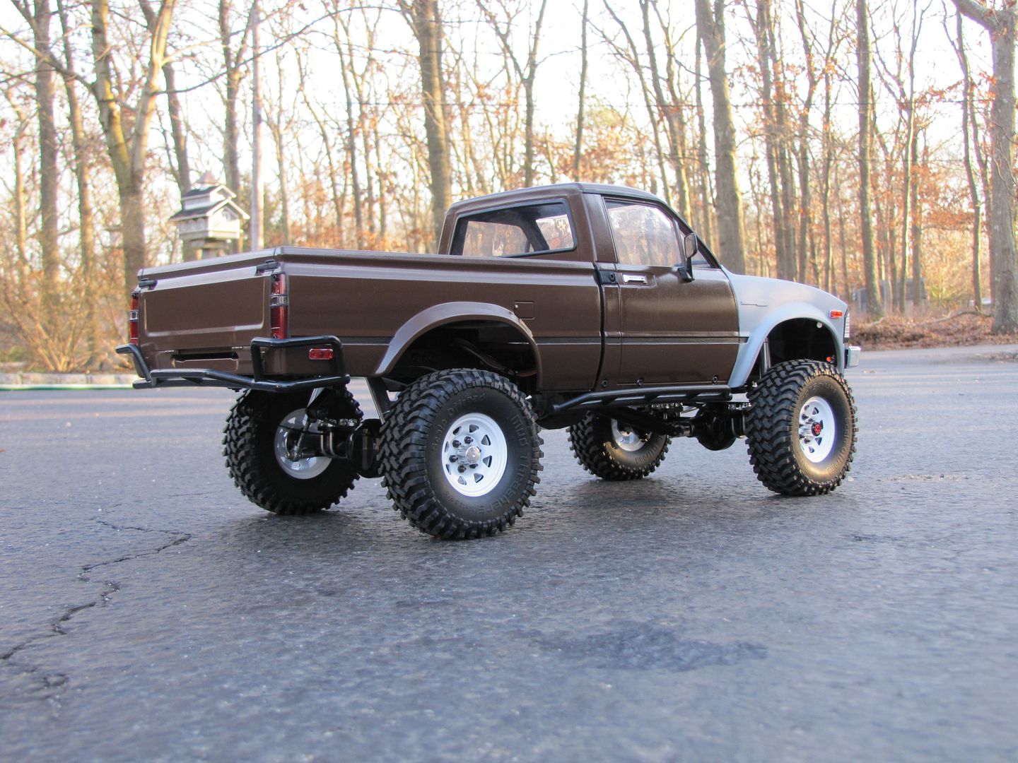

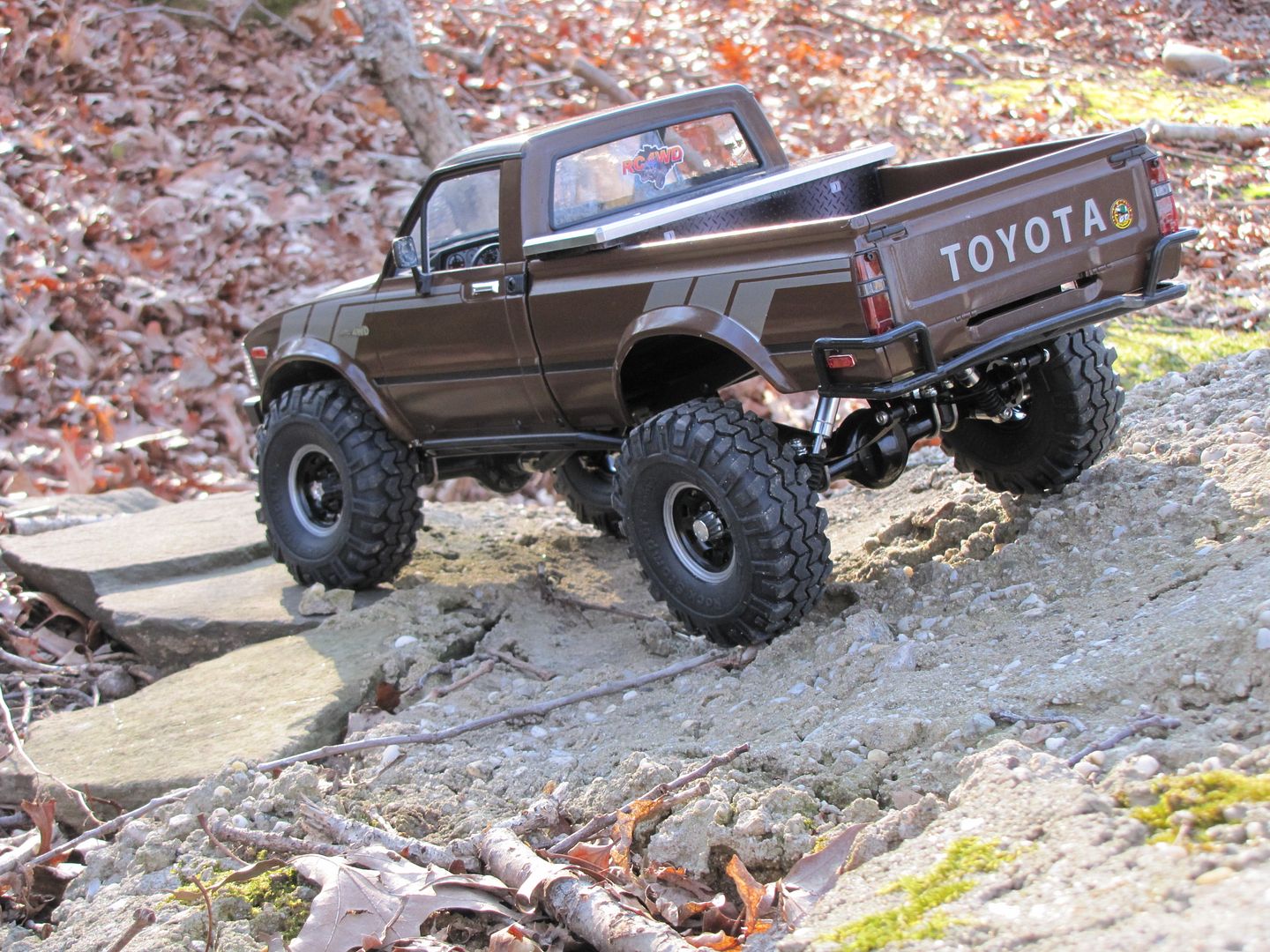

And Finally out doors to do some test driving, 1st a few posers
I think this picture is real good, if it had inner fender wells it might have been damn near perfect!
Unfortunately my scale course is COVERED in heavy amounts of leafs. The truck had no problems plowing through them, but it was hard to keep them from sticking to everything and trying to get some good scale pics.
I started loosing day light fast and the sun started glaring all my pics so I headed back into the house.
1st impressions are real good "thumbsup" The ultimate yota axles have never giving me any issues in any of my rigs in the past. The trans shifted MINT every time. I did not try shifting it on the fly but every time I stopped and switched it engaged right away. The tires are very gripping and the truck had good wheel speed with the 45 turn...although I think a 35 turn would be best (have some on the way).

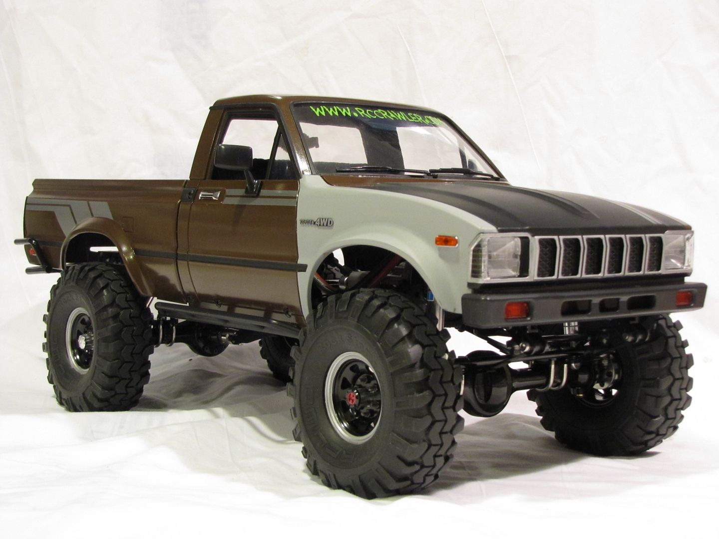

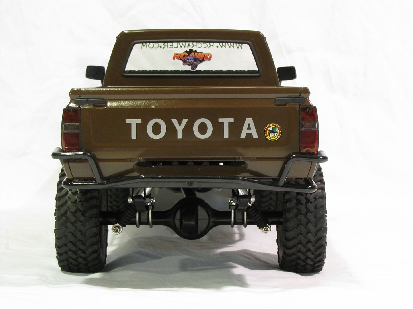

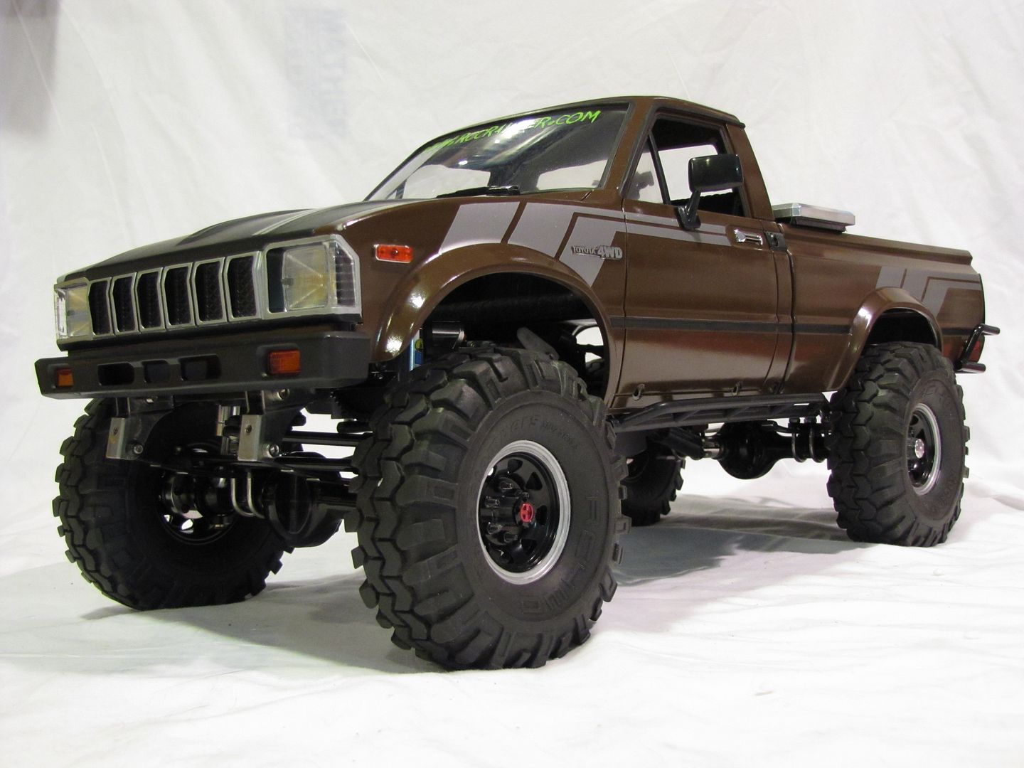

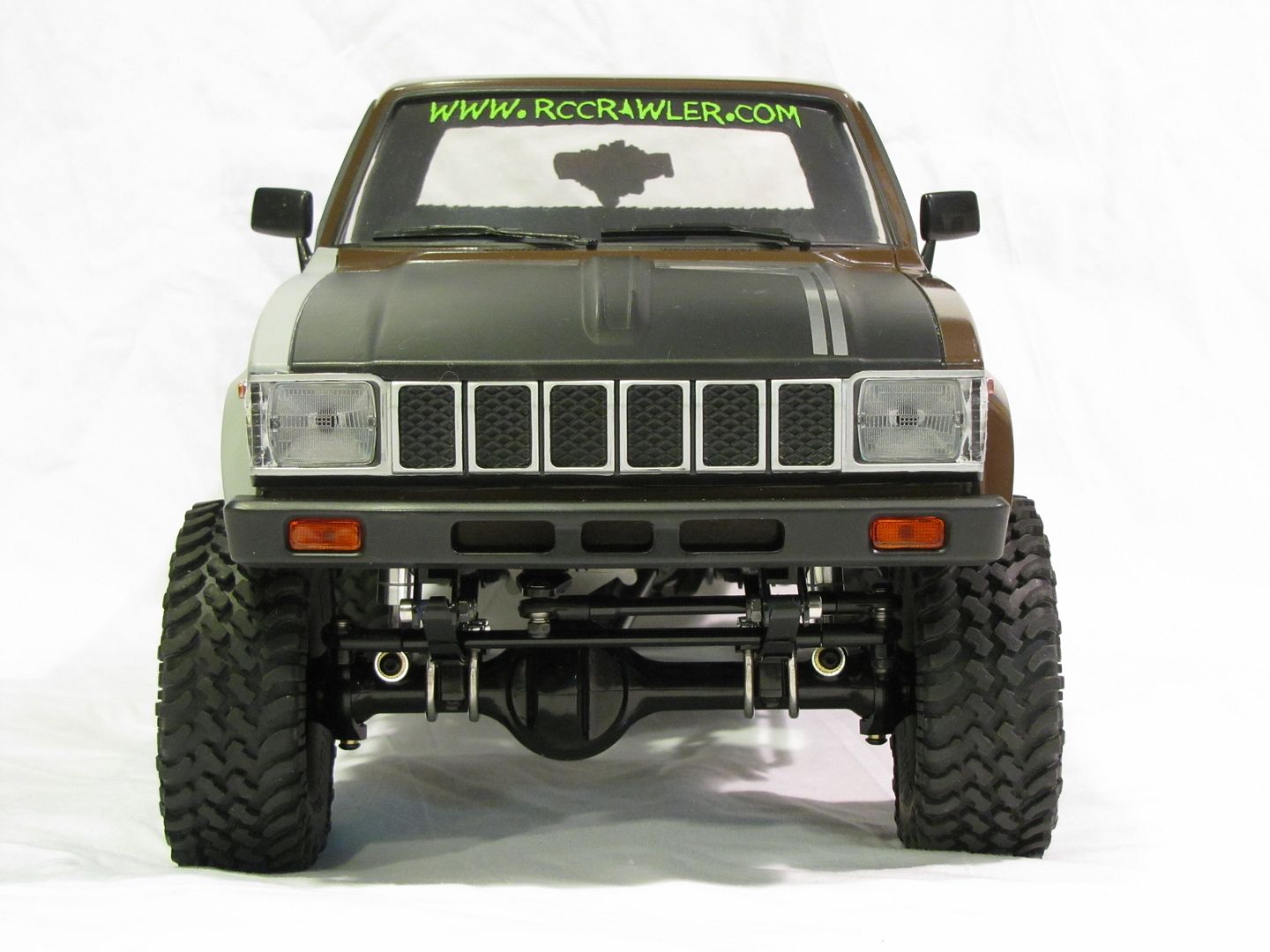

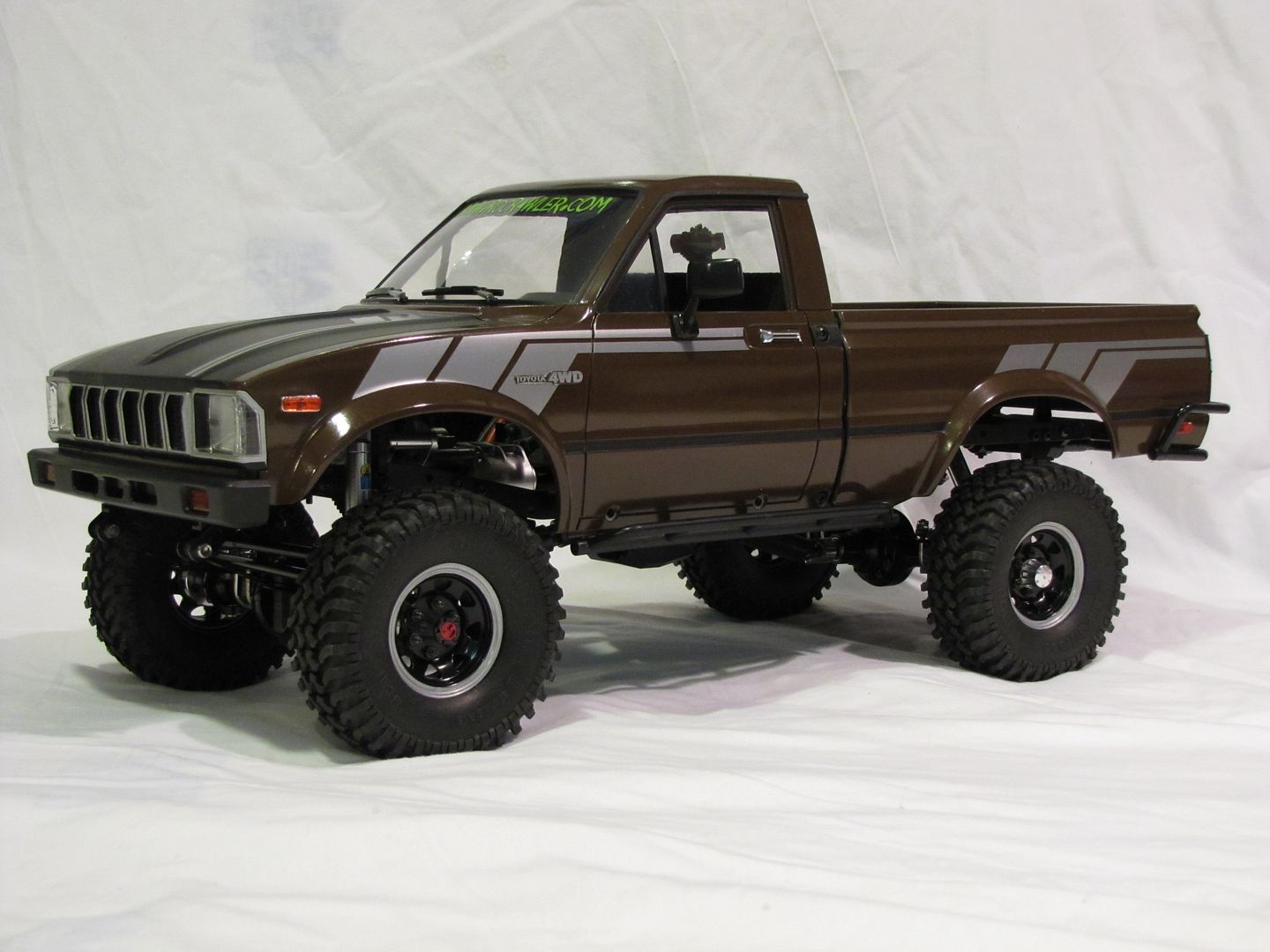

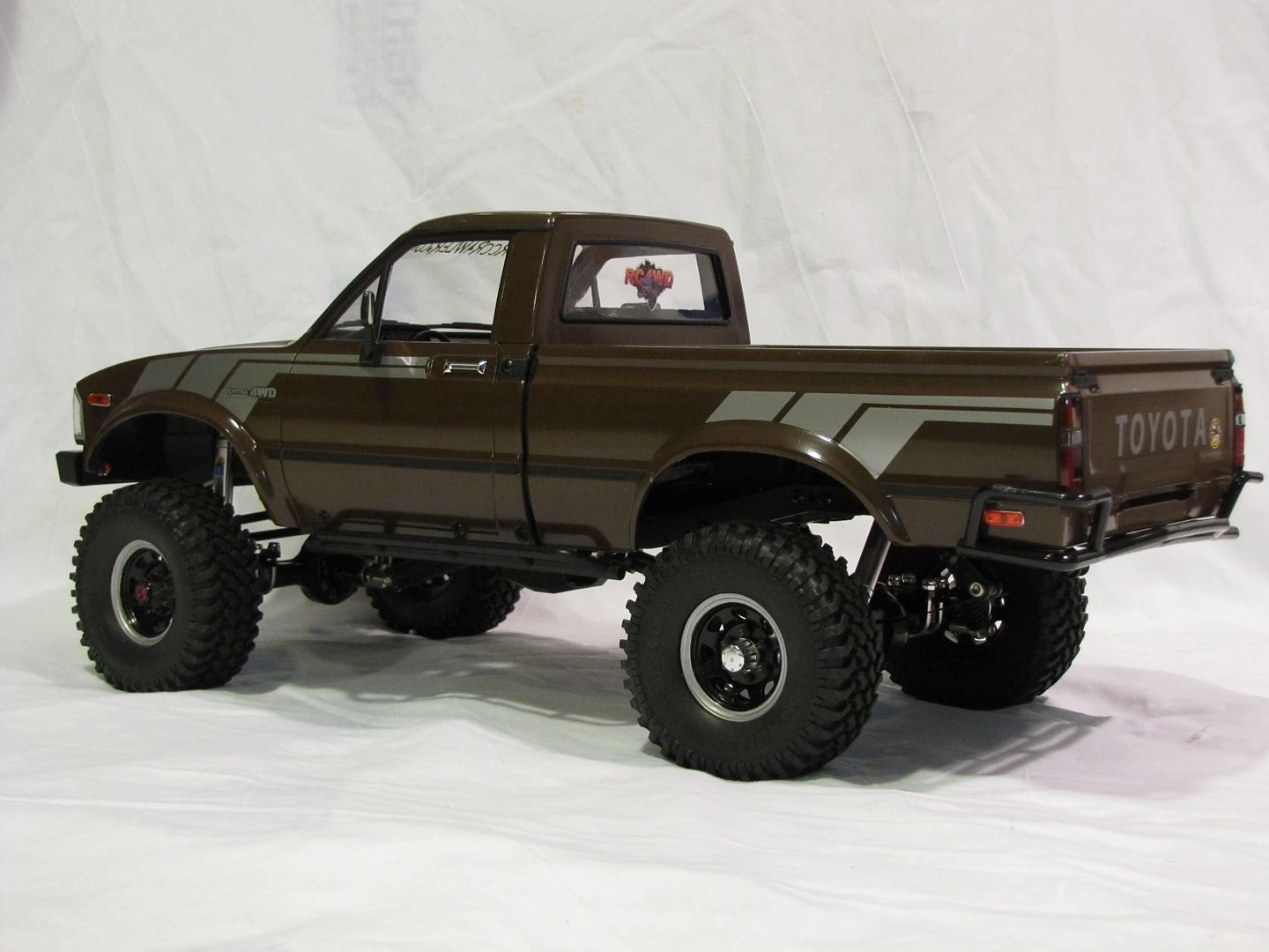

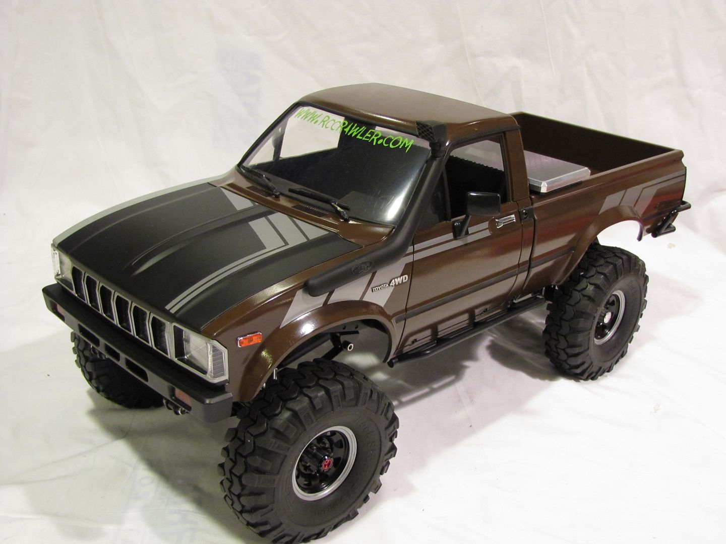

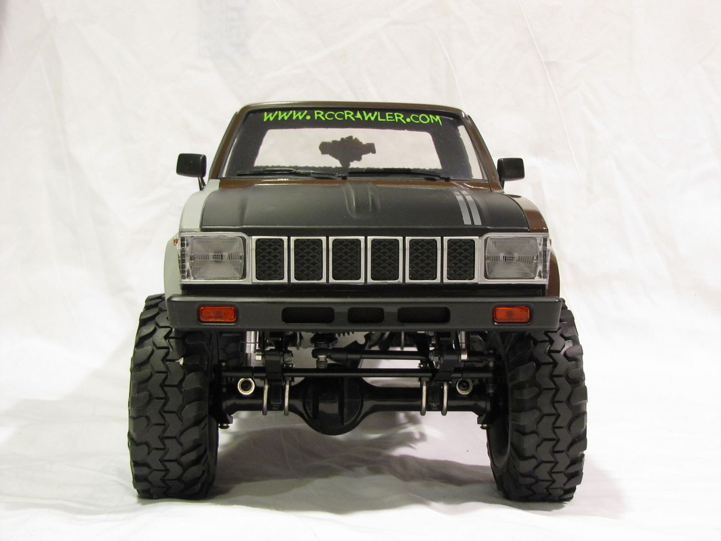

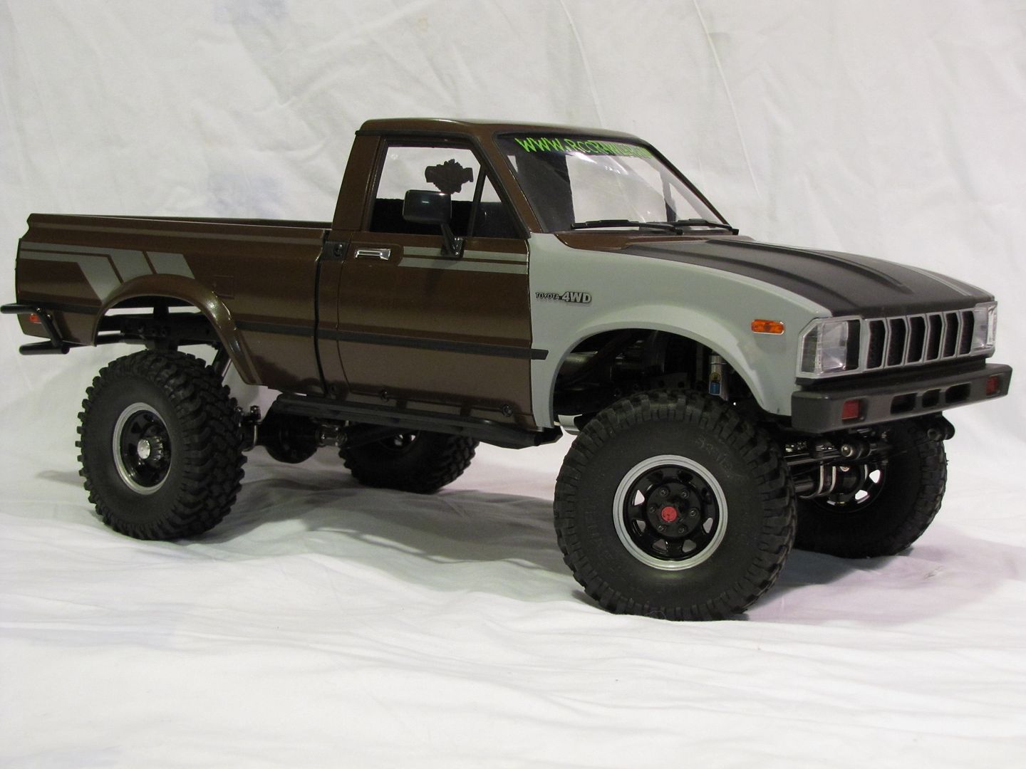

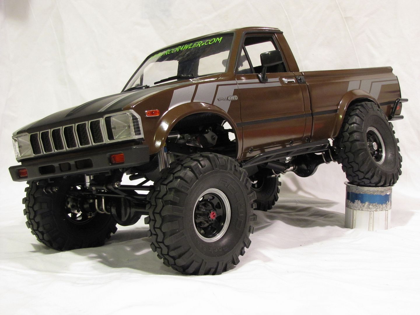

Been working on this the past 2 days...Here is what I have done:
Dready Slider mod (knocked 5cm off of them)
Trimmed lower valance and fenders accordingly
Stripped chrome off of front bumper
Applied SR5 silver stripes
35 turn pro lathe motor
Upholstered Brusier bench seat
Swapped in black version of the same wheels with silver stripping
Detailed grill
TOYOTA tail gate badge and marlin sticker like my OG had

Looks sick Mike..!! Almost as nice as the original ( Almost..!! :mrgreen:)
Re: 1BadJeepBruiser's RC4WD Trail Finder 2 The OG Brown Yota scaler wannabe
Very Tidy"thumbsup"
I like that, just not quite as much as the original ;-)
Perfect, looks spot on. Now I have to have one of these for sure.

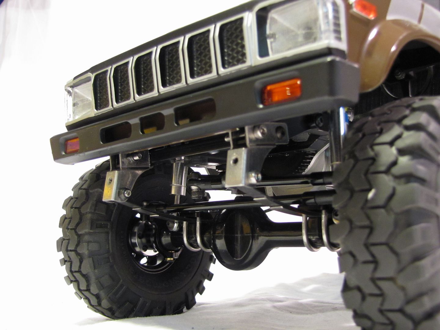

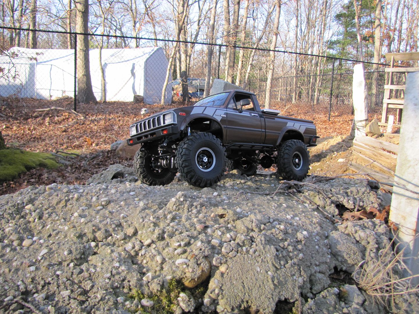

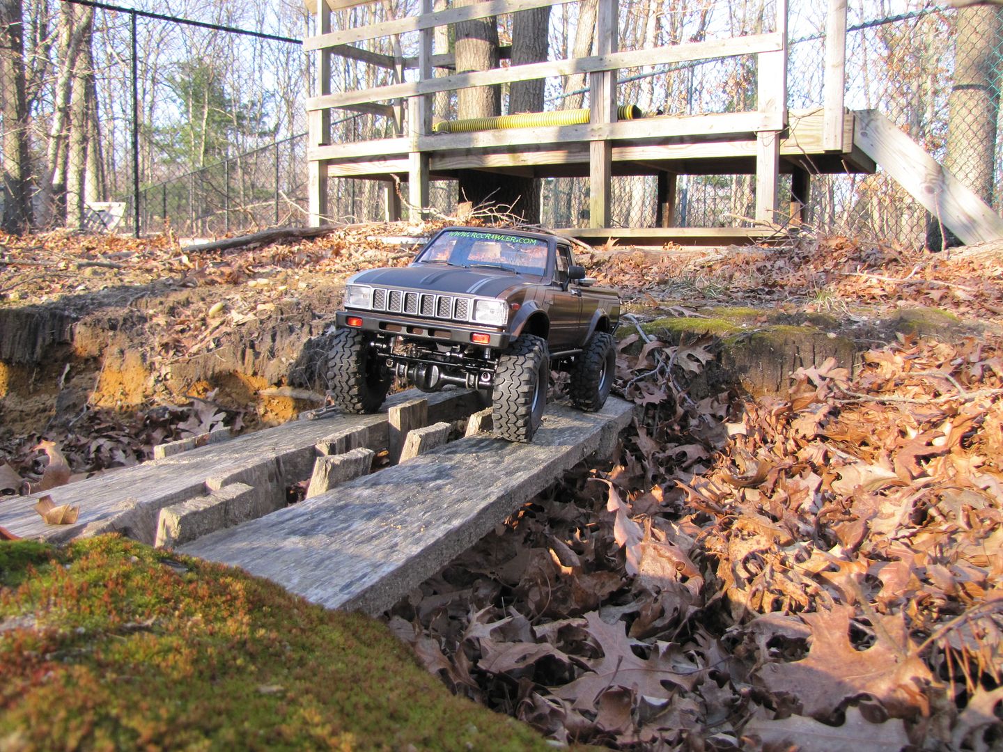

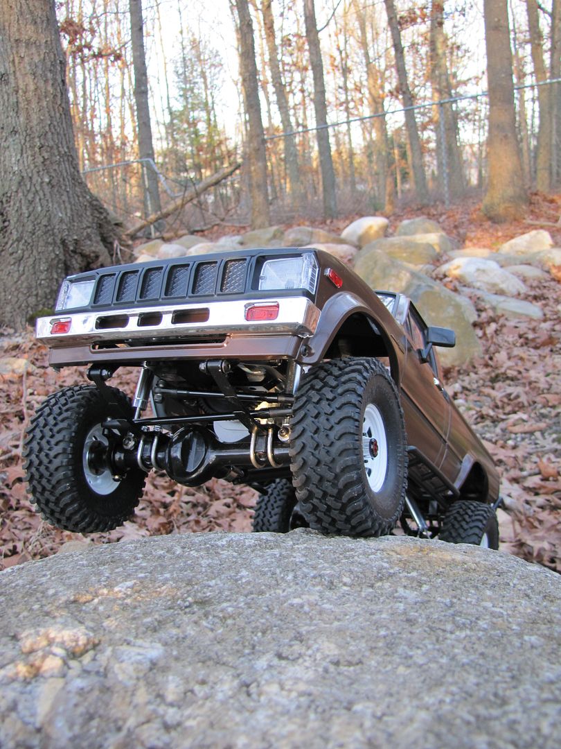

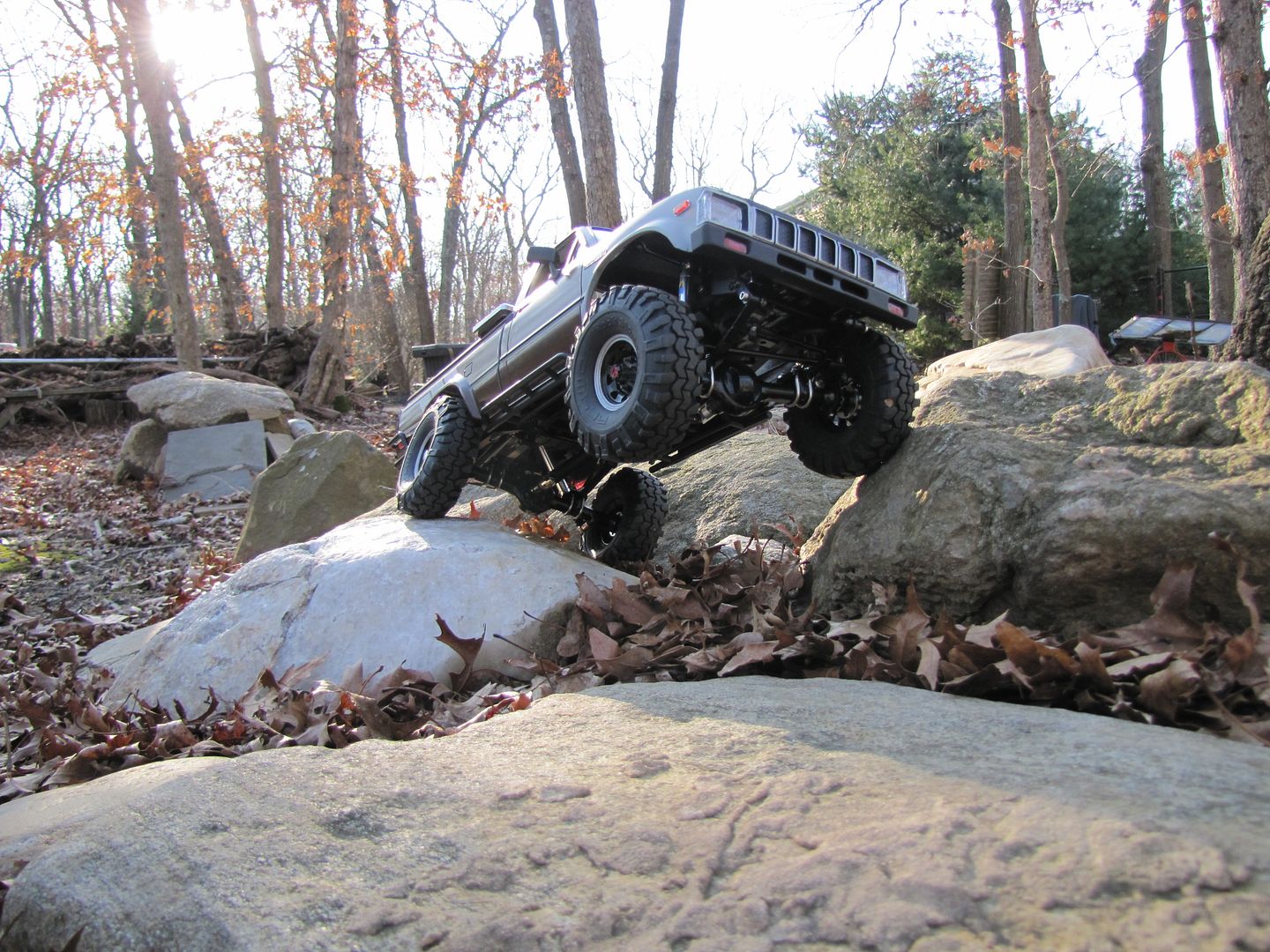

Back out on the trails to give the stompers and weighted wheels a try. Huge improvement! Larger tires allow for better GC so I didnt catch the cross member as bad.
3 wheeling
Why wheeling and taking pictures gets you into trouble :x Lost the mirror on that roll
Broke a hub:evil: I thought the stock toyota hubs were suppose to be stronger then warns :ror:
quick video
couple of stills

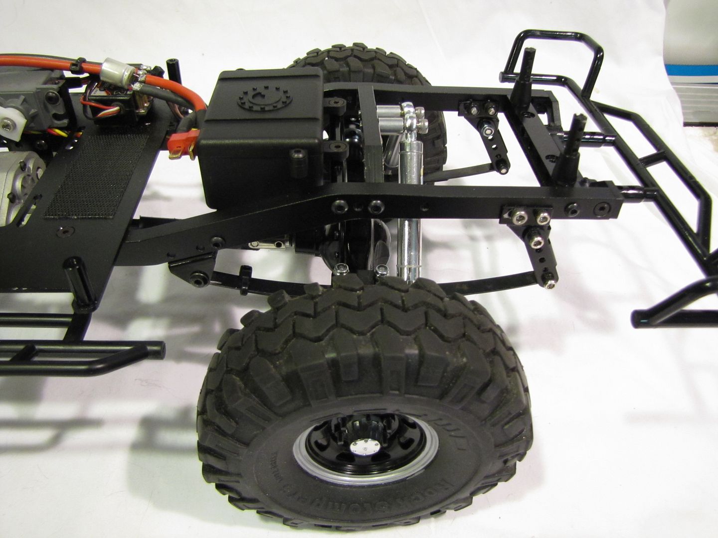

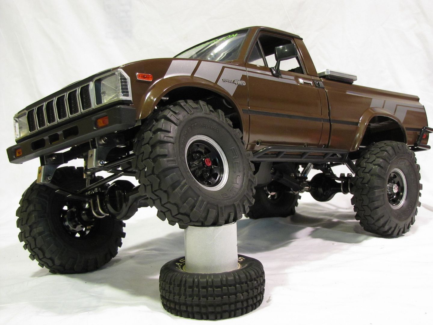

Today task was making it so that the leaf spring hangers were in the front and the shackles in the back...like 98% of yotas out there. I did this using OG Bruiser suspension parts and some 2/3 cell battery bars for shackles. The Bruiser hangers just need the one back corner trimmed off. Other then that, they line right up! I also pushed the axle forward on the leafs. The front leafs are chino leafs.
I also changed the rear suspension up, again using Bruiser suspension. I did not modify the holes in the frame, instead I slotted the one hole in the mount of the Bruiser shackle hanger. I also slid the axle forward as well in the back and I am running a bastard pack which includes a Bruiser main leaf and 2 chino leafs for helper leafs.
Flex seems good so far, they will need to break in some but I am overall happy so far
