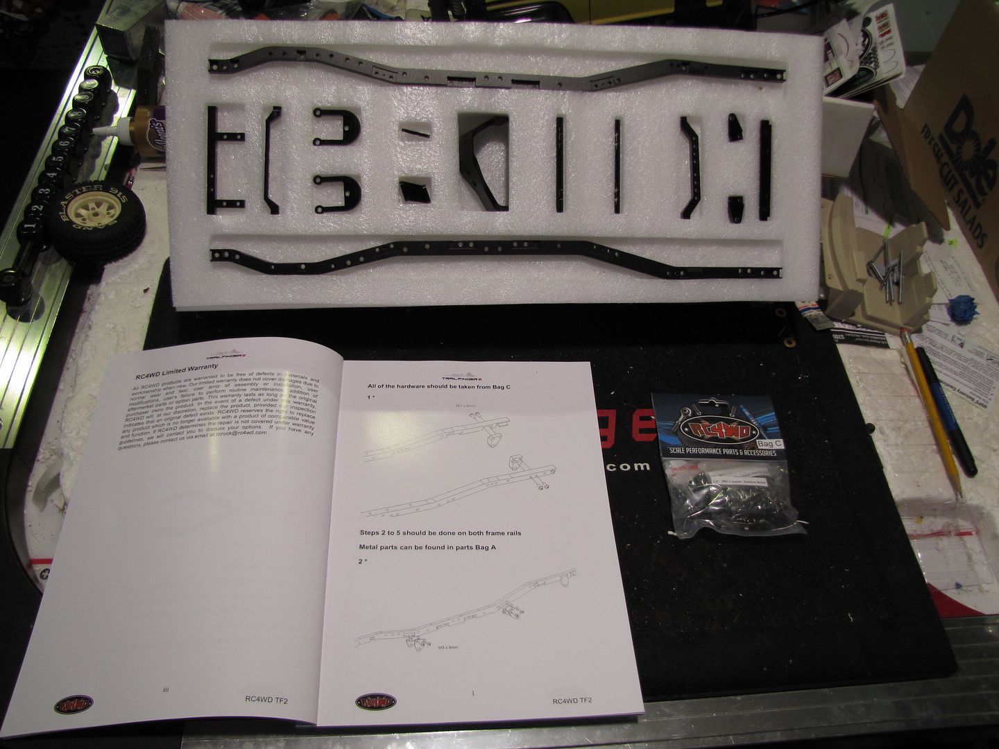

I was one of the lucky RC4WD Team Drivers to obtain the new Trail Finder 2.

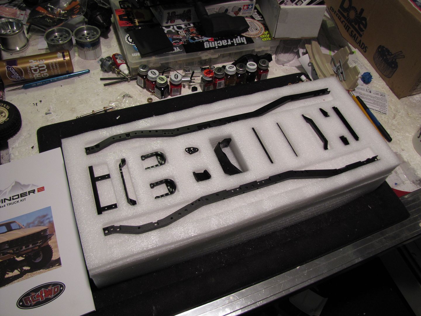

Awesome box art and packaging
printed detailed instructions

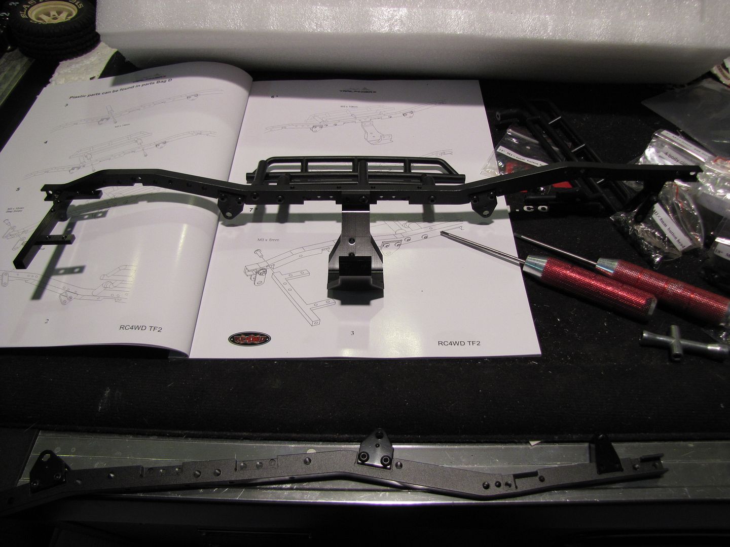

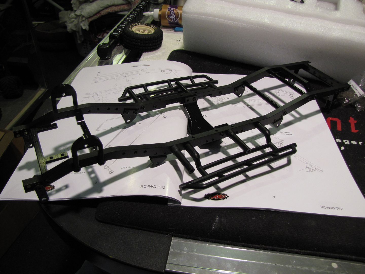

chassis rails
Axles, Trans, Tcase, Wheels and other goodies
Cleaned off the work mat, time to do some work!
Hardware bags are all nicely labeled
Marlin Crawler type sliders
With just the right amount of pitch
Cross member and leaf mounting points in

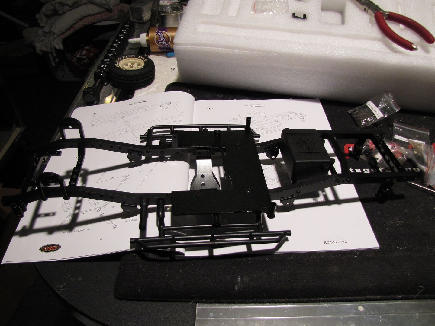

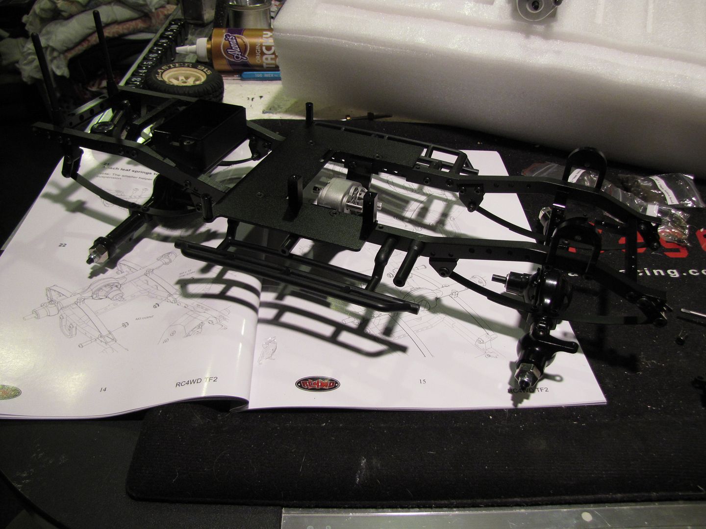

Chassis assembled

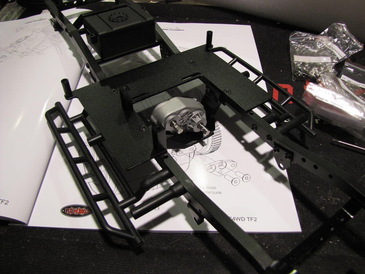

radio plate deck
super scale looking Tcase
Beefy 2 speed transmission

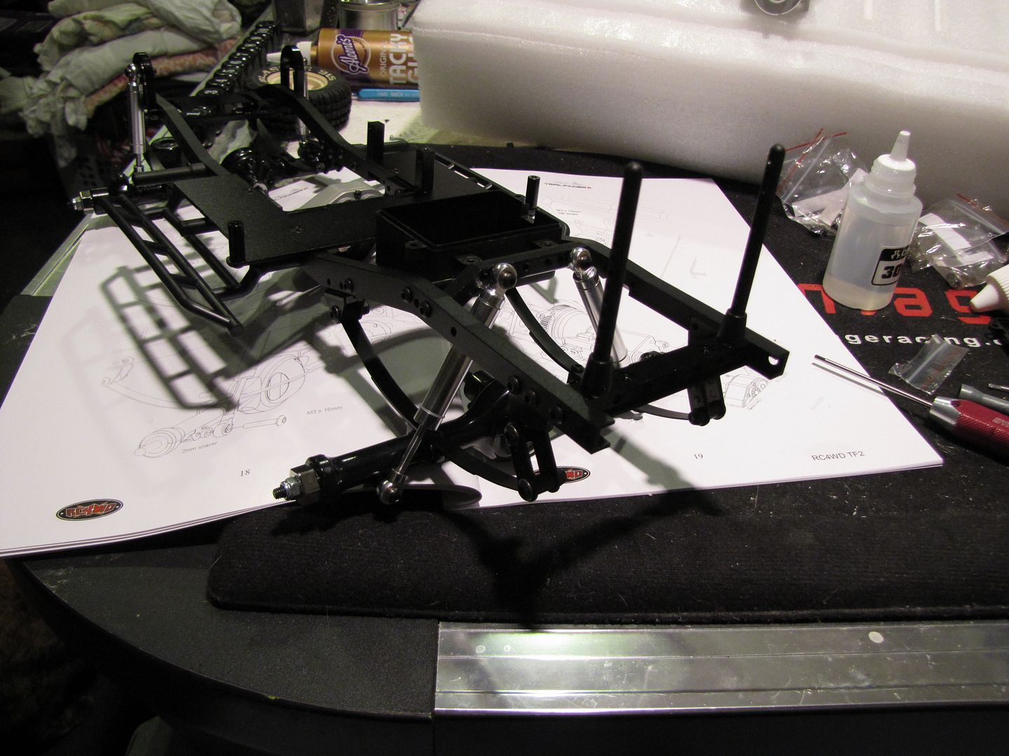

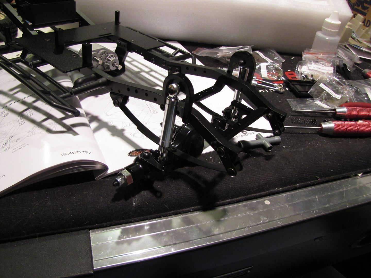

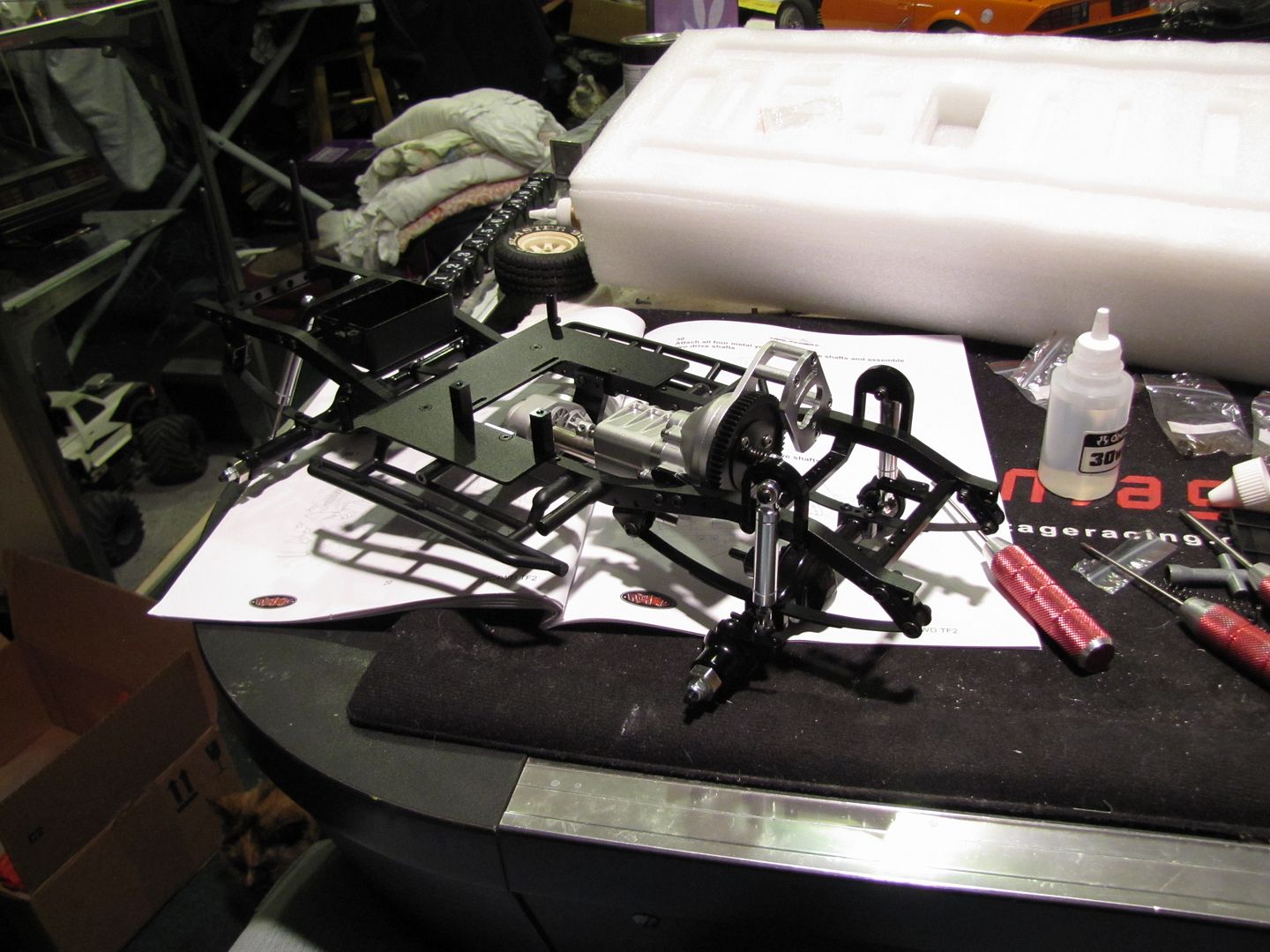

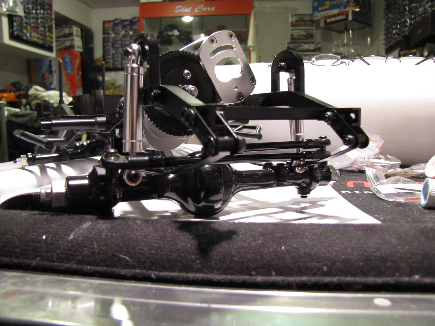

Axles and leafs in. I opted for the main leaf and smallest leaf. I worked them in by hand a bit. They feel pretty soft already and should settle in nicely. I might actually have to add extra leaf to the front.

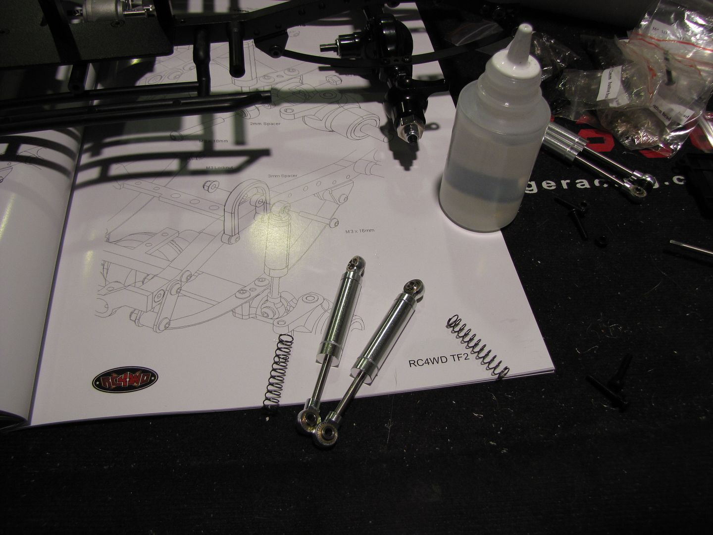

For the shocks, I removed the internal spring. I then filled them with some 30WT oil.
fronts
rears
Transmission in
getting there!

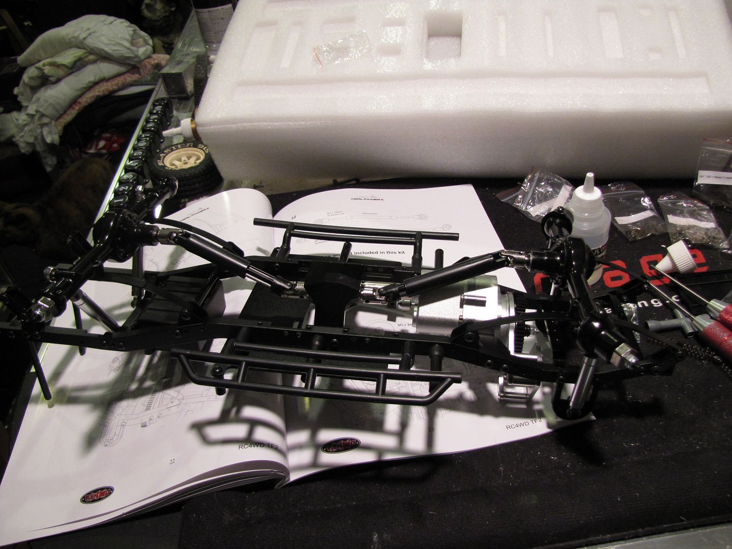

Drive shafts with steel ends
I set my steering up to look like a real Toyota high steer with it bolted on top of the knuckles

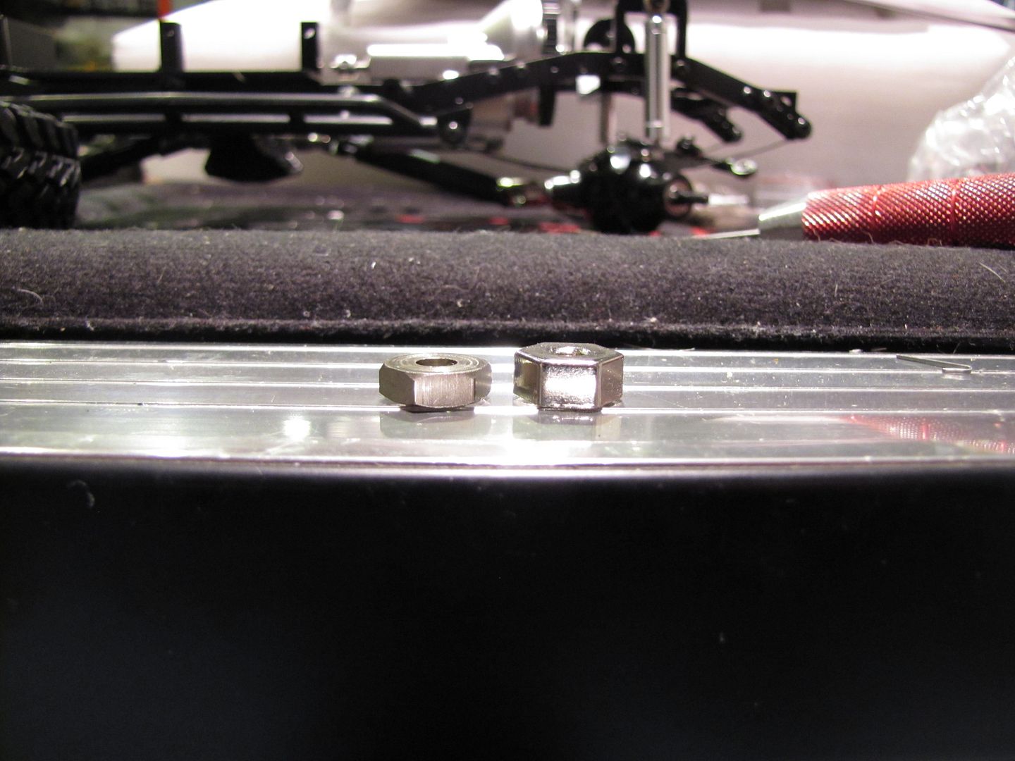

The kit includes 2 different types of hexes. I opted for the narrower hex so I can keep the track with narrow and the tires mostly under the fenders

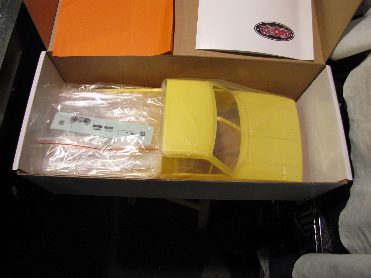

The body set

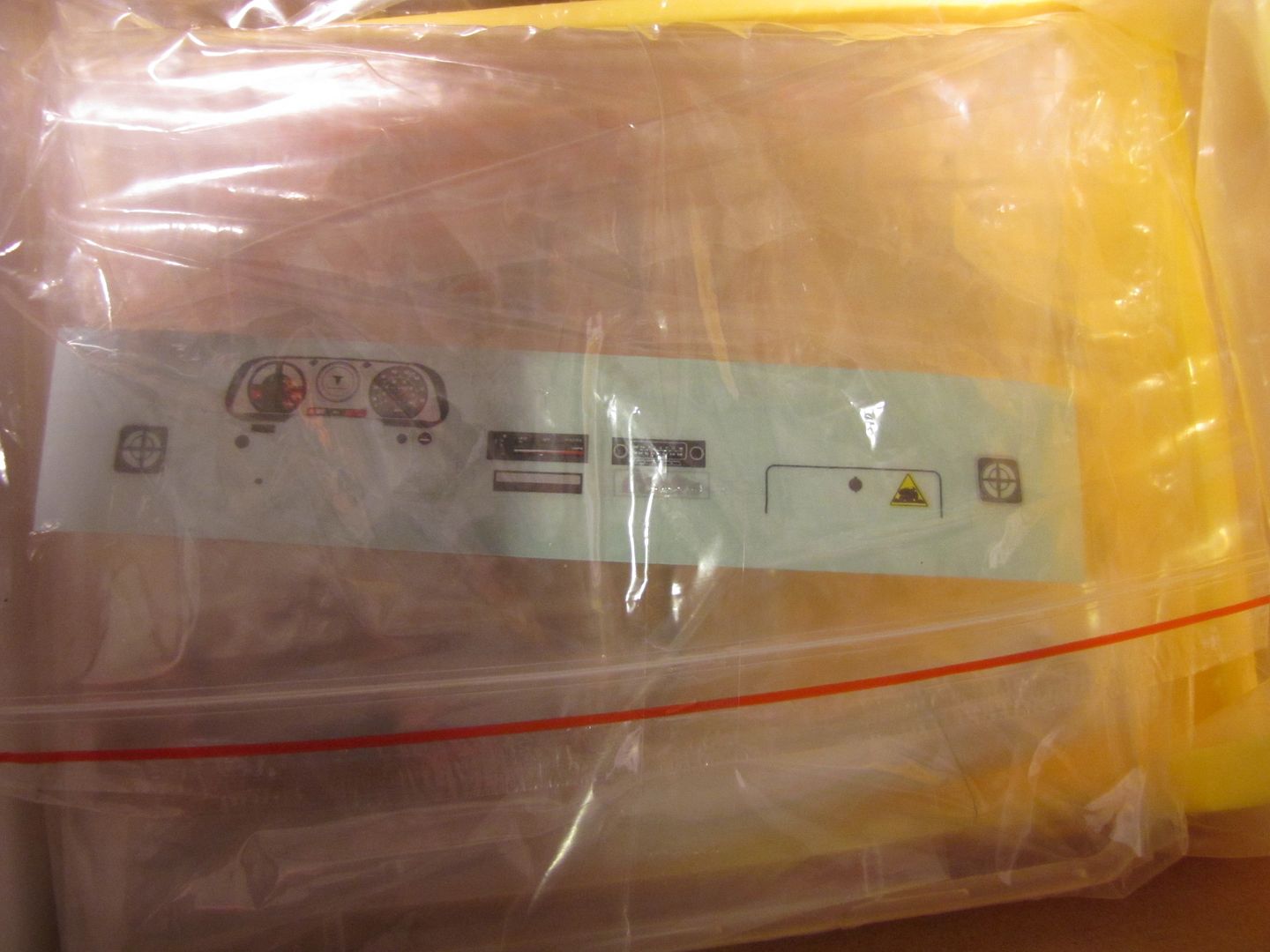

Detailed dash stickers

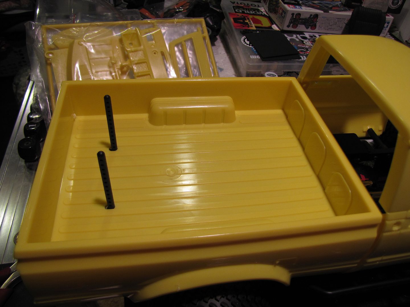

quick mock up
already dropped bed

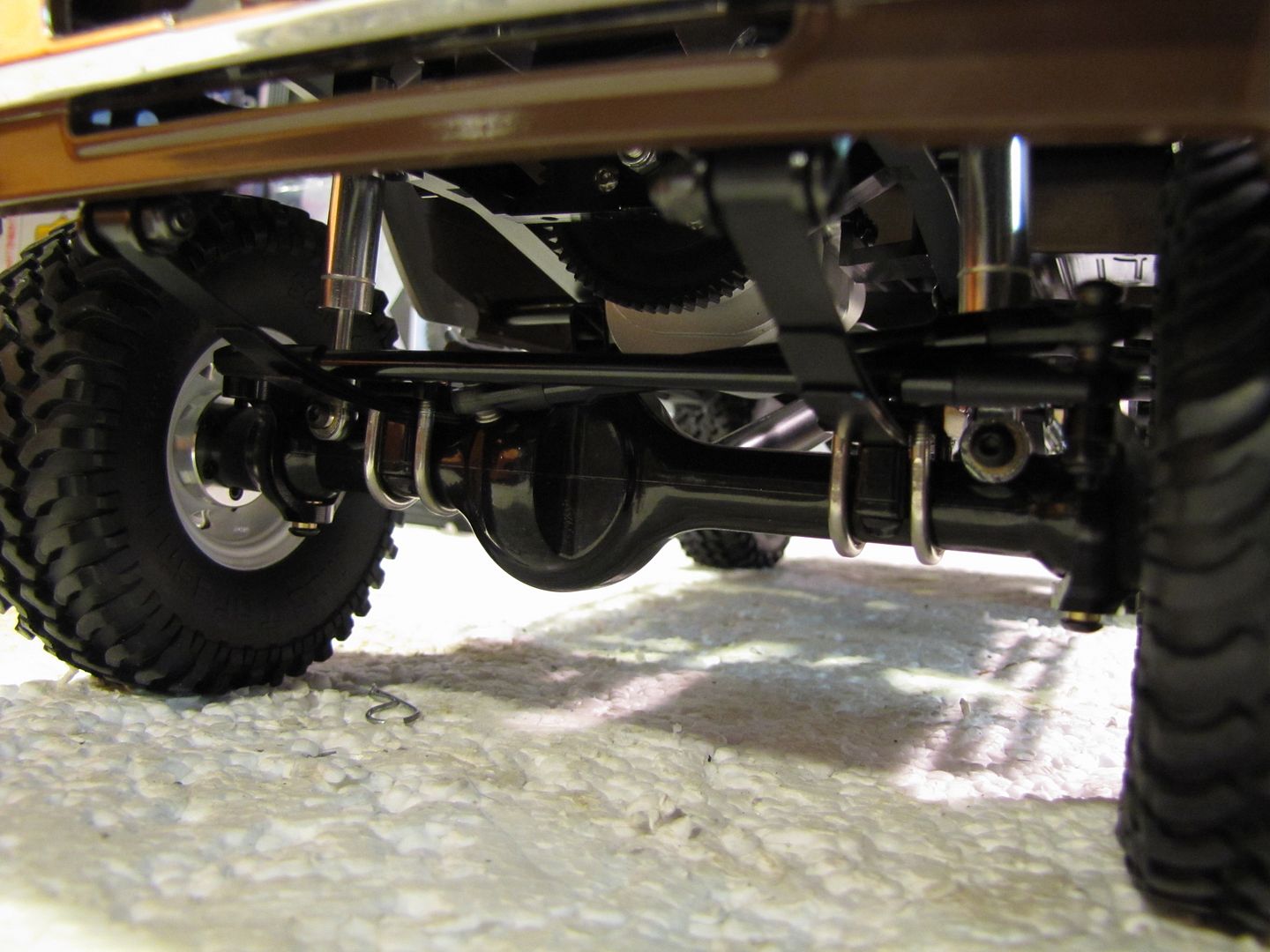

Do the front axle have clocked knuckles at all to relieve driveline angle or are they at zero with the pumpkin output like the trex 60's?
They are not clocked but the drive line angles seem good so far

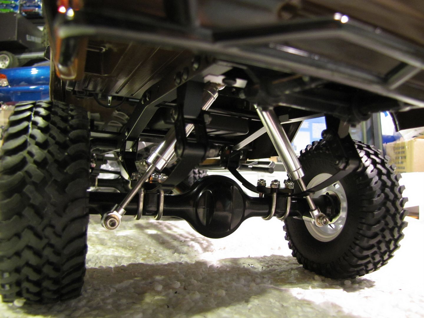

cool, i can't wait to get one of these, soon. but it looks like the front shocks they included are too long, they look like they are almost at full compression in the pics.
Re: 1BadJeepBruiser's RC4WD Trail Finder 2
Mike BJB took the Internal Springs out of the Shocks and filled them with 30wt Oil instead to get it riding different. With the Springs inplace it sits alot higher
To add to what Dready said....The shocks are fine, I opted to remove the internal spring I also left one leaf out of the pack too. I also "worked in" the leafs some before I put them. After I have the electronics in I will adjust the suspension accordingly.

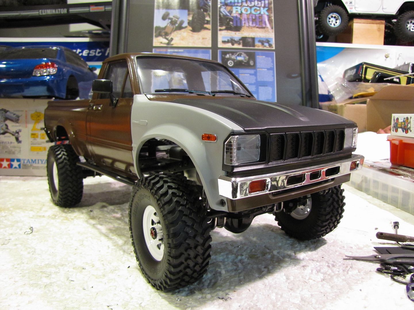

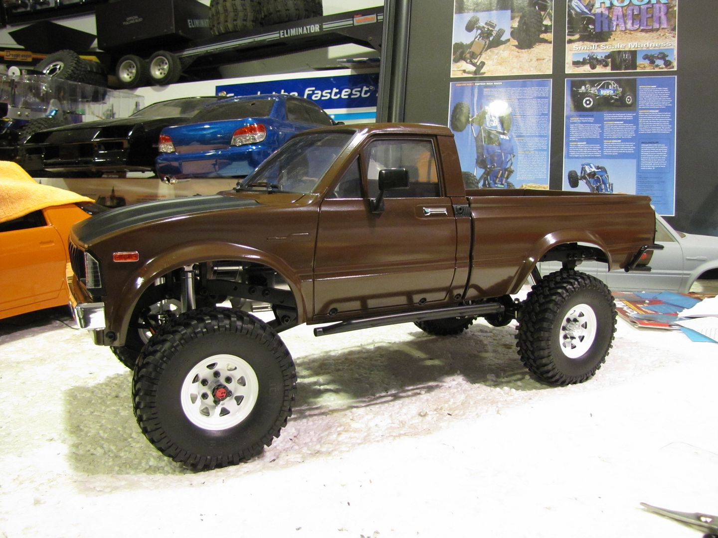

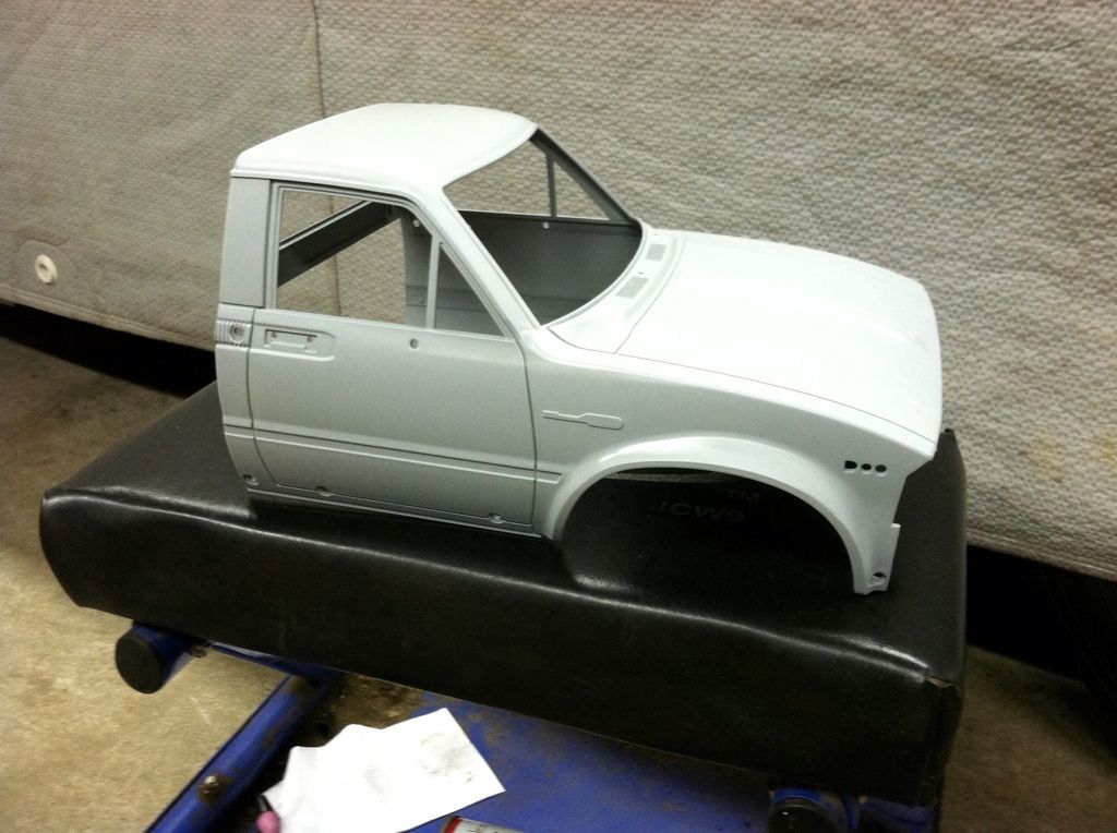

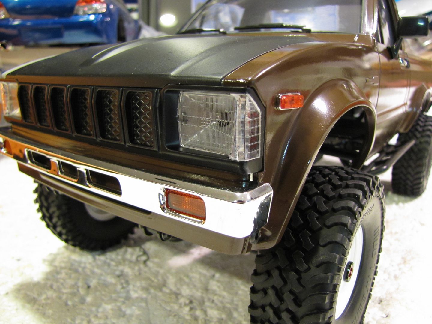

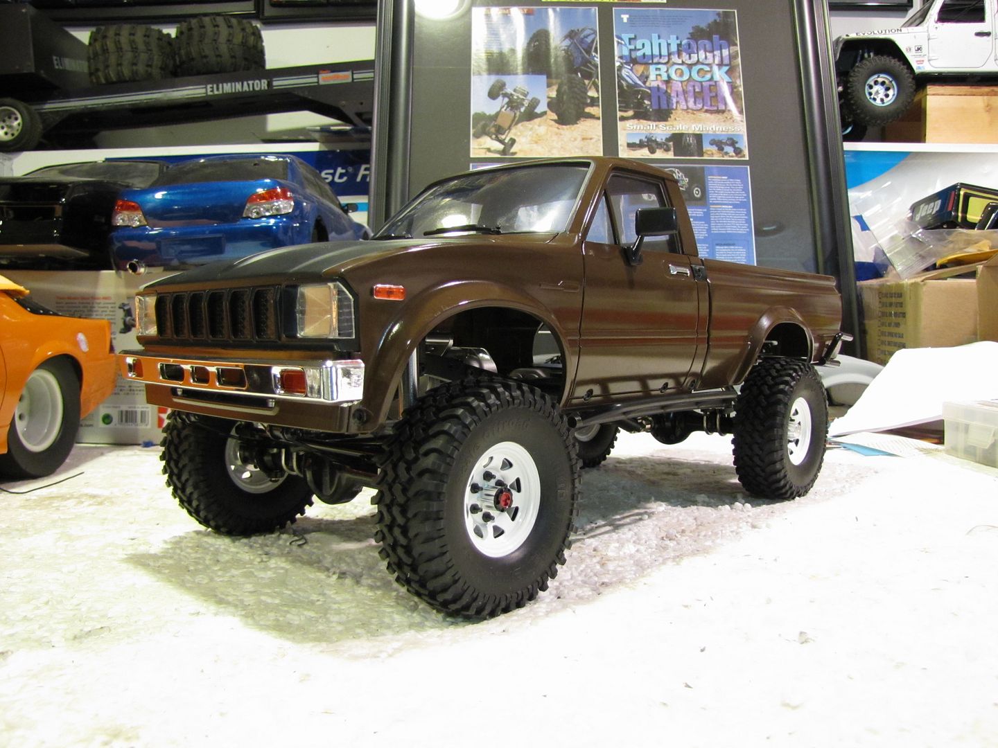

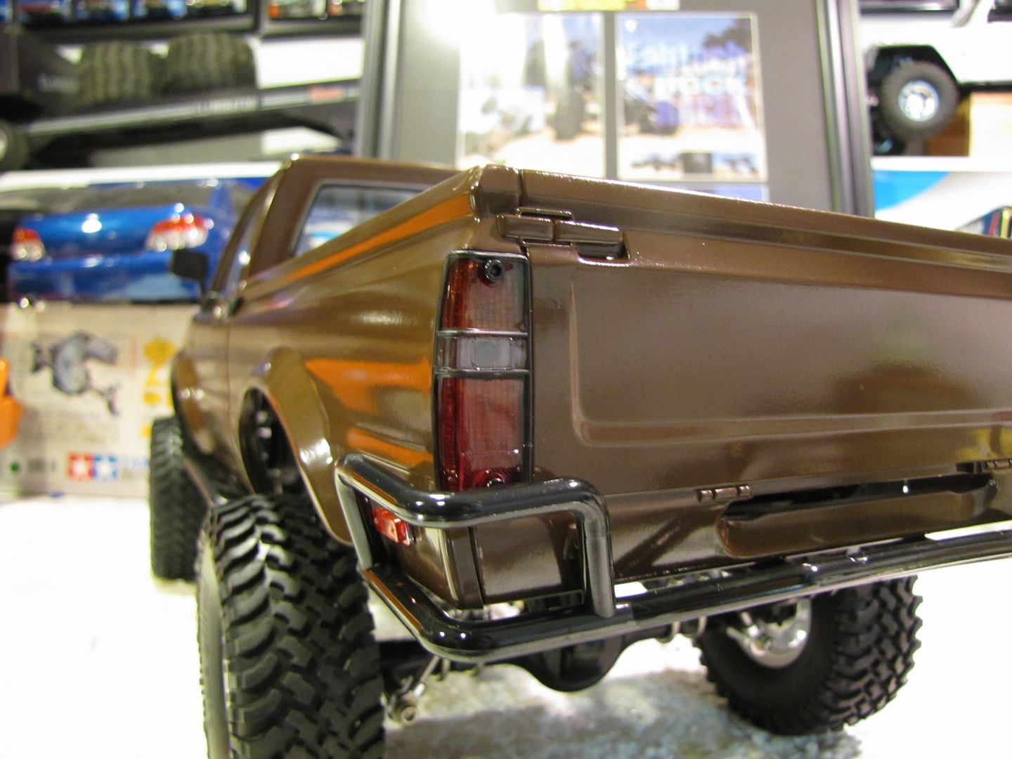

Started painting up the body
Cab is in primer. I had to wet sand the hood after the can of primer had a fit and dripped excess primer all over the hood :roll: I also then sanded out the mold lines in the fender and through some filler on the rear window seams as well.

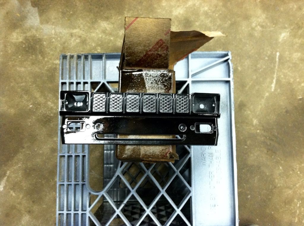

Satin black freshly sprayed on the grill

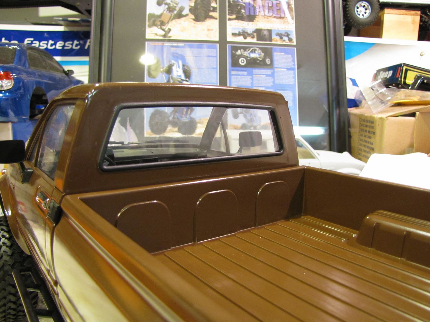

and Yes, we are kicking it old school! The return of the original doody bomb brown scaler !!
Its baaaaaack! Sort of...it'll have to do since the original is with BigBaller and I dont think ill be able to afford to buy it back anytime soon.
rear window molding painted
Rear bumper, definitely reminds me a lot of the one the one that was on my truck that I built.

painted and sharpee'd rear tail lights

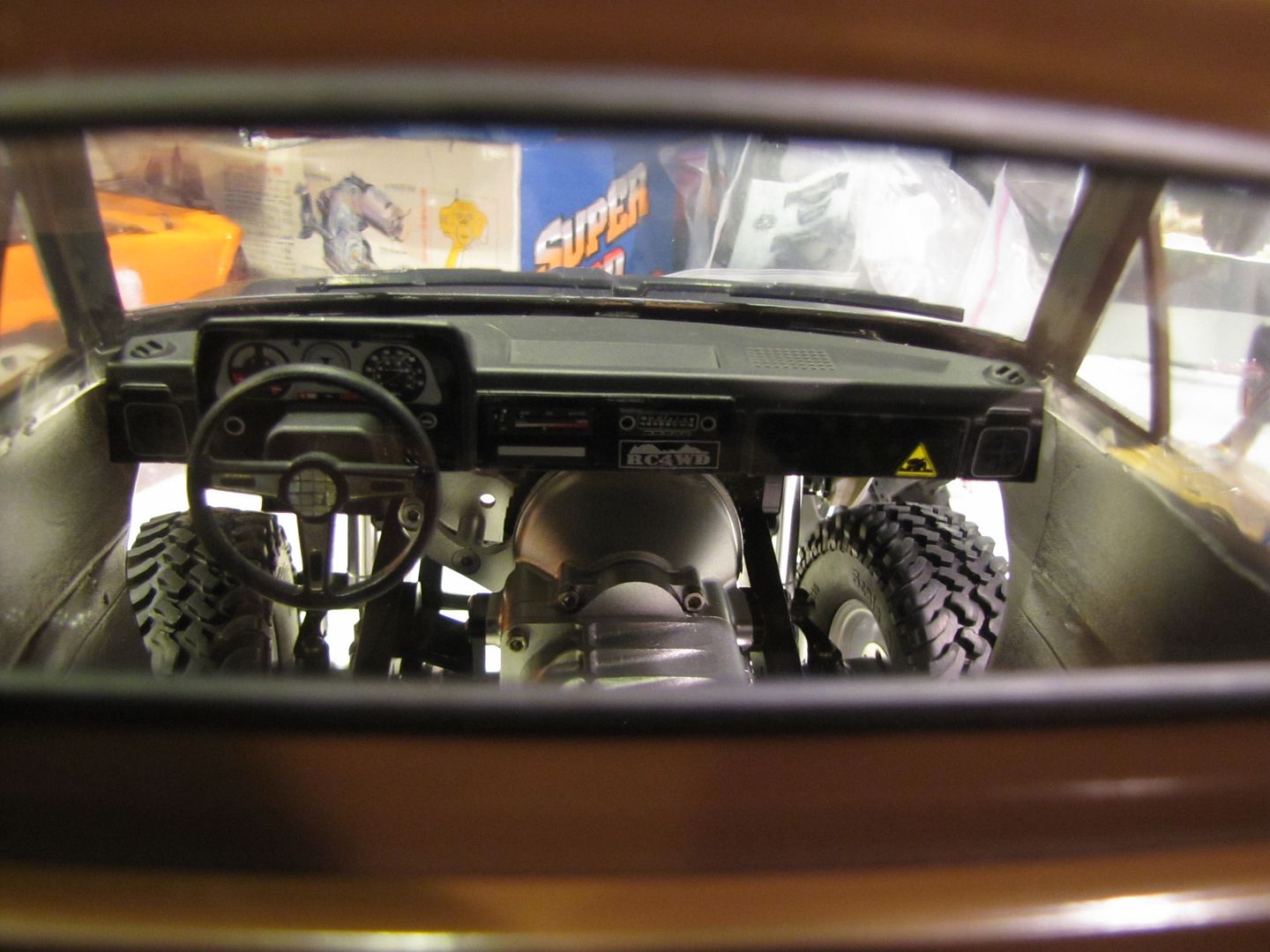

Dash, Couldnt help but install a Dinky RC steering wheel :mrgreen:

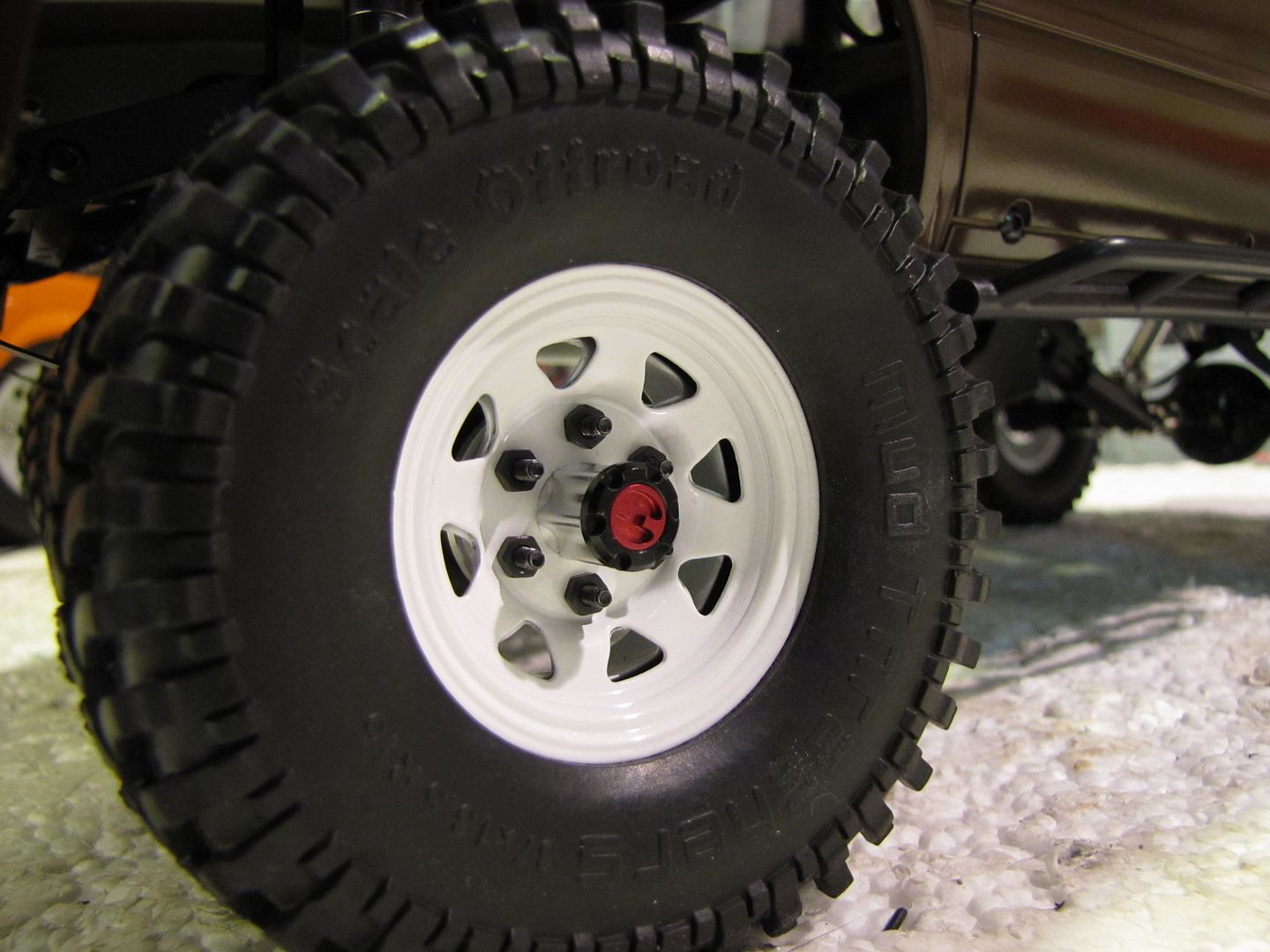

RC4WD Toyota Hubs, these things are AWESOME

Re: 1BadJeepBruiser's RC4WD Trail Finder 2 The OG Brown Yota scaler wannabe
Looks great Mike! I love the throw back paint scheme. "thumbsup"
Looks great Mike! The color looks different, interior lighting vs. natural light?
Nice paint mikey..cant wait to see what you're gonna do to it once the flag drops.
Thanks Ty"thumbsup"
Dez, I think its the lights in the basement however the Brown I originally used was a walmart color choice brand called "walnut" and this is a krylon fusion called "leather brown". Unfortunately the "walnut" brown is discontinued and I sent my last new can to 51WillysJeep when I sold the clone originally :sad:
I have some plans...Dinky interior with tons of details/modifications. 1.55 Stompers and black 1.55 wagons. Ill probably also recreate the armor in metal. I also plan to hack the front bumper and fenders. Gotta get some rice light bulbs to so I can light this sucker up.
