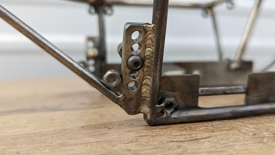

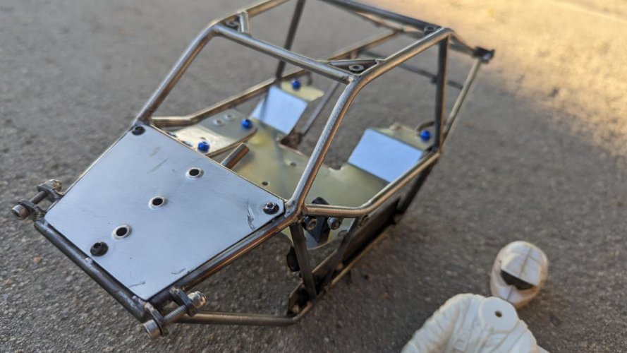

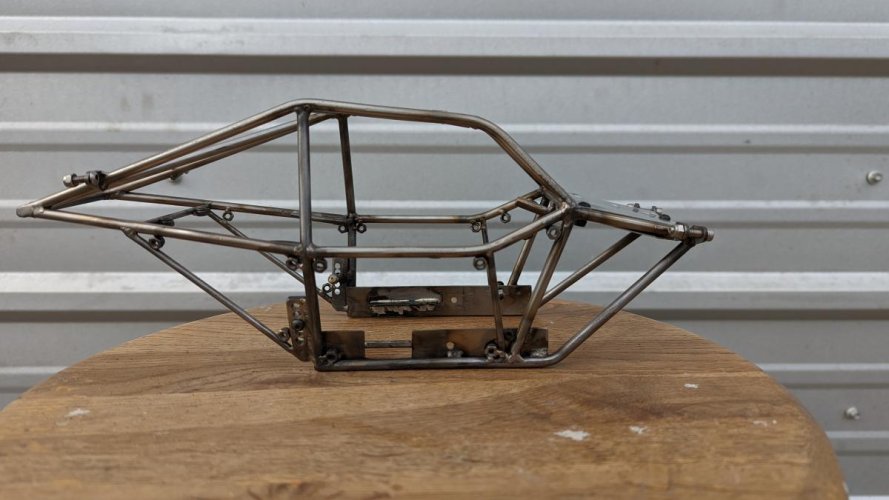

I welded up this chassis a few years ago for a buddy and now it has returned to my stables
Chassis is 316L medical grade thin wall stainless tube, (pretty damn light)
similar design to the Lasernut buggies you see in full size Supercrawl series
Custom interior
Will be setting up as a 4ws buggy

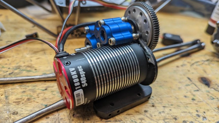

Using a VP F9 front axle
VP F10 portal rear
VP 3 gear trans, Holmes extended outputs
VP KMC Bronze Machete wheels
PB Bloodaxe tires
HW FOC motor
Direct power servos

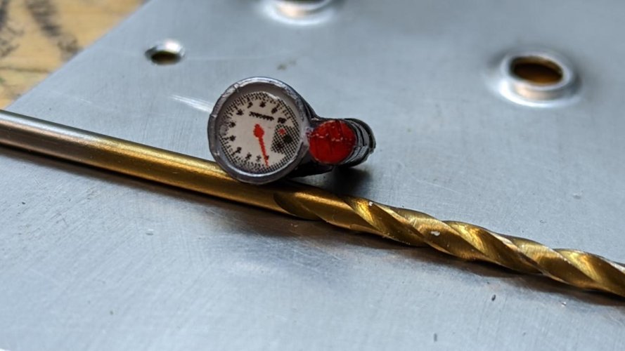

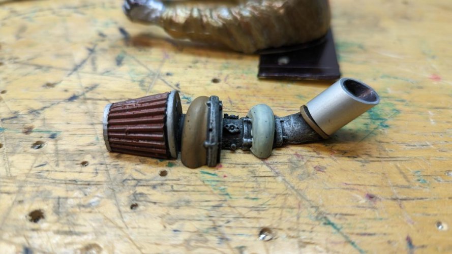

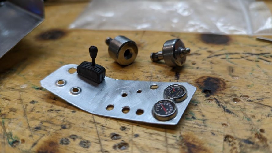

Dash/control panel, added some more dimple/die holes and a boost gauge, cutting brakes
Working on driver paint too

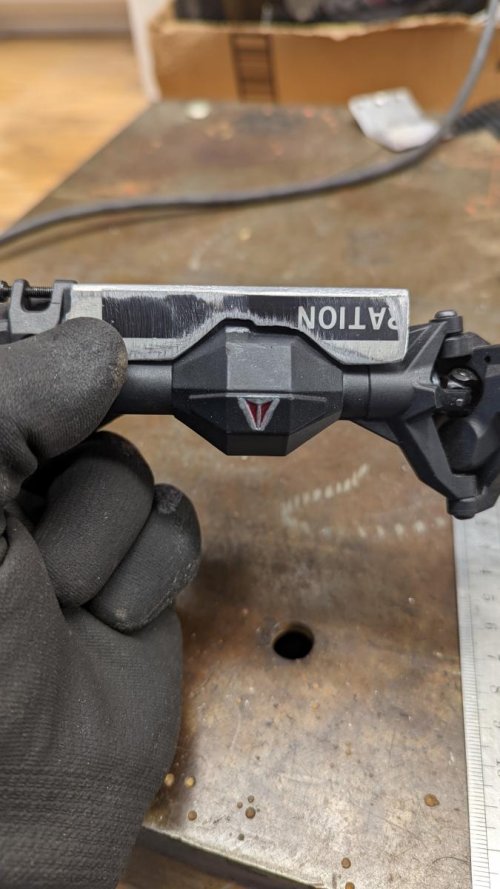

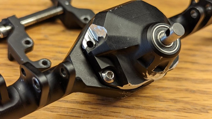

I like the VP Scx I0.2 F9 axle because you can flip the diff upside down on it, makes pairing/running a rear portal easy to setup.
You do have to cut the upper ears off though, but it worked out that the VP servo mount had holes for upper links.
Had to do a little surgery though on the drop out to be able to still run the VP SOA mount

I was interested to see the f10 axles were designed to have the upper link mounts on the housing rather than the third member…
Same here
Gotta come up with a SOA mount for the F10

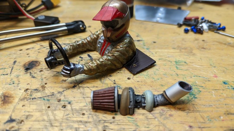

Driver and turbo are painted

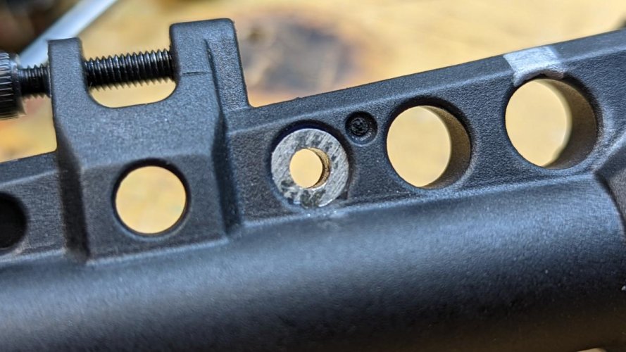

Decided to fab my own F10 SOA mount
First had to press an aluminum spacer into One of the existing holes in the truss then drilled out one of the holes on the driver side of the truck
I used a Hard anodized aluminum sheet, will have some bracing on the backside for lateral support.
Made a little template out of paper to get a proper fit then transferred to a sheet of aluminum "thumbsup"
