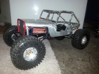

I will update when there are some, sorry. Snail Build for a reason. IaROCKs next comp is in DBQ, but there may be one in your area some time this season. I will sell them. They are a good looking tire but that's about it. Thanks for the compliments"thumbsup"

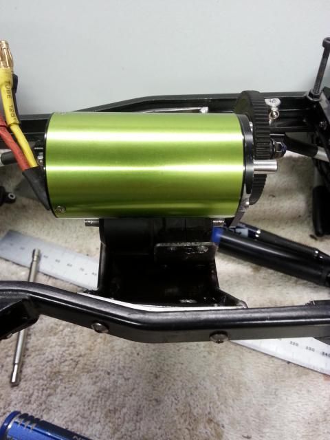

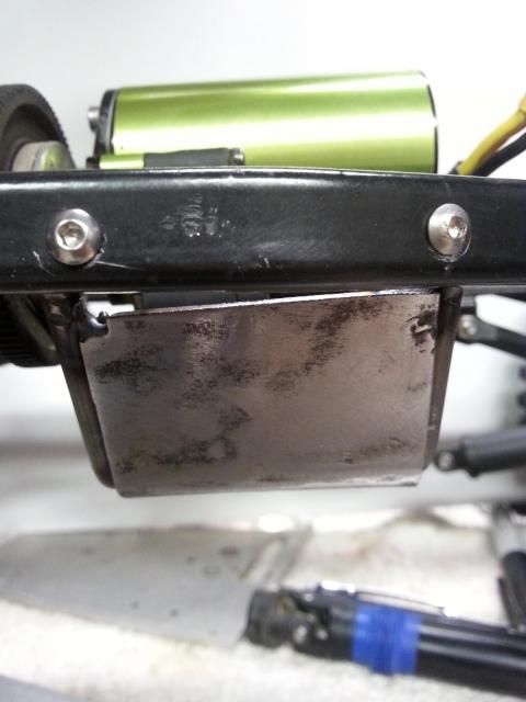

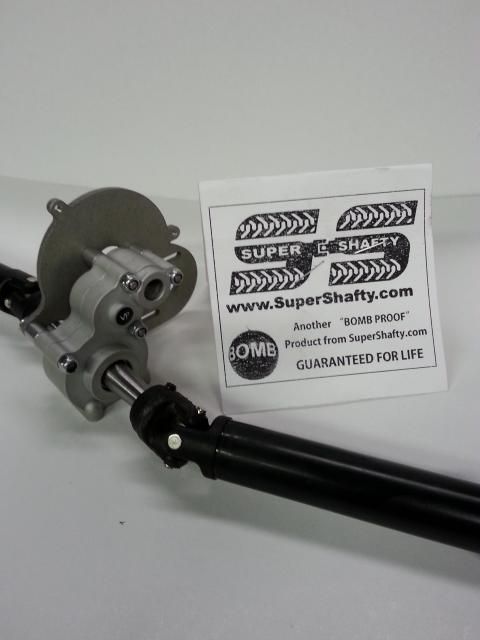

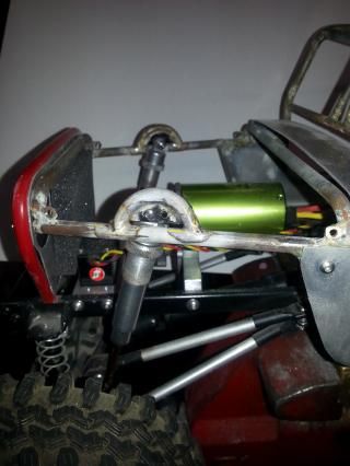

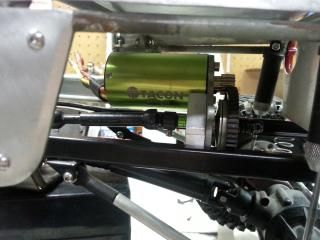

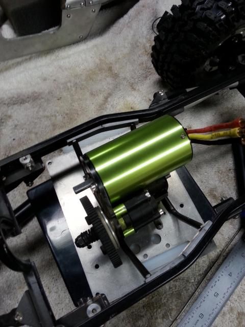

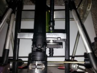

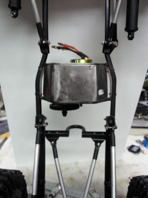

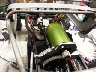

The Toyzuki divorced SCX10 motor mount inspired me to get this damn rig rolling. Fabbed up a mount, custom input shaft, and Junfac shaft to transfer the power. Really happy with how it came out.

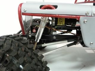

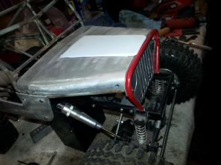

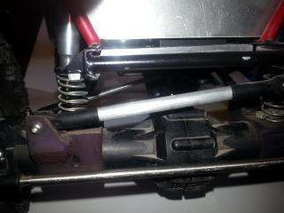

Also fabbed up a BTA steering link. I don't have enough room in the front for a traditional drag link. I think the length and angle are going to be perfect too. Just need to get the servo mount built next.

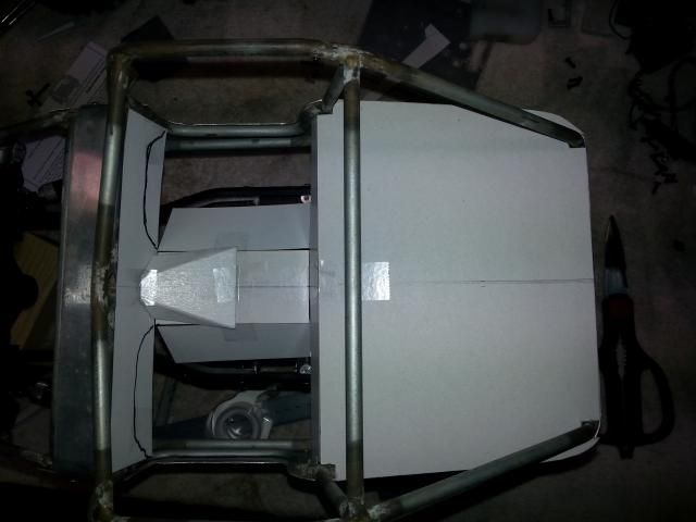

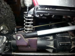

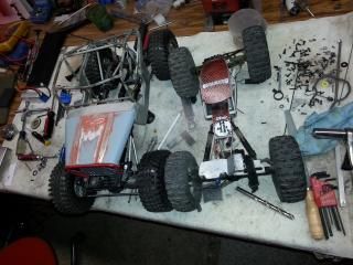

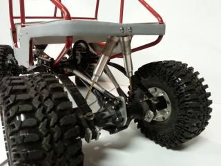

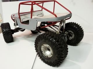

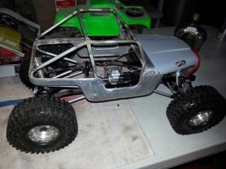

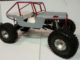

This is a major milestone in the rigs life. It's the first time EVER it's been mechanically all together. All shafts are built and installed. Suspension, steering, everything is ready to go. Just need to get ready for electronics and viola. She's ready for the trails.
