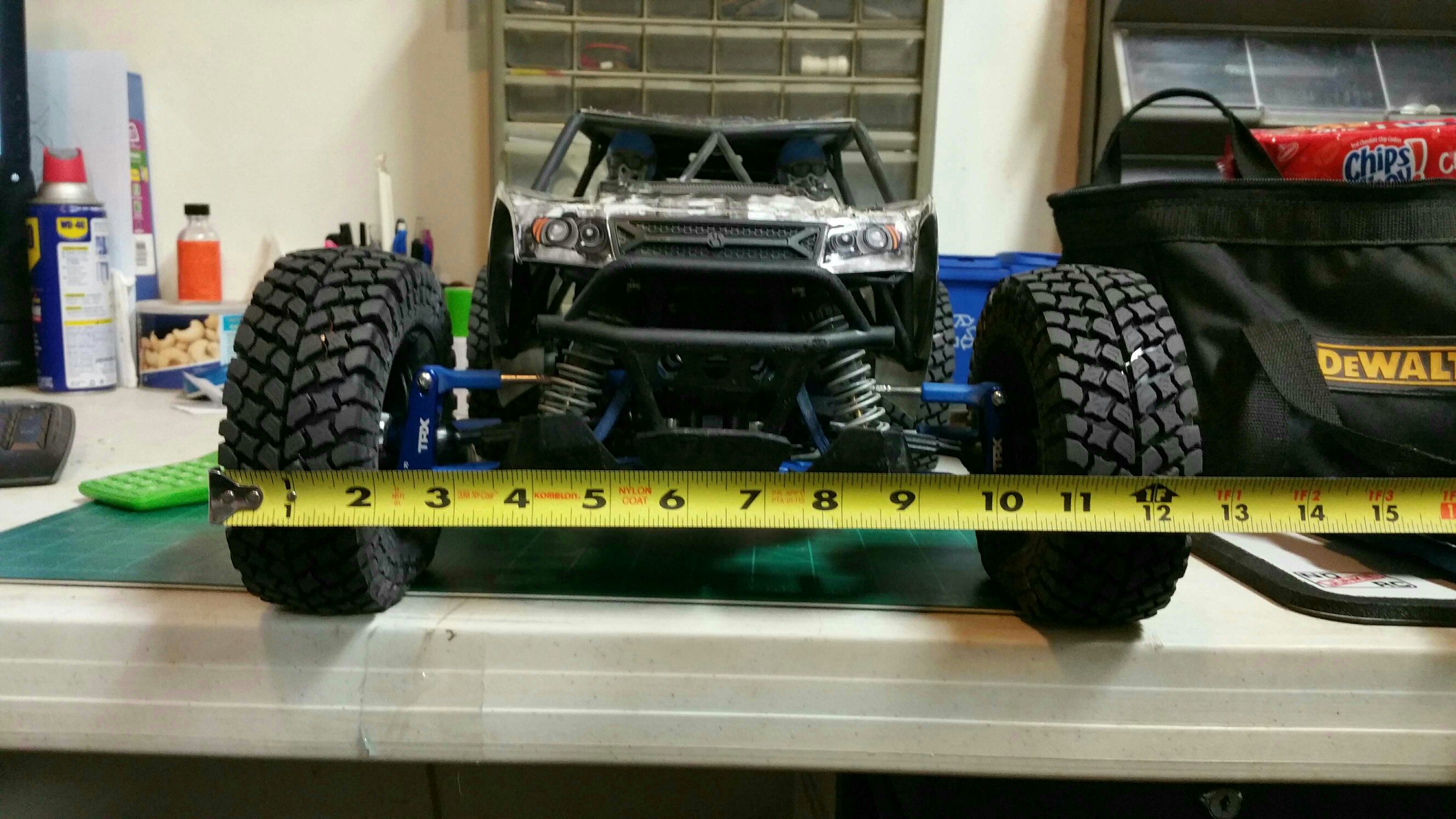

Doesn't look rediculous to me. These are 2.2 crawler inovations wheel, cheap and great. 2.2 vp wheels fit just the same. These fall under the 13" max with for U4 Racing. No wider than a stock yeti setup.
