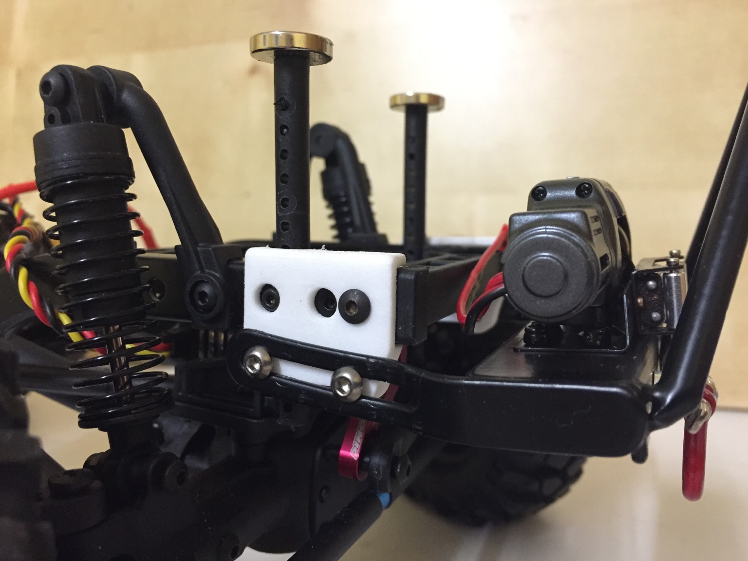

Is that a servomount on the front bumper for CMS or servo winch?
I was checking... With a little work, you should be able to fit a servo winch. But I believe it for a normal winch, although the mount points do not match the one from 3Racing

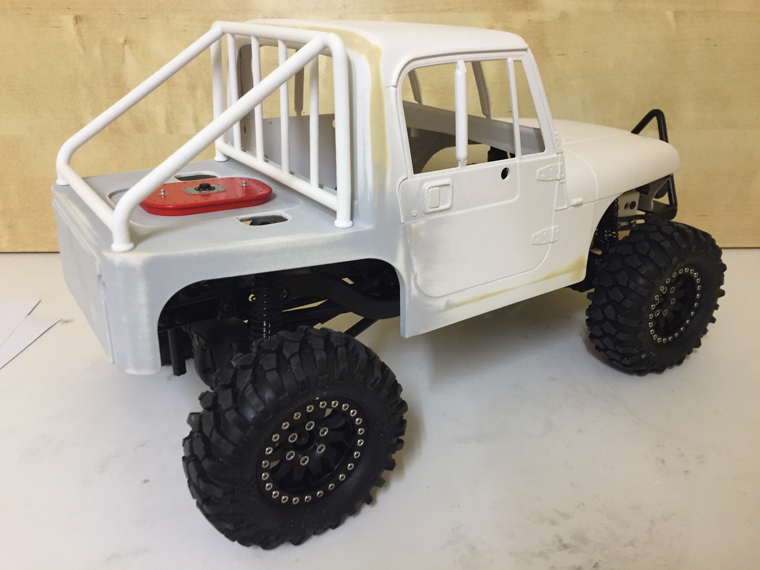

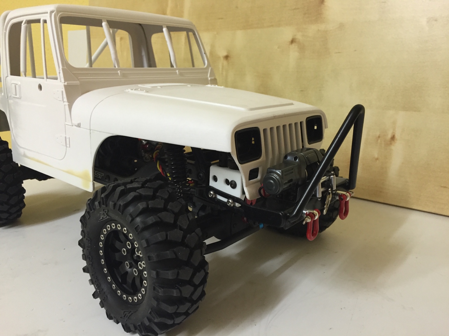

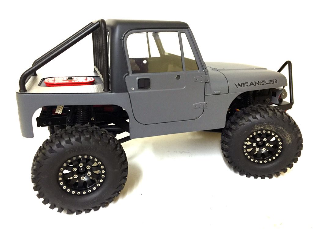

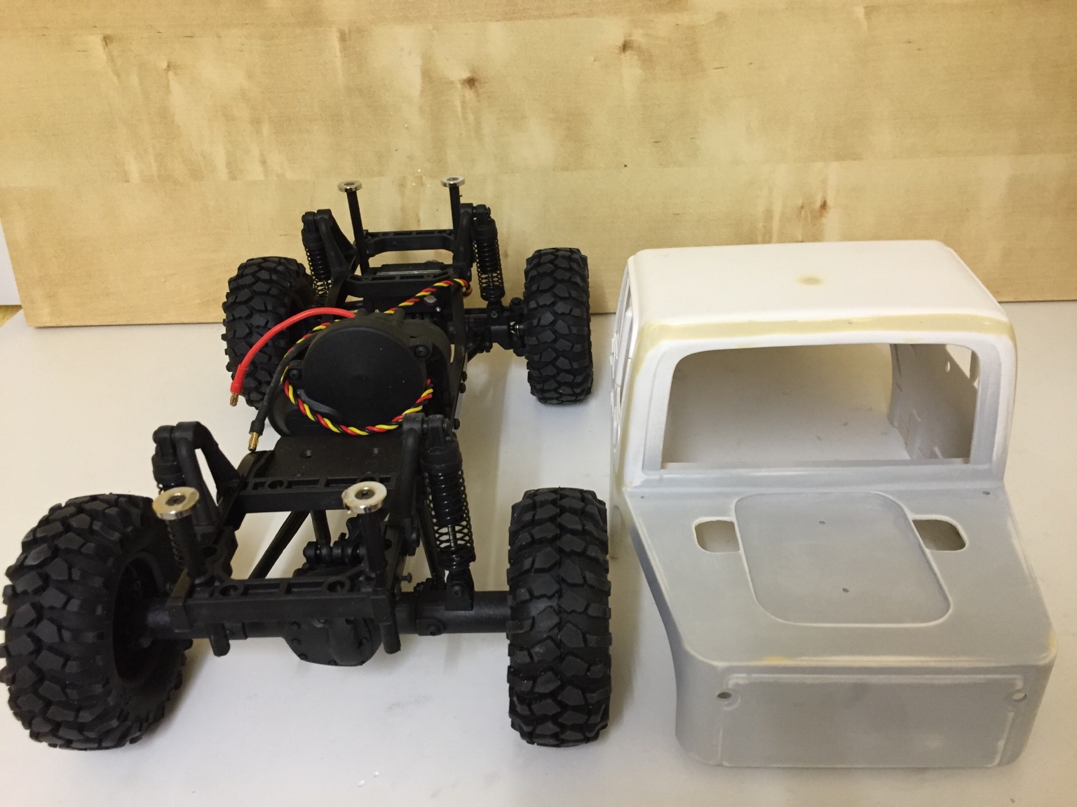

Got some more work done...

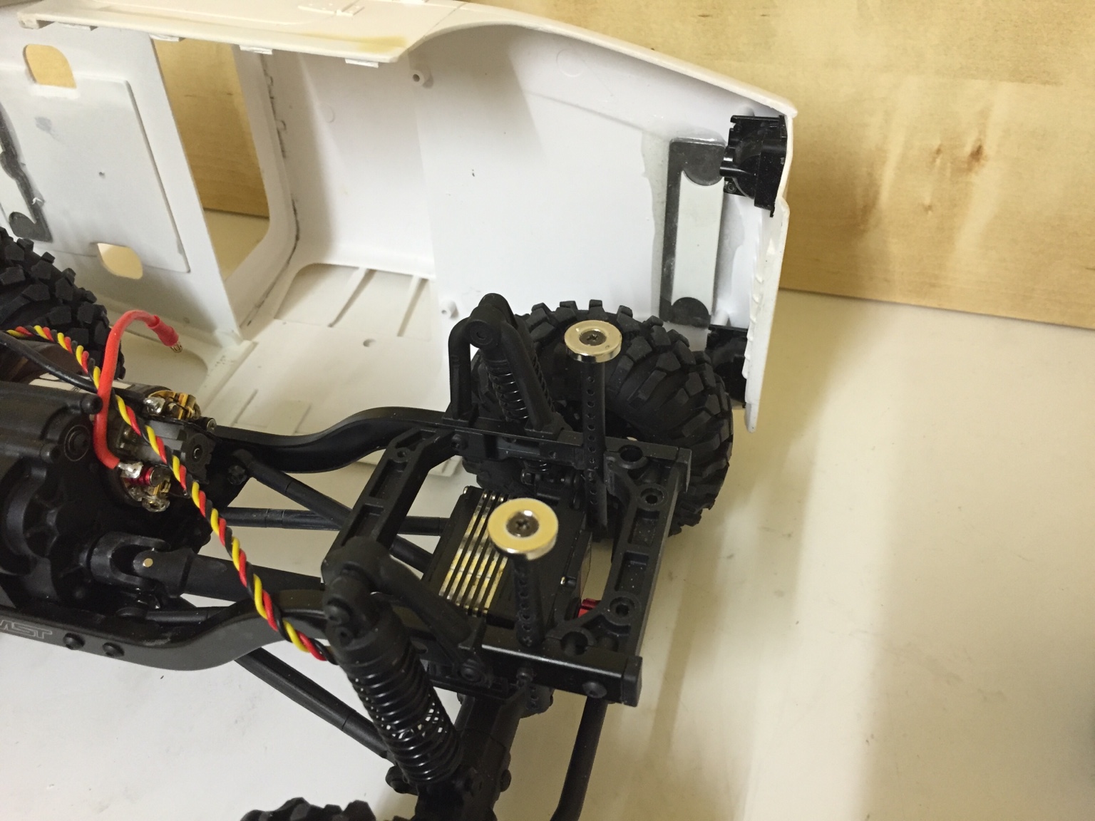

Built the mounts for magnets (those will hold 3 kg, more than enough)

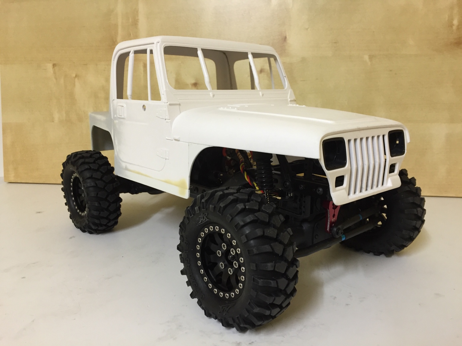

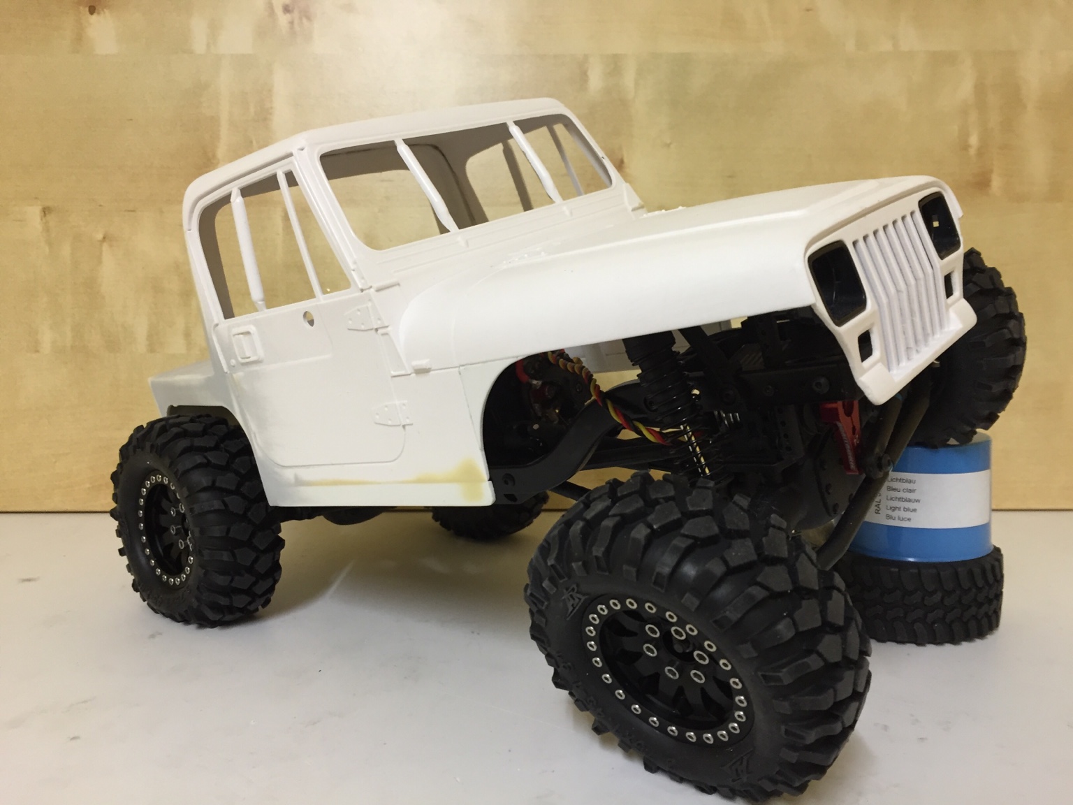

Than, in order to get the body to the right height, I had to open up the rear deck a little. This provides enough space for the shock mounts, some diamond plate will cover them later on
Wheelbase (247mm) and body height look alright now
And there is enough clearance for the tires

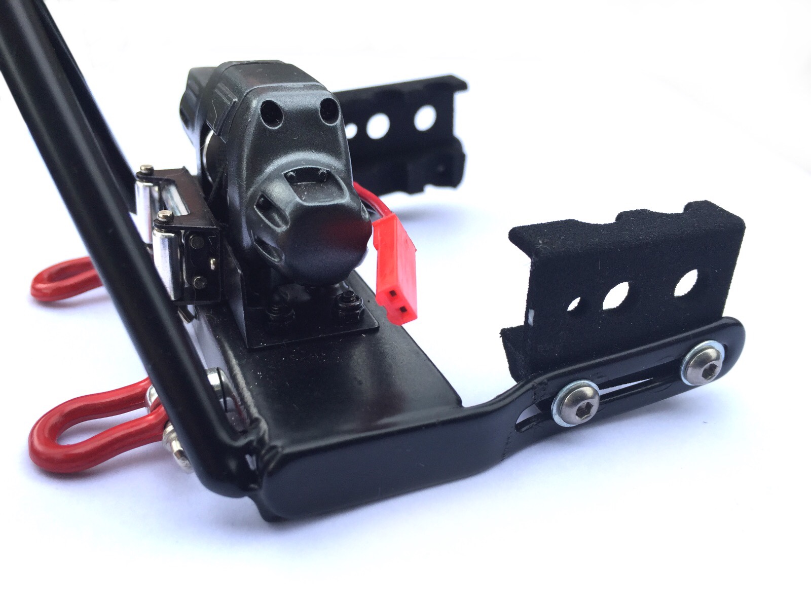

Next: getting a SCX10 bumper mounted...

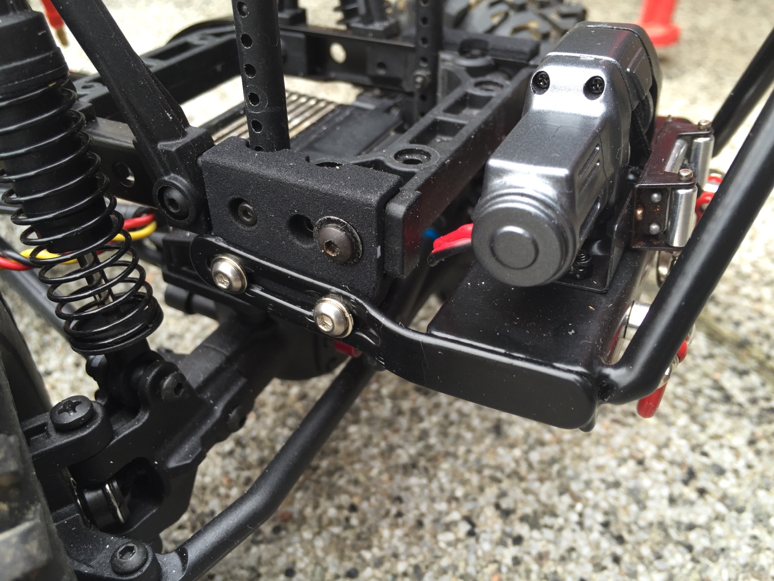

Drew a 3D file and got it printed at Shapeways

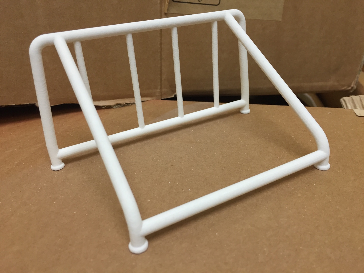

At the same time, I designed a roll bar and I'm pretty happy with the result

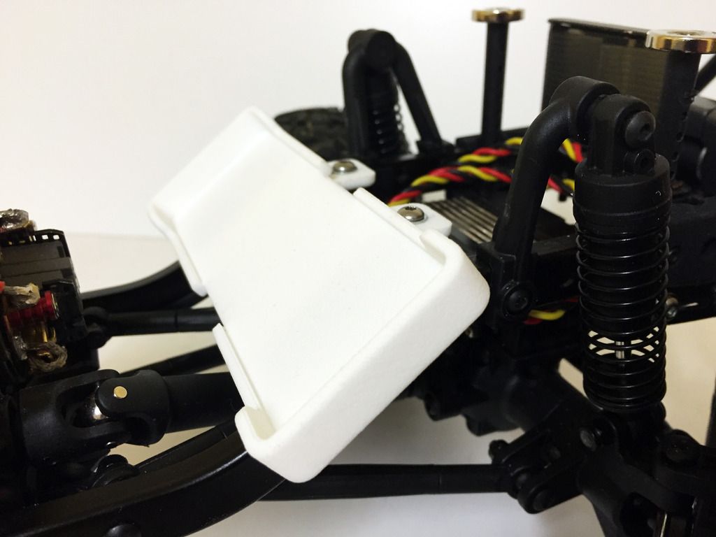

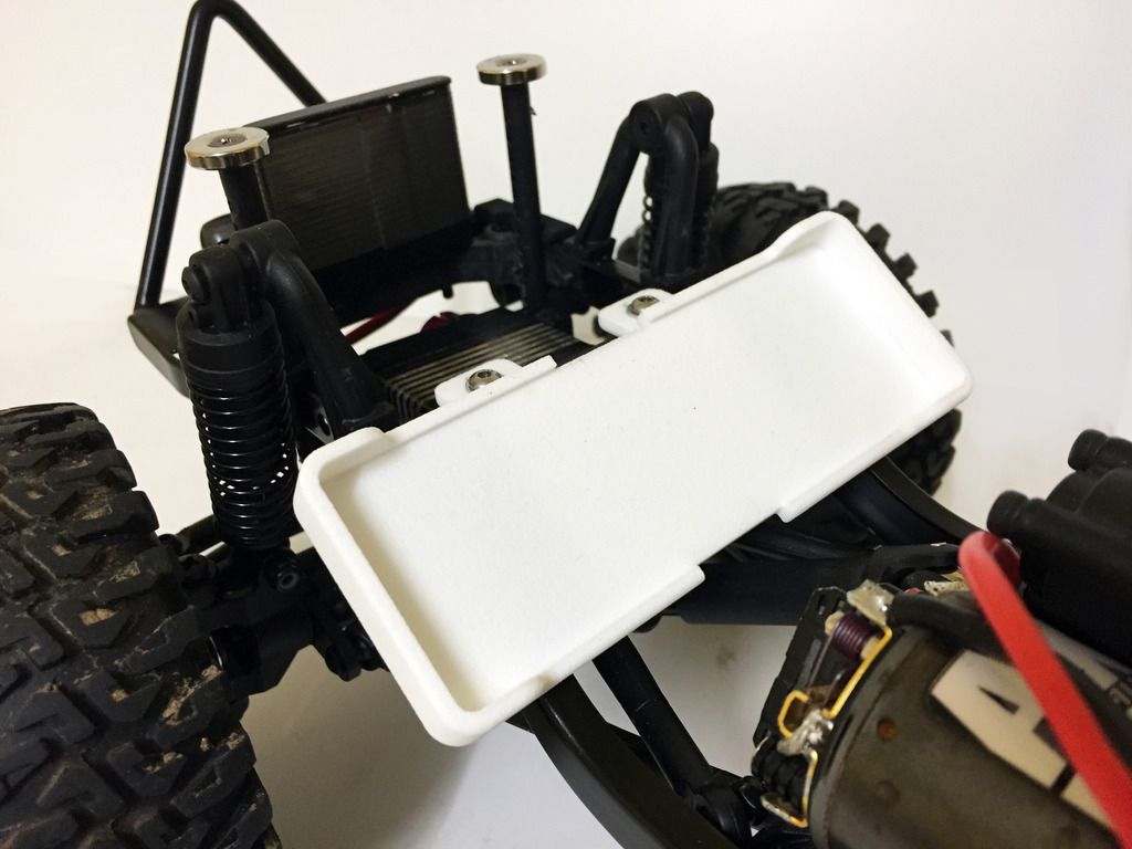

Don't like the battery mounted on top of the axle, so I got a new mount for my 3S lipos from Shapeways
That is looking great!!!! Awesome work on the body. Looking forward to see how the chassis handles
