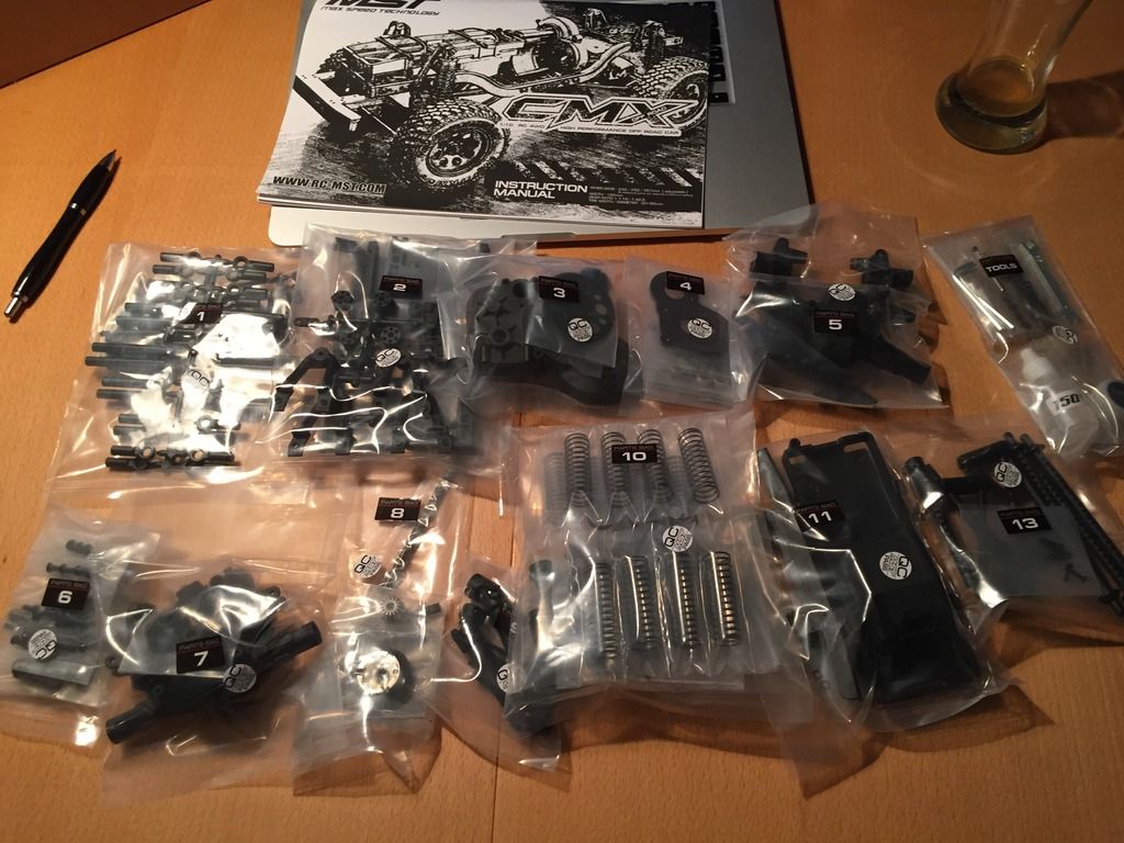

The chassis-only box is small and contains all the parts in smaller bags, all packed to match the single steps in the manual.

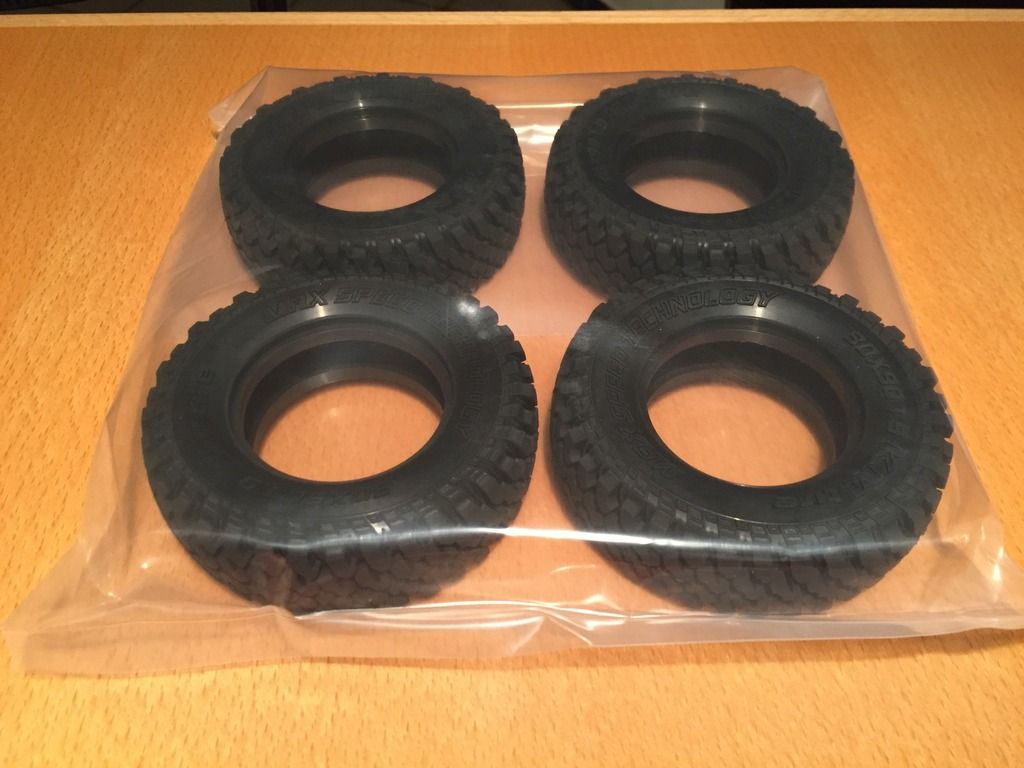

There also some 1.9 wheels and 90 mm tires included, with 2 different wheel designs available (but not selectable at order)
The tires look and feel much better and softer than the stock Tamiya bricks, but are a little too small for my build, but others will love them!
To get started, the kit also contains the usual set of tools, grease and shock oil - but I prefer my own :)

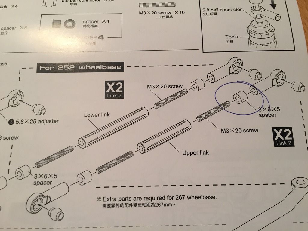

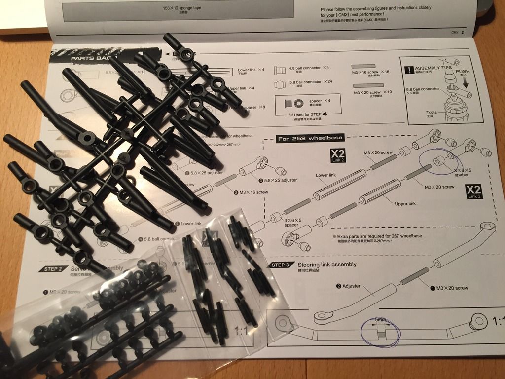

Anyway, the first step: Links
As mentioned before, the kit includes parts to build links for 242 and 252 mm wheelbase, for 267 mm you would need 60,5 mm/72,5 mm long parts for the upper/lower links.
Unfortunately, the manual is not very clear on this, even for the 252 mm wheelbase it tells you to build 2 sets of short links and 2 for the longer wheelbase, but it won't tell you which set goes to the front or back.
As I wanted to get 252 mm, I just build all links the same length, using only one spacer each.

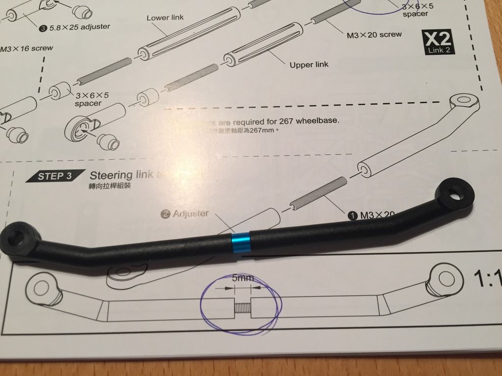

The steering links are made at the same time and the manual tells you to leave a small gap between the rod ends. I "filled" those gaps with spacers I had available.

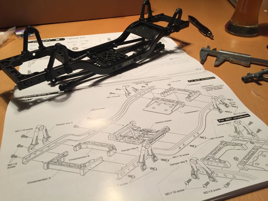

Next up is the chassis itself.
Two metal rails are connected to the skid, plus a couple of staffers for the front and the back, nothing exciting...
The shocks mounts have different shapes for left and right and can be switched around depending on the wheelbase chosen. Much easier than adjusting wheelbase on an Ascender ;)

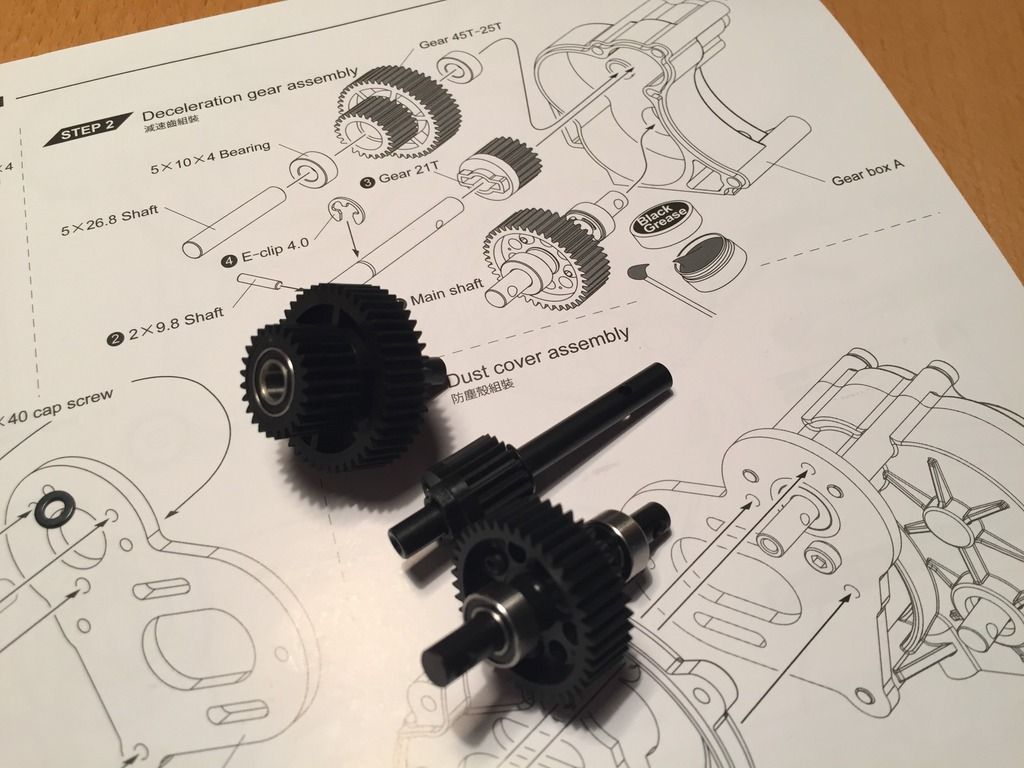

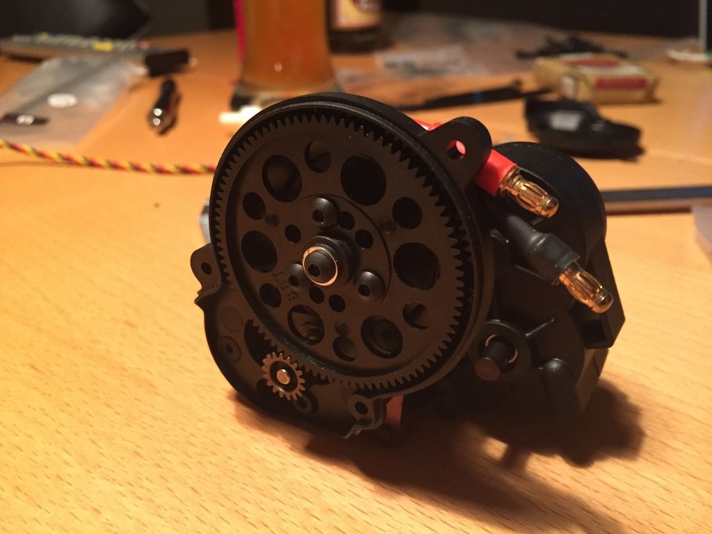

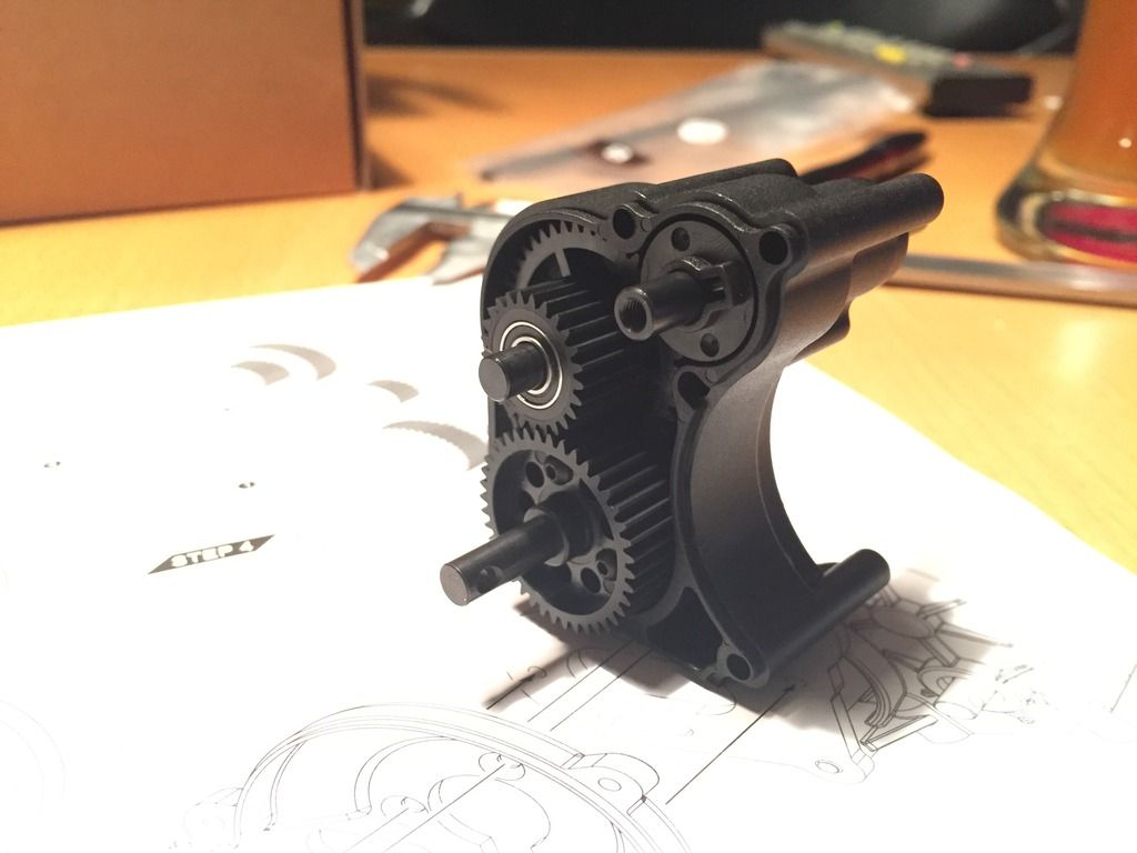

After that, the gearbox. Again, nothing special here, very similar to what we have seen from Axial or Vaterra. Gears are plastic, just like anything else in the MST, but the plastic looks pretty good.
Please note: the MST CMX doesn't come with any ball bearings, only bushings.
You can go through the parts listing yourself and write down what you need, or trust my list ;)
16x 5x10x4 (I picked 10 hybrid bearing for the axles, plus 6 normal bearings for the rest)
2x 8x12x3.5
4x 10x15x4
All put together
There is also no pinion in the kit, I chose the smallest possible (according to the manual) 17t/48p at first, but got another 90t spur from MST and a 15t pinion which is a tight fit under the cover

Some remarks so far...
There is no slipper clutch - hope this is not going to be an issue in the future...
And, I really love the plastic MST is using. Probably the best quality stuff I have seen in years. Axle housings or gear box halves just snap together, perfect fit.

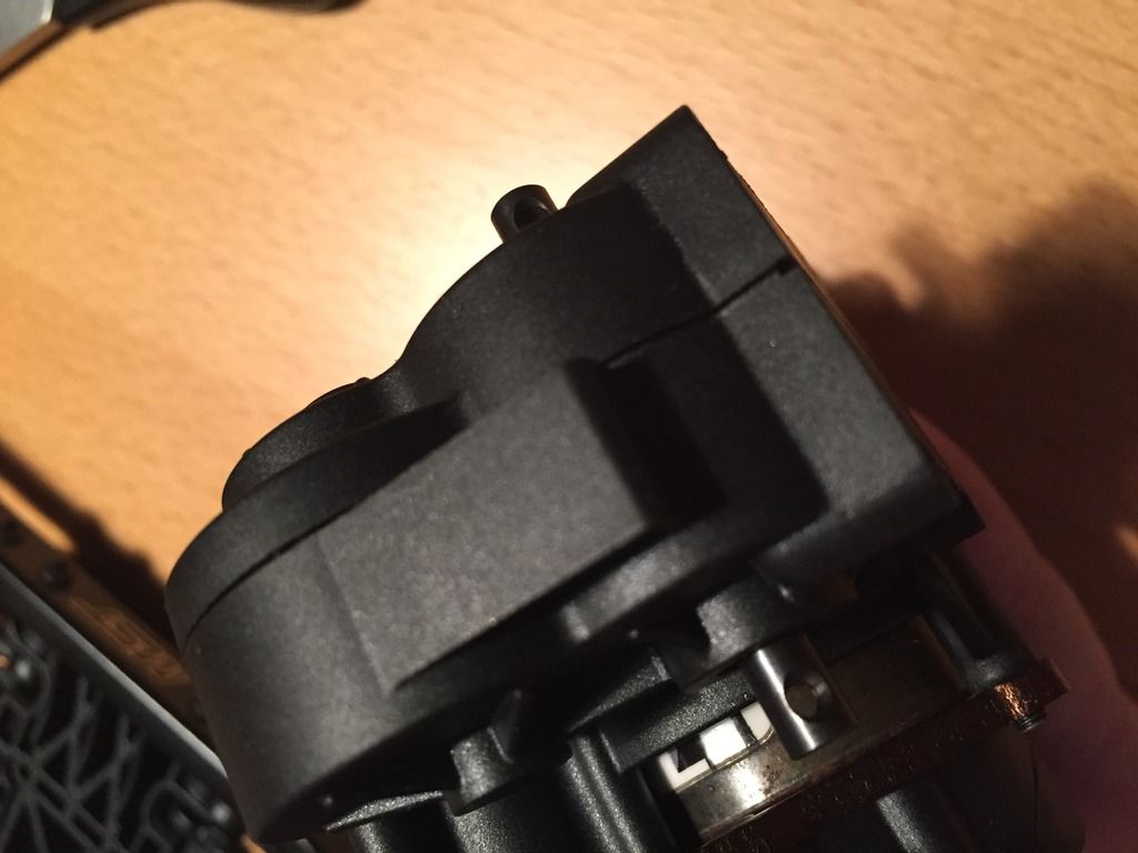

The only cosmetic issue is the in the construction of the gear box. With all the screws in, to bottom part separates slightly
Not a huge issue, as it will be pressed together once it is connected to the skid. Still bugs me a little

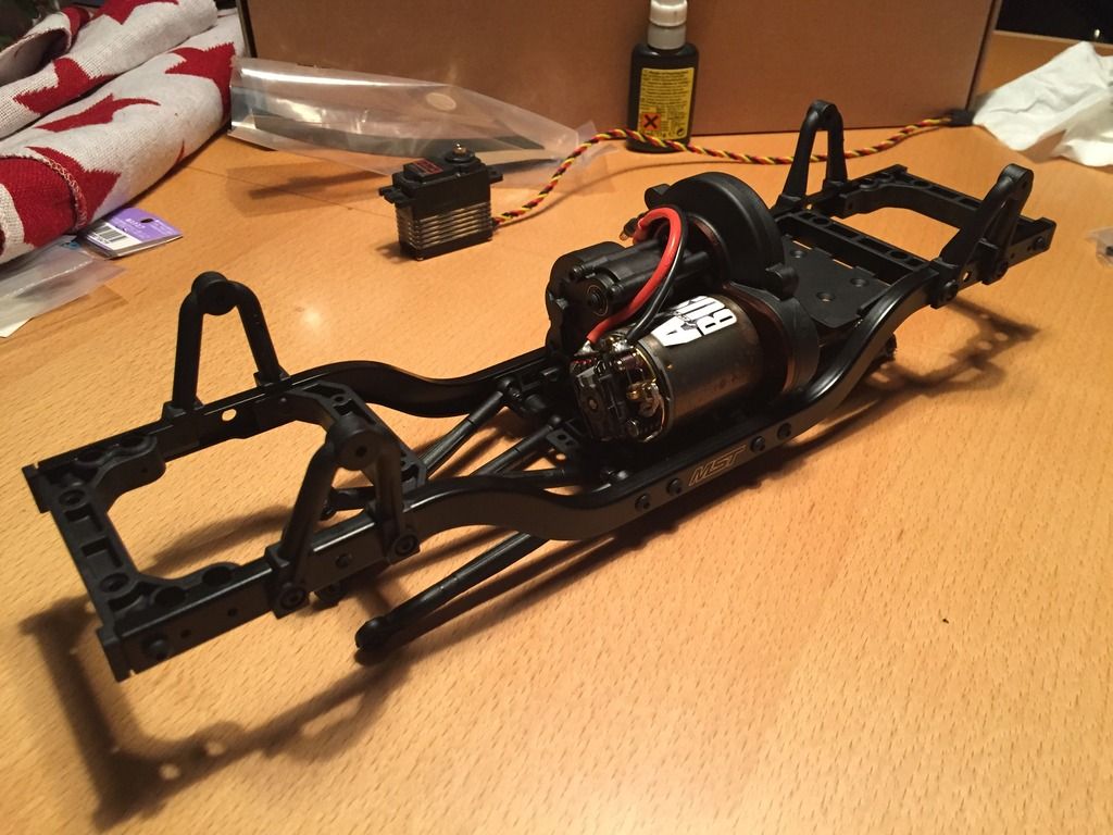

And here it is, with my favourite Team Brood motor

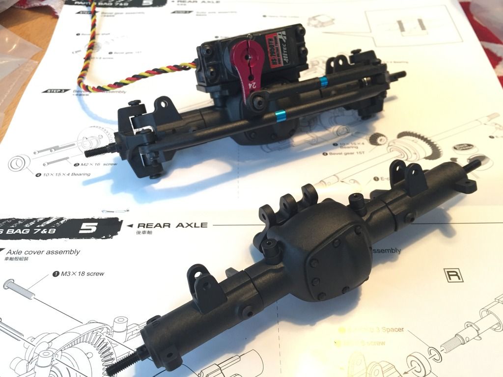

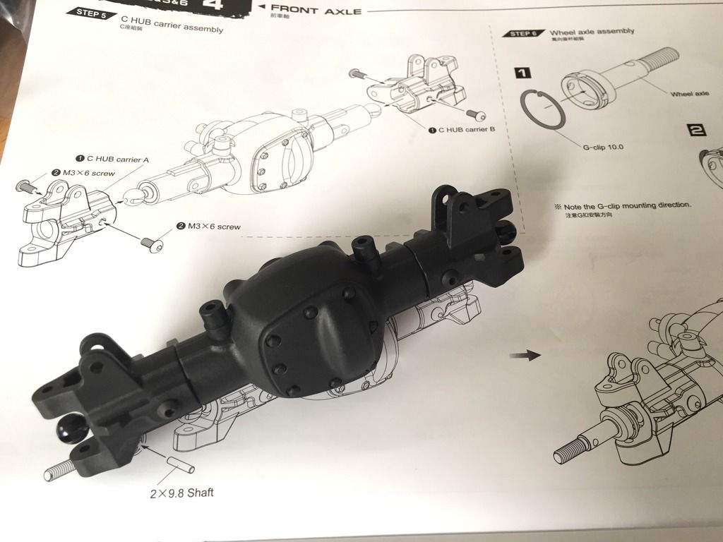

Next step are the axles...

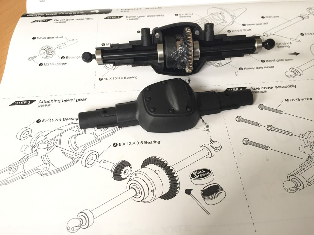

Some might not like it too much, but the lockers are plastic as well. Lets see how they hold up
The gears are metal and look pretty good (at least compared to the ones in an Ascender)

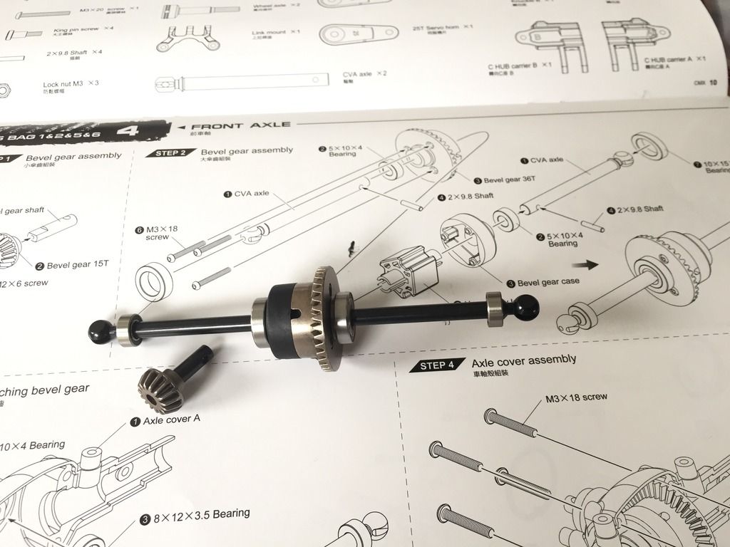

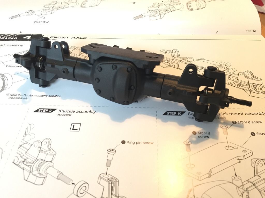

And the closed front axle

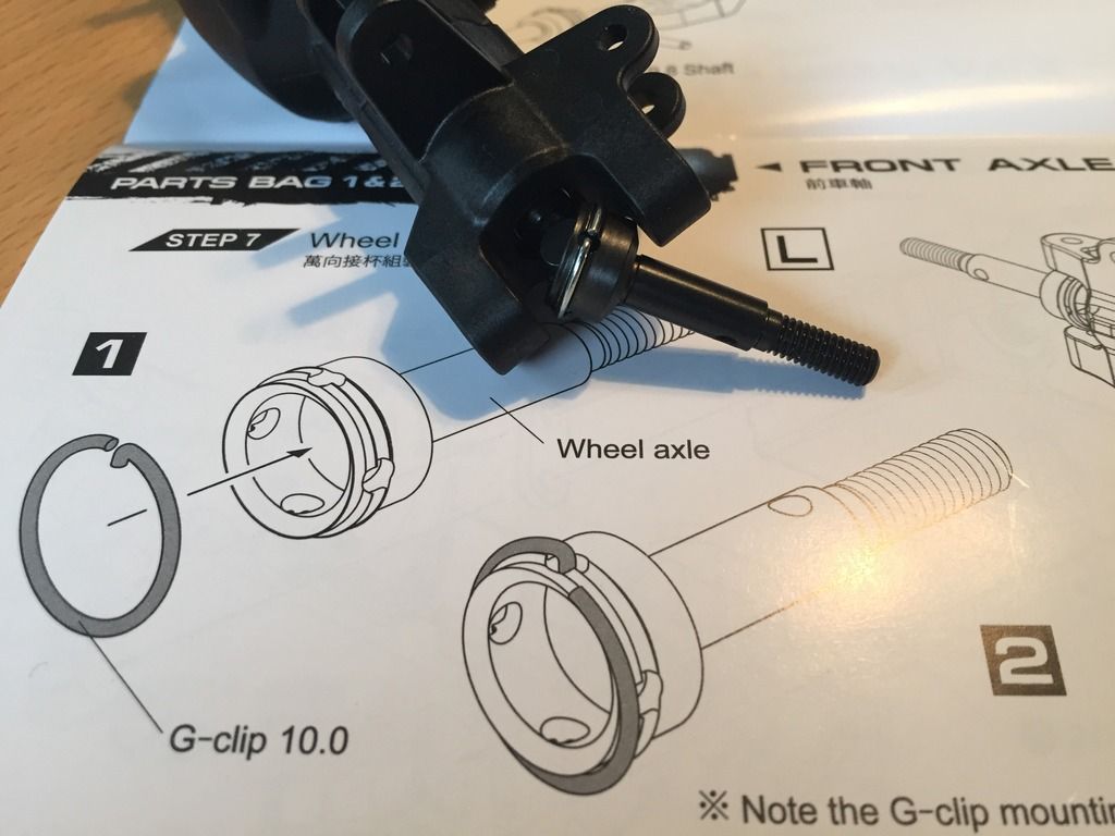

Front CVDs are standard and are only help together with a small g-clip. They have to be mounted differently left and right and I secured the clip with a drop of super glue (just to make sure)

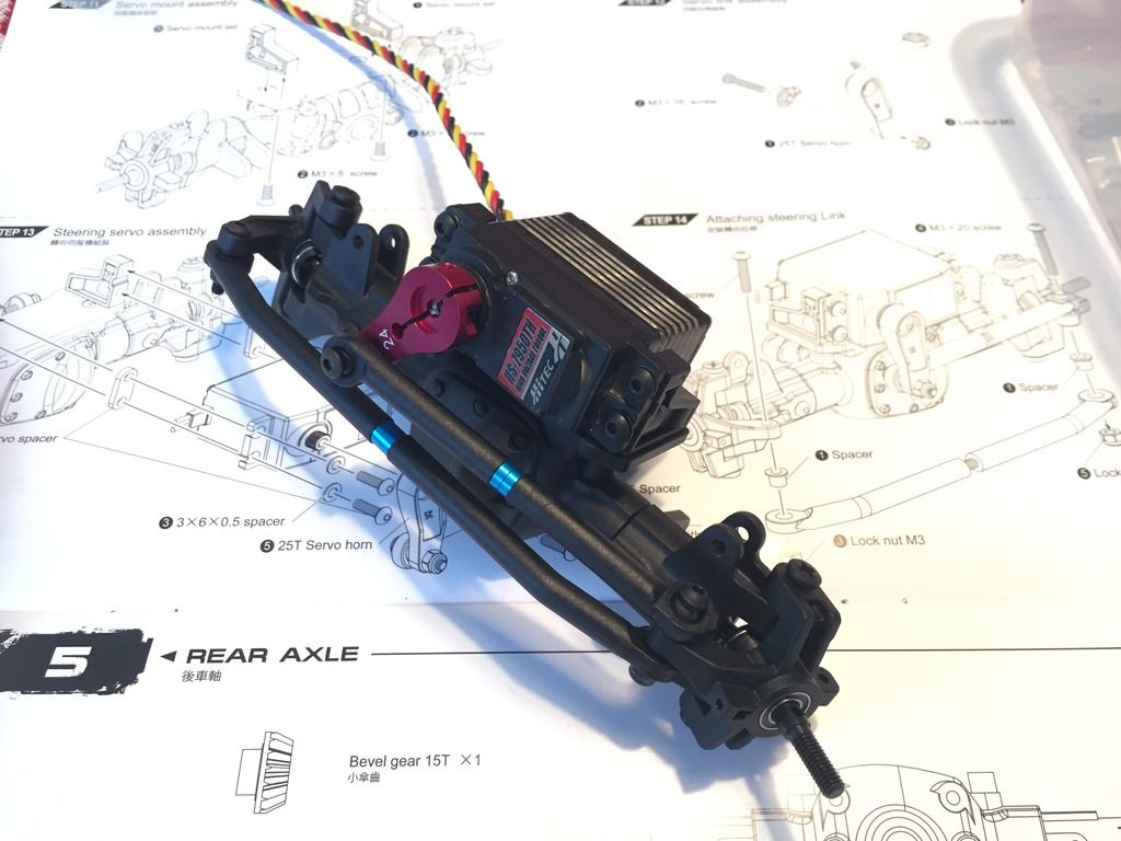

Servo on axle
And all done

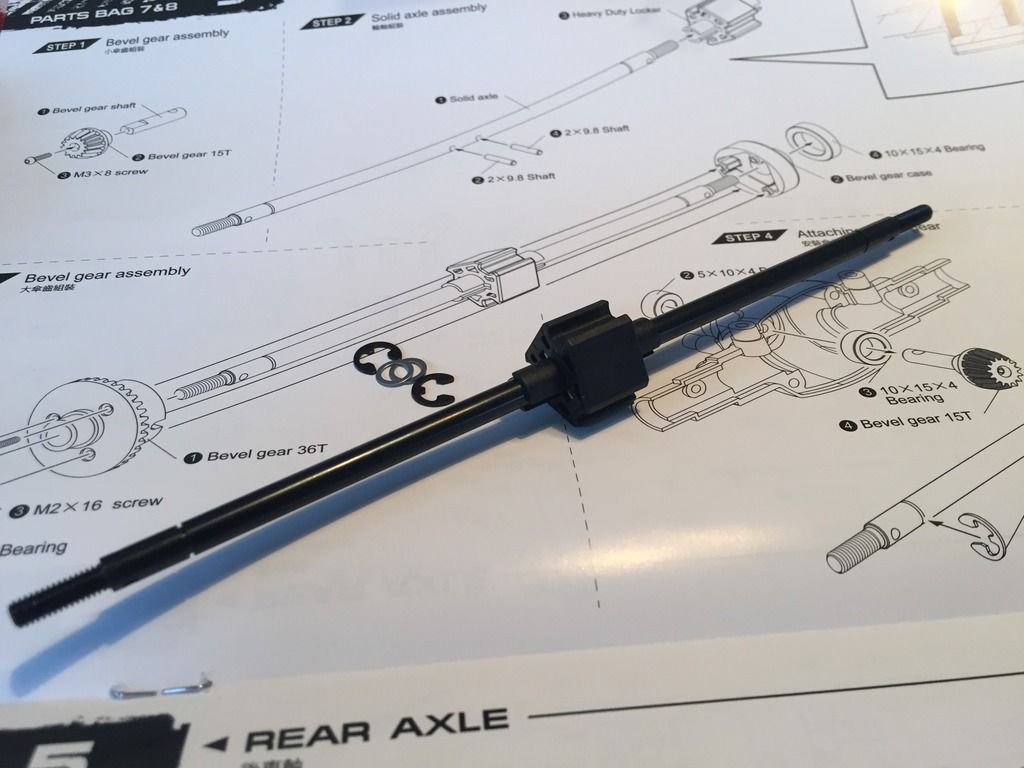

The rear was much easier, so here are both

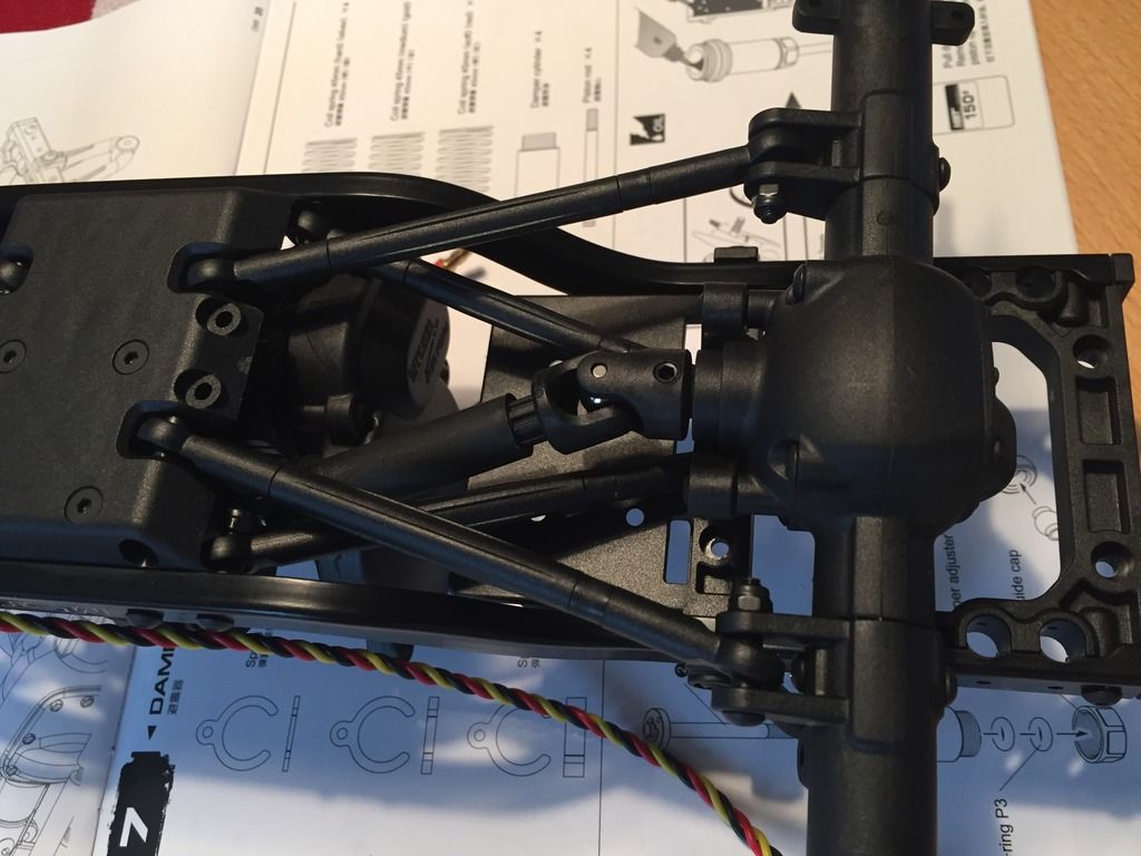

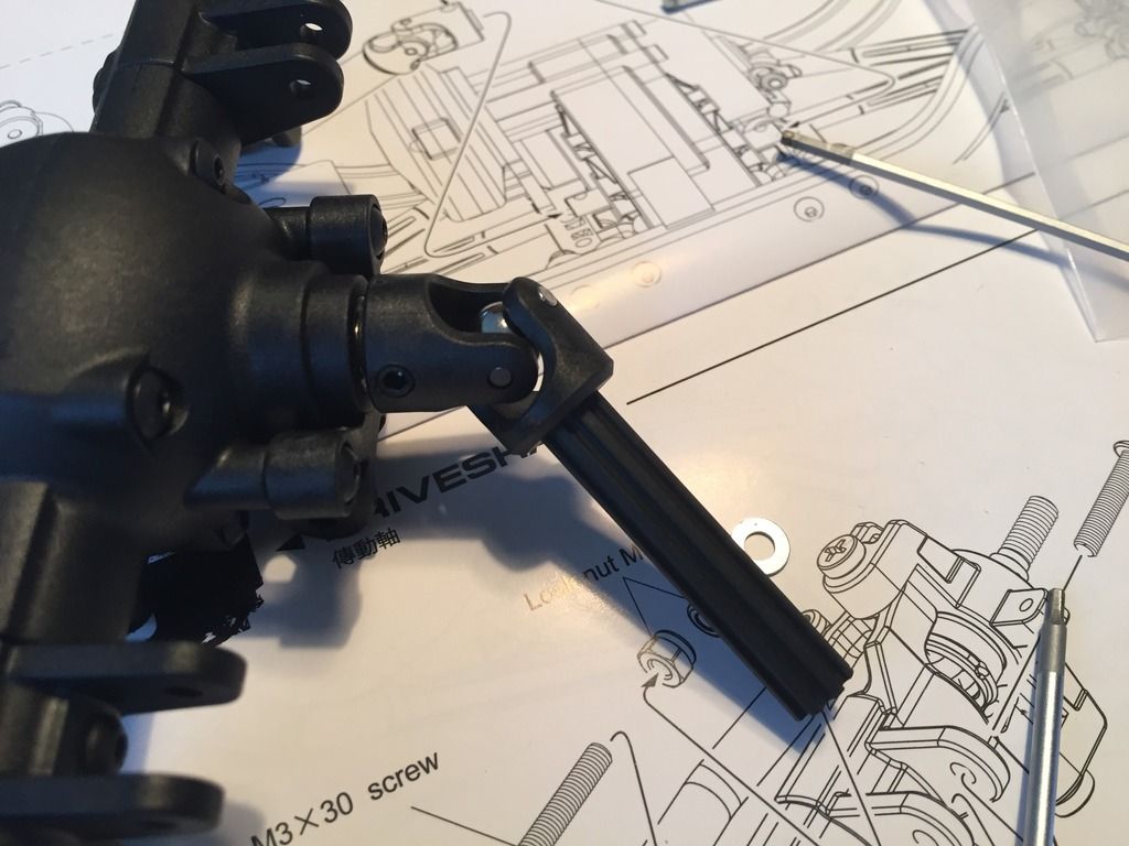

Drive shafts are pre-assembled and come next. Of course, plastic! But they look pretty stable...
All done...

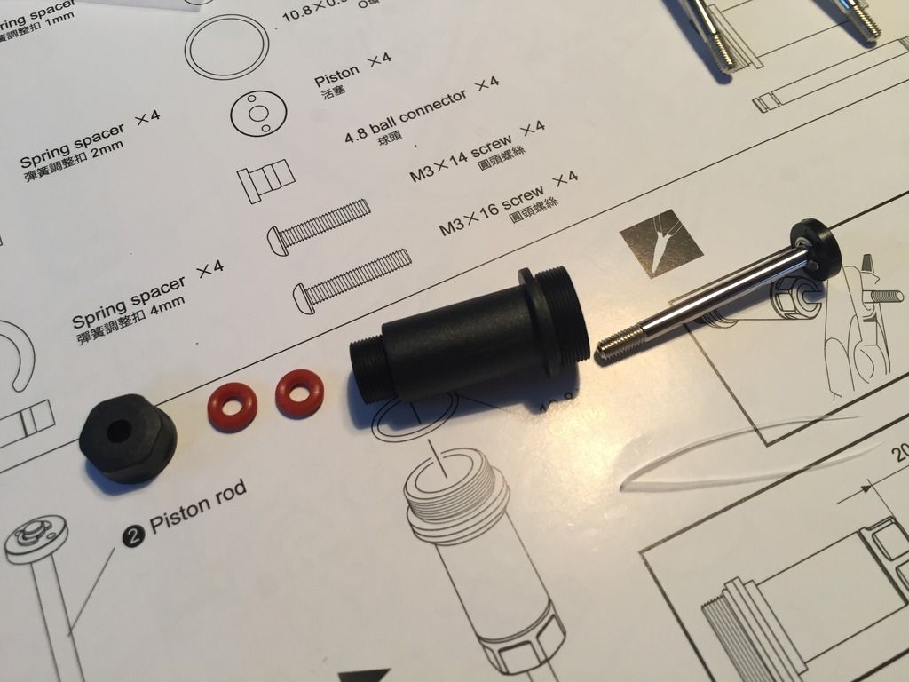

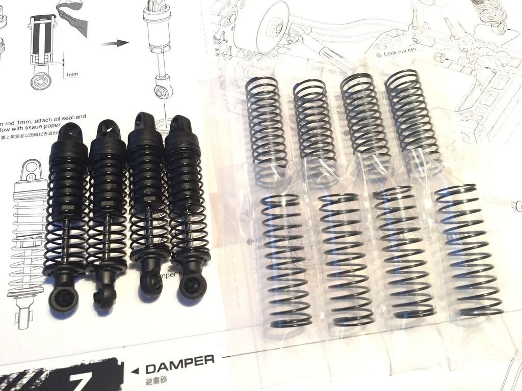

The shocks are 70 mm eye to eye and pretty standard.
But at least the kit comes with 3 different sets of springs.

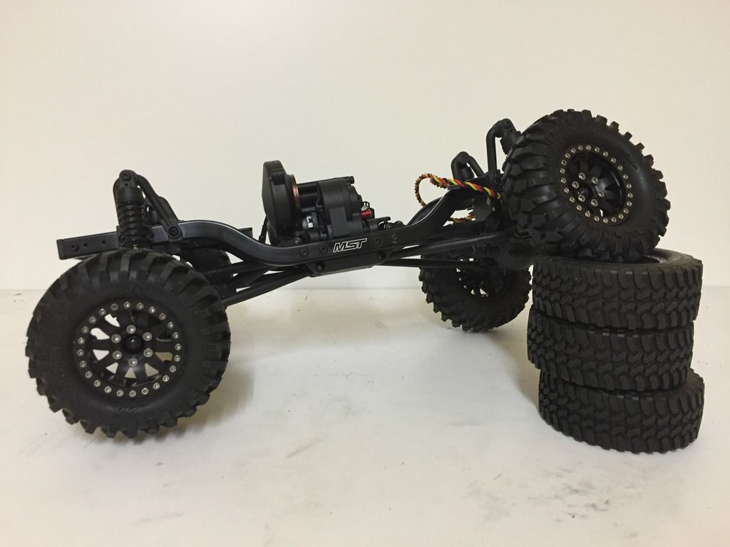

And the mandatory flex shot
Steering angle is not too bad either...
The pic is probably not good enough, but depending on the servo used, it might hit the cross member above. Nothing a Dremel can't fix ;)

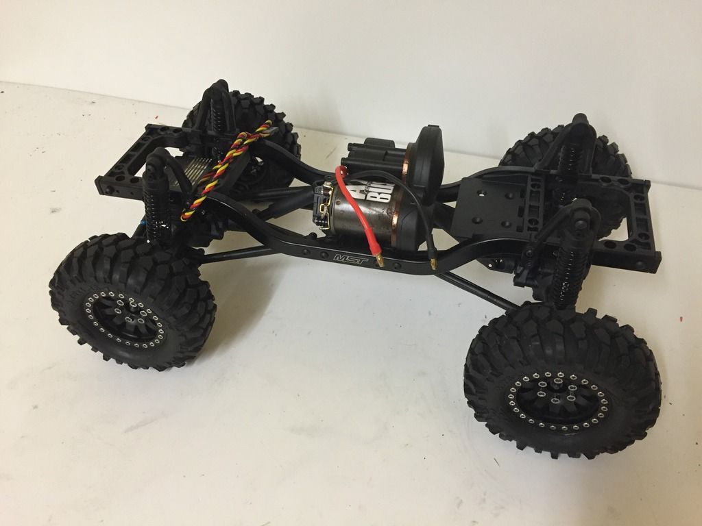

The battery tray also hold the front bumper (for the Unimog) and a splash proof receiver box. The ESC is mounted between gear box and rear axle.
Alright, this is what I have on the chassis. Let me know if you need anything else :)

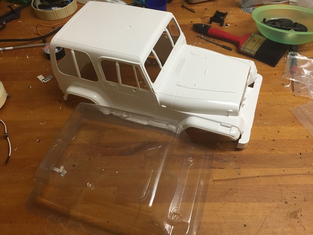

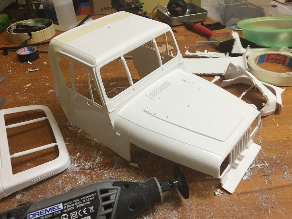

Now the body...
I didn't want to go for a standard Wrangler and quickly went from this
to this

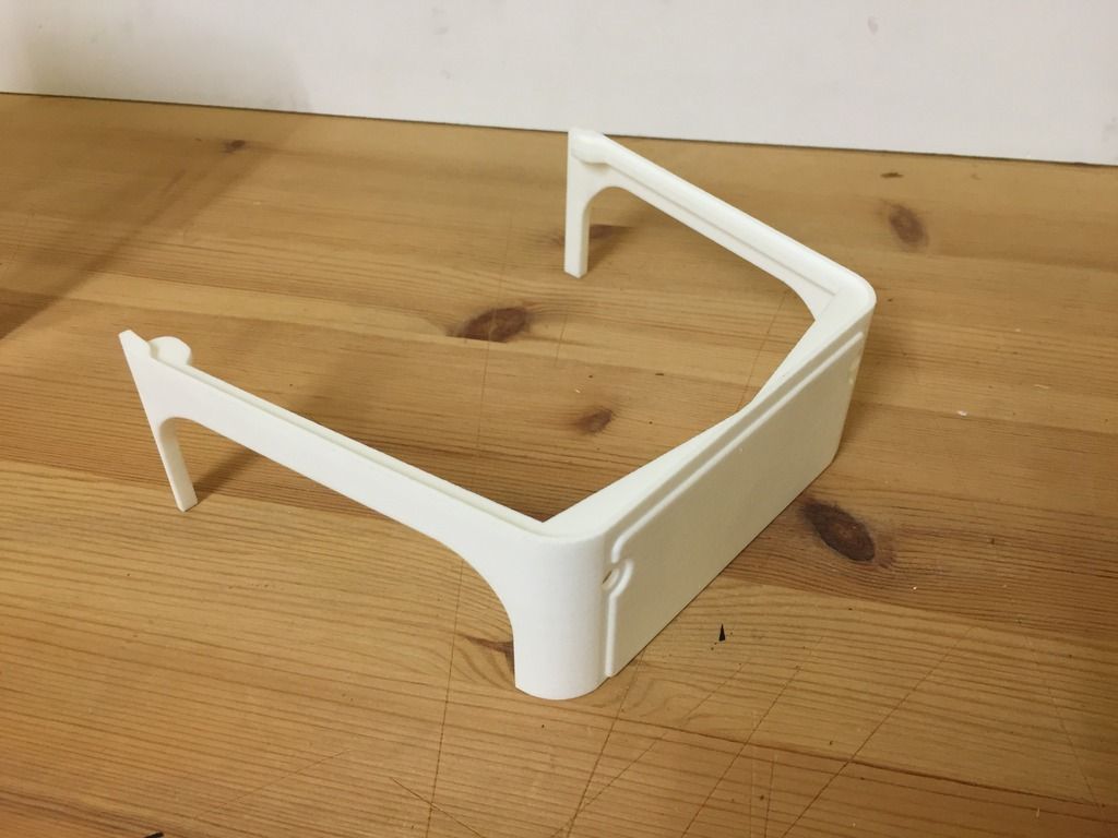

I already designed a dove tail and got it printed at Shapeways...
More Dremel action and some super glue later...
Made a fuel cell as well :)
The body sits too high and I still have to figure out how to mount it, but this is where I am right now. From now on, progress will a bit slower ;)
