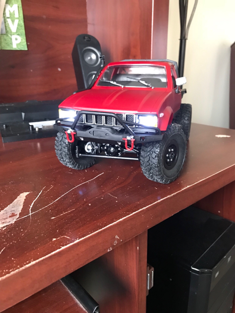

the door mirrors came out really nice.. some pics didnt post.. Not sure why. Ill add a few more here in a second..
So the Axles are all metal, assuming the gears are as well.. But the first thing that i had to "fix" were the transmission outputs to the axles. I havent taken apart the transmission to see how it all goes together inside but i know that those are my weak points.. Wondering if these are the "Upgrades"
