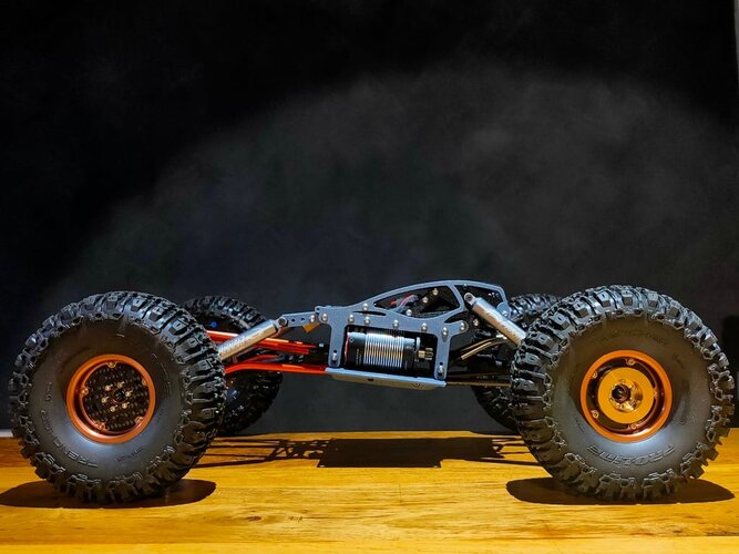

Hatchbox, Inland, Sunlu and Gratkit print well for me. I follow reviews on filament and buy when they're on sale. Current print/build is the MJet Sprint. My epoxy fail, sanding/bondo cover up and paint job were a collective sh*t show but I still love the boat!

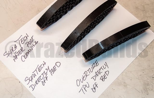

Been printing TPU for about a year now and pretty much found for the price the Overture from Amzon to be the better bang on the dollar.
Ive got three S1's that I can clean the bed and drop the nozzle with no concerns.
Retractions and Speed is the key Ive found. Temps are important like PETG - Im around 220* first layer @ 0.3 then the rest is 210* @ 0.2 layer height.
I dont print from a dryer so I get about 3 days of it sitting in the open air before I start to see some strings and moisture. Throw it in my dryer for about 6-8 hours and its good for another 3 (ish) days.
Duramic has worked well for me also when Ive tried it.
SyraTech has some 85 Shore stuff that I tried recently. I wanted a little softer for the Touring Car bumpers I make.
Pain in the ass printing. Reviews were all great, a few similar to mine but for the most part its good.
I posted my review and SyraTech got ahold of me to resolve my problems. I havent talked with them yet but plan to.
They have good resins and I may have just got the end of a batch that wont dry enough or was mixed on a monday.

Good feedback. Thank you. I've never even heard of Duramic, but good to know about Overture.
Speaking of dryer...I need to buy one of those now too. I'd prefer a front door version, but can't find one for a reasonable price.

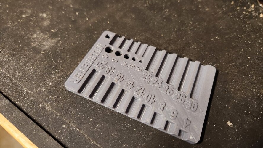

I saw Boom Racing is offering a screw measuring guide. As soon as I saw it, I knew I had to have one because it would be handy for building kits. Much faster than pulling out the calipers. I also realized I could model and 3D print it. Not surprisingly, many similar items have already been modeled so I found an STL file online and printed mine in Prusa ASA. The print isn't perfect, which means I will be doing this again at some point, but definitely will be handy for quick identification of screws.
One of the first things I ever printed as well. It gets used frequently over the years since.
