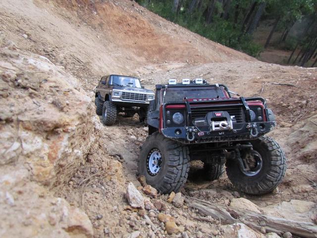

This post will be a little pic-heavy but hopefully that's okay. We got out yesterday and had an absolute blast! Weather was great and rigs ran problem-free the entire time. Only thing that sent us packing was the setting sun... gotta love those kinds of days.
So... Despite that I've had my Bronco for quite a while now, I had never run the stock Canyon Trail tires until yesterday. Cannot believe how great they did! They're a little firm but they hooked up so well... loose dirt, uphill climbs, sandstone, etc. Had to side-hill the rig in a few places and they just continued to impress. The lugs bit in and the firm sidewall kept the rig planted and stable. I'll definitely be running these tires again.
My buddy still had issues with the sidewalls of his Thornbirds getting wrinkly. Seems to be the rear tires that are having the issue. He'd punch it in reverse to get them straightened out but it kept happening throughout the day. I think that his rig is just damn heavy and that he needs some stiffer foams... idk. Anyway... performance didn't seem to suffer much as he and I both were able to tackle most everything we set out to conquer. His biggest issue is when climbing steep stuff, the rig wants to flip backwards.
